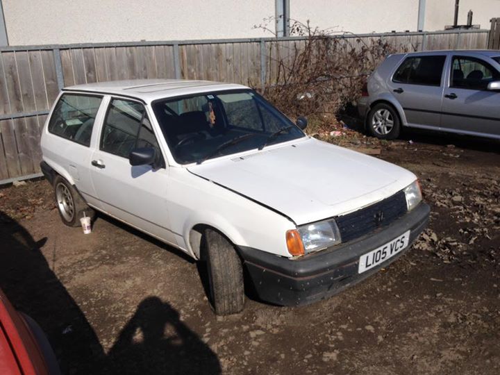

pics are of what I just bought in the attachments.

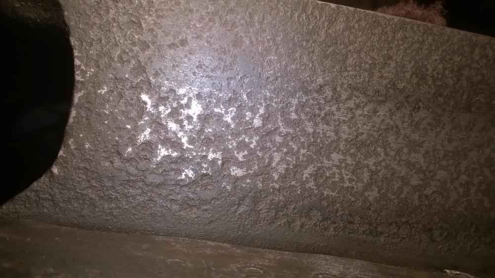

Well its not there ?
could it be some wear else on the engine ?
post-923545-0-98511300-1461110816_thumb.
So someone did buy that car then :)
The engine number should be there. May just need to wire brush the area. The stamps weren't very deep.
So does it have all the GT stuff with it? I was told it was a full GT conversion it just needed wired up.
They aren't etched very deep so are hard to see, a good clean should make it visible like kwijibo said, as for emissions the regulations are the same for the whole mk2F range so I wouldn't worry about the year of the engine
Looks like a decent find and I don't see many white breadvans, be sure to put a build thread up [emoji4] and welcome

When the surface is nice and clean (scotchbrite is the one) colour the area in with a permanent black marker pen. The resulting black surface will show everything up there is to show - possibly even the machining marks.
I rubbed the area with 400 and there was nothing there at all,
I can't find anything still, Am I in the right place on the block, On the engine theres nothing but on gearbox theres two sets of codes there
The engine number should be on the block literally just above where you can see the codes for the gearbox.
 just don't see it
Is it invisible ?
There is quite a lot of corrosion there, like I say they weren't stamped that well so it is likely lost now.

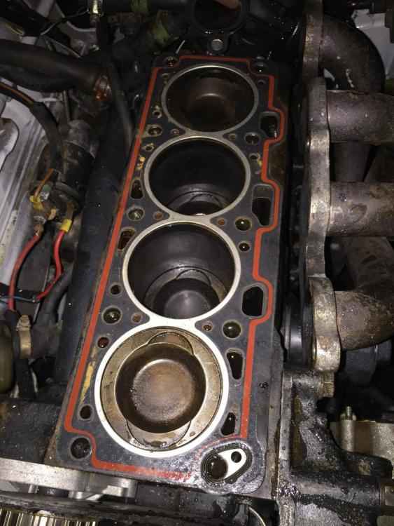

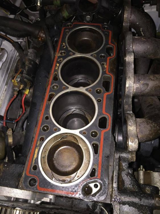

I think the engine code is the only way. Not sure if there is a noticeable difference in the pistons or anything compared to a normal 1.3.
I've never had an AAV and a 3F piston side by side to compare.
This was my AAV when I had the head off it. Top of the pistons look the same.
Gt pistons are AAV are really similar design, just the AAU I think that has different style crowns
