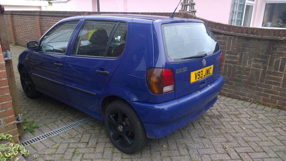

And he cuts out when its wet, or too much power is being used such as heaters lights etc or going down to a low gear sometimes

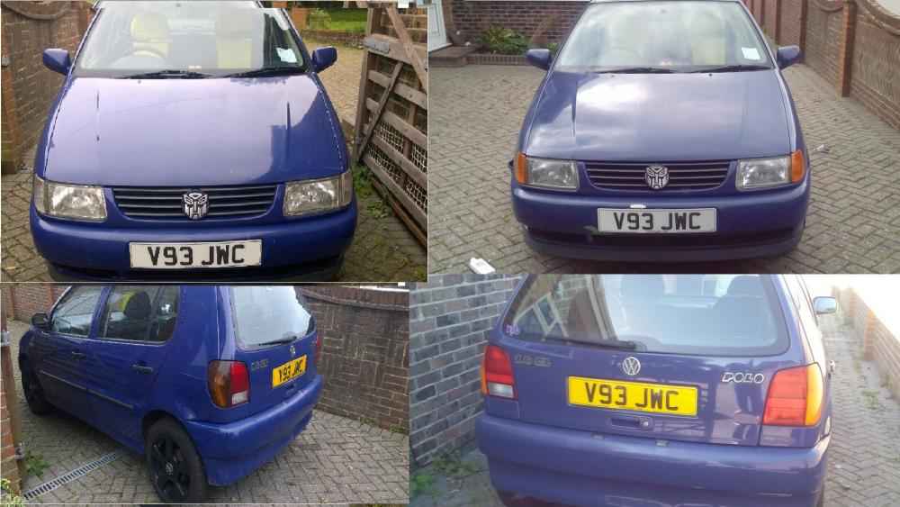

Any suggestions about how i can fix it (except exhaust haha) would be great but heres some pics of my bad boy

  • With a broken paddle in the drivers door the switch in the lock won't know you've turned the key, so the pump won't be signalled to run. The sliders on the window mechanism might benefit from some gr
The door locks will probably be the tab that goes into the locks have snapped, plenty of repair kits on ebay.
Window, wiring between the door and body inside the flexy rubber tube, the motor? or broken clips on the mechanism, again repair kits on ebay.
Engine, dizzy sensor failing, poor plug leads/plugs/dizzy cap, coil unit ? also check the alternator wiring and the main battery & engine earth points
Awsome thanks i'll check..didnt think of the coil What a plank i am haha.. its the central locking thats gone would the paddle thats broke in the drivers side door effect it? I'm thinking electrics/ maybe vaccum? But maybe wiring for the window..It goes so slow when its winding up or down..I've already replaced a broken clip on it..and it didnt change it..Maybe dying motor..
Thanks for your help :) your a star
The sliders on the window mechanism might benefit from some grease?
yeah i thought that might be the case :) yeah i will get me grease out.. Cant hurt it :) thanks so much i'll let you know how it goes when i get to steal little ted for the day
