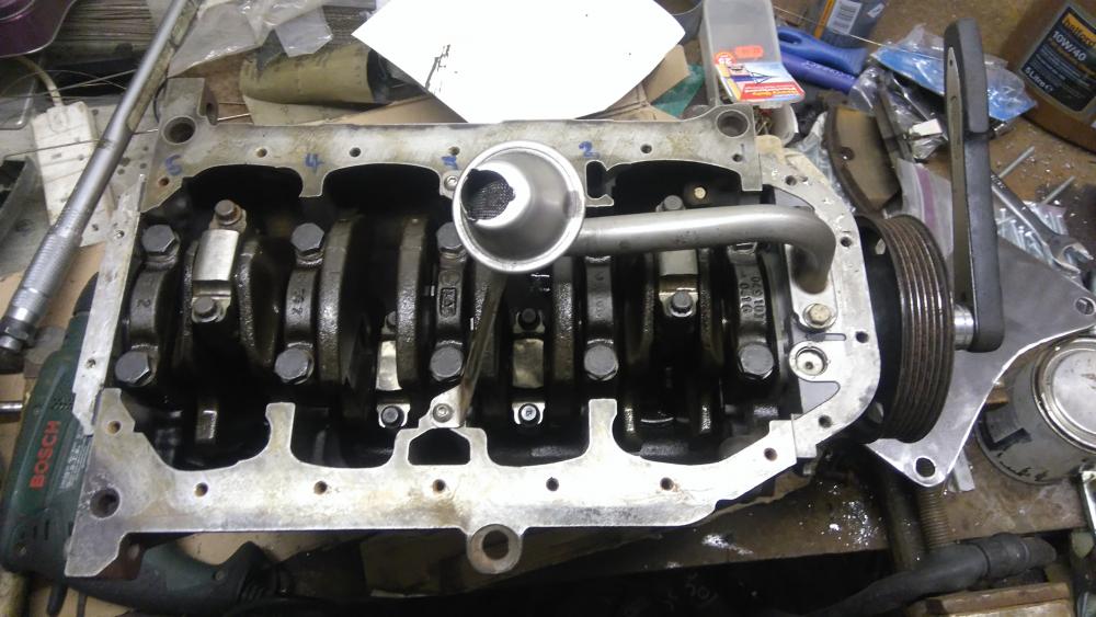

Made a bracket for the engine mount
Had one of the blokes at work skim 4mm off the back so it sits flush
Starting to look like an engine again now!
Need to get a new tensioner for the cambelt and pick up a few bolts and what nots from vw.
Will do some more at the weekend if I get a chance, picking up some wheels tonight.
