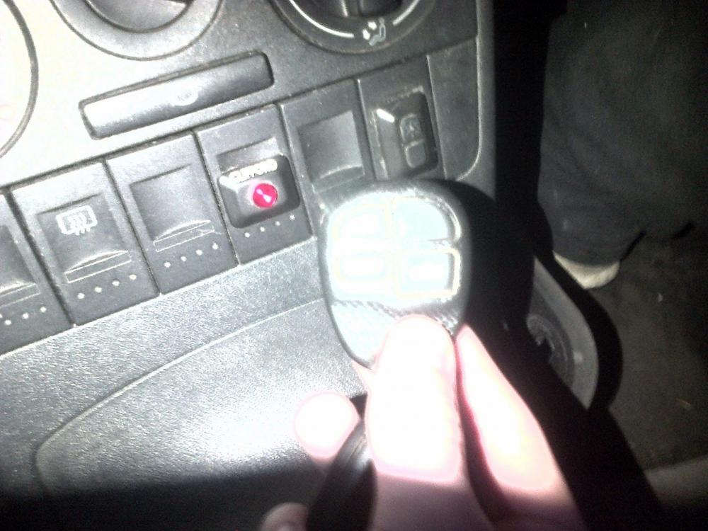

Hello,
After buying a 6N2 with a friend for parts I want to remove the Clifford Alarm any one have any information on how to do it all help greatly appreciated.
Thanks, Conor

pull down the lower dash and console and find where theyve hidden the main brain , then trace back all the wires and remove them and tape up any damage , the immobilser part will be black wires cut into some circuits so you will need to find those and re join the cut wires
