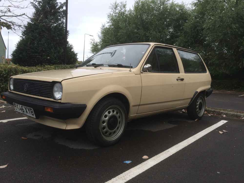

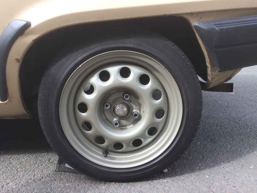

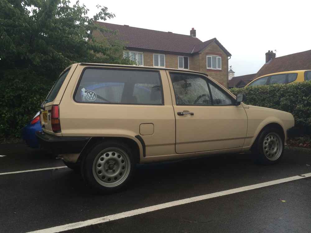

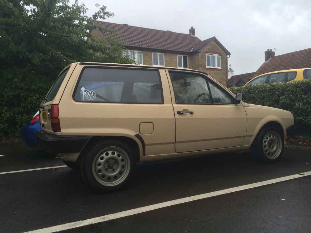

Shocks and springs done!! Pics to follow soon. Haven't seen a massive difference in how she sits but i'm kinda expecting that. The difference in the drive is incredible! I'm pretty sure everything i changed was what it came out of the factory with!!! Shocks, springs, bump stops and top mounts. Took the old shocks off, pushed them in with my hand, no resistance at all and they just stayed there. Rear bump stops, or what was left of them, pretty much crumbled to dust when i took the rears apart. But just wow! Massive difference. It is a bit crashy going over any bumps though. My only beef. Apart from that, very happy. Top pics are befores.
These are the after shots.
Front is sitting noticeably lower. Would have liked a bit more but what it is is fine.
Can actually see it in this pic
I'm liking the wheels buddy
