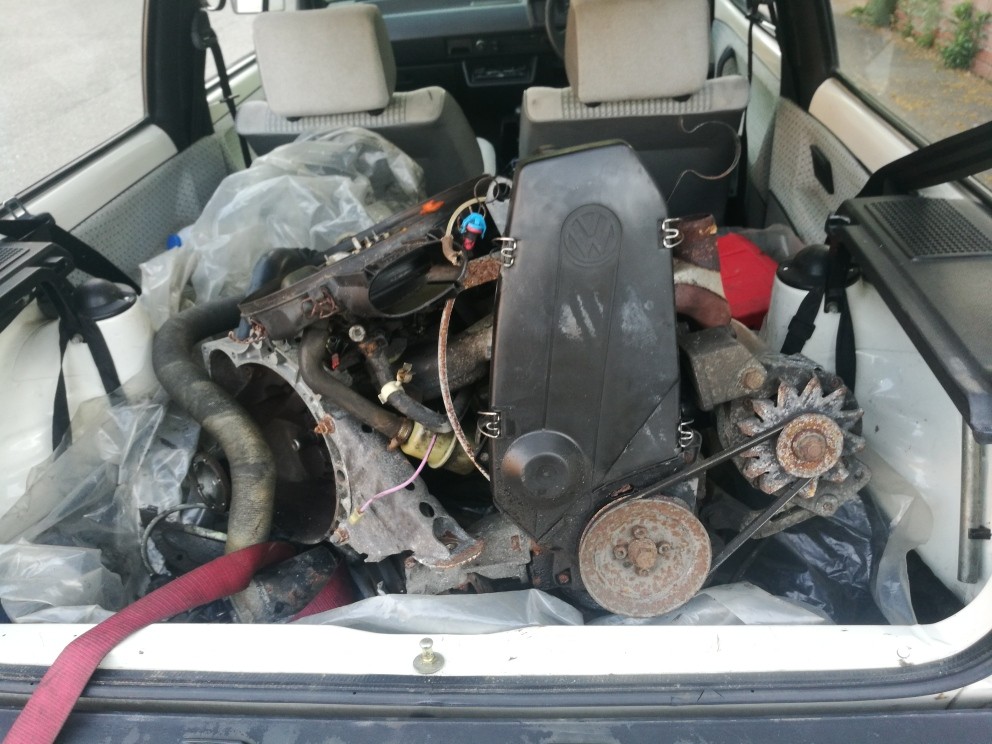

Picked up a 1.3 MH engine and 8P gearbox in May with plans for a top end rebuild and a Newman cam, probably fast road. Still after a 5 speed gearbox mount if anyone has a spare. Hoping to get running then get it rolling road tuned as soon after as time and the bank account allows.

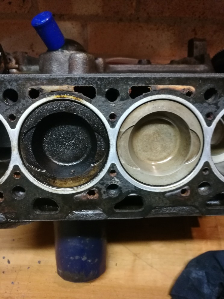

Cleaning up the block and pistons, amazing what wd40 can do

Although your pistons looked pretty fucked, it's  not always a good idea to remove all of the carbon build up. This actually can help to seal the pistons, especially in a worn block
Only gave the tops of the pistons a clean and its highly likely that the engine is going to get shells and rings before it goes in. Can still see clear honing marks on the bores so assuming it hasnt been rebuilt already(i was told it hadnt) there should be no issue with excessive wear on the block.

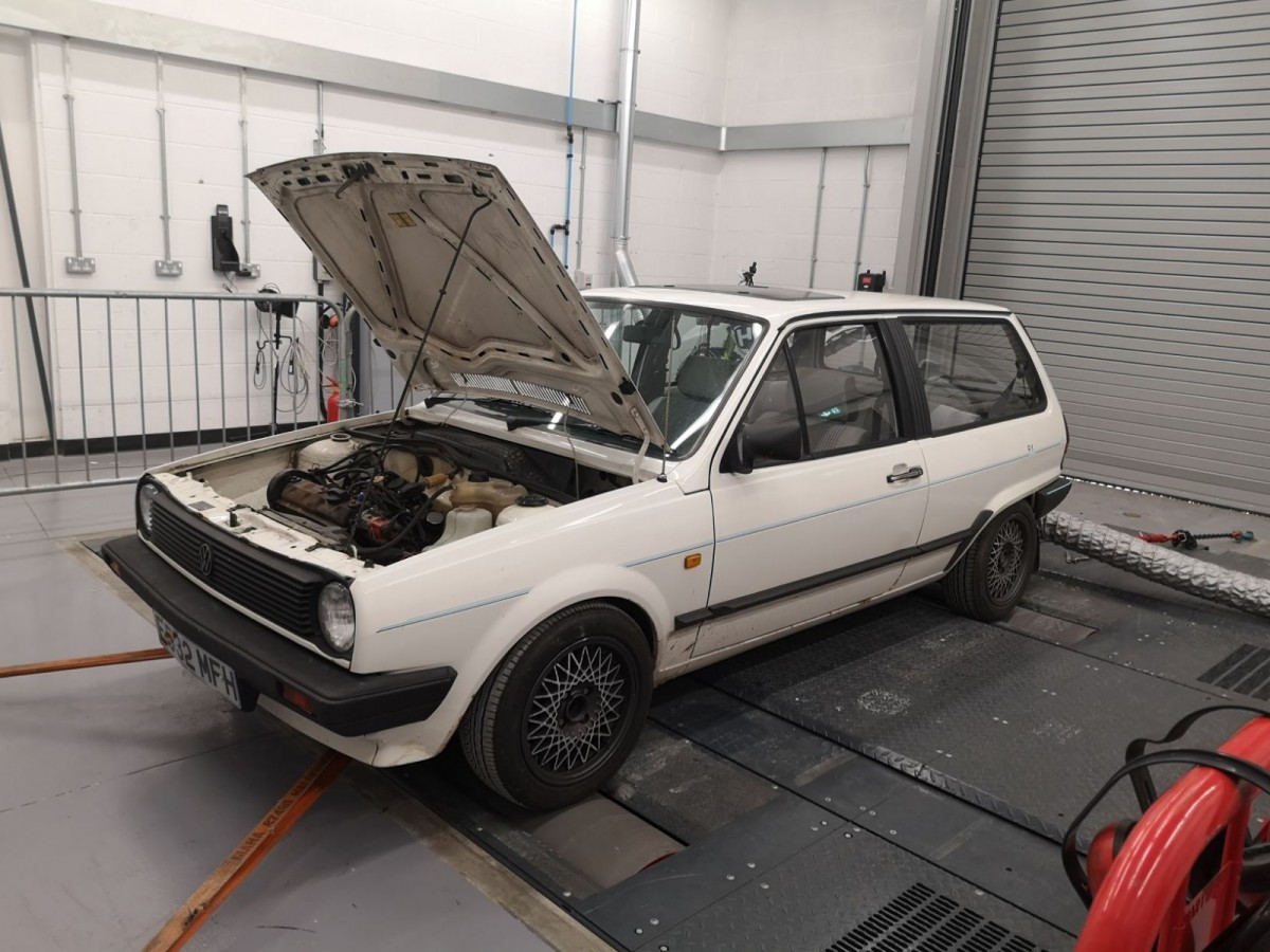

Did get the nankang as-1 at christmas. Were useless in the snow but did give some pretty good slides. Good tyres, nice predictable limit on them and car can really be thrown about with confidence. Polo has been retired for a month after the purchase of a volvo 940 turbo to do motorway duties and since im only at uni for a month this term there was no point trying to get both cars down. Running 2 cars on a student budget (even working full time in holidays) may put the engine on hold again sadly but the car is still a blast to drive through the twistys. Took most of the interior out to see how much difference it makes and the back end was rather more lively which a good dose of full throttle sorts out.

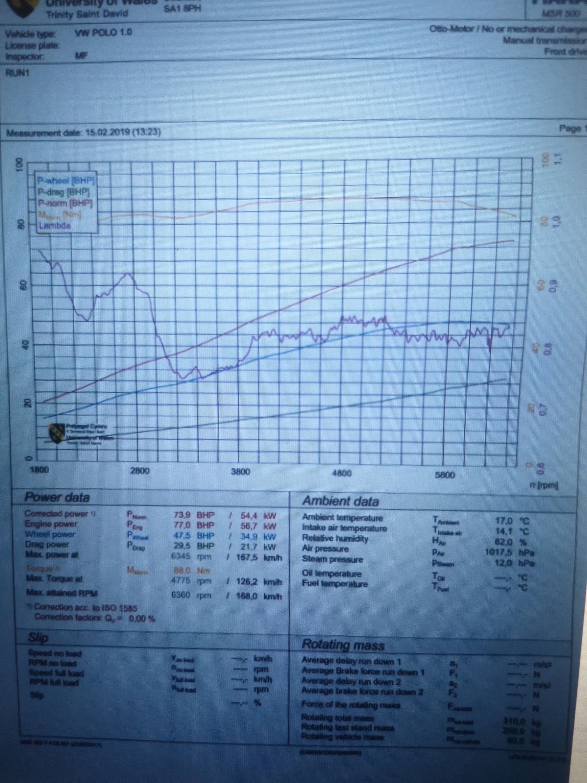

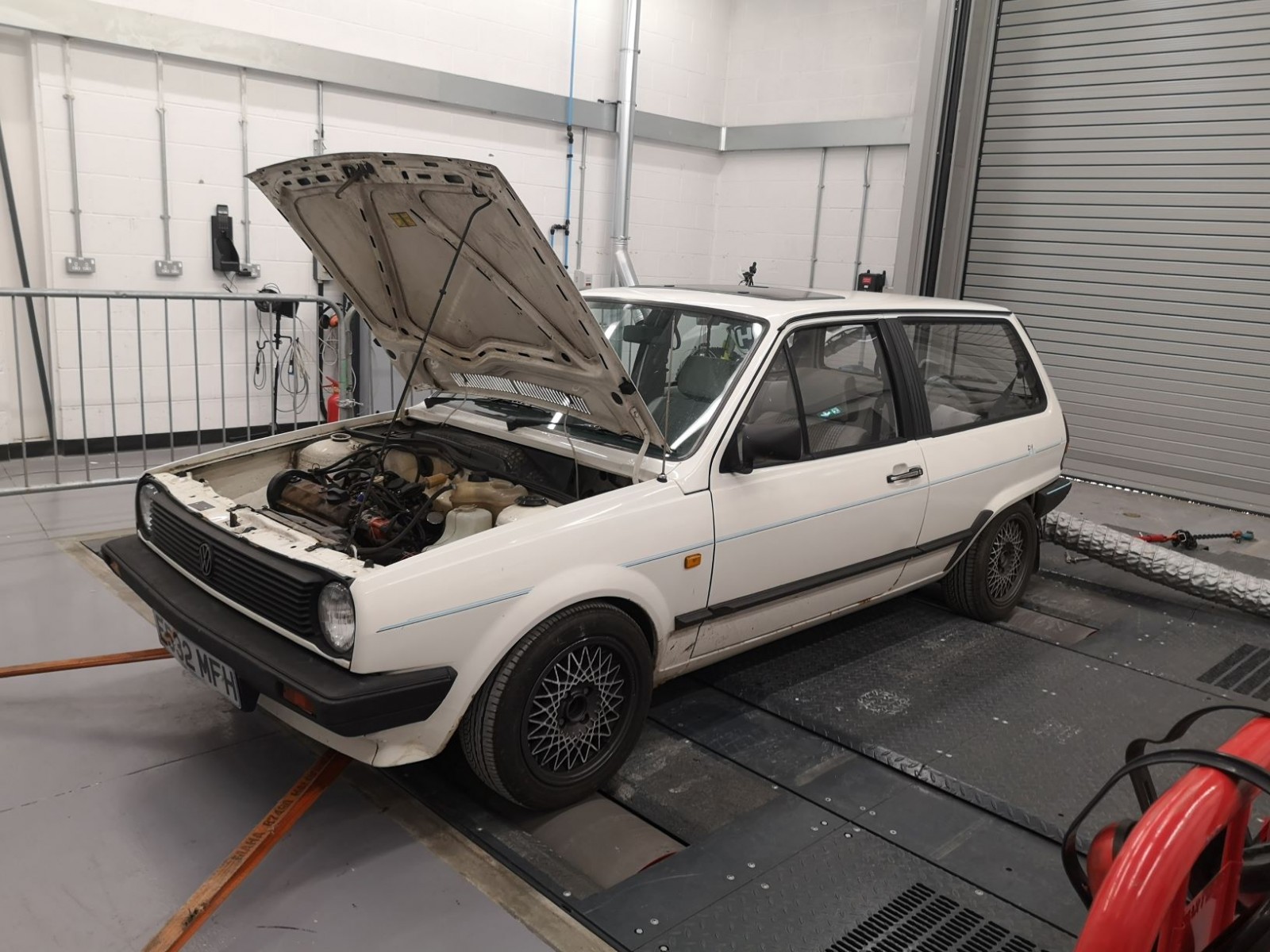

Also had her on the uni dyno and she made a grand 47.5 to the wheels with bike carbs and full manifold/exhaust. At least its more than standard, would have been gutted if it came out less.
That's from the 1.3 MH engine right? 73.9bhp from 1.0 litre would be impressive. The 1.3 litre GK with a single Pierburg carb was rated 75ps =73.9bhp standard.
Always nice to see a dyno curve with the lambda reading.
Making good power/torque at ~0.83 lambda (12.2:1 AFR) over 4000rpm.
You can see the small torque drop at ~0.75 lambda (11:1 AFR) around 3000 to 3800rpm.
Thats a 1.0 HZ engine with yamaha fzs600 carbs, 4 branch and 2" stainless single box system. Factory power is 45hp so VW must have quoted at the wheels not the crank on these cars. The 1,3 was rated at <65 i thought because the MPI GT 2f was rated at 75hp.
non gt was always 55hp

45ps (33kw) engine horsepower on HZ as standard
