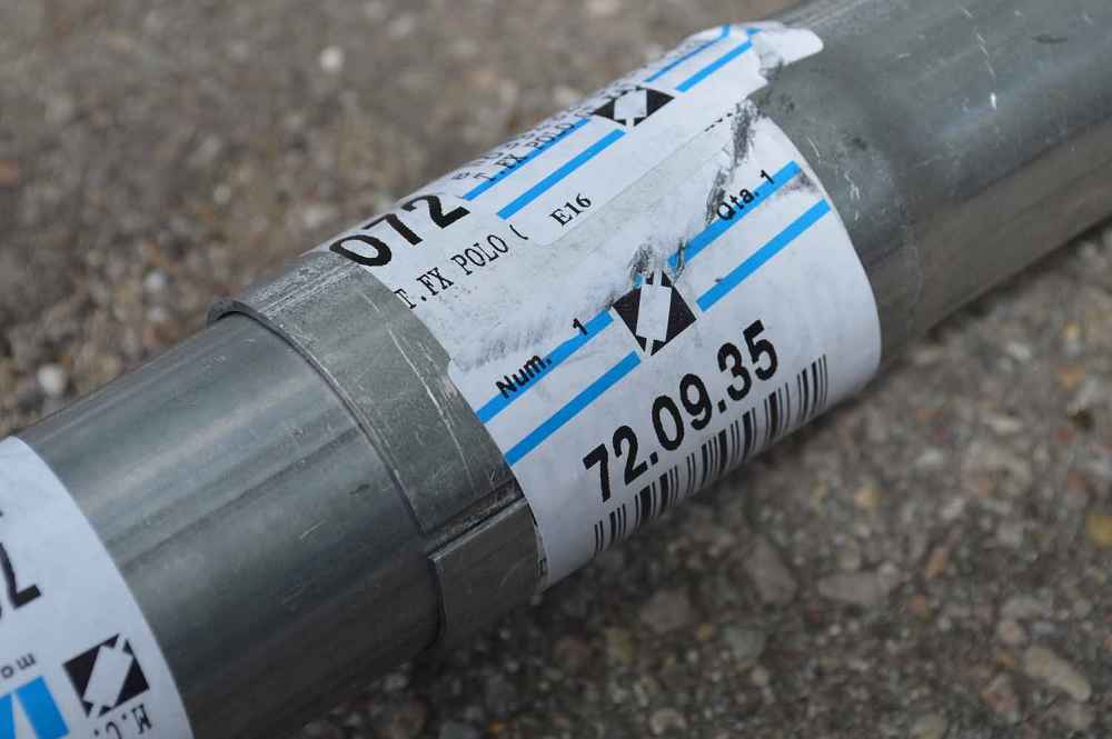

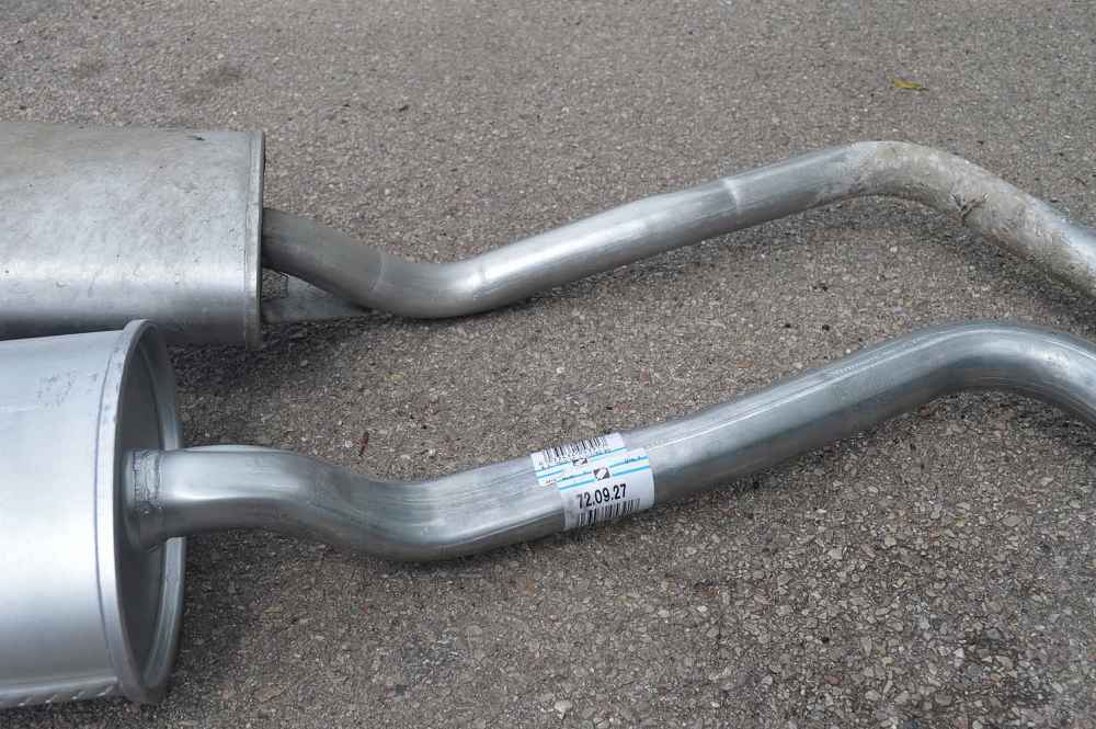

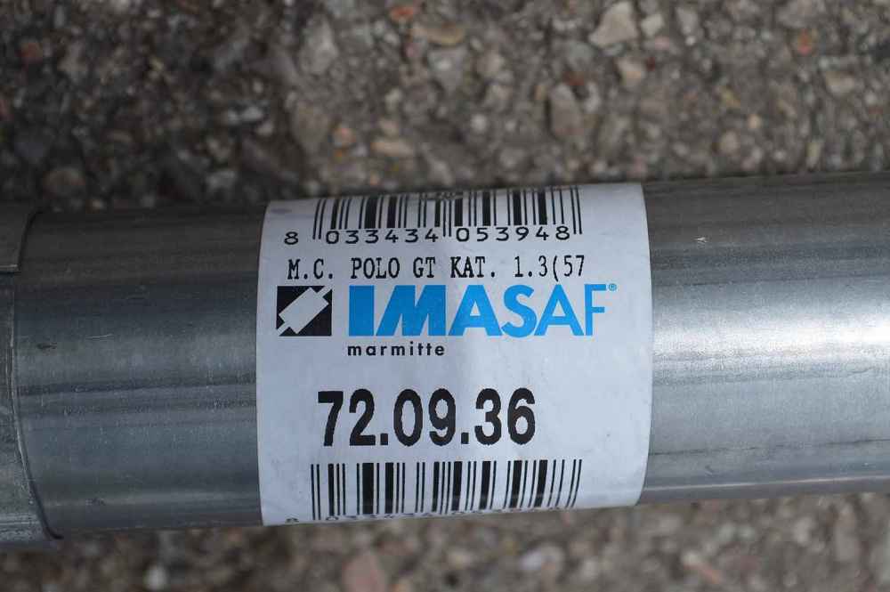

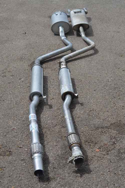

I recently fitted a new IMASAF GT/G40 pattern exhaust to my GT and thought I'd post here in case anyone is hunting for a standard exhaust for a MK2F.

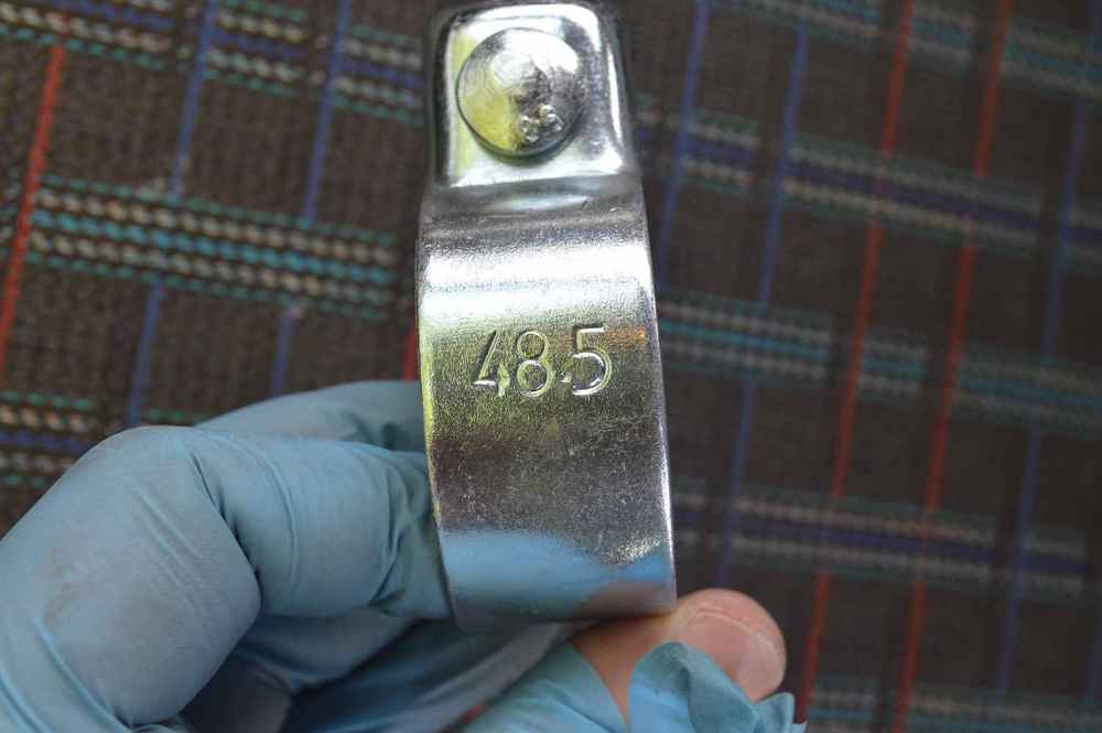

It's 45mm O.D all the way front to rear, and uses three 48.5mm clamps at the flanges.

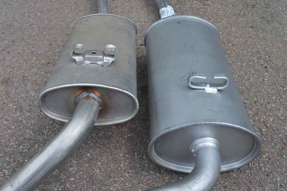

It seemed to fit well; the only thing I found was that the backbox hooks are pinched close together, so I had to bend the rear underbody hangers inward and use longer rubbers to reach them.

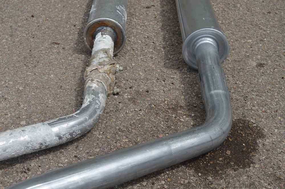

The photos compare the system with the very cheap 'ebay special' exhaust it replaced. It can't be seen here but the mid-rear join on this was 35mm O.D and it strangled the engine. It runs much better with the IMASAF system.

That's fantastic Dude as the post I put up not so long ago on my original gt exhaust and a cheap replacement one off ebay the difference in bore size and bend and sets in pipe work was stupid.. I have been on the search every since and ended up fixing the original vw gt exhaust till I came across a good replacement.. So for £100 I shall buy one ..
I got the system as a complete set from ebay.
It's quiet and fitted together well - the clamps I thought were a better fit and easier to adjust than the usual U-clamps. They're wide enough to cover the slits in the flanges, aiding sealing.
The mid-section outlet is angled slightly down, so the backbox tube easily clears the rear beam - but sits slightly lower overall at the back than other systems. This might be due also to having to bend the hangars down as mentioned.
still better than the other crap on the bay..
