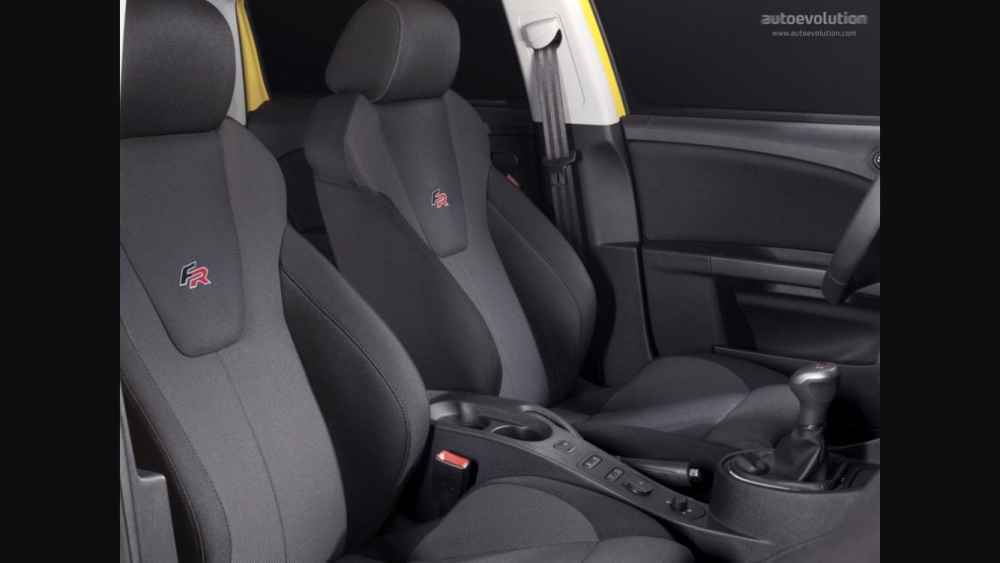

Hey guys,
Can anyone help me regarding which seats will fit straight into my 9n3 with no modifications? I have found some Seat Leon FR Mk2 seats which I really like but obviously don't want to buy if they won't fit!
Any help would be appreciated.
Thanks!

probably wont fit direct, fronts can be made to fit. If theyre same as mk5 golf chassis then youll need to drill the mounting holes out about 10mm wider. rears will be a pain. Probably best to look at some 9n3 gti seats or something
