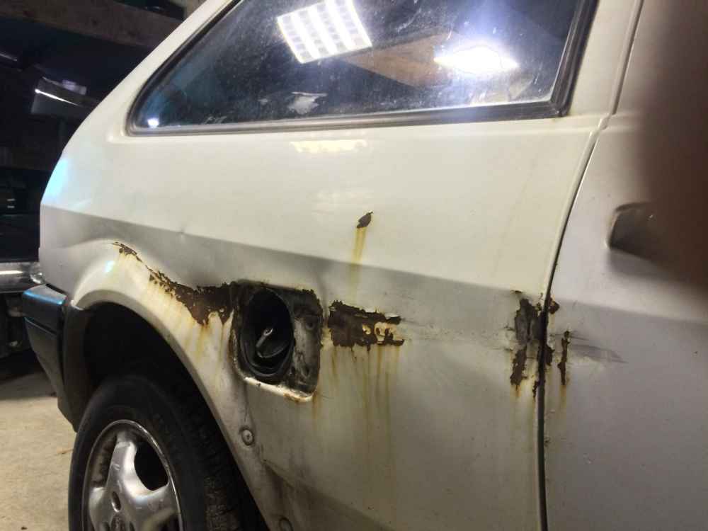

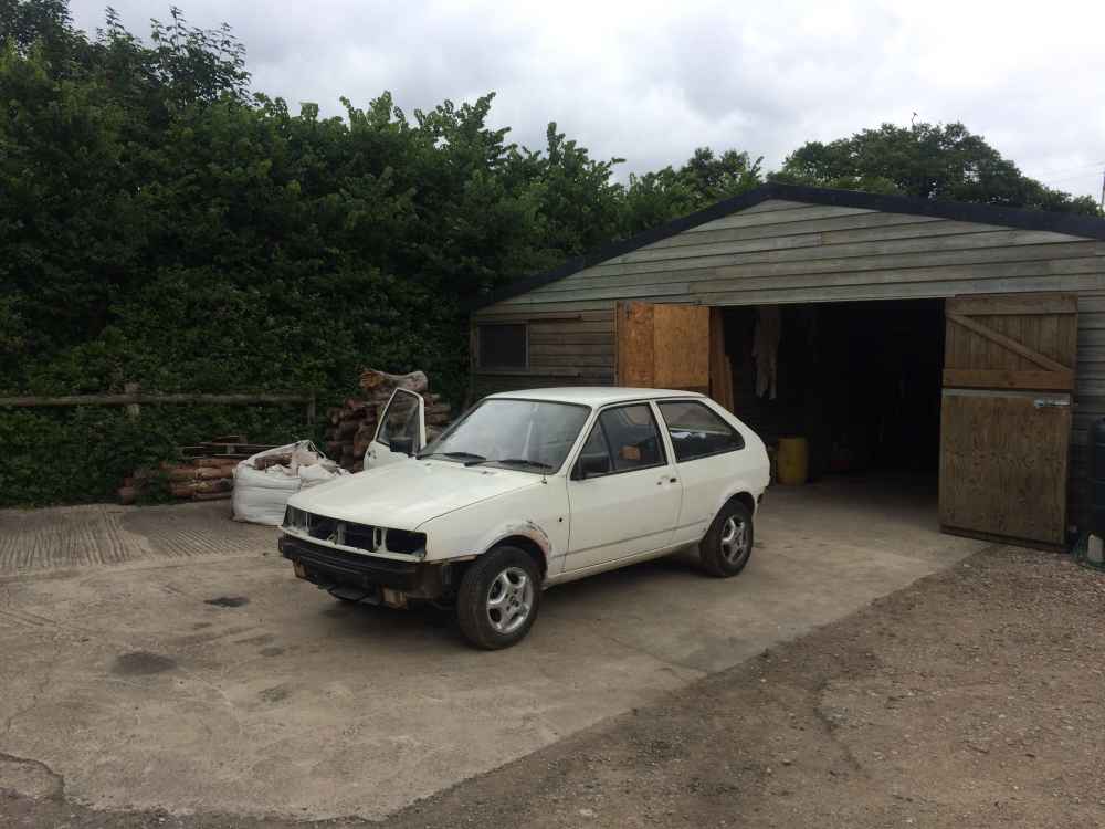

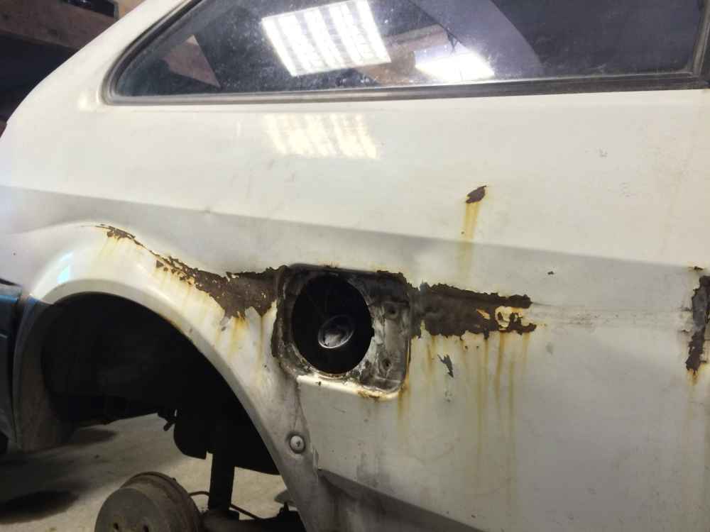

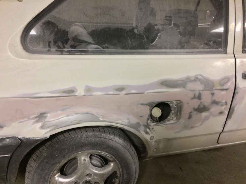

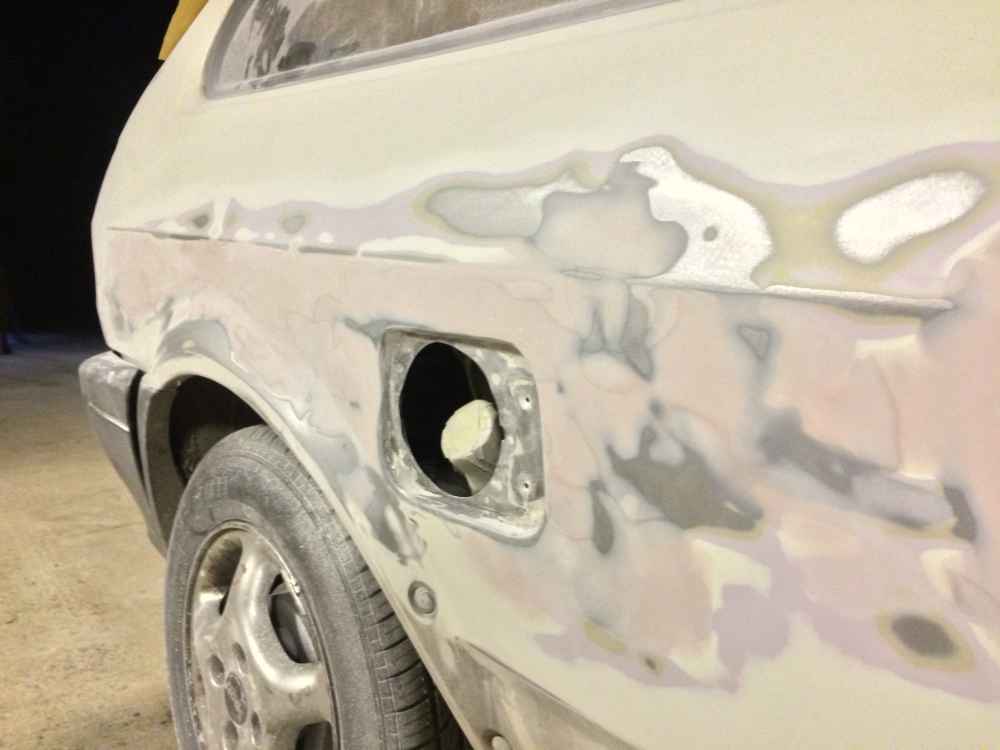

its only when i got the polo back out last week that i had done more of the body work than i had remembered so after a little bit more sanding and cleaning it was almost ready for primer.
I put the primer and paint to one side until the weather was right and started stripping the interior out for a good clean and too see what the floor was like under the carpet. found no rust at all and a full unopened packet of rolo's!

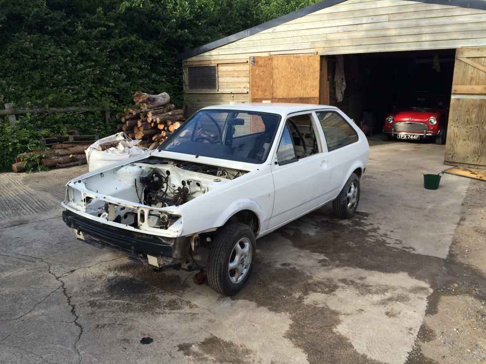

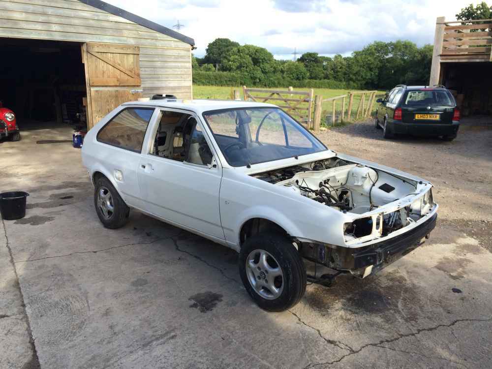

This morning i pulled the 1.0L engine out and gave the engine bay a good clean to get rid of those rusty water stains from months ago!

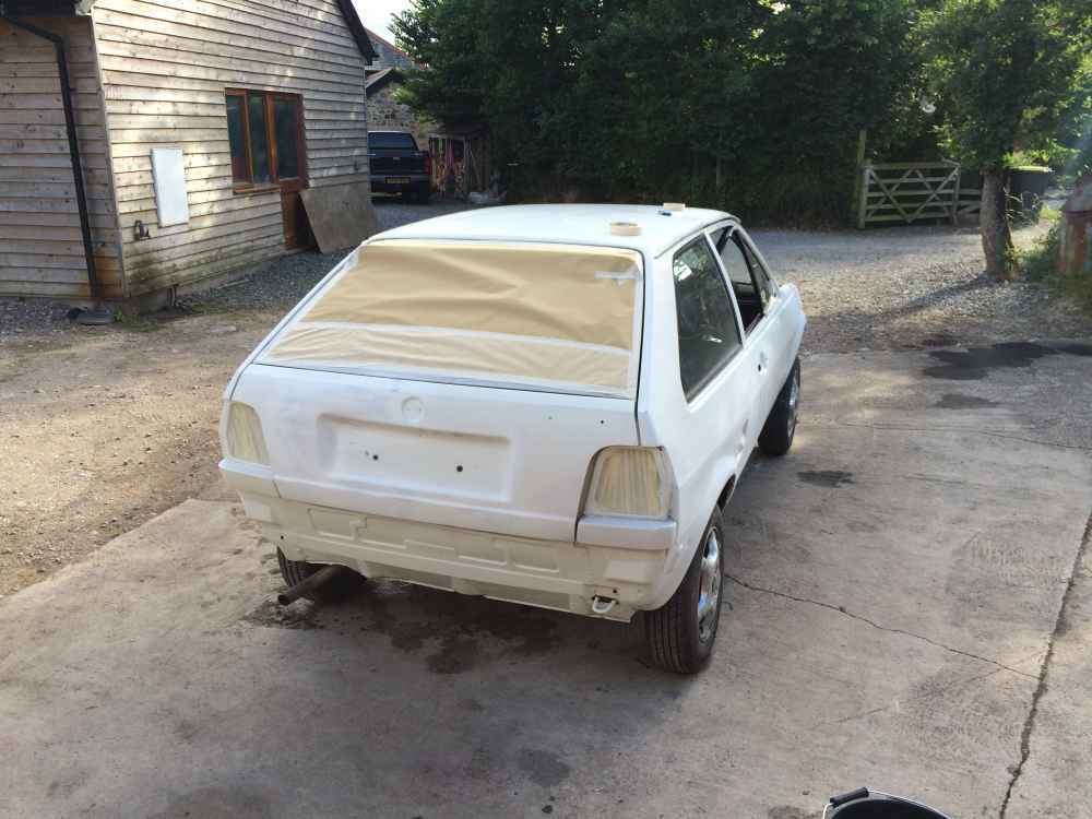

Currently the car has no interior no engine and needs painting, and i plan on having it finished or at least very close to finished for Devon Dubfest on the 22nd of this month. its going to be tight for sure!
here it is so far..

Nice repair on the rear quarter, engine bay looks like it cam up well too.

Thanks man! yeah i was surprised at how well it came up! the guy has 2 gt engines, one of which is still in his car and the other that he pulled out of a running car for a backup but scrapped the car with the loom as he had a running gt so didnt need the extra loom.

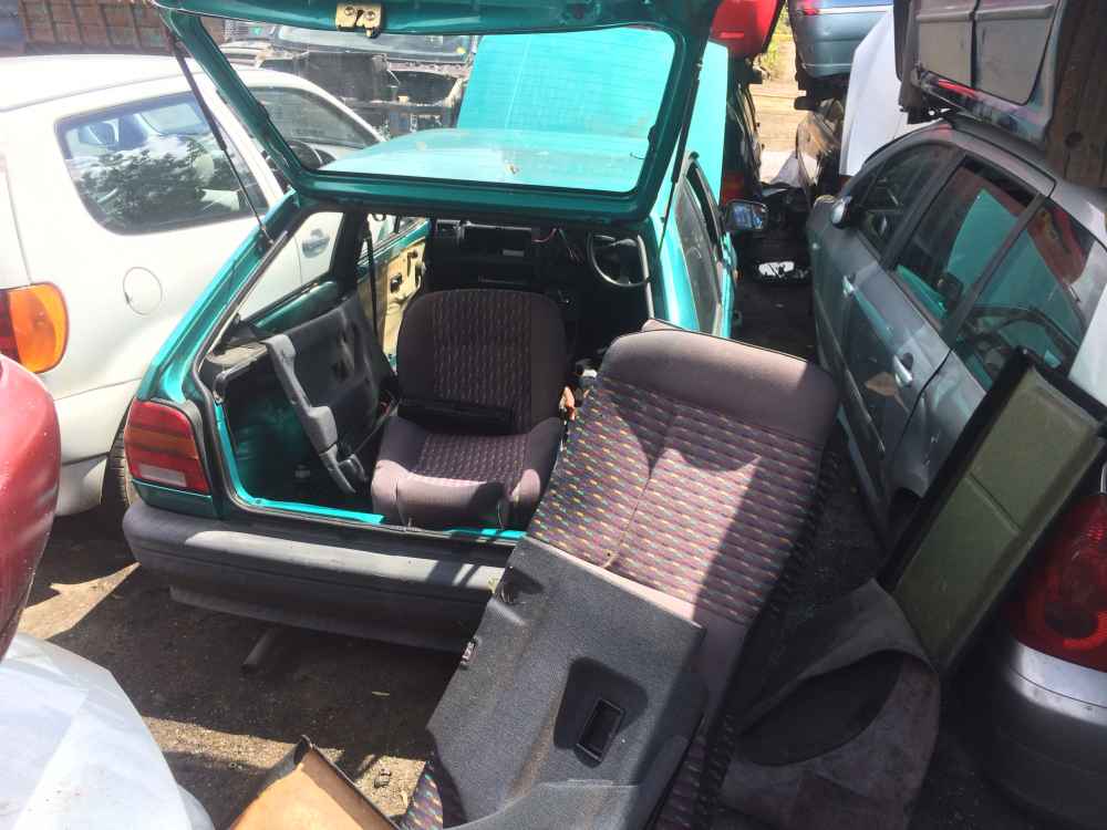

Had a productive day today! bit of running around this morning to get the correct paint for the polo. Whilst i was passing the scrap yard i thought id pop in as i heard of a mk2F in there and i needed the indicator from one. i ended up leaving with a full interior, glove box, petrol cap and the indicator all for a magical 50 quid!
Only reason i bought the interior was because anything had to be better than the horrific blue and grey pin striped seats with plastic door cards!

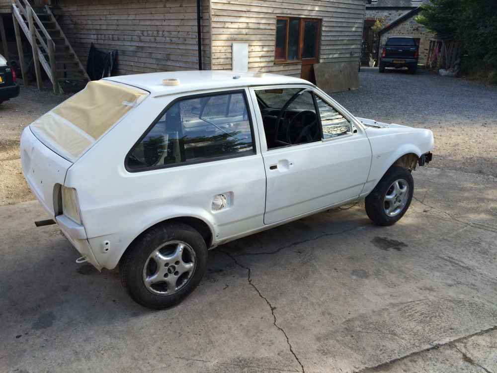

And then made a start on the paint prep sand wash sand wash sand wash mask primer long old process but all worth it!
