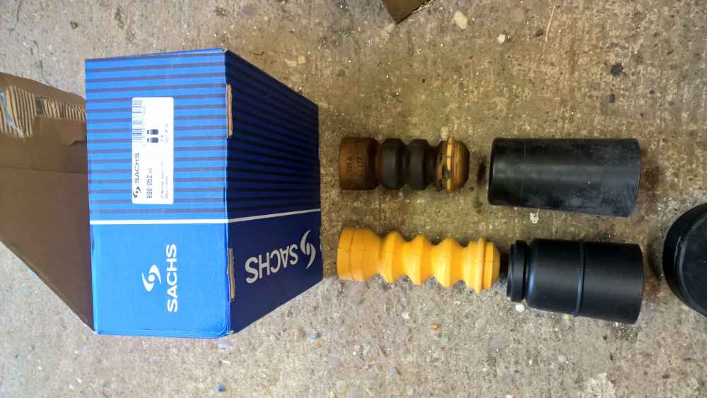

Hi,
I am replacing my rear shocks and bump stops. Is it me or are these a little too long? Part number is correct.
2000 Polo 6n2 1.4TDI
Any ideas?
Thanks

    For all Polo 6n2 bump stops are 100mm. 133mm will be fine if You put them on OEM springs, otherwise it will be too long, and car will "seat" on them.    I had on my 6n2 133mm rear bump stops
I had on my 6n2 133mm rear bump stops in combination with OEM springs, and they work fine. They wasn't smashed at all.
Polo 6n had 133mm up to certain chassis number, after (about 1999.) they change to 100mm.
Thanks. Fitted them and drives fine like you say. :)
