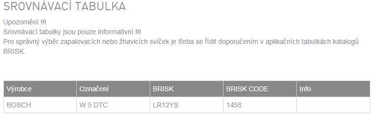

I also found this W5DTC alternatives list
  • Autolite 9062
  • Beru 14-5DTU
  • Beru UX56
  • Beru Z44
  • Brisk LR12TC
  • Brisk LR12YS
  • Brisk LX14TC
  • Champion N6BYC
  • Champion N7BYC
  • Champion OE012
  • Champion OE109
  • Champion RN7BYC
  • Denso 5066
  • Denso 5307
  • Denso IW22
    Denso VW22
  • Denso W22EPB
    Eyquem C82LS3X
  • Iskra FE85PTRS
  • Lodge 25HL
  • NGK 1263
  • NGK 3684
  • NGK BP6ET
  • NGK BP7ET
  • NGK BUR6ET
  • NGK V-line-1
  • Torch F6TJC
  • Unipart GSP4347
  • Valeo 246859
