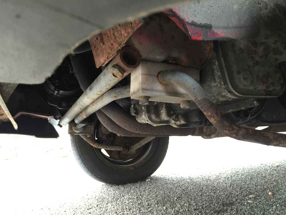

Any advice on my anti roll bar mounts pictured below, I'm guessing it's not standard. But is it an upgrade or a bodge? Tia

    its an upgrade ...arb blocks are made from a firmer material and also move the bar forwards for better geometry ...the bar in front is a brace sometims known as a ged bar , that helps stiffen the fron

    Yup both very common mods. The ARB blocks move the ARB forward to correct the castor on lowered cars so it is actually recommended that all lowered Polos have these.

Cheers for the info, does seem to handle well. But the steering at slow speed is a bigger
Yeah, that is a bit of a side effect of them. Worn top mounts can be a bit of a contributing factor as well.
I will check the top mounts tomorrow. Cheers
