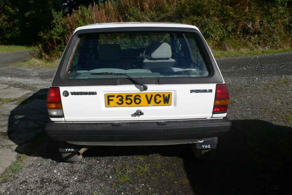

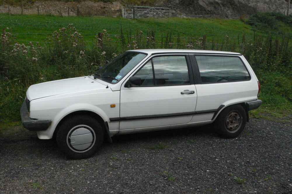

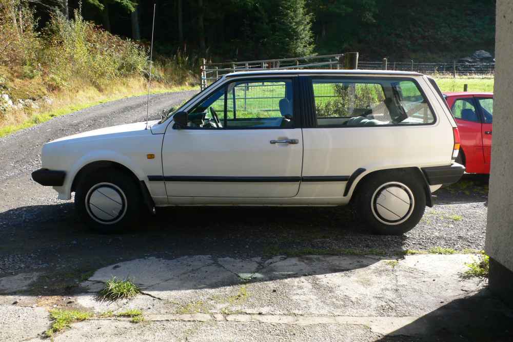

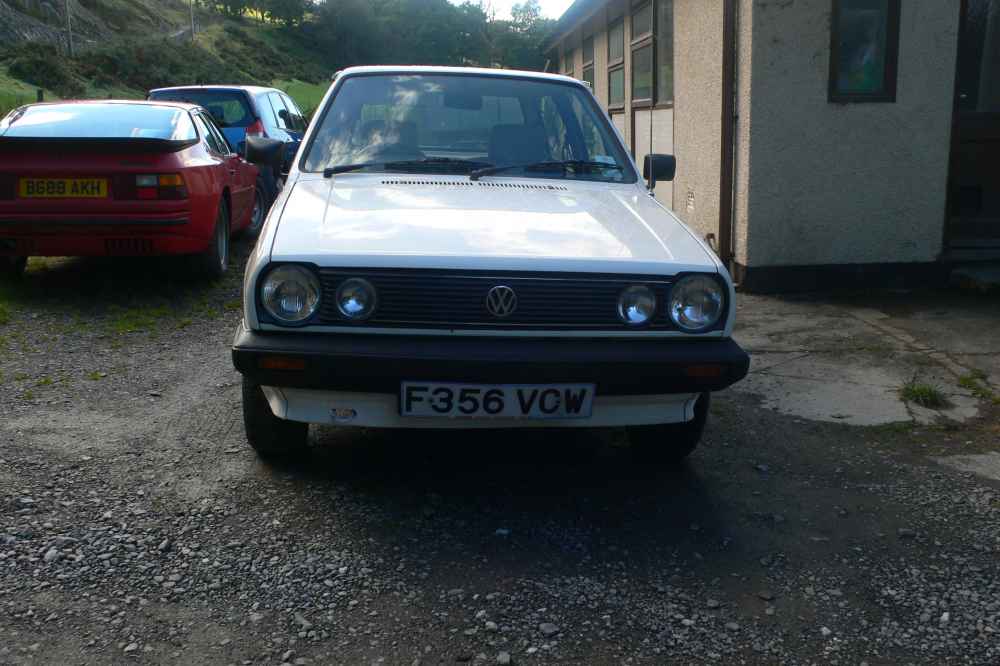

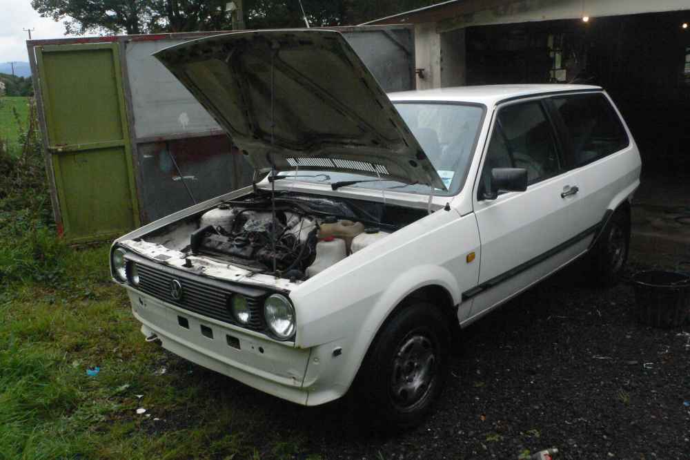

I have been given an 'F' reg'd Polo Mk2 by a friend of a friend! It was originally owned by the lad's mother (Lad; ha ha. He's about my age! i.e. ancient) and has been stood on his drive for about 8 years. He wanted it moved as he and his wife are selling their house to downsize. So went and fetched it with the Landrover and trailer. It starts and runs, but requires carburettor overhaul and a new carburettor flange. Brakes are seized, but all in all, doesn't look too bad. It's a Polo C with 84K on the clock. I've ordered the carb bits off ebay but in the meantime, it's now in the garage awaiting a good examination and whatever work it requires. The one thing that it is short of is an air cleaner. If anyone has got one to suit a Weber 32TLA carb, please let me know and we can do a deal. Otherwise it's all there.

    It runs! New cambelt fitted today. Carb now set up. Choke works properly and I sorted out the thermostatic fan by cleaning all the contacts in the fusebox. The spin off is that a number of the electri

Lucky you getting a freebie. Looks to be in good condition too.
Nimal
Nice car, same as my daughters. Whats plans do you have for it?

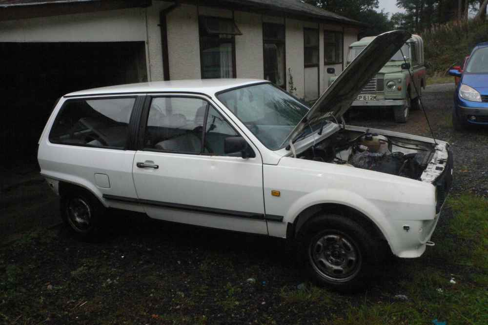

Just been having a good look round it. Seems to be reasonably sound underneath. Has had a new sill on the OS. Has upgraded front brakes with ventilated discs. Off a Polo GT perhaps? I don't know what my plans are for it at the moment; it depends on what I find is wrong. If, as I suspect, it is reasonably sound, I shall probably recommission it and use it for a bit to give WOH a bit of a rest. It looks to sound to require a full scale restoration and I am not into concours cars that I'd be terrified to take out.
It certainly needs a good overhaul, but the only rust I have found so far is in the battery box. The front brake calipers are seized and the driveshaft boots are perished, but the engine sounds well and the clutch and gearbox appear to be all right so, all in all there is nothing that can't be dealt with. perhaps I should start a blog and chronicle it's resurrection. Anyway it's now 8.30pm and I am packing in for the night.

It runs! New cambelt fitted today. Carb now set up. Choke works properly and I sorted out the thermostatic fan by cleaning all the contacts in the fusebox. The spin off is that a number of the electrical issues have been sorted out as result. Stripped and cleaned the number plate lamps and fitted new bulbs and they both work now. Stripped the rear brakes and found them in good order. Just needed cleaning and a little copper slip in the right places. The cylinders were free and not leaking!  Considering that it has been standing for 8 years its remarkably good underneath. Even the brake pipes are sound!
Still more work to do: The rear windscreen wiper motor is seized, so I shall strip that down to see if I can rescue it and I haven't looked at the dashboard lamps yet.
In fact, the car is in a far better state than I envisaged when I picked it up. Might even be ready for MOT next month.

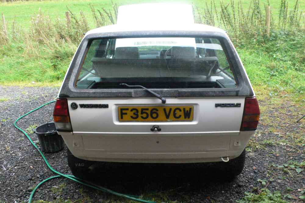

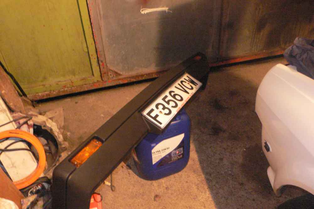

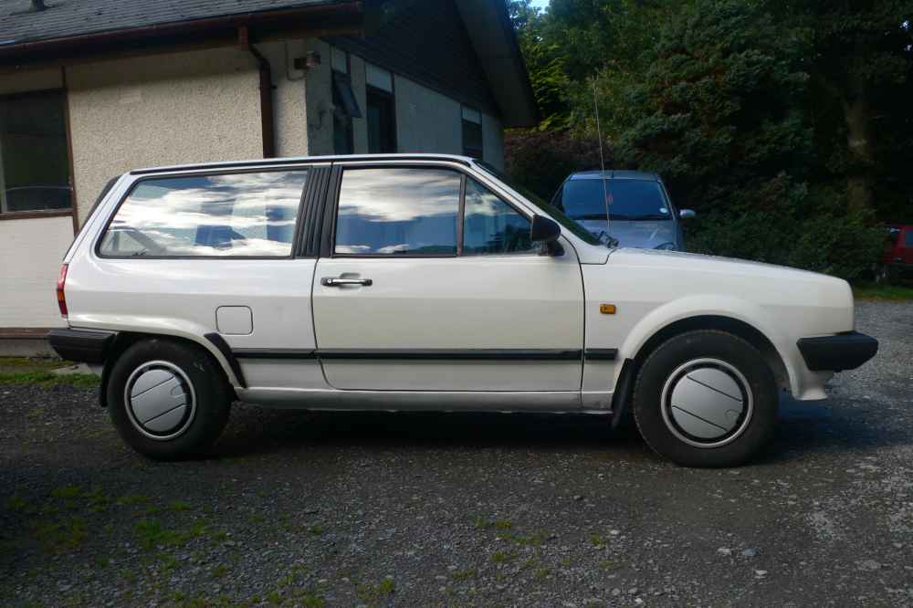

Now it's running I tried it down the track from my house to the road and back today. About a mile there and back and it appears to drive well. So I took the bumpers off it and gave it a good bath. Got all the moss, lichen, dead leaves and other detritis off it and have inspected it  to see where the coachwork needs attention. It has been white stonechipped from the black trim line down so no rot, but the stonechip has peeled in places and needs to be treated and repainted especially around the rear wheelarches and on the front panel by the towing eye. The driver's door is the worst panel, with a dent about the size of a penny just under the mirror and a bit of rust bubbling along the top by the window. I may have to paint the door. The label with the paint code is missing but I suspect that the car is alpine white (paint code L90B) but any suggestions will be gratefully received. Photos attached of what it looks like clean. I should have done 'before and after' photos but didn't think about it until I was half way through. (I shall blame Dr. Alzheimer for that.) The inside of the bonnet appears to be covered in a thin coat of waxoyl so I shall fetch that off with some petrol, but not today.
Still pottering with the white Polo. On Thursday I got the rear window wiper to work. The shaft had seized in the bush that pokes out of the back of the car, so not a big fix. Just required a bit of patience. Tidied up the two areas where the stonechip had peeled but no white stonechip which I got on Friday. Gave the rear window surround and the bumpers a good coat of black trim wax. Made a list of the bits that I need to get and ordered some of them from ebay.

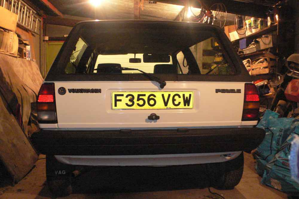

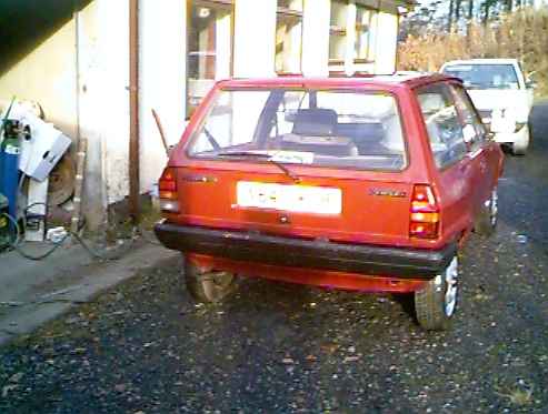

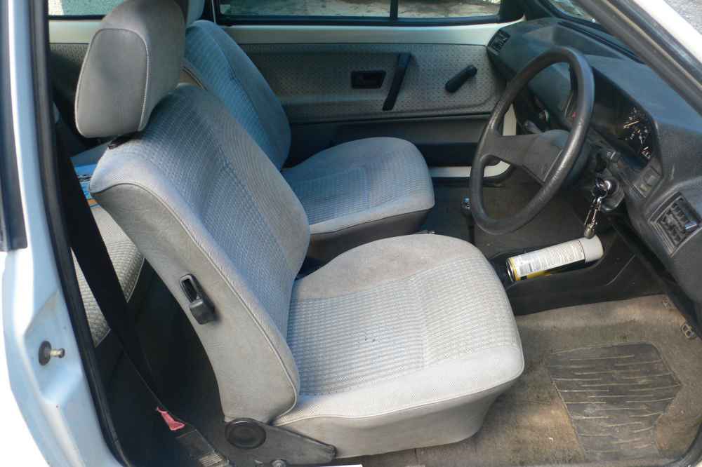

Today I had to go up to Liverpool and then over to Anglesea. Did 200 miles in the red Polo so I have just pottered this evening again.  However, I have managed to get the interior lamp and drivers door courtesy lamp working. With the car in the garage, I cant get the passengers door open far enough to get the courtesy switch out, but I can sort that tomorrow. I have also touched up the rear arch and the front panel with the white stonechip and fitted the rear bumper. The mudflap clips that I ordered a few days ago arrived yesterday, so I shall put the offside rear mudflap back on tomorrow and will sort out the air cleaner and a few other niggly jobs. Might even have a go at the drivers door and see what horrors lie under the bubbling paint!
Photos of the rear of the car with the newly blacked bumper and trim and of the front bumper after its second coat of trim wax:

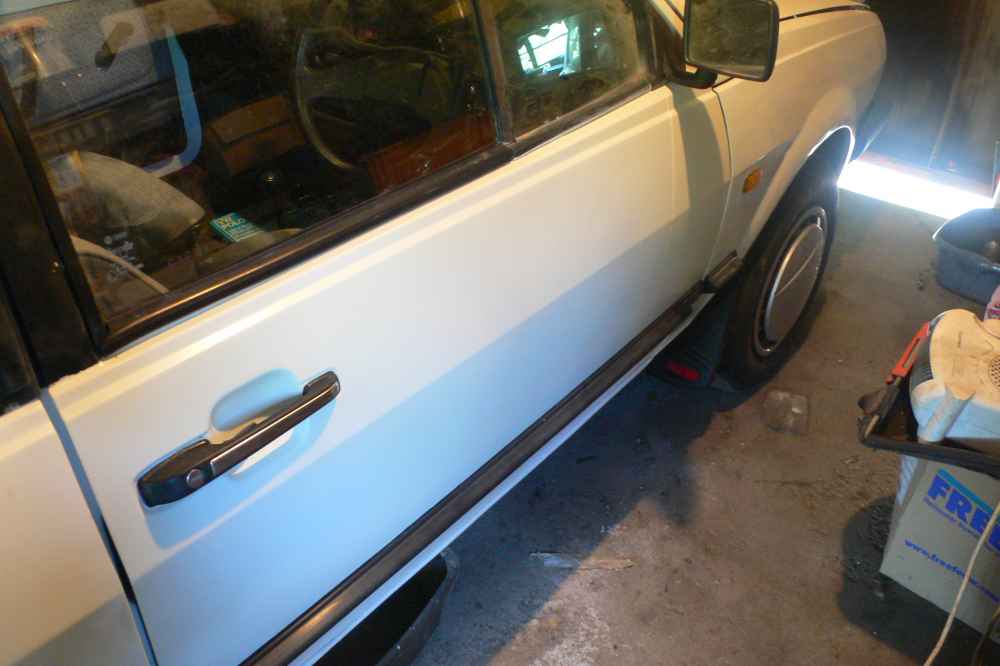

The recommissioning work continues. The major job this week has been to deal with the dent in the drivers door. As predicted, by the time stripped the door casing off and got the worst of the dent out as it was quite deep, I ended up with a large area to fill and smooth out. So I have painted the door from the black trim up.  Sorted the co;our code out. If all else fails, look in the service book. So as I had to take the Land Rover for MOT in Wrexham, I went via my favourite paint suppliers in Oswestry and bought two spray tins of Alpine white L90E. Unfortunately, it was base coat, a fact that the chap in the shop didn't mention. However it was a pretty good match but had no shine. As I was doing this at 10.00pm last night it took some working out what was wrong. So I read all the small print on the tin! Fortunately, I had a couple of tins of clear laquer, so used that. The trouble is that the laquer has given the paint a slightly straw coloured tint but it's not so bad that I can't live with it and, all in all the door is a damned sight better for being repaired.
Got a new aerial,  reversing lamp switch and rear tailgate strut yesterday whilst in Wrexham. The strut is now fitted. The air cleaner hot air trunk and dashlamp bulbs arrived in the post yesterday, so they have been fitted this morning. I shall fit the aerial and reversing lamp switch later today and hopefully that will be the end of all the niggly jobs. This week end, if the weather is kind, I shall give it a good wash, cut and polish it and clean up the interior. Might be ready for MOT next week. Fingers crossed!
Been working on the Polo in fits and starts since last Thursday. Got the new aerial on and have cut and polished the paintwork. In the daylight, the door is definitely the wrong colour but I can live with that in the short term. Spent Saturday afternoon cleaning the interior and getting all the black mould off the seats and generally tidying it up. Found that the cigarette lighter element has seized in the socket, so i have ordered a new one which should be here this week. Otherwise it is now ready and is booked in for MOT this coming Wednesday. Photos of how it looks now follow:-

WoW that's scrubbed up nice :)  I see what you mean about the drivers door, but that can wait.
Thank you Nige. I have a little work to do on the red Polo, so I shall press the white one into service for a few days. I intend to take it to the paint place and get them to match the paint to the car. Running it will also allow me to do any final snagging.

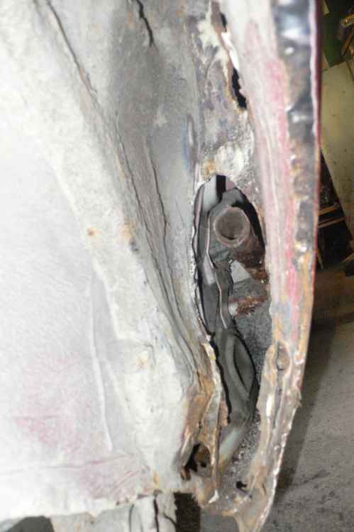

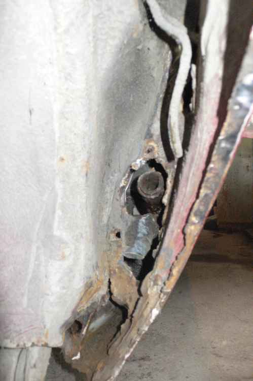

Took the Polo for MOT today. Alas, it failed on two pennies worth of welding to be done to the off side inner sill just below the fuel filler and the tester wasn't happy that the tyres showed some surface cracking. Wasn't running quite as well as it might on the way back. I suspect that it has developed a vacuum leak on one of the pipes from the carb. But not to worry. All eminently fixable. Got to have the tank down so I shall make sure there is nothing floating around in there just to make sure.
nice project there.
if it's rusty below the fuel filler area, be prepared that it might not just be 2 penny's worth!! there is a steel pipe inside which sets the whole area going with rust. some call it the pipe of doom.

The radio cassette player works a treat. Its a Panasonic 493 and looks to have been fitted from new.The speakers are shot though, so I have ordered a pair of 6x4 Alpines. I've got a pair in my Porsche as they are the only ones shallow enough to fit the front doors, so I know they are good quality.

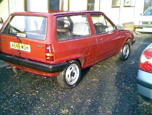

I shall tax it tomorrow and have the red Polo off the road for a bit of TLC. Running it should ginger up any lurking bugs and I shall have the opportunity of getting it on the ramp at work and cleaning and waxoyling the underside.

Finally, as everyone likes pictures, here is one of the two Polos taken after I got back from MOT. "Babes in the Wood"

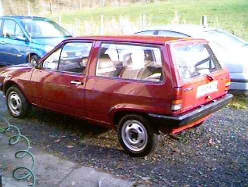

I have replaced the cigarette lighter. The element had seized into the original one. Although both cars are Polo C's, the red one, being a 1983 model is the real austerity spec: no cigarette lighter, no clock, only one courtesy lamp switch etc. The white one is better equipped (just).

Oh yes! I treated it to some cheap black overmats yesterday too. At least they protect the carpets.

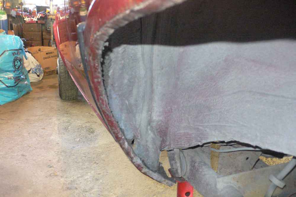

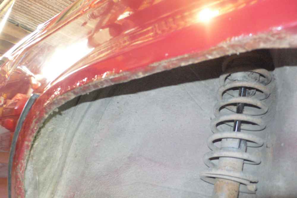

I have now run the white Polo for over 300 miles in the last week and, apart from replacing the radiator, because it was leaking from one corner, it has behaved itself quite well. In fact, well enough to be my daily transport whilst I tidied up the red Polo's coachwork on the rear lower panel and rear wheel arches..
About a weeks worth of work or so i thought!
Some while ago, I made a little cover to shield the filler pipe from the worst of the crud, having had to deal with a leaking filler pipe a couple of years ago. So i took it down to get the tank out so as to give better access to the right hand wheelarch. I noticed this little hole behind the filler pipe. I will let the following pictures tell the story:
