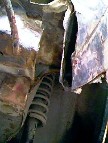

To repair all that has been revealed is going to be a major job! What has made it worse is that someone in the past has bodged some of the area with bodyfiller I dug tons of the stuff out at the bottom where the rear beam attachment fits as well as at the top by the filler aperture. I fear that I do not have the skills that some of you lads out there have when it comes to this sort of repair. Indeed, as the full extent of the rot revealed itself, I began to think that the repairs needed were beyond my pay grade. However, it is not going to fix itself, so I'd better get going!

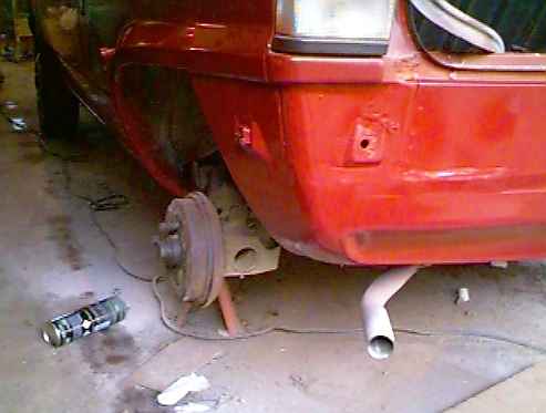

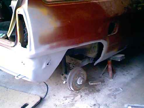

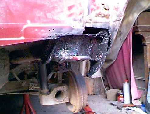

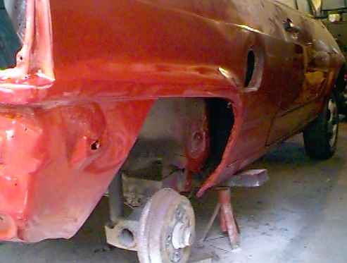

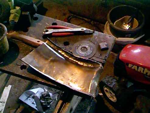

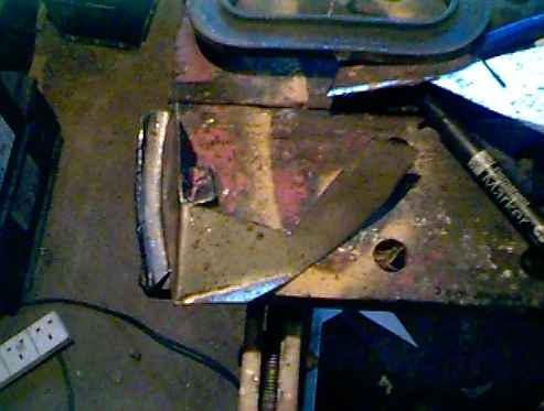

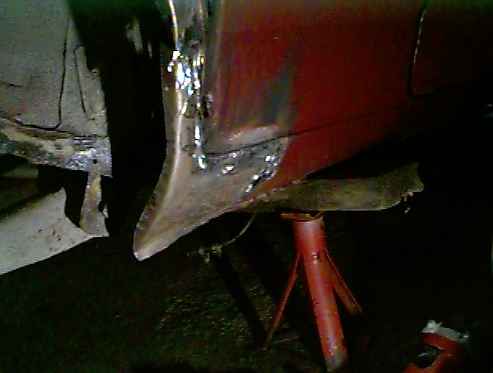

Anyway, since my last post on 20th October I have managed to get to grips with the horrid hole in the offside rear wheelarch. On the way round the end of the sill was found to be rotten. Someone (before i had the car) had welded a patch onto it and all the sill underneath had rotted away leaving the patch unsupported. So I had to make a panel to repair the lower front of the wheelarch and the last 6 inches or so of sill as well as a panel to go into the end of the wheelarch and a panel to go on the inside of the rear quarter panel. The recently acquired panel beater's sandbag has been a real godsend!  My nephew kindly lent me his MIG welder as he said it would be easier than using arc. having never used a MIG welder before i struggled! Eventually I got to grips with it but i cant pretend that the welding is neat and tidy, but all the panels are well stuck on and a coat of seam sealer makes good welders of us all.
I have still got to sort out the lower rear panel. Fortunately I have bought a complete panel from VW Heritage (£33 with the postage and packing, which will save an awful lot of work, so that will be the next task. So more blogs to come.
Any way here are some pictures. Sorry for the quality: they were taken with my Kodak DC20 which was the first commercially available digital camera back in 1996. Picture resolution 783X493 pixels! But the files are small for uploading.

Thank you Ivw2many for your kind remarks. You didn't see the panels (or the welding) in the flesh.I can't pretend to be a panel beater but it is amazing what sheer desperation can drive one to achieve. At least it all could be made to fit. i have seen one or two blogs on here showing some lads are capable of some truly stunning work. I'm afraid that mine is nowhere near that standard.  It has been a steep learning curve though as I have never done anything like this before. U tube has been especially useful. Amongst many other things, that's where I found out that right-angled circlip pliers make a good tucking plier.

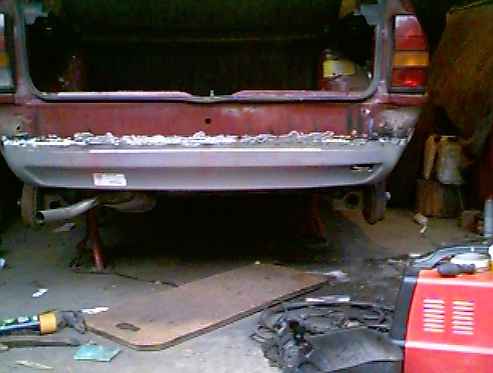

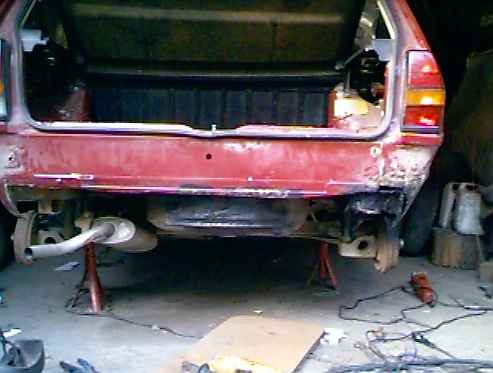

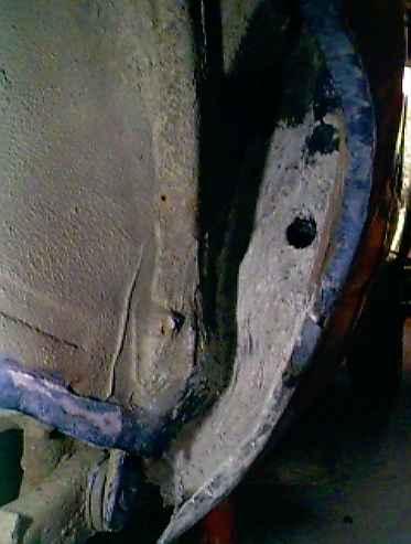

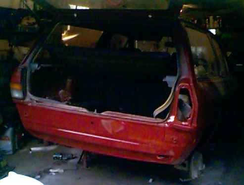

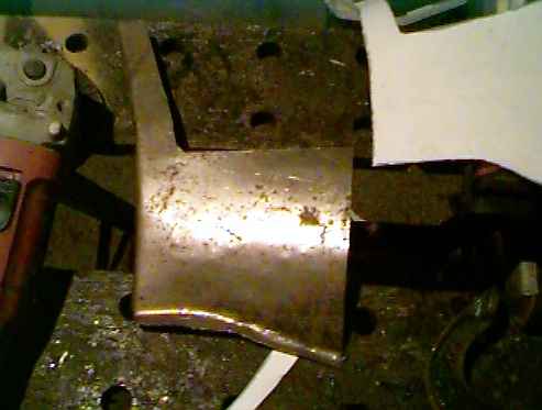

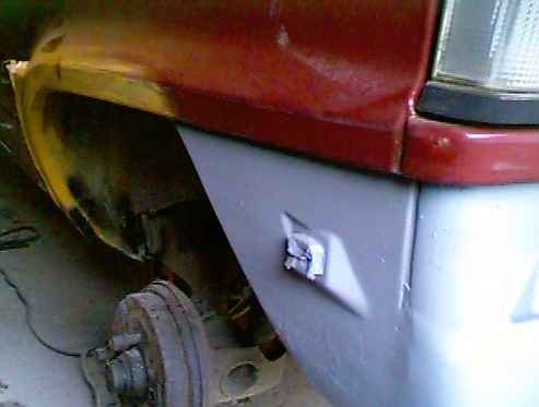

Having sorted the front of the rear wheelarch out, I turned my attention to the back. The offside rear corned turned out to have rotted badly. In fact the rear towing eye and and the little square bracket that is supposed to be an axle stand support were only attached one side, The rest of the support panel wasn't there anymore. So, I have made a new section of wheelarch, both inner and outer, and strengthened the rear floor support panel as best as I can. I have also (today) fitted and welded in the new rear lower valence. Hopefully, that is the last of the welding (I hate welding!) and it will be now just a question of doing the requred tidying up and painting.

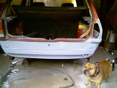

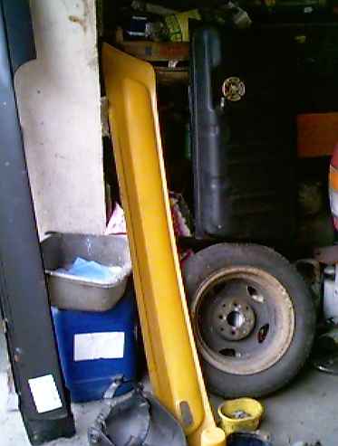

Last week was a bit of a write off as I had to go shopping on Wednesday and get my trailer ready for Thursday, when I went to get hay for my horses. Last weekend, I had visitors, so it has only been this week that i have managed to get on with the red Polo. However, I have achieved quite a bit, considering. All the tidying up and filling has been done, and I would have been happy to have got the primer on today. As it happened, today was quite nice, but cold, but with the assistance of a fan heater to keep the chill off the garage, I not only managed to get the primer on, but the colour coats as well! Still go to put the tank back in and couple up the handbrake, but I thought I would leave that till the weekend to let the paint harden. I am aiming to get the Polo back on the road next week as the white Polo has now done over two thousand miles in my hands, needs a good clean inside and out (it is a dirty grey at present) and a nearside wheel bearing. Other than that, it has gone well.
Photos: Please note that my indispensable assistant appears in one of them. As everyone knows, you need someone to chase the jack wheels, bark at the power tools, try to catch the welding sparks and lick your face when you are lying under the car!
For some reason, the pictures are in reverse order. The top three are the last ones!
