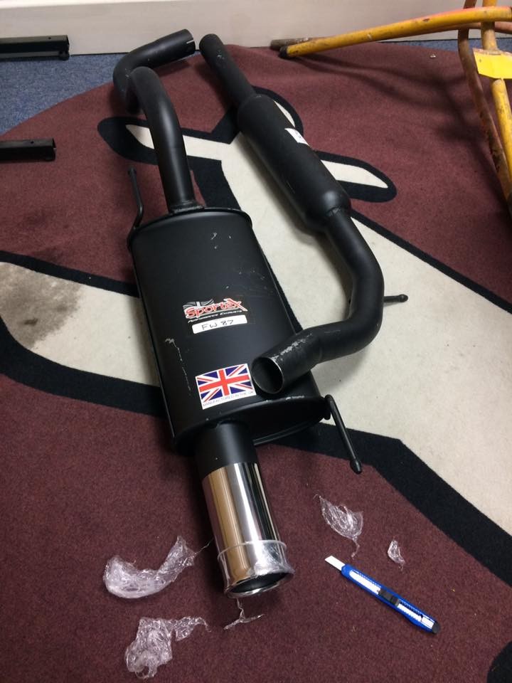

The new exhaust is getting fitted tonight as the oem system was so rotten that after I clipped it on a curb it split in 2 places!
It's a Sportex cat back with 3" tail pipe.

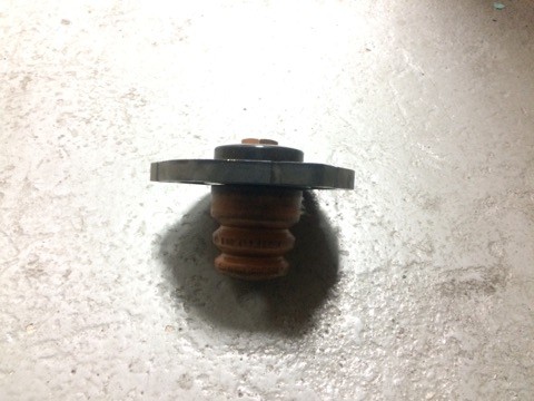

At the same time, I also have a set of TA Technix dampers to fit that are supposedly 30mm shorter pistons and 30% stiffer than oem.
That should help loads as currently it's bottoming out with the CNC top mounts fitted and the 40mm springs on.

anyway, photos of last nights progress.
It had bottomed out on the OEM shocks so bad, the bump stop was stuck to the top mount.
Got it all stripped down and transferred everything across to the new shocks, all refitted.
It actually felt firmer than it did before even still on the axle stands.

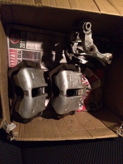

Doing a bit of a refurb on my brakes at the moment so gone back to the standard 1.4S calipers.
Got my GTi calipers and G60 carriers off for a strip down, repaint and a regrease of the sliders and new seals on the pistons.
Once that's all done, I'll be getting hold of some braided brake lines before refitting the whole lot in 1 hit
