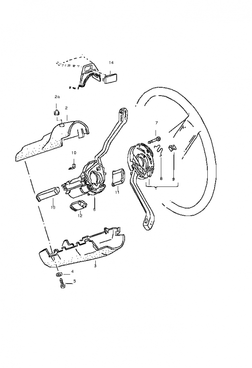

Screw/fixing size for steering column surround.
I removed the surround for the steering column/ignition a few months ago when tracing a electrics issue.
I've now lost the screws (3No.) so I need to source some replacements, does anyone now what size they are?
oval head panel screw
ST3,5X13-C /
