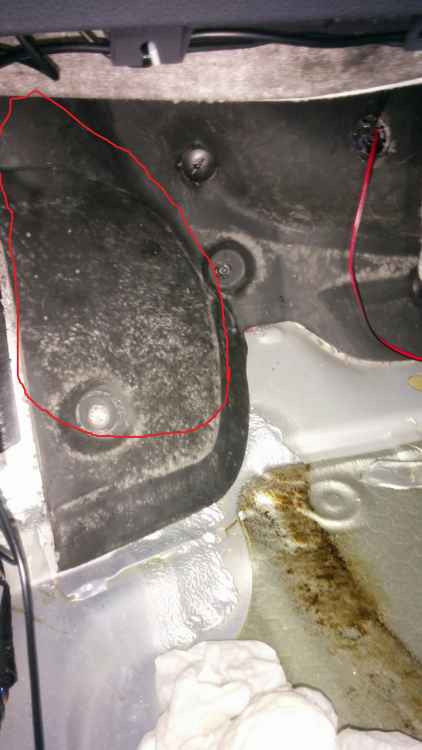

Last week I noticed a horrible smell when I sat in my 9n3 polo. I managed to track it to underneath the carpet on the front passenger footwell.
I thought it was because of a water bottle I had in the car with a while so I gave the carpet a chance to dry well today
I sat in my polo today only to find I got an upgrade in my car a freaking swimming POOL. I am having difficulty tracing the leak.
I am able to feel that some of the insulation is wet in the front left corner and appears to be flowing down from here(circled red in photo).
I thought it was perhaps the unused hood seal that I took out 3 weeks ago but the insulation behind it is bone dry.
Does this type of polo have spots that are prone to leaking.
