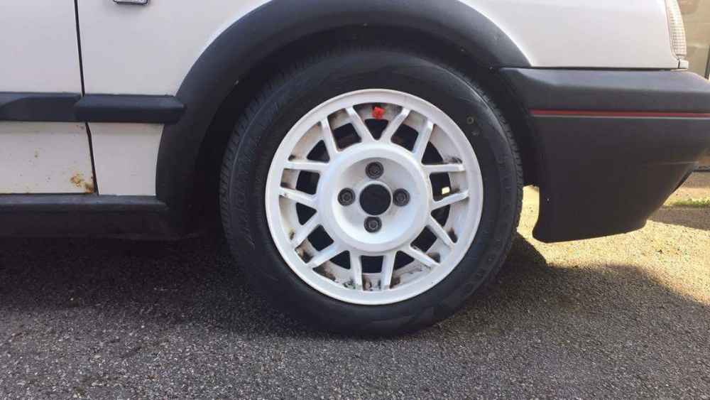

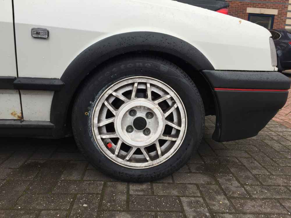

Thought I would share a couple of pictures of what your wheels should look like after fitting ARB blocks the right way compared to the wrong way.
Yes I made this mistake ?
But it is a easy one to make hope this helps
(ignore the filthy wheels)
picture of wheel sitting towards the rear is wrong the ARB blocks need to pull the wheel closer to the front of the car this also gives better clearance for manifold .

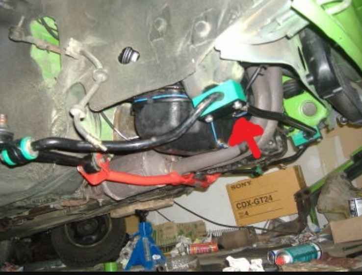

  • Thought id add a few more pics pulled of google images, hopefully help a few people out
