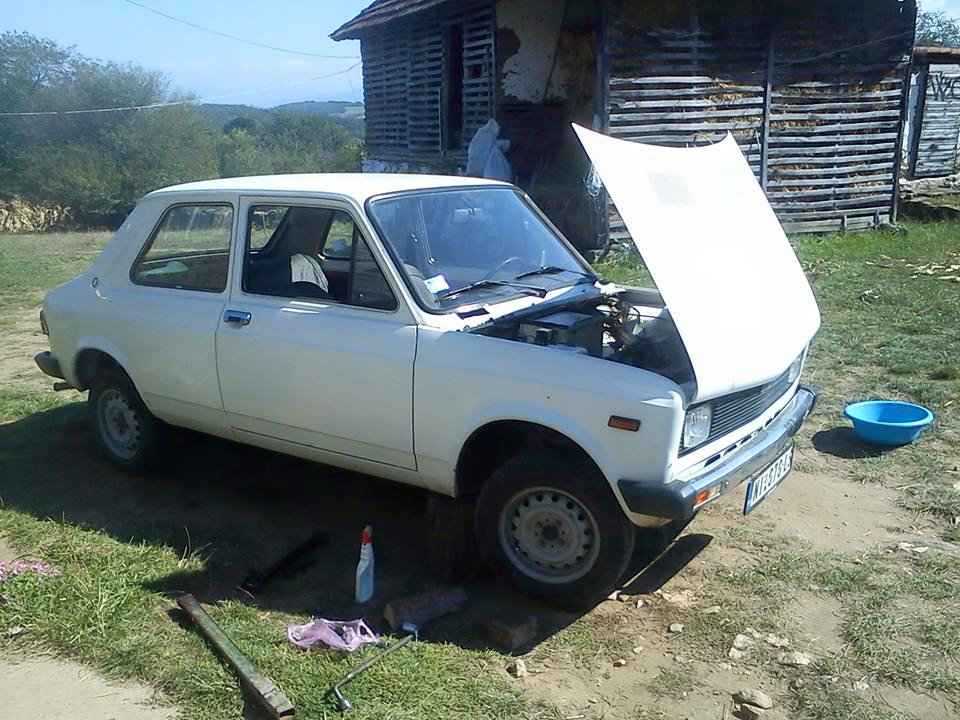

I bought this old Zastava/Yugo few days ago. I never meant to buy it, but it took my heart. It is Fiat 128 rally based hatchback.
I never had courage to put bike carbs on a Polo. So I decided to try it on Zastava, and to see if it works. I like that this is the best bike carbed forum on the net.
I also have twin Dellorto 40 dhla carbs, but they are not that interesting to me as bike carbs..I might sell them.
Zastava is 1.1l engine (1116ccm),  44 kW @ 6000 rpm /55hp,  83 Nm @ 4400 rpm . 0-100 around 17s. It has one barrel carb as standard, so I wanted to get some more performance out of the engine.

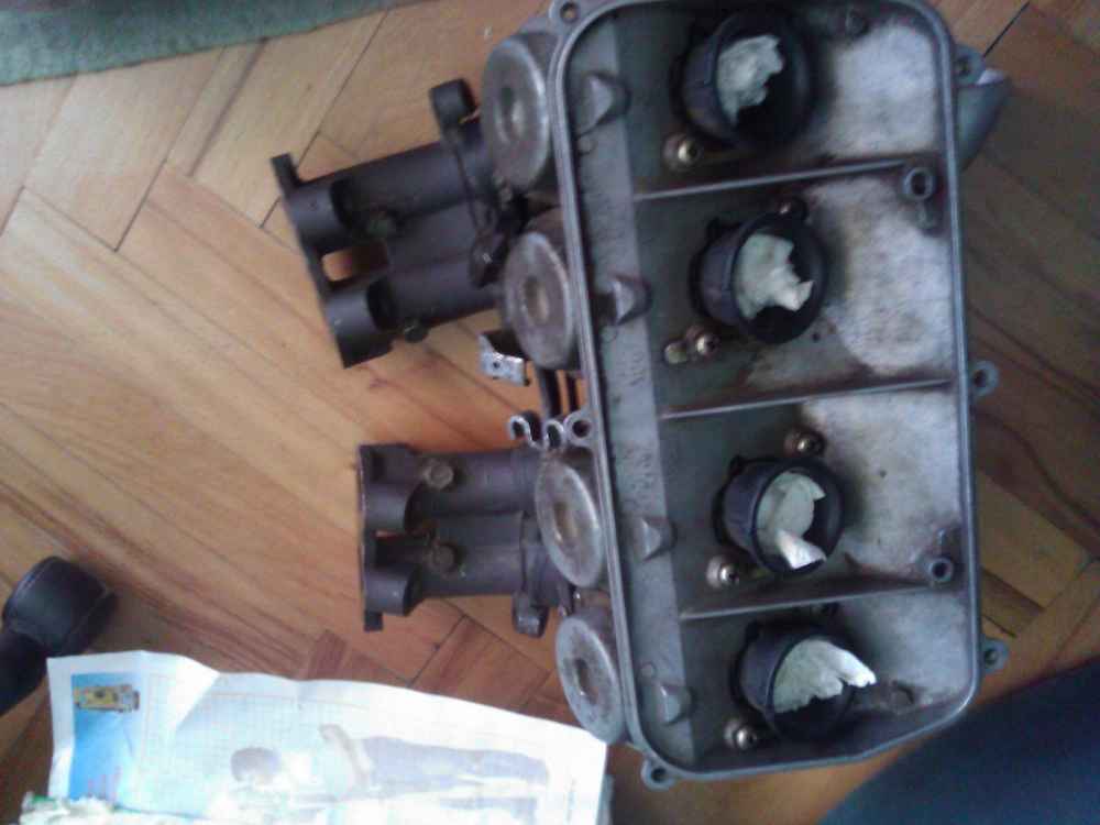

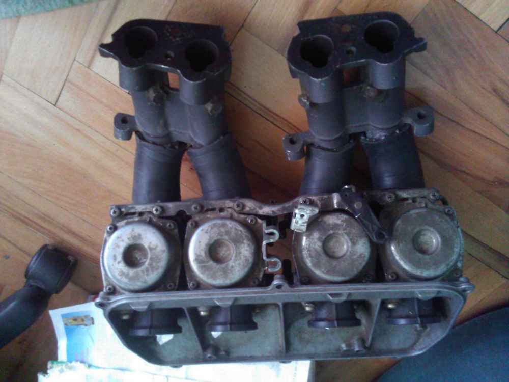

I tried to mount Honda CBR 600 F1 carbs on it. I made manifold from Yugo Efi manifold, it worked good. Had few problems, I will write them later.
Hope that you will like the car.
Here some photos when we mounted the carbs, and some when I bought the car. I bought it for a very good price, and it is in very good condition.

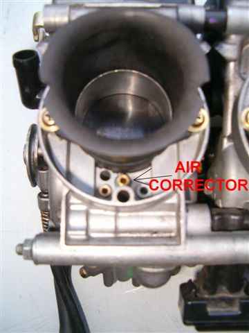

I had problem with the carbs, I need to change O rings. It had good idle, but vacum pistons were vibrating, which was strange to me. I tried carbs without air filter, and I didn't sealed air corrector-as shown on the photo. It was so loud, and had bit slow throttle response.

I opened carbs today, they had 2x105 jets and 2x108. In standard they should have 4x105 jets. That got me bit upset, so I will redrill them to 110, to be sure to have four same jets. Idle jets are 35 standard, diffusers  are 32mm. And then I will try it again. I will post carb photos tomorrow.

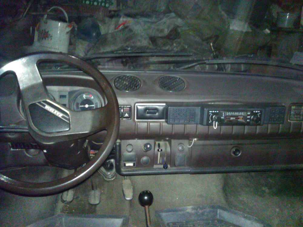

This is the best dash photo that I have. I took it when I bought the car. It has original radio. :)

Could anyone tell me how to see where is air corrector hole on those carbs?
