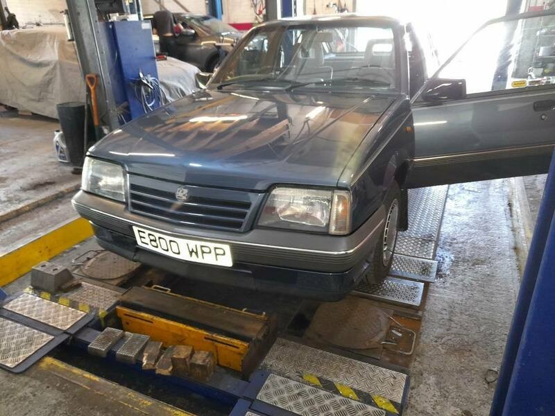

Bough this in June last year
950 hours later -
If anyone's interested, I can stick up a build thread?
