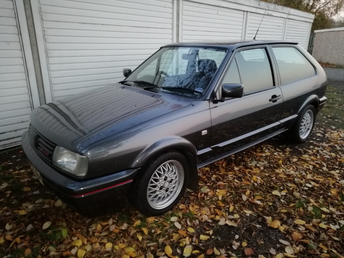

On ‎02‎/‎04‎/‎2017 at 21:19, sleag40 said:
This came out of hibernation today - just took some fuel and a mild rinsing by the DVLA.
Still puts a smile on my face. 🙂

On 06/07/2019 at 23:22, Jamie/Arosa said:
Your level of work is amazing! I wish I had the time and space for something like this. There really isn’t many mk1s about now.. I’m truly shocked to how solid that mk1 actually was! I was expecting to see more holes than Tiger Woods has 😂 I can’t say I miss my mk3 Cavalier to be honest, I wonder if they were made worse over the years as your mk1 was more solid than my mk3 10 years ago aha. Keep up the good work.
Many thanks! The mk1 had been garaged all its life - explaining the fantastic condition. The vast majority of them lasted 10 years or so,  mk2 + mk3s not much more - thankfully a few of these humdrum vehicles have avoided being fragged by being kept going by their usually elderly owners. 🙂

Thank you kindly! I have a new set of the standard wheel trims to go on when its finished, but as the wheels are a similar fitment to 4 stud VW I may run these BBS off one of my Polos from time to time.
Nice, the RA's aren't unlike the CD alloys if I remember correctly😉
