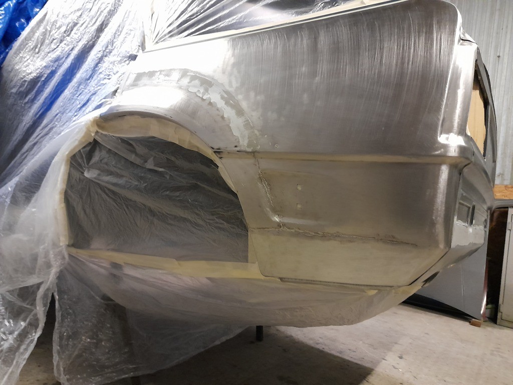

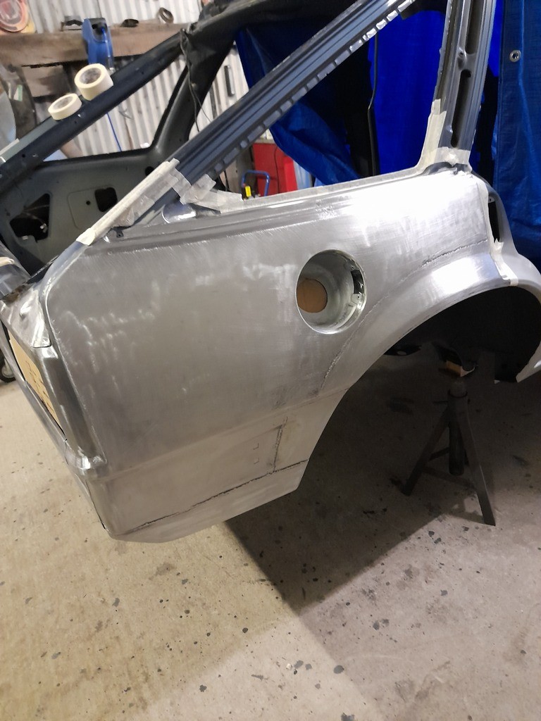

Disappointingly little progress this week. Started removing paint from the back end in preparation for getting the epoxy primer on there.
Daubed the rust pitted bits with Deox gel, then taped plastic sheet over it to stop it drying out.
It'll probably take a couple of applications to remove all the rust, but when it's gone, I can prime it.

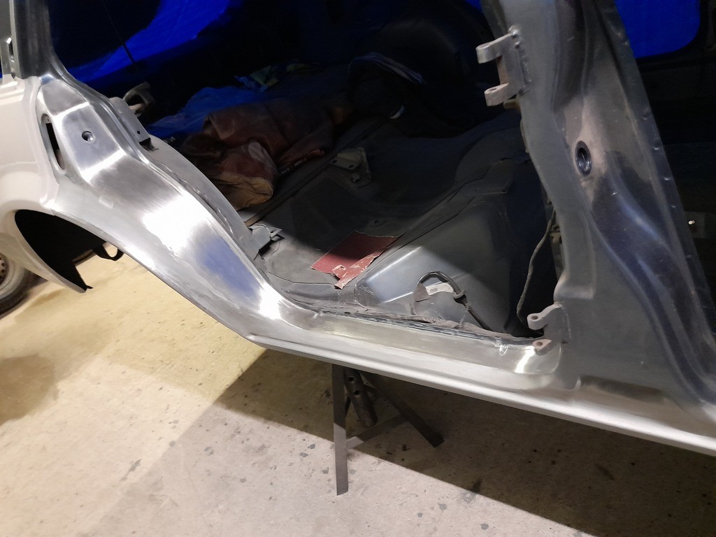

While the Deox gel does its thing, I made a start on getting the Nearside rear quarter cleaned back to the metal.
Most likely be splashing the primer about next weekend. 🙂

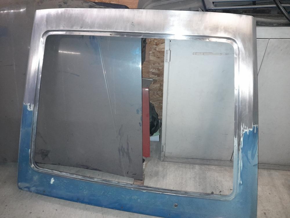

I got tired of bare metalling bodywork once the offside rear quarter was done, so decided to remove the scratched glass out of the replacement tailgate. This time less finesse was employed, and I used a hammer.
Doing it this way was a lot quicker than doing it properly - from swinging the hammer to finishing cleaning up the mess  took about half an hour.
Just need to wire wheel off the rest of the sealant - That can be done when I get round to priming it. 🙂

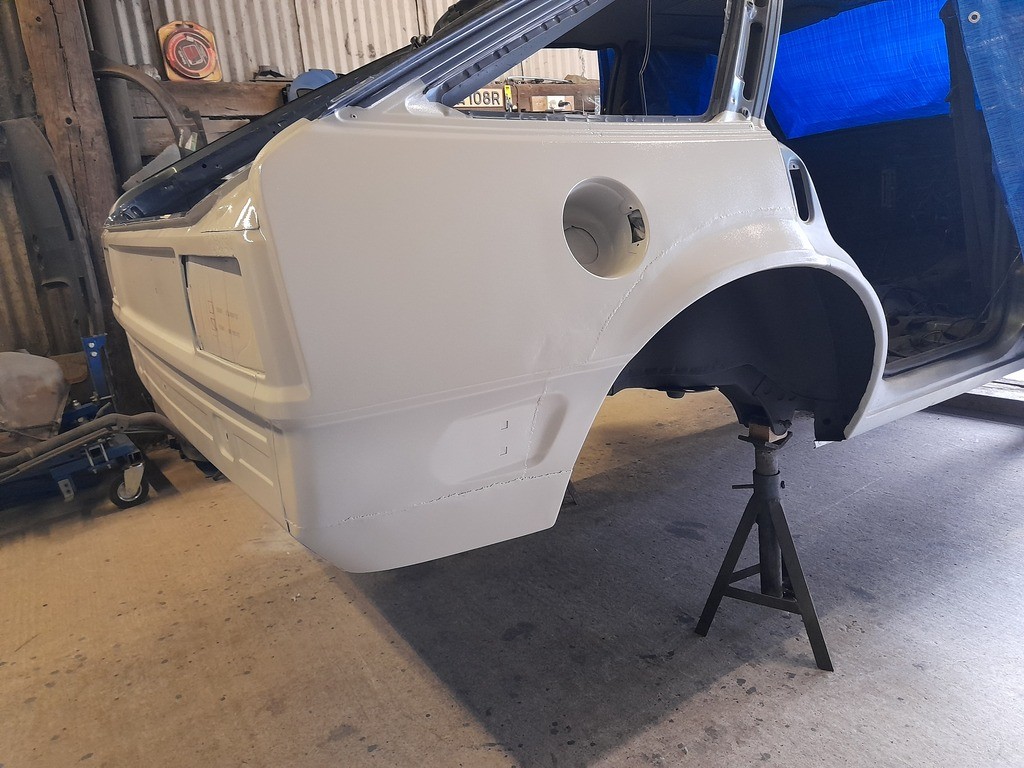

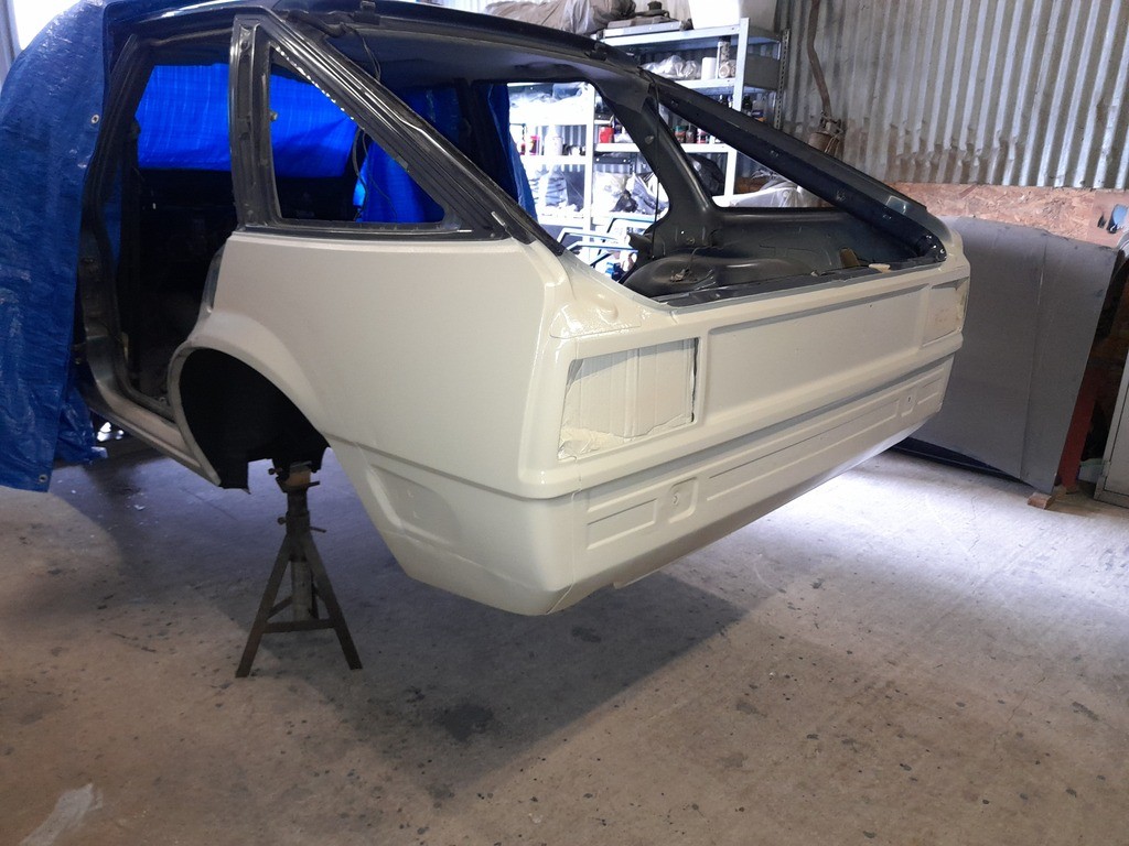

The Deox gel did its thing.
80 grit sand paper used to get a decent key for the paint.
Masking complete to ensure the stone chip stays fresh.
Epoxy primer applied - it was a bit thick, but got it to spray reasonably well.
Sills + door apertures next in line for this treatment - then engine bay and front valance  :)

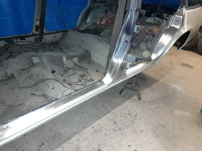

Got an unexpected bit of time on this today, so got stuck in to the offside door apertures/sills.
Hopefully I'll get this side epoxy primed at the weekend.
Edited by sleag40

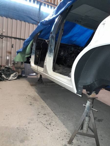

From Saturday-
Offside sill + door apertures now epoxy primed. It's a lot easier to see where filler needs to be applied now it's all the same colour.

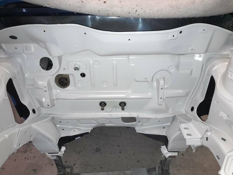

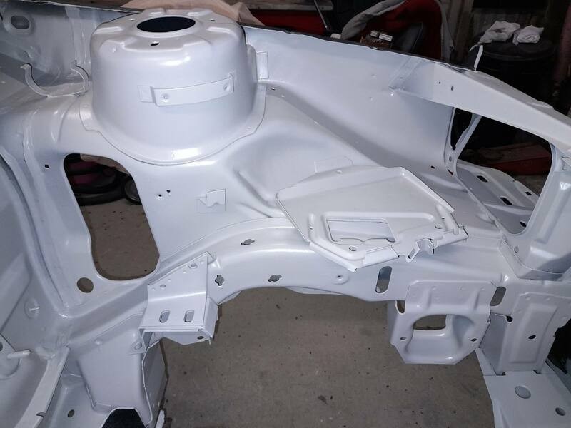

Run out of epoxy primer now, waiting on some more. Hopefully getting the rest of the bay done by weekend.

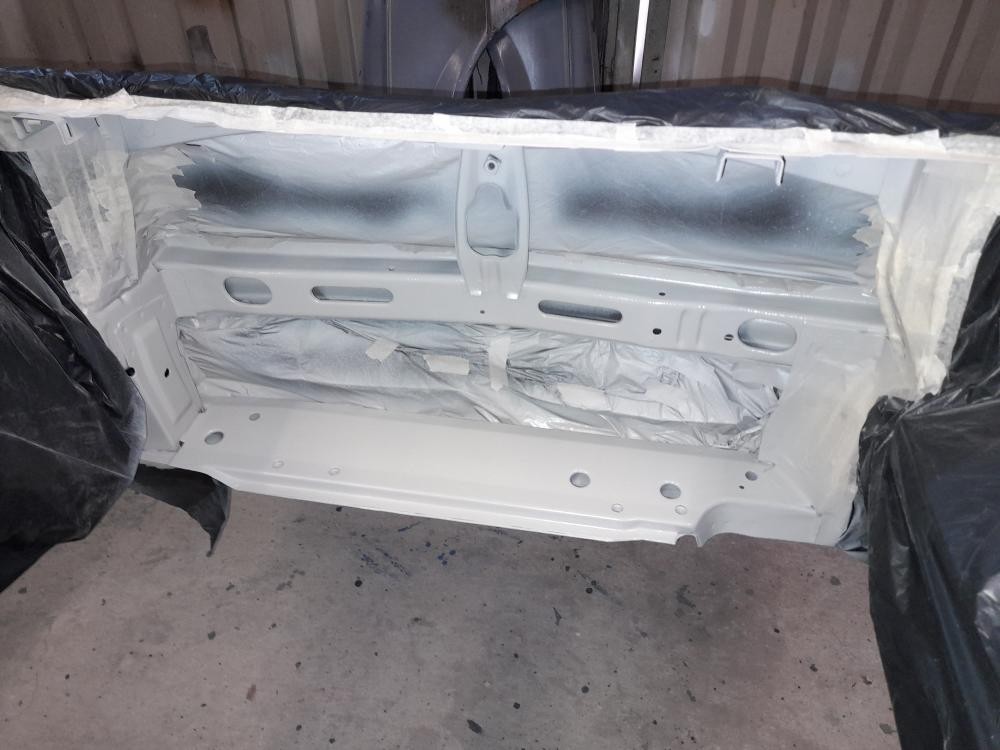

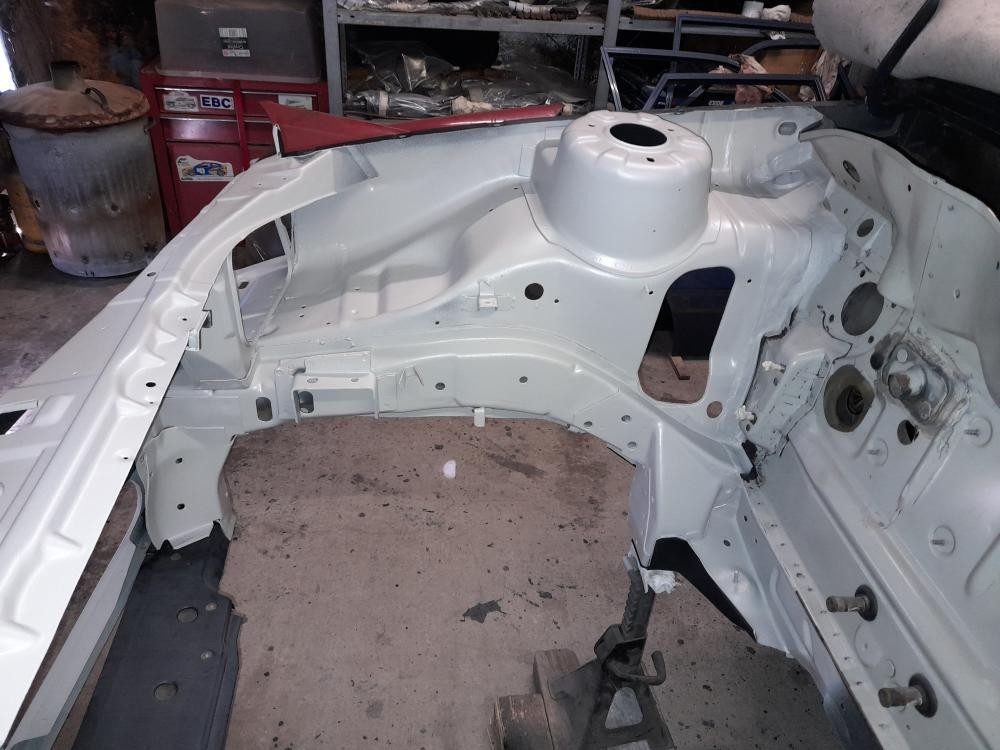

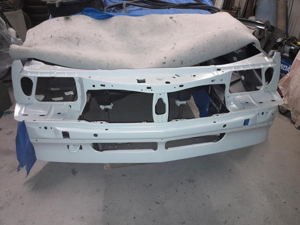

Many different jobs were competing for my available time at the weekend, but I managed to get the rest of the engine bay primed on Sunday.
20200920_162847.thumb.jpg.11abedfae06e15cd751bf71f7d0c464f.jpg.b9d4aef46ee15950fcb4153b9e48b4bb.jpg
20200920_162749.thumb.jpg.70bc174c82c0415c8ad28d41399a5264.jpg.6dbde214340312b8993c1bf043979c4f.jpg
This will all get a rub up at some point to flatten any brush marks  from the Hydrate 80, then primed again to seal any bits that get rubbed through. This should then be ready for regular primer + colour.

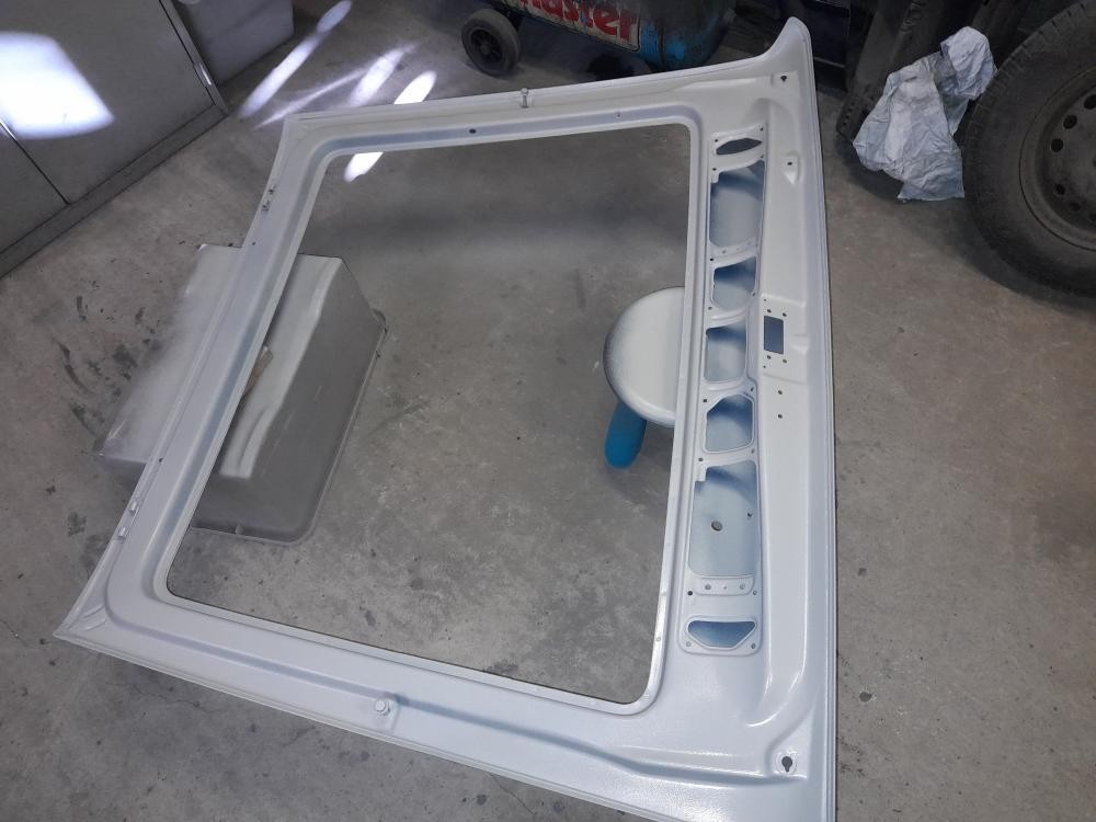

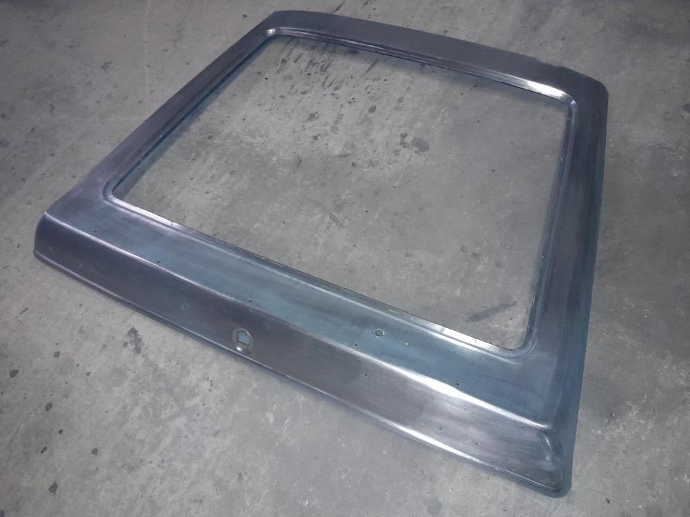

Tailgate stripped.
20200925_162445.thumb.jpg.470359af6ef3bde7e3d8e72df0e28901.jpg.abf31a5f9d8018e71241d1834cbf82e3.jpg
20200927_142321.thumb.jpg.8661f62384c2995c2900b5b46f30a2fd.jpg.39c1508b662719c1cc358a36780c2424.jpg

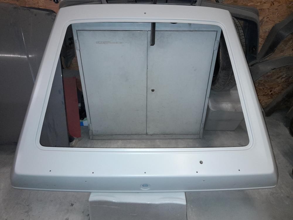

Then epoxy primed.
20200927_153532.thumb.jpg.872e535fbc7a7b994db1ee05b3c071f1.jpg.3d1e03f158381a601bcd367cffaed597.jpg
20200929_192648.thumb.jpg.3ad729fd9e729237ba3aae3fad70dca0.jpg.e0f70e861a643b1b3d9aa943cad3f6ee.jpg
Starting on doors next.
