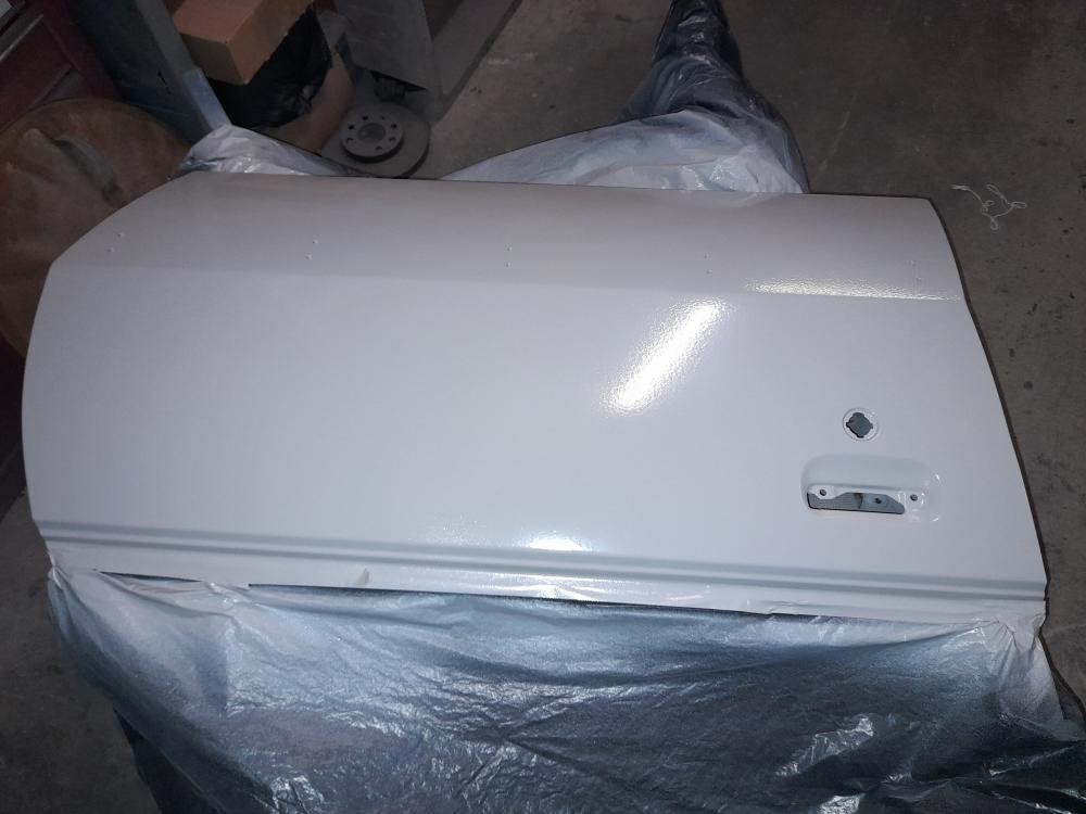

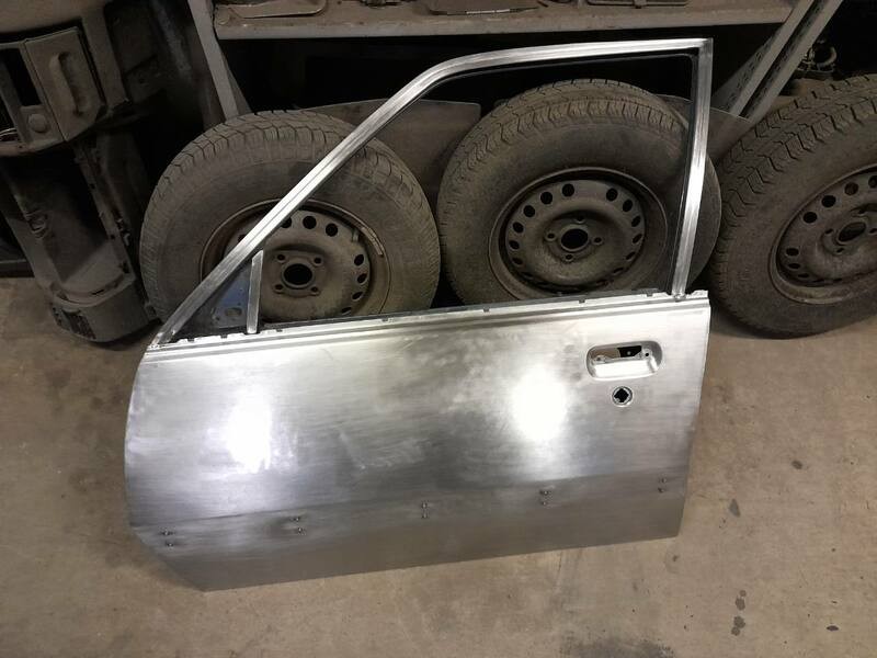

Not updated for a while - N/S/F door was stripped back to the metal.
20201004_141432.thumb.jpg.12c2288dd5b0349c8a0d261a996830d0.jpg.53744249d675d3cf3df7c8bcb2445a2f.jpg
20201006_185707.thumb.jpg.1fe0f2e43984ca0c2312799f270ba7c3.jpg.89dc157fba26818c8cdef2d8c87c1456.jpg

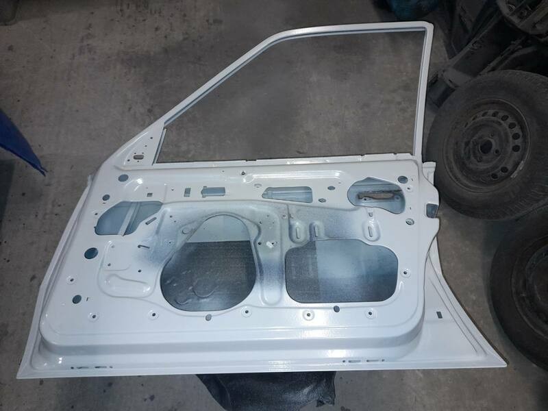

Then epoxy primed.
20201009_132955.thumb.jpg.ffb562a591d5651992c133250ee6c6ba.jpg.2c251bfe867df6531277eb8e42ed799e.jpg
20201009_132618.thumb.jpg.d2fd496fb03c7b10fc5ef844b904e827.jpg.3da664cdb6f6e13df8261f99350263fe.jpg

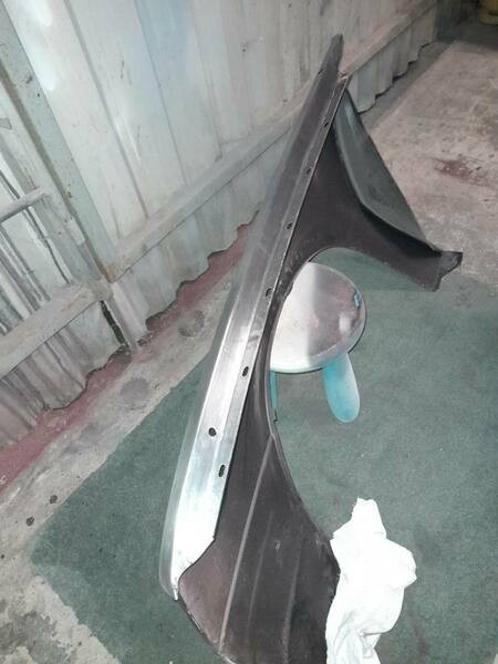

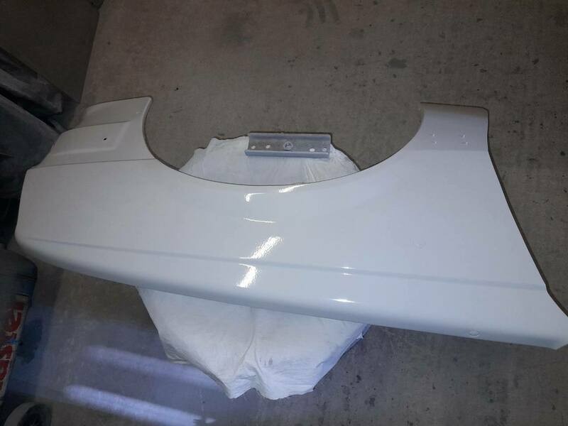

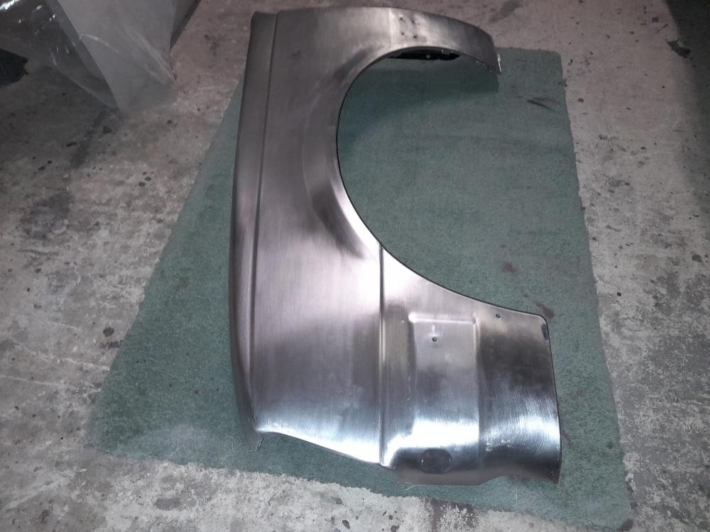

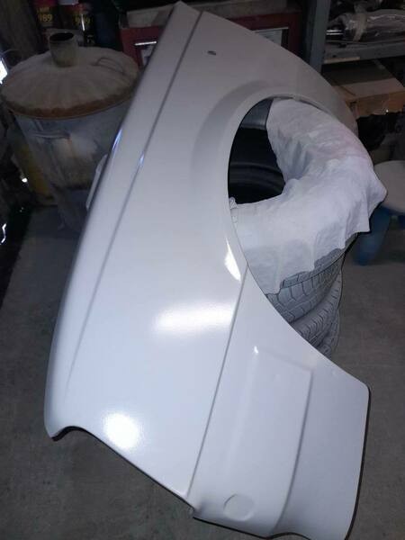

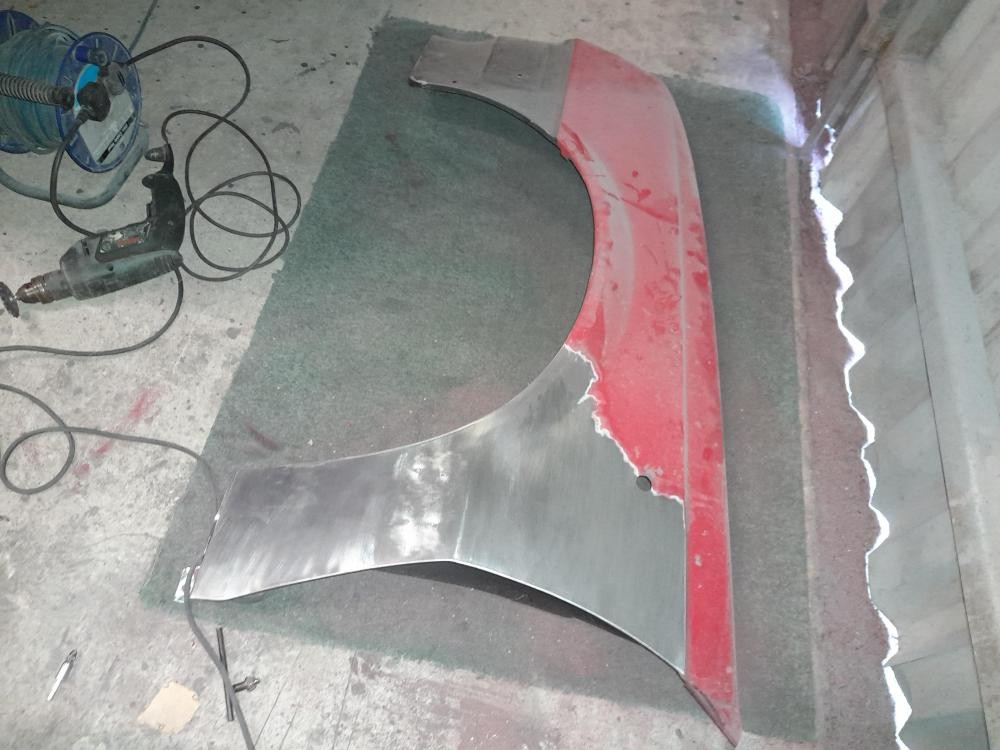

Unexpectedly got an afternoon in the shed today. The offside front wing had all its exterior paint removed.
20201022_183000.thumb.jpg.905039808932b73f96d0314a49228d5f.jpg.0d8974faee9fd25e4a65d00d2cdfefce.jpg
It had two thick layers of red on top of the factory paint, and was certainly a bit of a faff to remove, but the trusty poly abrasive discs got the job done. A wire wheel attachment on a drill sorted the tricky bits that couldn't be done with the disc.
20201022_182751.thumb.jpg.46e2e608353f0ca3958976f0a65f02ad.jpg.80fa2bc637ff71a314b31ec1c798e493.jpg

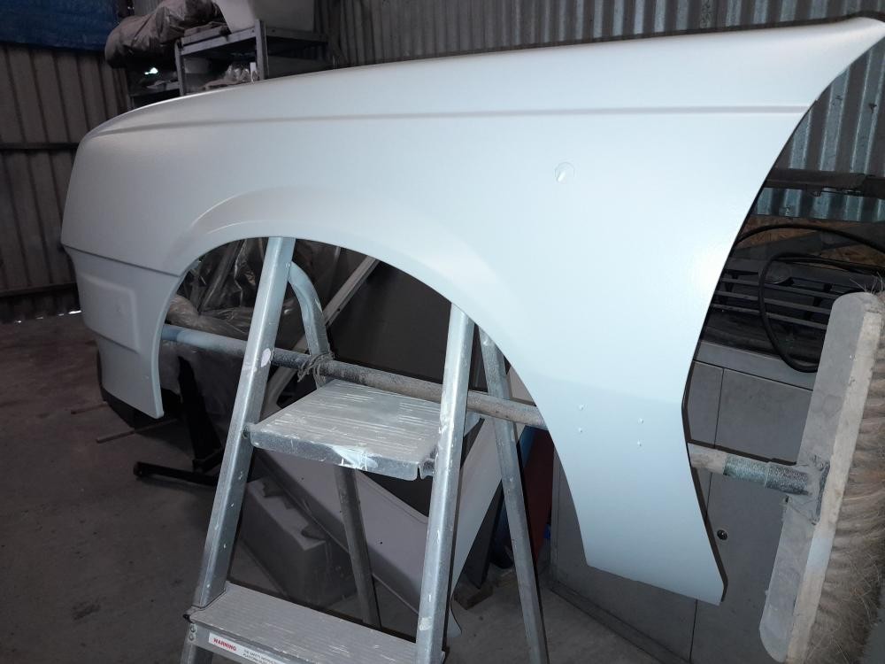

After a good cleaning, the epoxy primer went on.
20201023_164735.thumb.jpg.4da4691b4f347b77f309f40dc38acf31.jpg.22a43b2a91f632d0c102d1e28d07ffce.jpg
It got a good thick coating, and can now be put to one side until I start the filling, blocking and priming necessary to enable some colour to be splashed around. Just need to order some more paint so I can crack on with the other wing, doors and bonnet first. :)

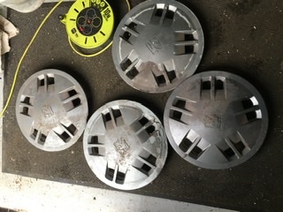

Love the build, any interest in these FOC  before they get thrown away? From my uncles old estate of similar vintage. Other than paint only one has any real damage
Cool - what would they cost to post?

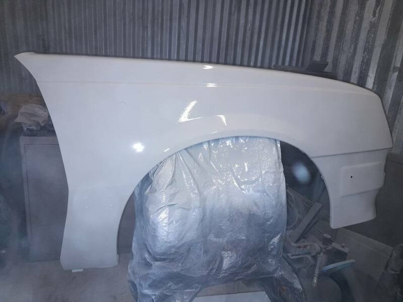

A few more bits done recently.
20201025_151737.thumb.jpg.7764989b4cbae1b3e6d87fba206d3f75.jpg.e9a55aae77ac0f750641aed78221d42c.jpg

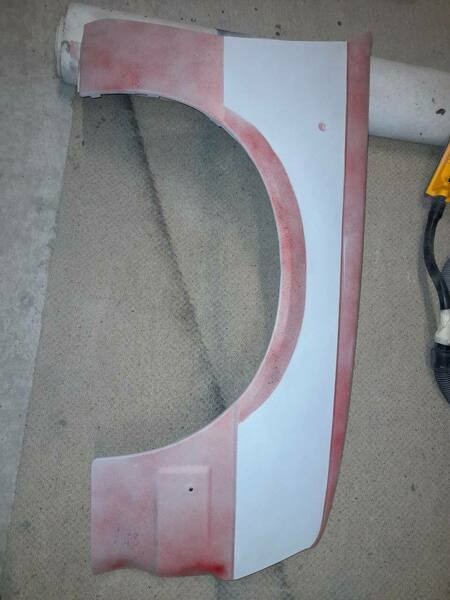

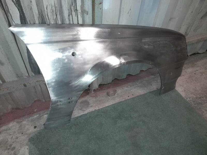

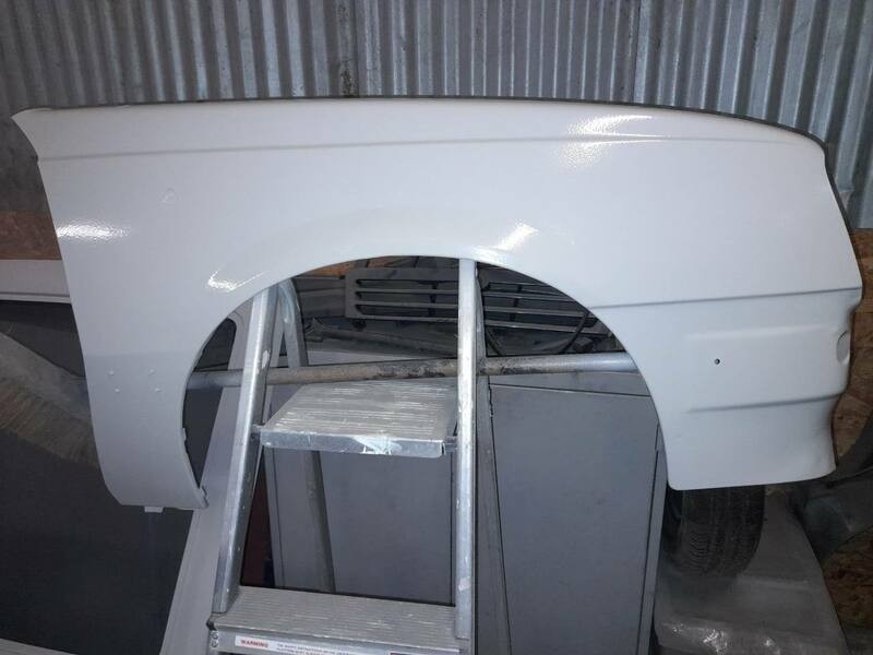

Stripped the nearside front wing a bit at a time on my way home from work.
20201031_190504.thumb.jpg.5b303da00a9f7737560b72c54cd69269.jpg.d1665580737f87f10c9bd6a9b0b814cc.jpg

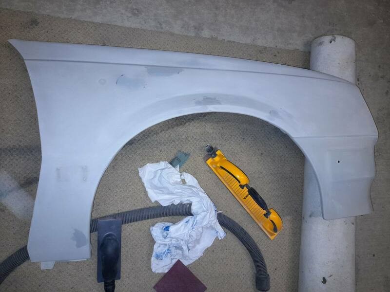

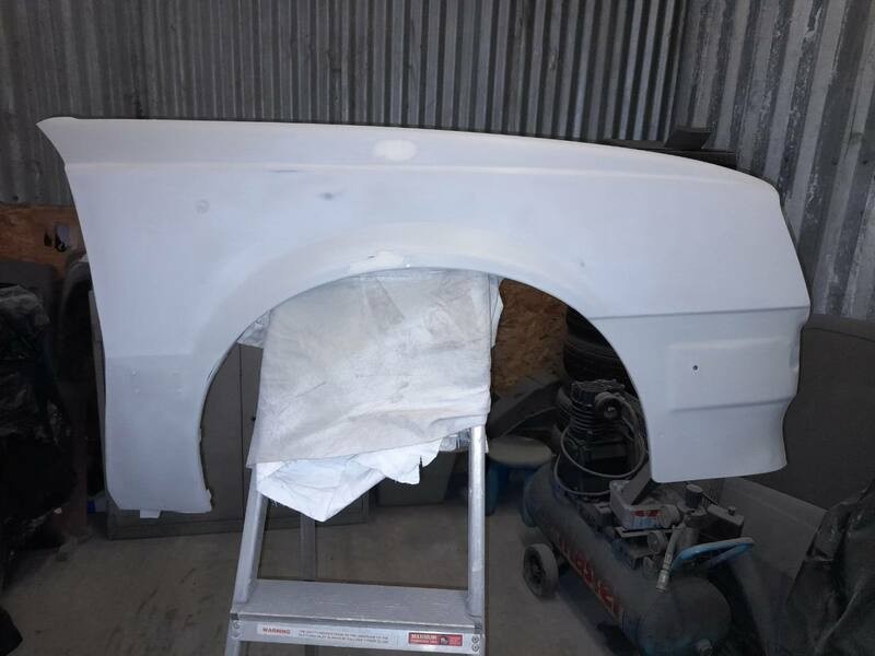

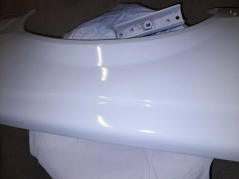

Surprisingly, this wing is completely dent free! It looked a bit wavy before stripping, but it must have just been the dodgy multiple resprays the wings were sporting.
Priming happened , and the next day the marks made by me catching it with the air line whilst spraying were blocked out with 240 grit wet and dry paper.
20201101_120440.thumb.jpg.28c58c906ecaabddd5394513d8a16cbc.jpg.88d9ca7850e2cb7fb68ecb4d87dac093.jpg
Both wings were then plonked on to the body to take up less space.
20201101_124457.thumb.jpg.20ea15e3bee16c3110371d3aba34c16e.jpg.20583eb08d9a0b4340fddd4b59e68da0.jpg

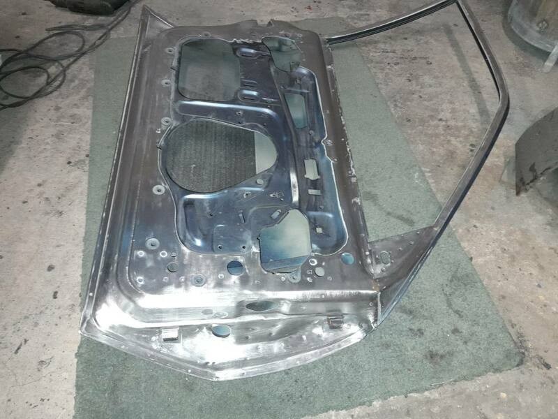

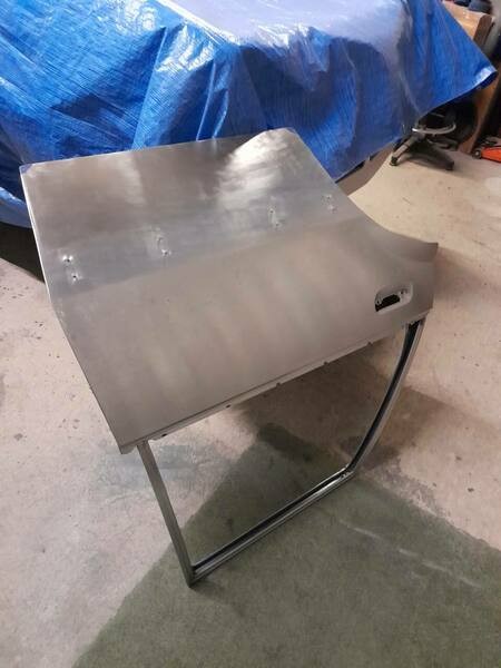

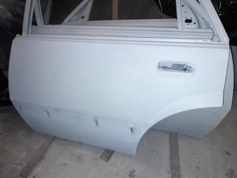

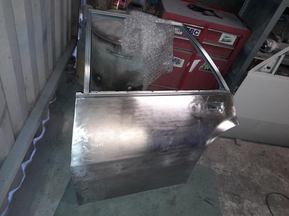

The nearside rear door was stripped over a few evenings.
20201101_154645.thumb.jpg.de0851395a7ae4cd0e72765c42aa52f2.jpg.52105acb1f9cb62cd44a82de63c65a33.jpg

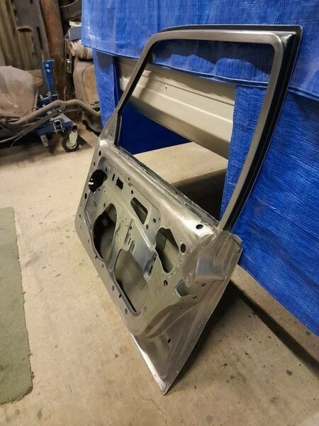

Once stripped, a bit of distortion was detected around the rear part of where the trim strip sits.
20201106_162033.thumb.jpg.c3a84d98f309aae5052b7d1efa10a992.jpg.2f278c358358a8d44ccd8def2efccc8e.jpg
It was beaten into a slightly better shape, then epoxy primed ready for further bodywork.
20201106_173158.thumb.jpg.7c720cf554b5f6fc459230cfc0d6fdce.jpg.c34900338398ace34a57c87f0f20f046.jpg

PM sent about the hubcaps

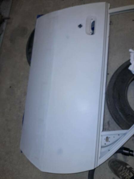

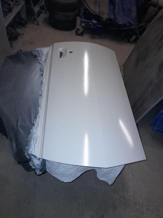

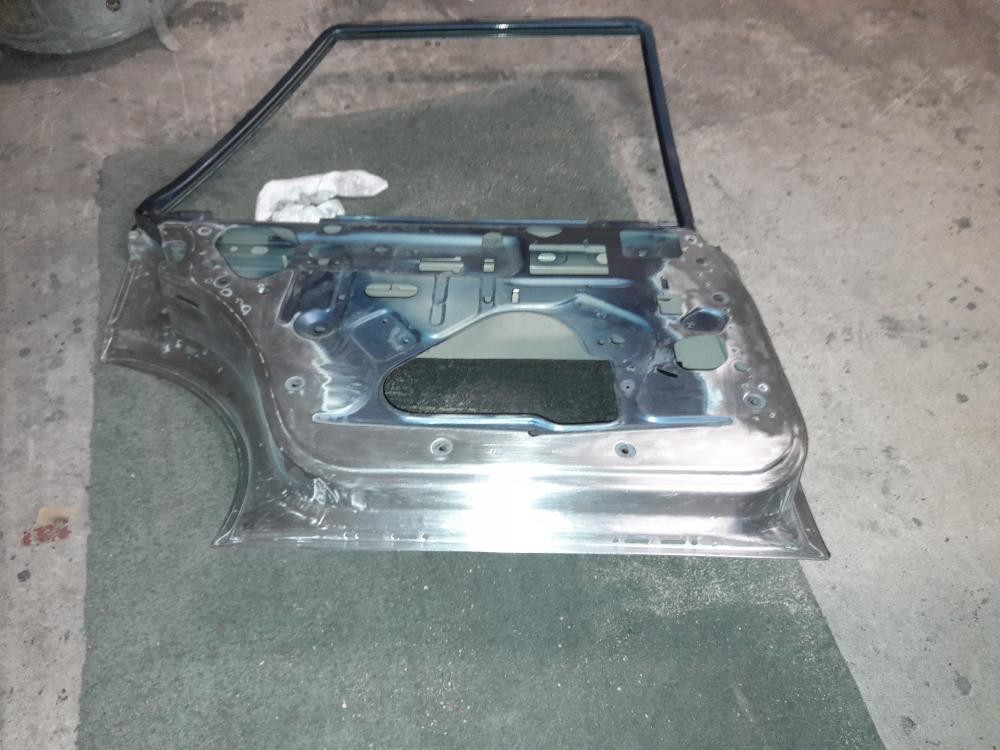

More doors stripped -
20201109_190601.thumb.jpg.b839b903bd95afc7f5ca2dd5301f972f.jpg.fefdc5e1ddd5ebd202221d4e5acc5275.jpg
A little Hydrate 80 required on the bottom corners.
20201112_184659.thumb.jpg.3b127a43860ab996d6319cc7daadf250.jpg.10a78556e5d7c372975a872dfbfe3dc2.jpg
And primed -
20201113_171612.thumb.jpg.292e6464077fa226249f3c88dacc4c90.jpg.d917913274a21e0f81e6b6157b79f031.jpg

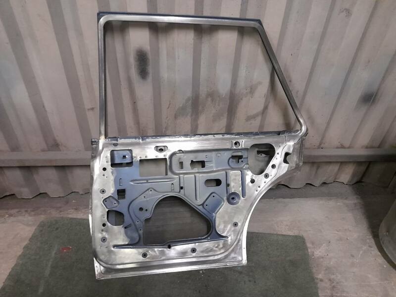

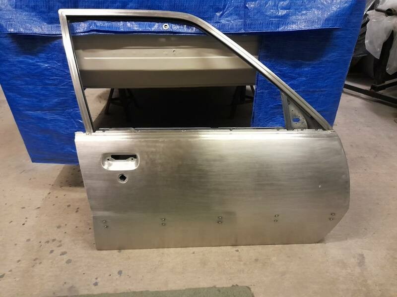

Final door stripped back -
20201121_173625.thumb.jpg.b8d9d8b78ba52410966beb12cccb4bf0.jpg.3212832c314569e7981c432650c9e811.jpg
20201121_173911.thumb.jpg.5df06a5496fb8a80e4e7dd6f9457dad6.jpg.aed3ca0ffe3fa701cd9391db3bd5f361.jpg
And primed -
20201122_145613.thumb.jpg.c6e0b5d2f9fa445993c3b6053a83ed75.jpg.80b4cecfe5633d976550f9e9b37fbd6f.jpg
20201124_181034.thumb.jpg.06c356873a93f11d9d599ebd6841b1d3.jpg.c586c692b26d5d3523348eeab642e1f3.jpg

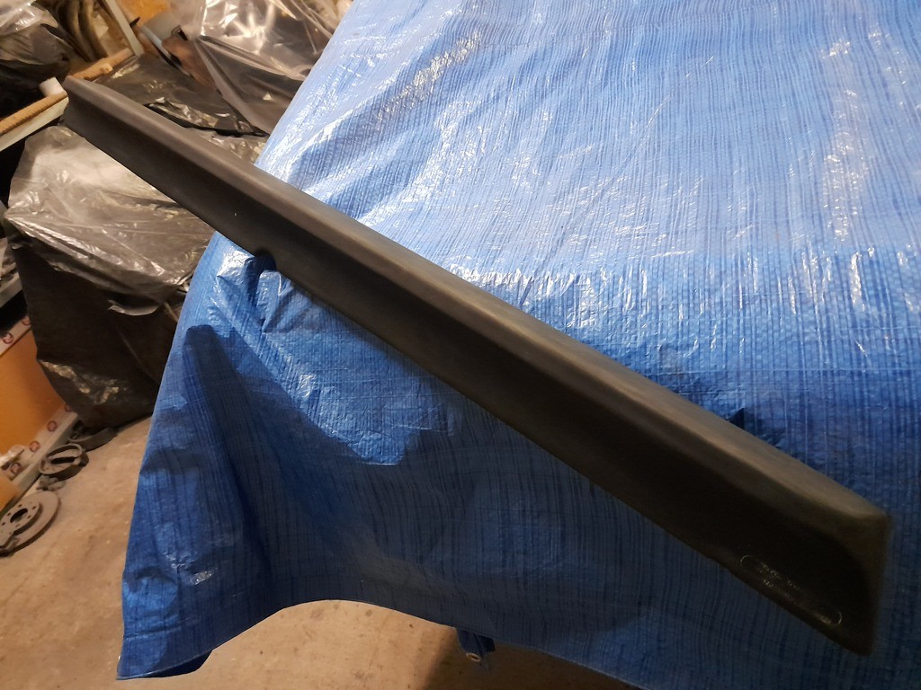

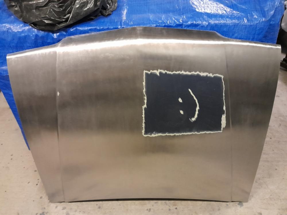

With all four doors stripped and primed now, theres just the bonnet and spoiler left to prepare for bodywork now. As the weather is set to be colder for the foreseeable,  I reckon now would be a good time to make a start stripping the paint off the tailgate spoiler. It has been painted over the factory finish, and there is crazing in certain places, so the only way to make it right again is to take it all off.

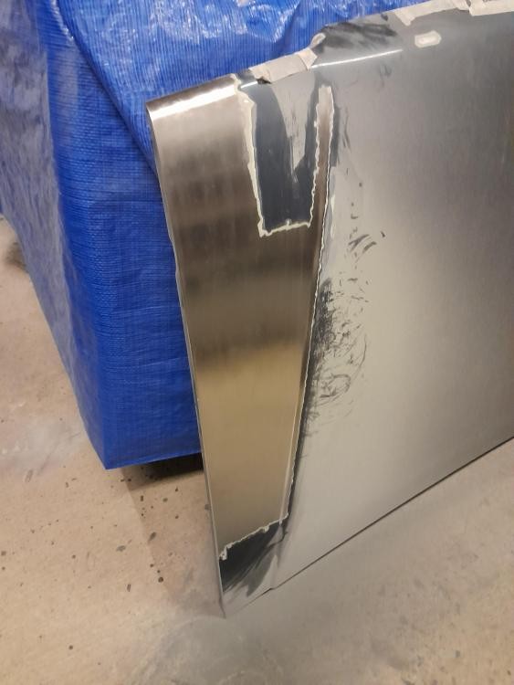

I've tried a patch sanding the majority off then finishing up rubbing it with thinners on a cloth - it worked well, but was incredibly time consuming.  I'm gonna see if I can get hold of some decent paint stripper to try and speed it up a bit.
As seems to be the norm, commercially available paint strippers don't have much effect on actual paint. Back to sanding and thinners it is then.
20201127_173324.thumb.jpg.43c033804cc484b9e5ab13acb3cc0325.jpg.8399327ff06901cb30f5f79b302b1f7d.jpg
Using a scotch pad with the thinners sped the job up considerably  -

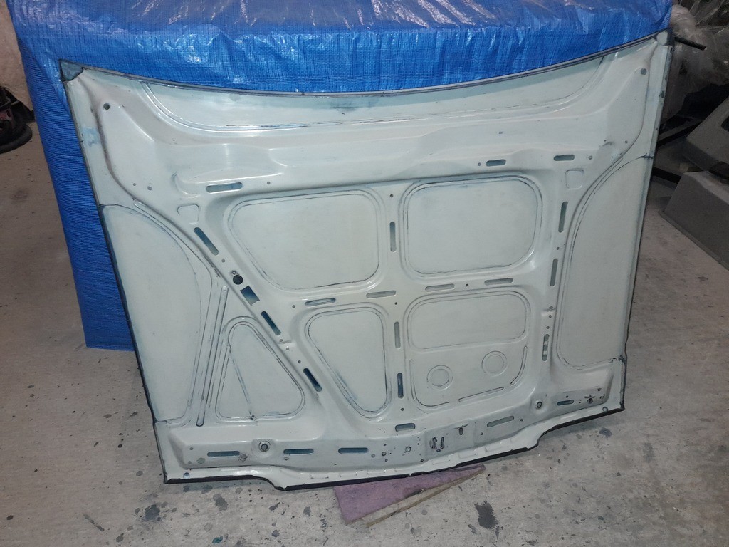

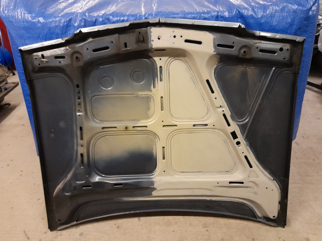

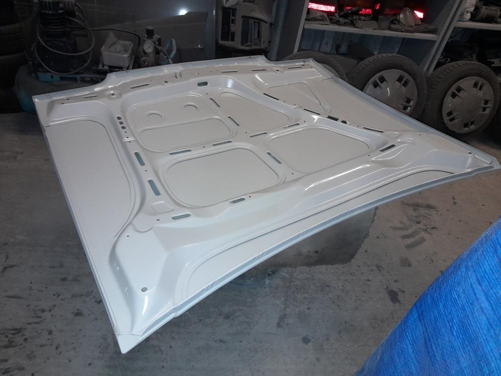

While the thinners was out, I made a start cleaning the inside of the bonnet.
And after several short sessions after work it was all back to the e-coat.
Just need to get some epoxy primer on there now, and it's all ready for the next stage.  🙂

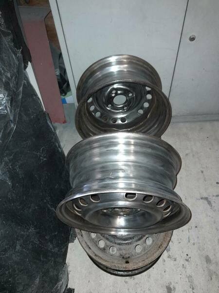

Not been at this for a few weeks for a variety of reasons. The most recent reason was the inability to get to the shed due to flooded roads.

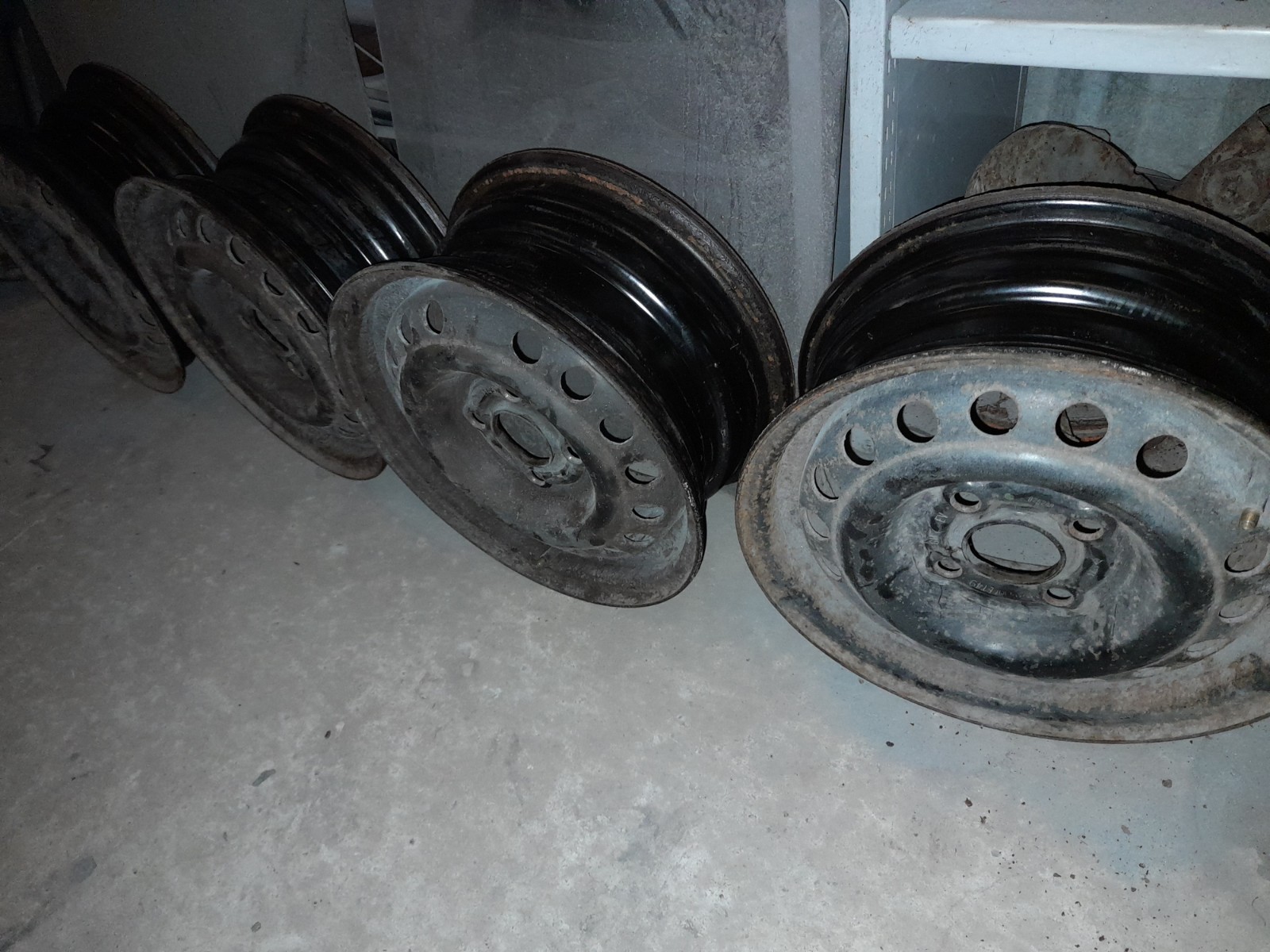

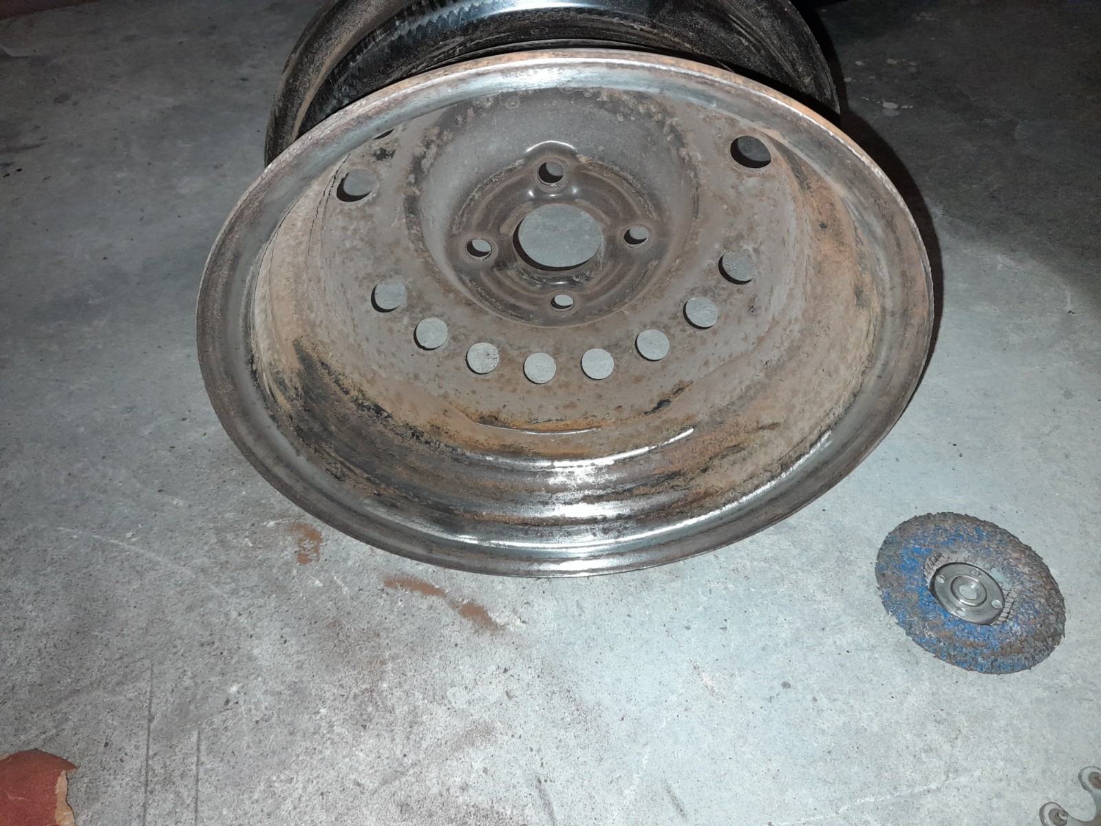

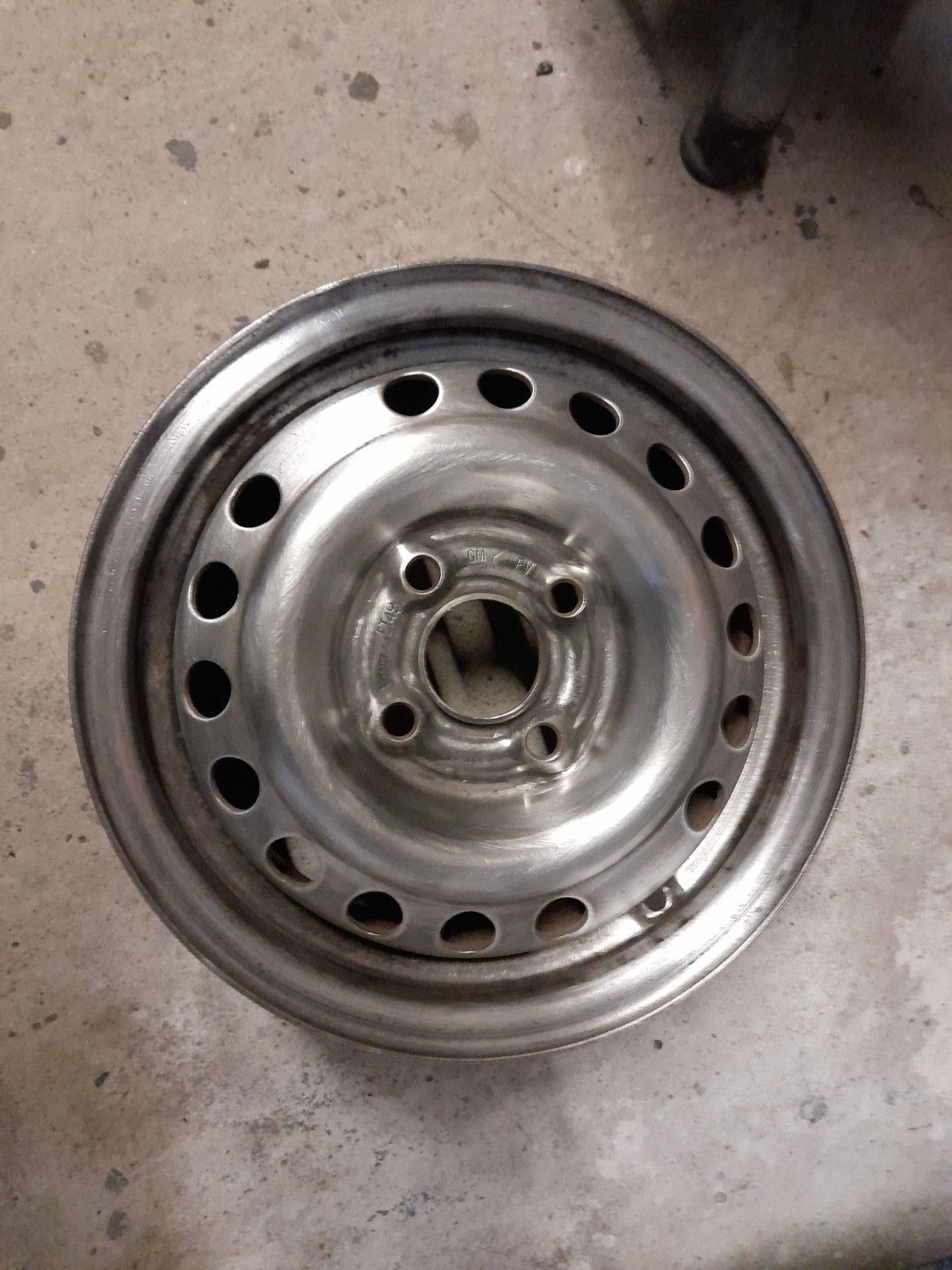

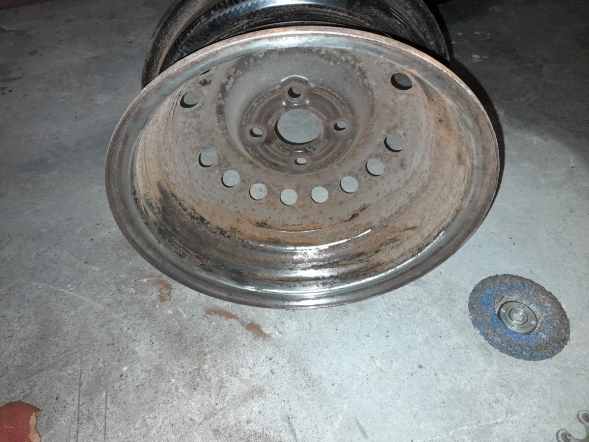

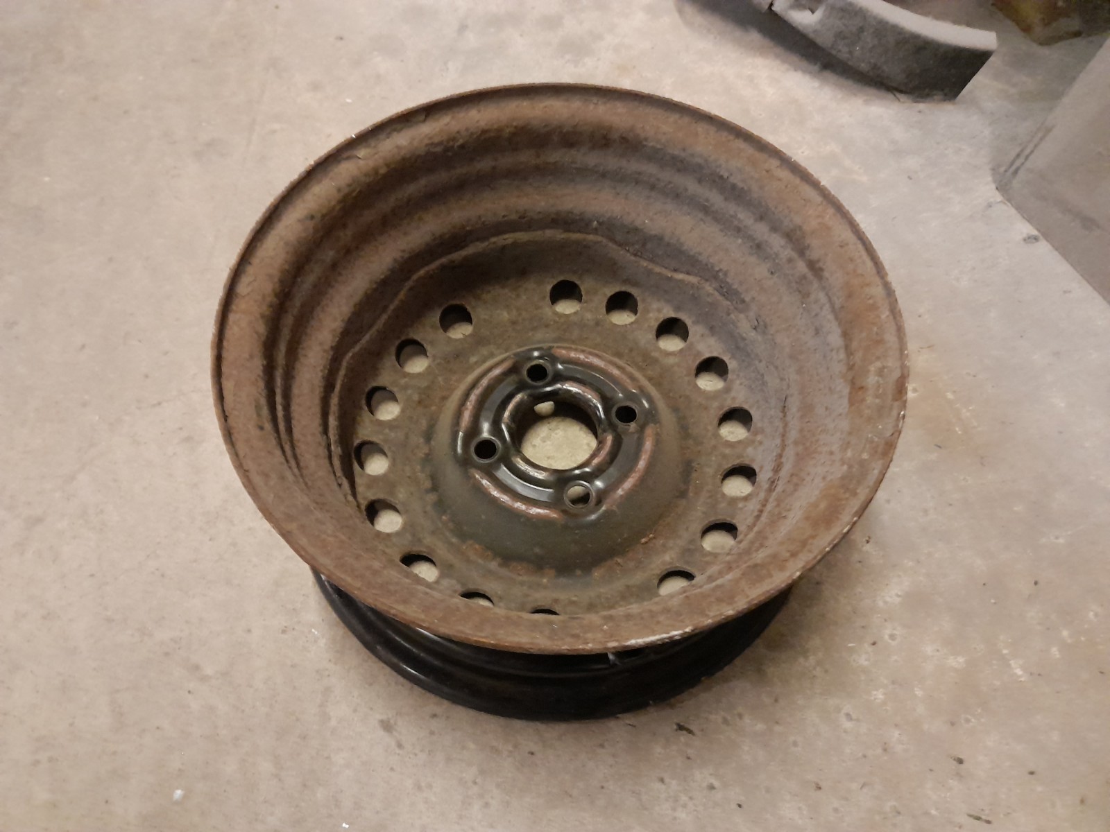

Got the tyres off - it's still too cold to do any body work stuff, and there  isn't a right lot left to do apart from that.

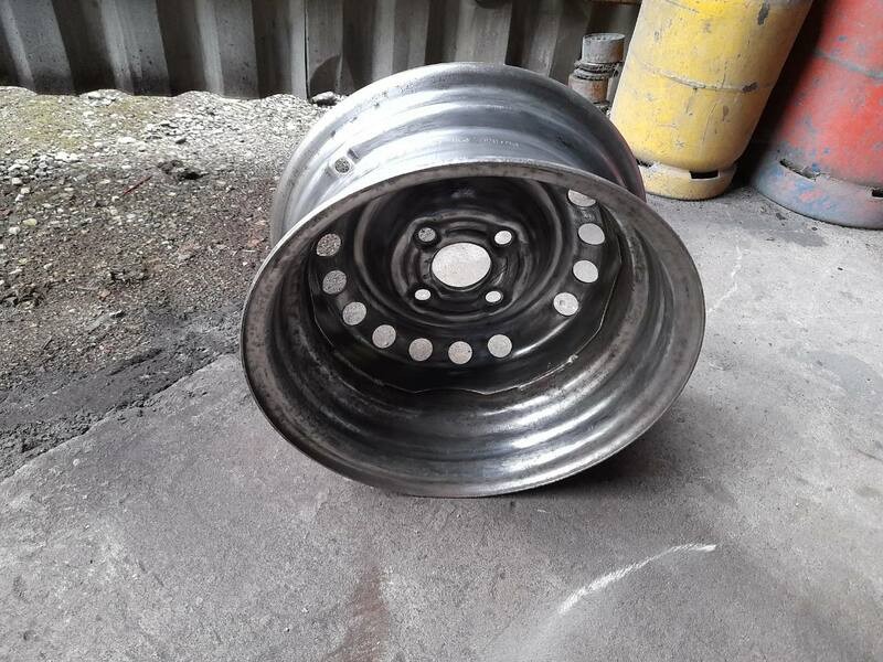

I had an exploratory session with power tools to ascertain the general condition, and was pleased by the face of the wheel.
The back was not quite as pleasing.
I duly got stuck in with the wire wheel stuff.
Not too bad at all - they're all very straight too. If I can afford it I'll get them all blasted and Powder coated. :)
The back cleaned up pretty well.
20210130_150855.thumb.jpg.b0b9222701c9aead1851ed5383bda8d4.jpg.9cd1b36982d0d1c9fb8efaa3512427f8.jpg

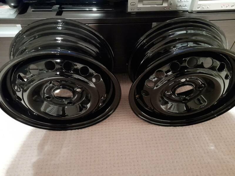

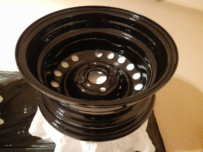

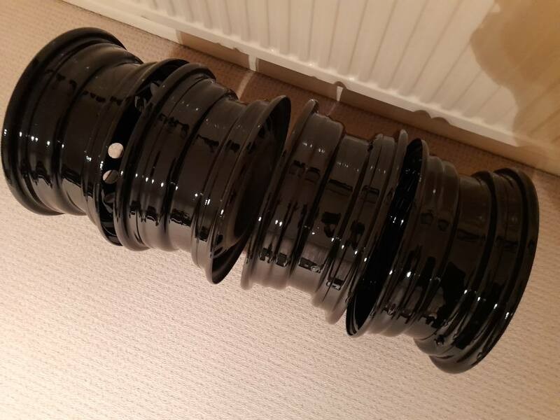

Costs have dictated that POR15 will be used on these, just got to get the other two done and I can put the wire wheel stuff away. (Hopefully for considerable time!)
20210131_151626.thumb.jpg.31152727e99586287c2e9c0b98c35de2.jpg.33051e2a12cbbd6172771c9955873f84.jpg
I'll probably have to paint these in the kitchen as it's a bit too cold in the shed!
I had to paint the backs and barrels first.
20210207_120105.thumb.jpg.91b81b95b14ea82bc804bfa288625ca7.jpg.cdc3a20de51dbf33c995448af9e09ad2.jpg
20210214_125555.thumb.jpg.b374509f9ba5d1188ad60d5059dd95a6.jpg.1a10aa60b489de597e1a761bc3090a97.jpg
20210214_125402.thumb.jpg.d9fae6b654712a15163ec29d15b54add.jpg.77f0d903fdc592c22a2f913c996155d0.jpg
Then finish off with the faces.
20210214_000220.thumb.jpg.03a6fe3bc0bd459c44efe68342a3d702.jpg.45444035b1706d7768b019ef6b1e7f5a.jpg

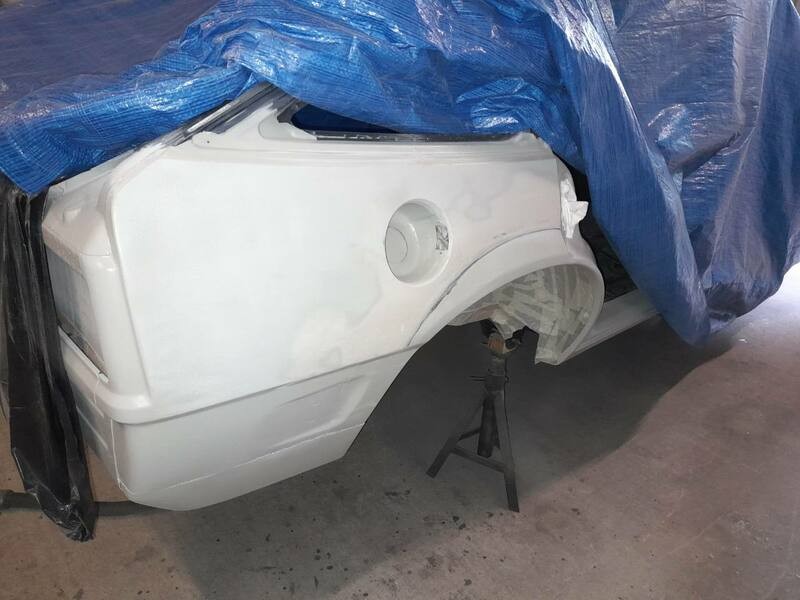

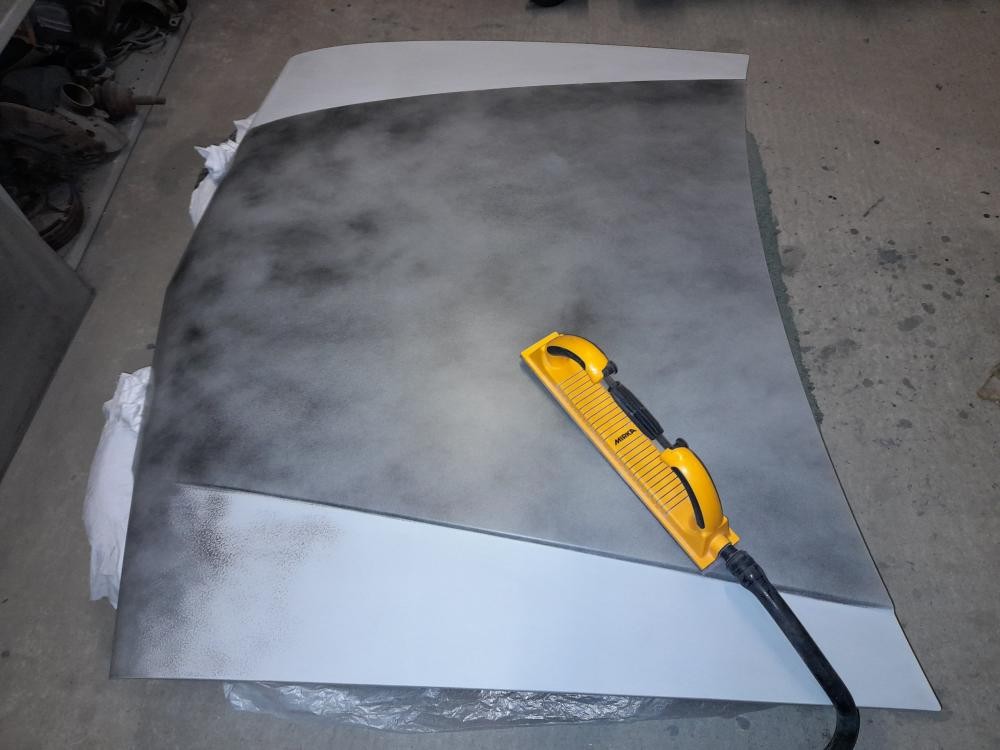

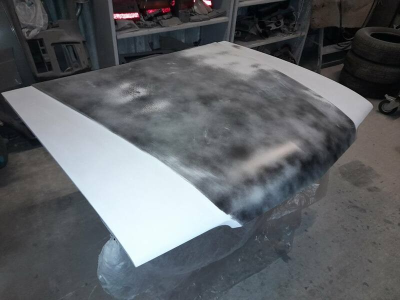

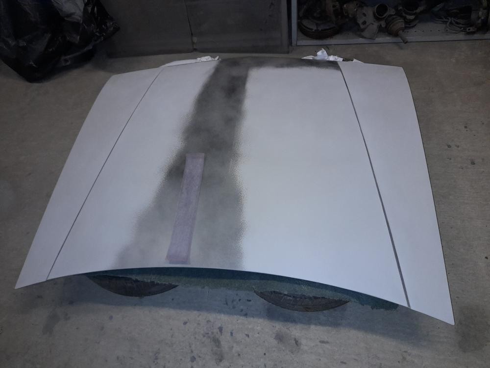

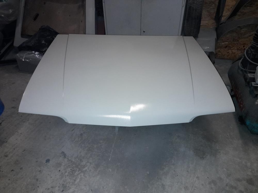

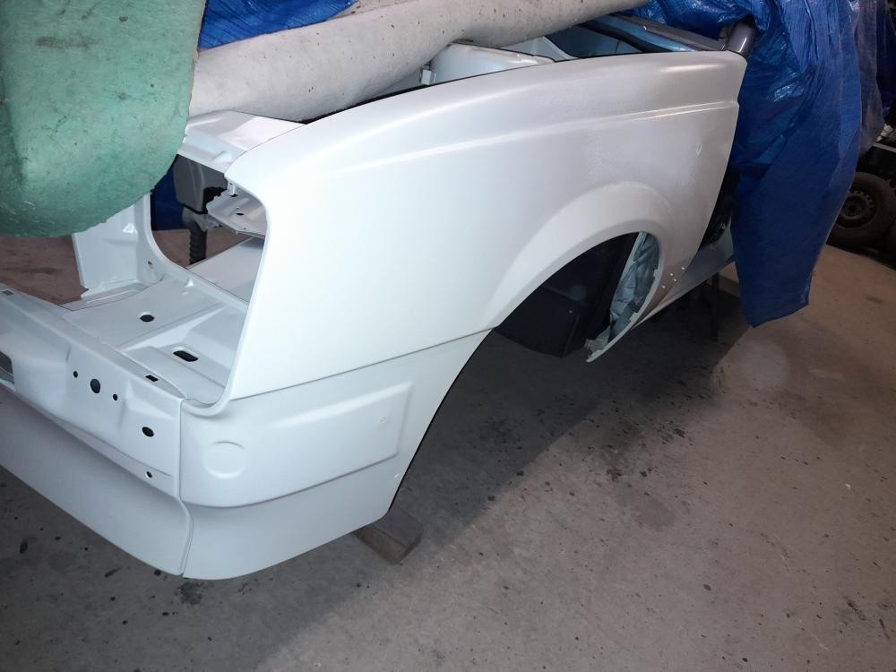

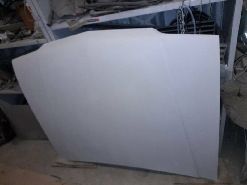

Managed to get a bit done over the last couple of weeks. The bonnet has been filled and blocked, just a couple of small dents plus a bit of rust pitting over the offside headlight.
20210226_154940.thumb.jpg.145716936c029568b80b1802303746d3.jpg.0ba7d36a607b15da32c928963dc771ae.jpg
It also got a second layer of primer on it, and has been blocked again. Seen here part way through rubbing through a guide coat.

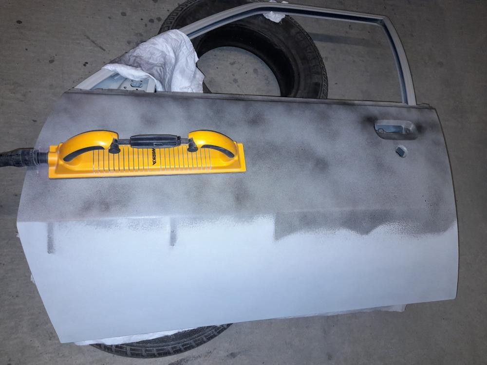

Two of the doors have been filled (car park door dings) and blocked. Waiting for it to warm up a bit so I can get another coat of epoxy primer on there to seal it - no idea when the paint job will be done so epoxy will prevent any moisture being absorbed while it all waits.
20210306_181806.thumb.jpg.167295c0193a4b063d67c67d8a192ed9.jpg.e2d6a7425e50c12d272912dd9fba19f8.jpg
Hopefully more rubbing tomorrow.  :)
Most rubbing happened -drivers door had a couple of door dings addressed.
20210307_141639.thumb.jpg.a11371f178201ca27af6f8bbf86d7b45.jpg.73af95c437cd39e12a5971cfdff2a91f.jpg

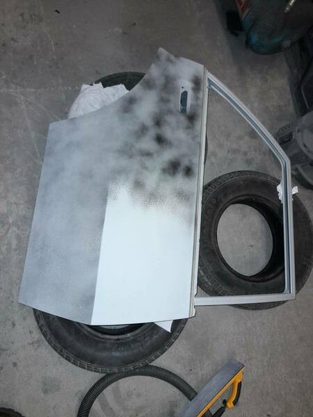

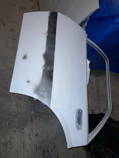

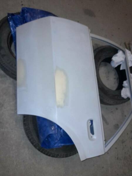

Passenger side rear door revealed a bit of damage after a few strokes of the block. I'd not noticed it when I stripped all the paint off, but it looks like its brushed against a gate post at some point. It's pretty superficial, but would have been noticeable once its shiny, so a little filler was applied before calling it a day.
20210307_163224.thumb.jpg.ad0cc74ba9ee9a449eecd4290c401228.jpg.b9e163a0a52f07eee5e6d541af7f1133.jpg
Both rear doors got a bit more attention today, the nearside one with the damage needed a couple more light skims to get it properly straight.
20210310_191134.thumb.jpg.cece915aa724cc7536914d9bf23fa065.jpg.cb810fa4be19c641e55532e63b0eb918.jpg

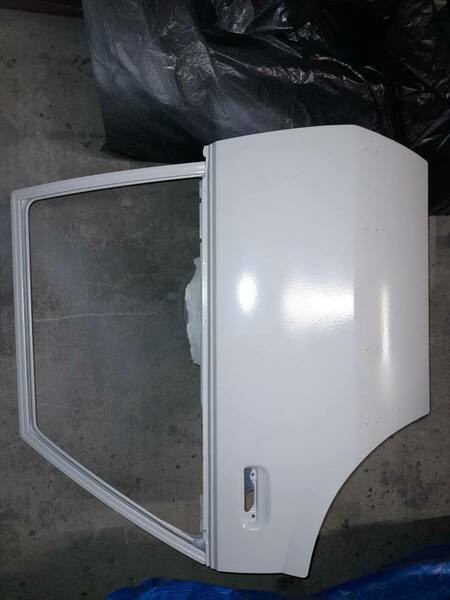

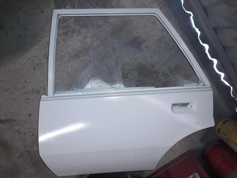

Once filled, primed, guide coated and blocked again, it's ready for the paint bloke.
20210315_190339.thumb.jpg.a1f0e0be7424d58677fec27017e785d3.jpg.29db3a238589c29df5b80d126ff13876.jpg

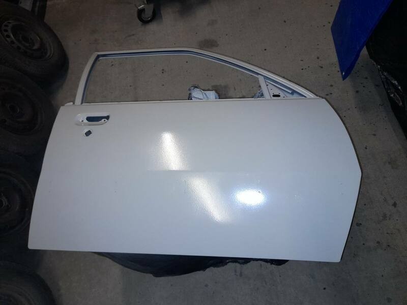

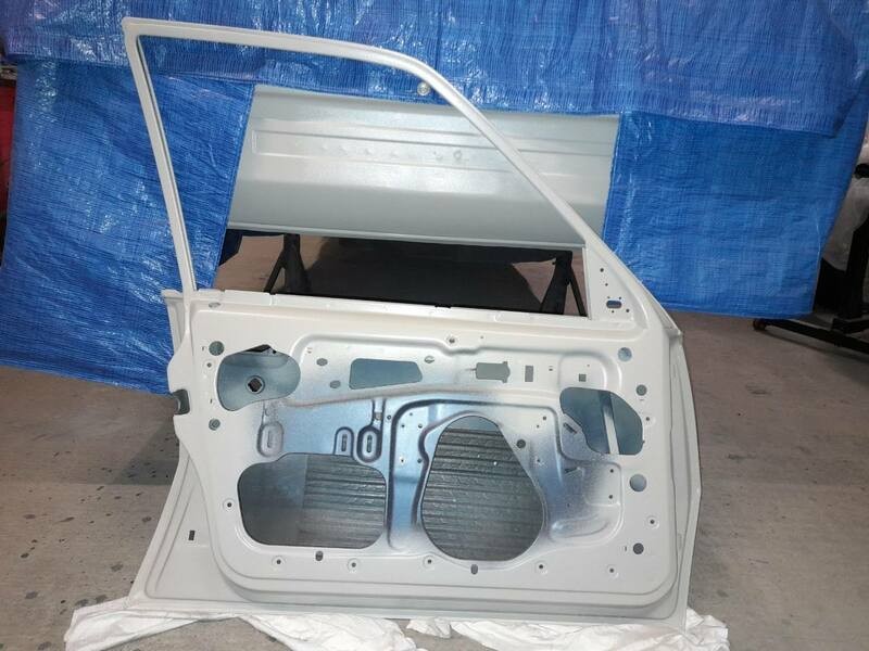

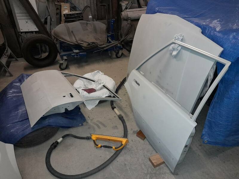

More stuff happened this weekend (boring stuff) Both front doors recieved what should hopefully be the last coat of epoxy primer.
20210320_163717.thumb.jpg.33639a13e7dcc58f34ebda1acc7b0002.jpg.282e604e6784a65279e00688f885c82e.jpg
20210320_163745.thumb.jpg.6fc8beb7a2a5bab9bdd36bd94b97fa3e.jpg.b3596278daf886fbce11106365aea70b.jpg
Should get these blocked during the week after work.
The bonnet had what I also hope will be the last required coat of epoxy primer on Friday. Today I commenced the blocking -

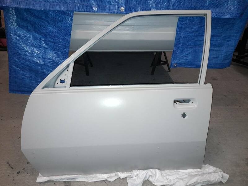

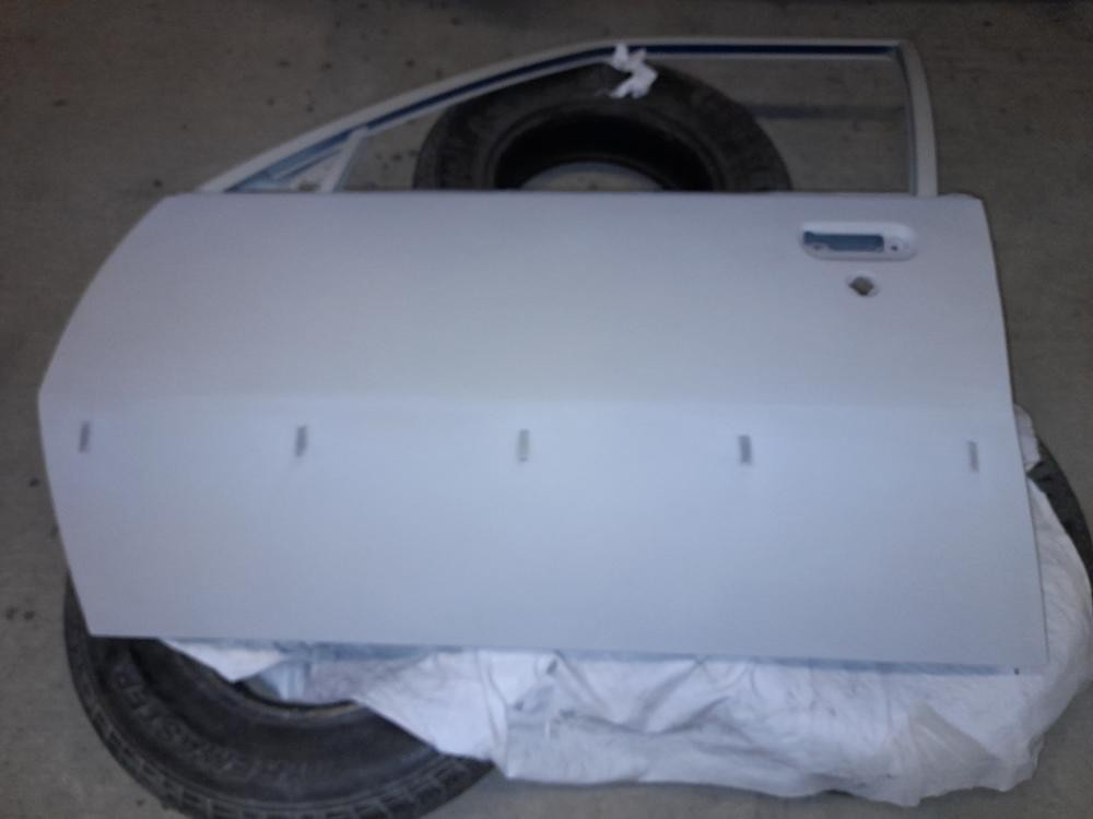

Front doors now finished up ready to paint.
Passenger side part way through blocking -
20210326_104749.thumb.jpg.4d3ba4f11f037a39c0799bb89102f02b.jpg.42252a6d782f10ea8914c831a7f06044.jpg
And ready for paint -
20210326_134629.thumb.jpg.3dcc188dce6bd1a3d4224665e5773d70.jpg.3bd85fce61e9cc999e113718a1a7deb0.jpg

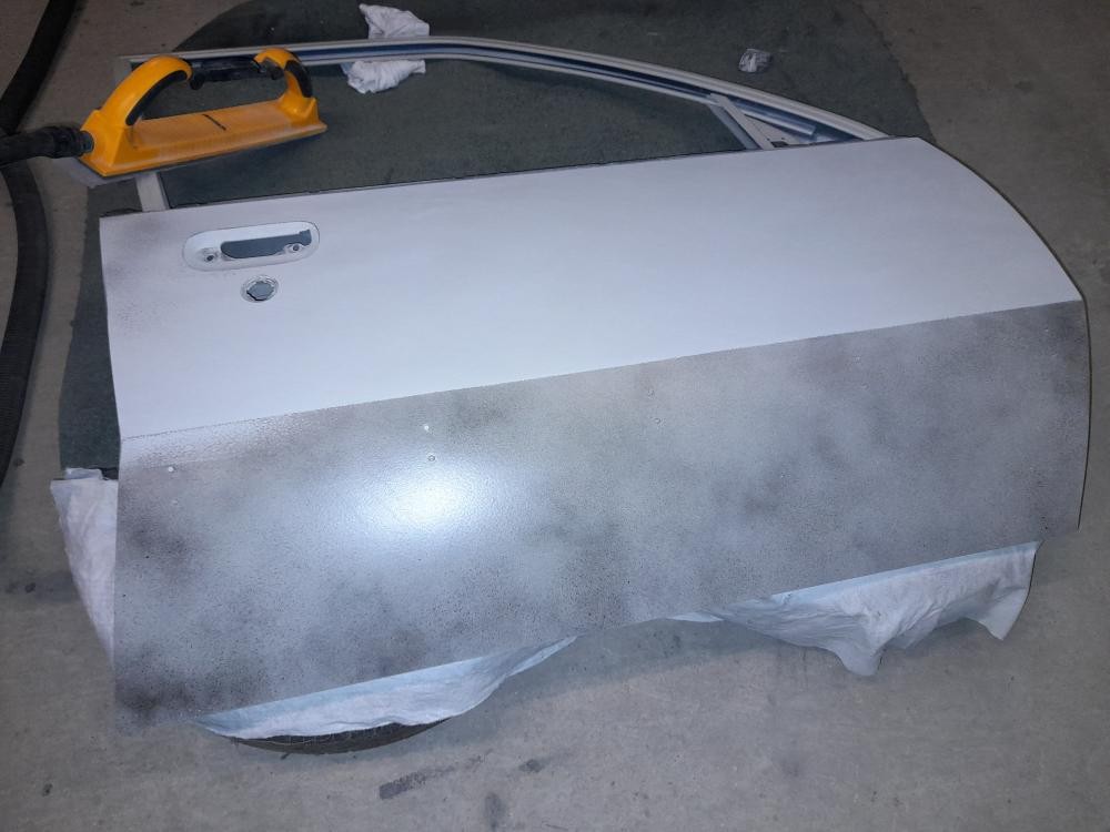

And drivers side after almost completing tha top half -
20210327_135937.thumb.jpg.9de8cc1e410517543bc1bed9ca663bfb.jpg.f93a0f15ca546aa7ad51672163f2b913.jpg
Still need to finish the centre line of the bonnet (mission) then next up will be the tailgate. :)
Edited by sleag40
Finally got round to finishing up the bonnet.
20210331_181606.thumb.jpg.c2522a0655e0fd9cf015aa956573a8c5.jpg.253a78a80601991721dca2ec95af0db7.jpg
20210402_134205.thumb.jpg.3d2e02a1a915ba068673078c8305b60c.jpg.efb2704fe051307df1c15a8798c43d2e.jpg

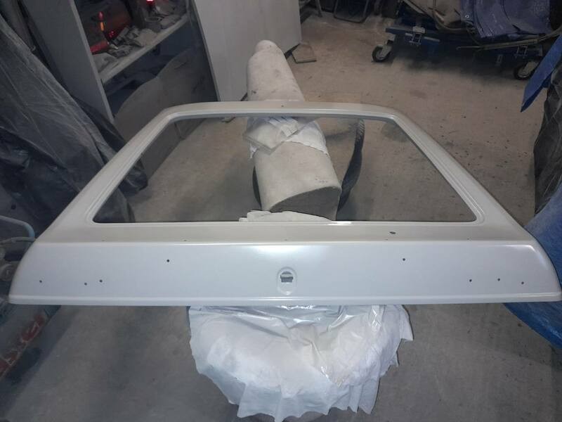

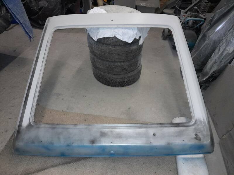

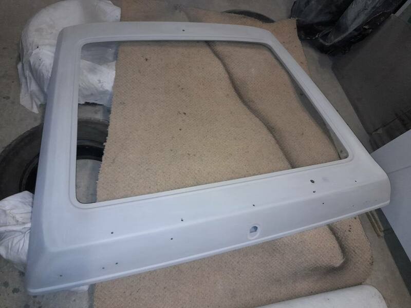

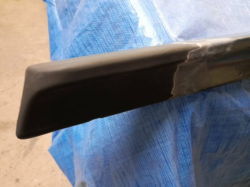

The tailgate got a good rub up followed by its second coat of epoxy primer. Only two little dents to fill on this, one next to the washer jet, and one next to the wiper spindle hole.
20210402_153545.thumb.jpg.e599f36fd7733b20da9881e22fad2eeb.jpg.7dc511af382f2082904f1470f8dbe59a.jpg
It then got a third coat.
20210331_181306.thumb.jpg.6d866b7c5ddd8b17cb5f355fa746d7ac.jpg.bba22a5be0b5372b2c4c03f461c3b764.jpg

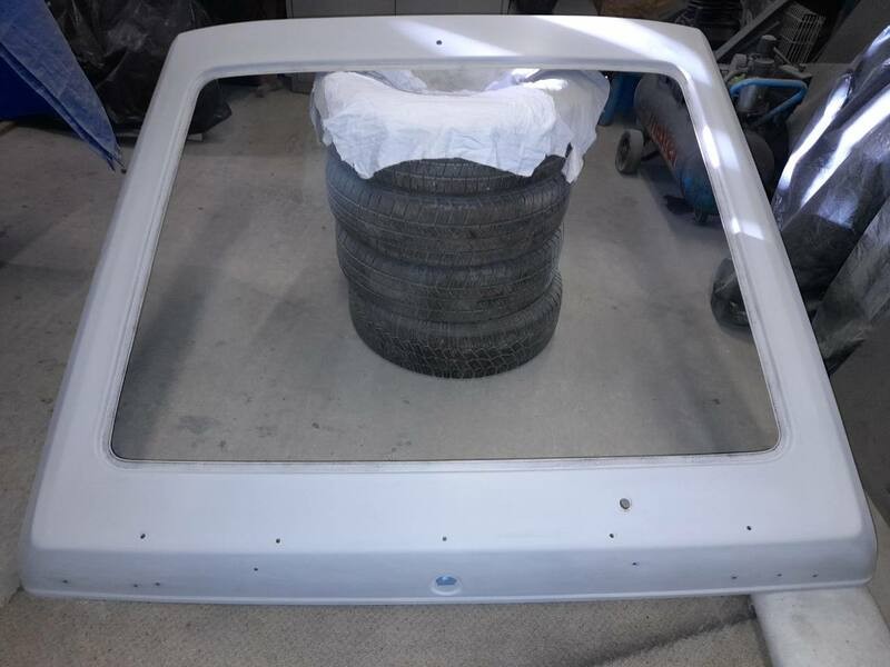

Tailgate now blocked again ready for painting.
Part way through.

And rubbed out (took a while!)
20210404_172152.thumb.jpg.df954c69f6a55d111f377112cf31ed7e.jpg.e24ebcacc9dc788627b4cc95085b824e.jpg
Made a start on the offside front wing, giving it a rub up and the first fill.
20210404_182217.thumb.jpg.b0fce2e3bd2ff1b85bee5730fc06ffaa.jpg.2eb51179b43c67750d68e12cebc1f630.jpg
It's easily the worst panel to be tackled so far - I've identified 7 separate areas that require fettling, so it'll probably take a while! The other wing is close to perfect, so should be a breeze after this. :)
It was given its second coat of epoxy primer before I scuttled off home.
20210404_190744.thumb.jpg.3ad55e8da5ba21dc3be06dee994432fa.jpg.59631091ae031e7a2d473dd0e31b6993.jpg
More work has taken place on the slightly battered drivers side wing. A few light skims were applied before more blocking.

Which was then blocked again, this time using a tin of Carmine red left over from my Astramax van for a guide coat. (Van was sold in 1999!)

Drivers side wing now just a blocking away from being ready to paint.

The passenger side one is at the same stage.

20210413_184036.thumb.jpg.bd8e55eb6ec8a15dae762485c56d582d.jpg.ec47f65063bc524121b5ccf828349d15.jpg
I suspect that these rear quarters are gonna be another big consumer of time - particularly this side - due to the previous bodge repairs involving the use of a hammer!  :)
