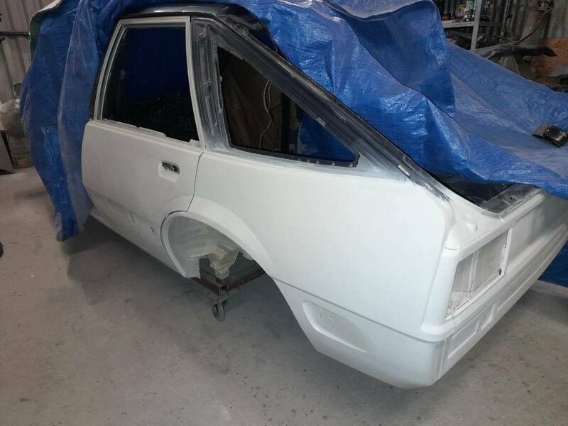

Top half of rear quarter now something like,  bottom half got its first fill.

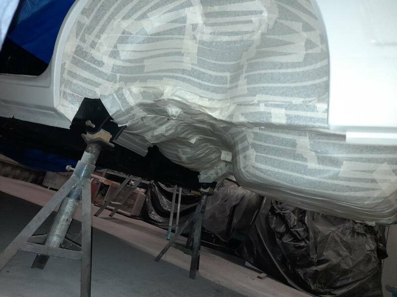

Made a start taping up the underside to keep it free from over spray too.
20210414_175156.thumb.jpg.2701cb12982ef63d6ad104789734388a.jpg.2de5ae859a9d31fac2e65d34373cb0c1.jpg
About a third of it done today - hopefully get the rest done tomorrow.  :)

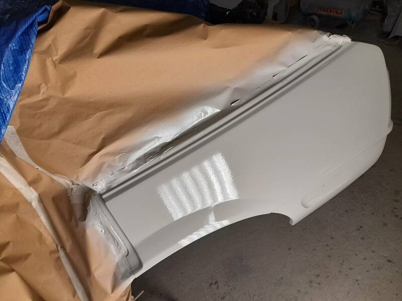

Managed to get a good few hours on this yesterday. The nearside rear quarter got skimmed and rubbed several times until it was good enough to be hit with some epoxy primer.
20210419_130556.thumb.jpg.a9d602b912371d4441813c2252877ba8.jpg.c8b59184d18f9cef07c7818c2aa22a5e.jpg
Really pleased how well this side has come out so far, just a small amount of fettling required before its ready to paint.

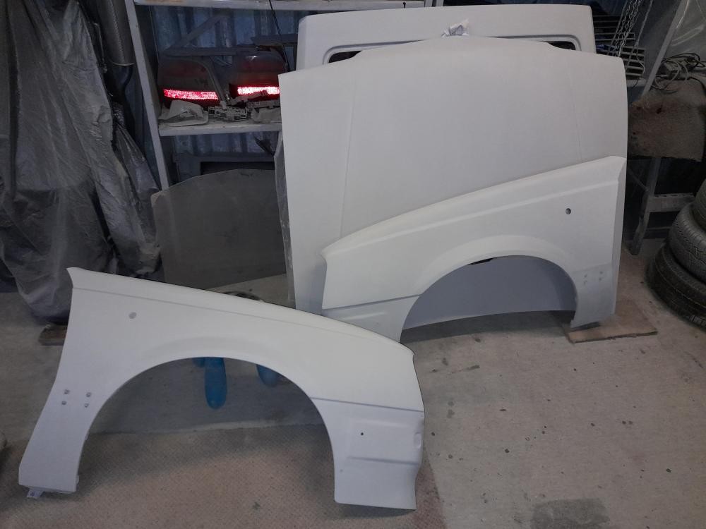

The front wings have both been blocked again, they can now go in the "paint bloke" pile.
20210420_161554.thumb.jpg.9a129e5ca1d8c8ca335ef197a5c0bde4.jpg.b0281c7644d70278fed8f58cccbd8cab.jpg

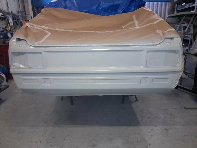

This weekend saw the rear end skimmed, rubbed and primed again.
20210425_160225.thumb.jpg.9e2aeeee6b65afc7aa3a7017c057b5fd.jpg.05d22cb36496eb932a6b0e8f98e25dab.jpg
Pitted areas now unable to be seen. :)

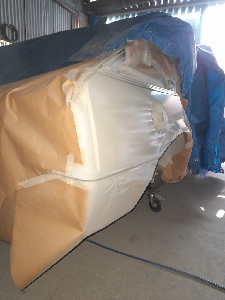

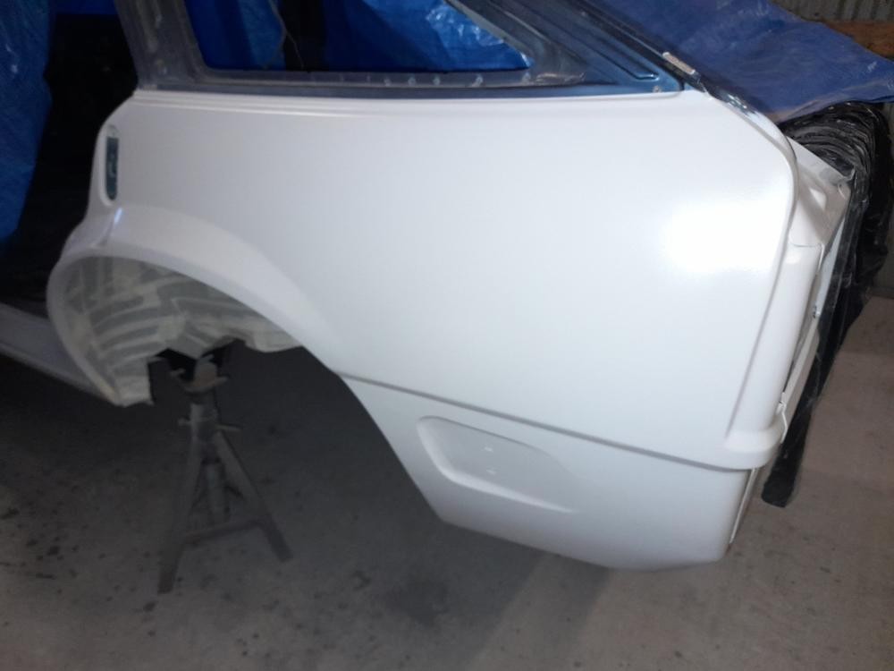

Nearside rear quarter was guide coated and blocked again.
20210424_141934.thumb.jpg.b59527192c147177131837555a90f330.jpg.1e8afb6b227c0843db610d9755844c80.jpg

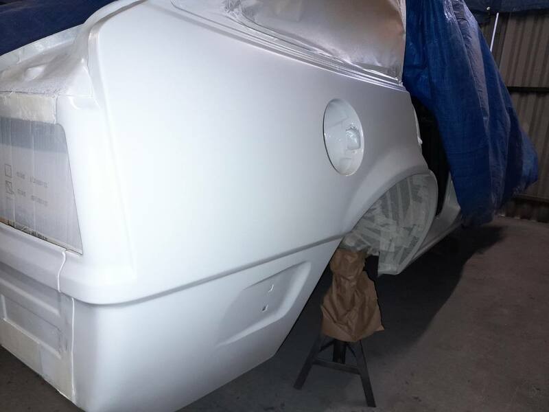

Then after a few small fills were applied, a third coat of primer went on.
20210425_165511.thumb.jpg.e4e530bb2dc3cdb566e236a24aac794c.jpg.3b4c38ace654fa46c674839bb3bbfdd4.jpg
20210425_165657.thumb.jpg.df3e34287eb14720c0229201b5e02854.jpg.5a9ff4189127efc5718a4343e629ac4c.jpg
Ill leave the back end and rear quarters for a couple of weeks before blocking them again, and get on with the sills in the mean time.

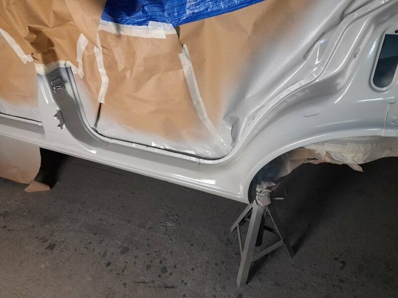

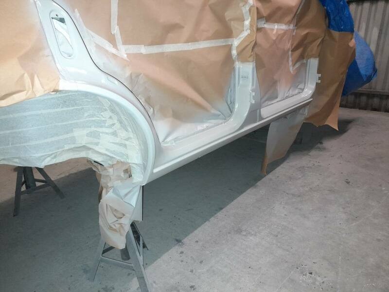

Nearside sill + wheel arch areas got some attention over the last weekend. It's been filled, rubbed and primed twice. The pattern part sills used are not very good pressings - this became apparent once fettling began!
20210502_145035.thumb.jpg.fe6f1abcbc9cb14022a93a97411dc03b.jpg.7a3aaad23ef70d82ffd072f152c3b949.jpg
20210502_144957.thumb.jpg.5252532352088b9b8551836184fe1b88.jpg.80ed0a16d8ed5be618761dd7759be97d.jpg
20210502_144850.thumb.jpg.386923691af2896015efa5dbc1dc30dd.jpg.803882d3ef49b072950f83b81a03f166.jpg
One more fill/rub/prime cycle should see it ready to paint, but I'm gonna get the offside to the same stage first.

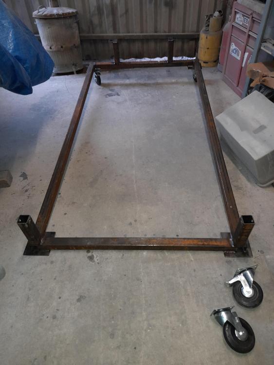

I hope to have the dolly fabricated before working on the front of the shell - should hopefully all be on it's way to the paint bloke in the next few weeks. :)

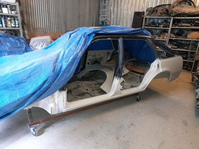

Offside was finished off today.
The nearside was given its final rub up as far as the rear quarter.
The dolly has been fabricated,  just need to shorten the uprights a little, then bolt the wheels on and the shell will be mobile.  :)
Nearside rear quarter finished off this week.

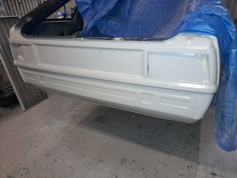

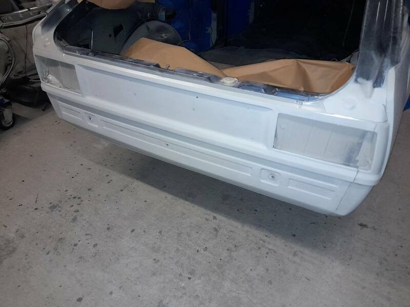

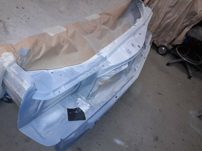

Identified some low spots in the rear valance, they were given a thin skim of fine filler.
Then rubbed and primed again.
The dolly was shortened and bolted on today, surprisingly it fitted absolutely perfectly - wasn't expecting that!
After that was done, good tidy up and vacuum session happened - it was incredibly dusty in the shed.

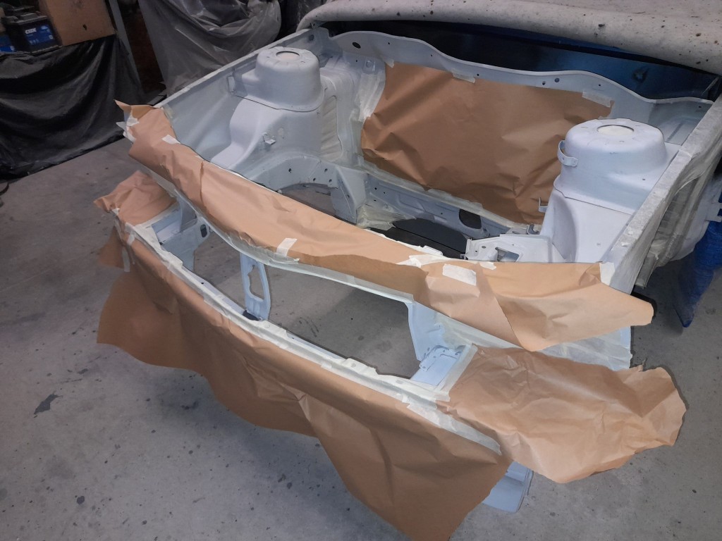

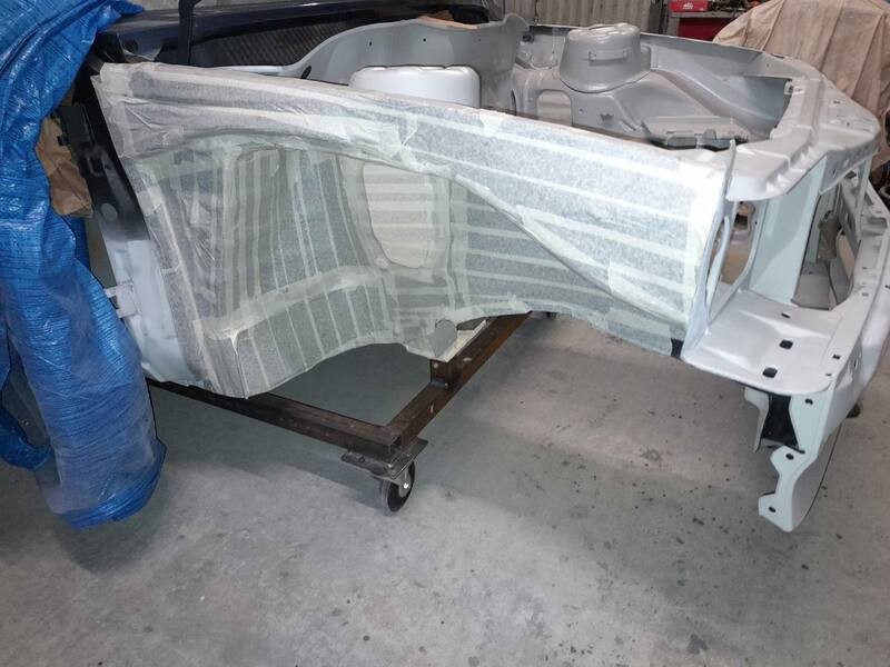

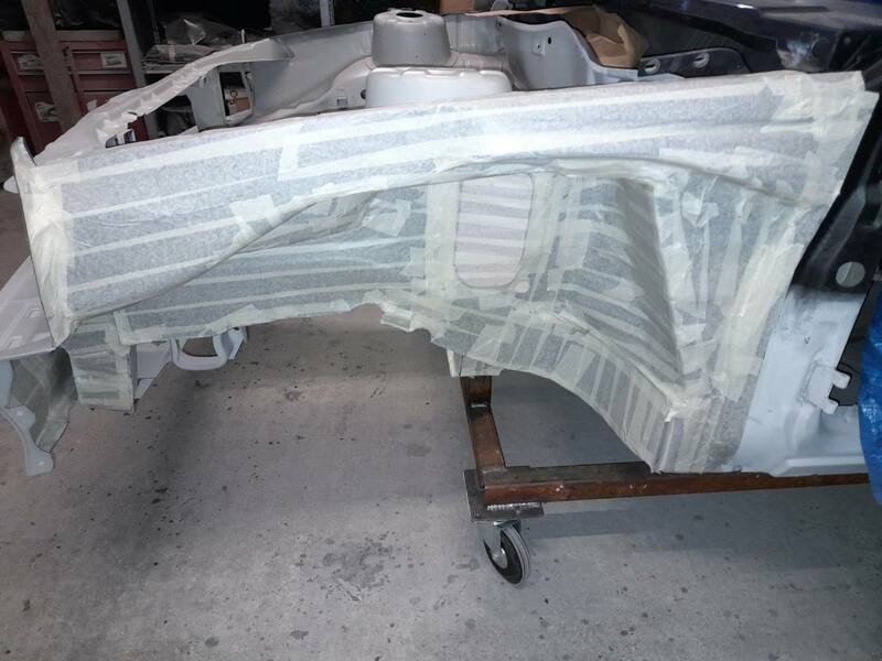

Once that was done, I continued taping up the inner front wings in preparation for fettling up the front end. Just got to give the rear panel its final block/rub and I can switch ends.  :)

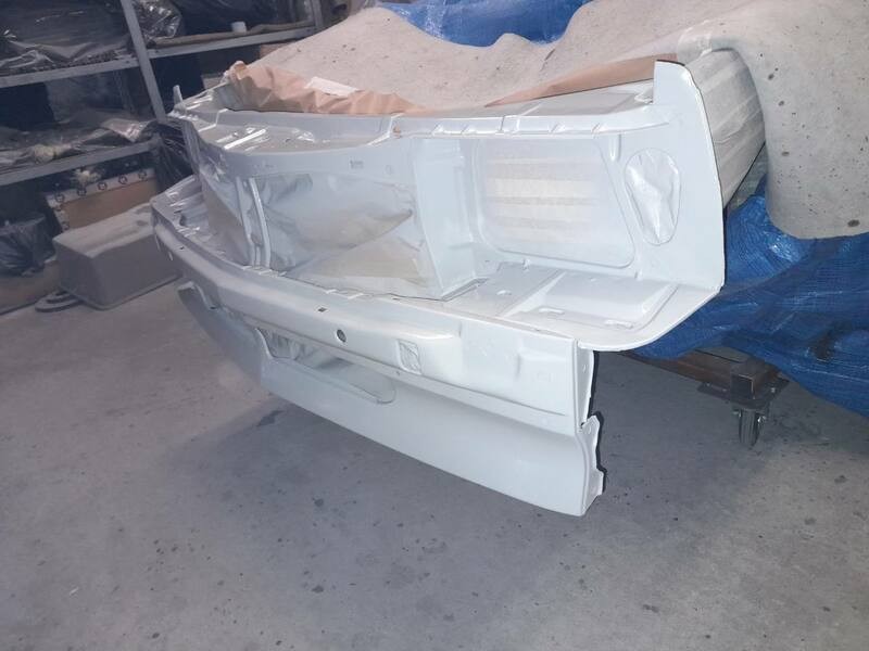

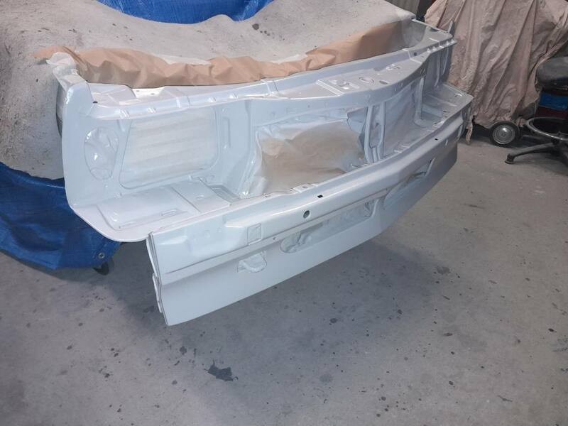

Managed to get a couple of hours on this the other day to get the back end rubbed out.
20210618_165347.thumb.jpg.ca84514d45ad3bda5a8e3cf19a583a77.jpg.ea16340951008cde47d28ac9b6f81979.jpg
Just got the top edge adjacent to the boot seal to do, then with a bit of luck this weekend I'll be getting stuck in to fettling the front end up to the same stage as the rest.  :)

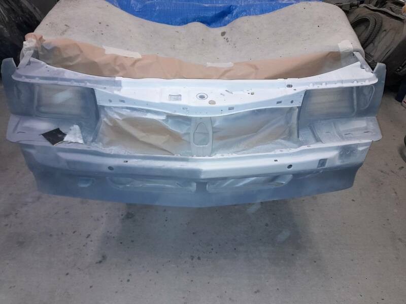

A refreshing change of scenery today -
20210619_134420.thumb.jpg.7a5d720eb8dc983b965af0a4e2c1558e.jpg.df99acd3fa601b17bb00deb3a5c64f83.jpg

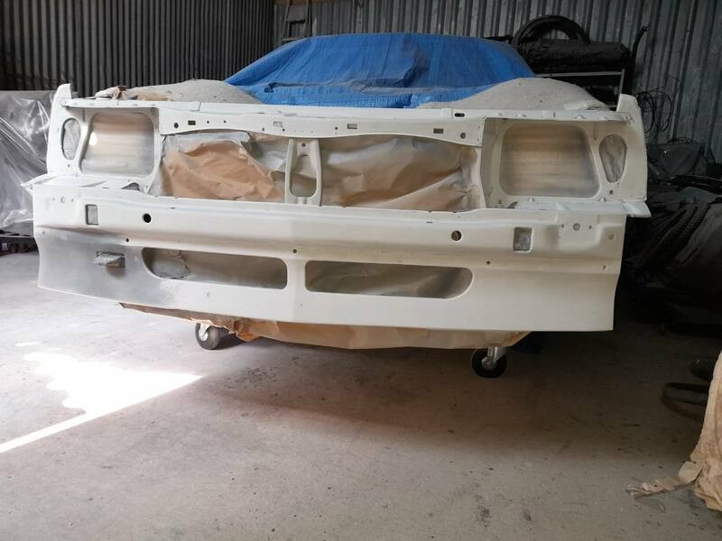

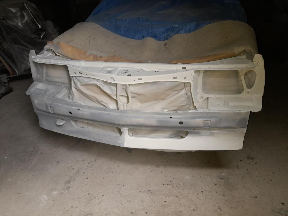

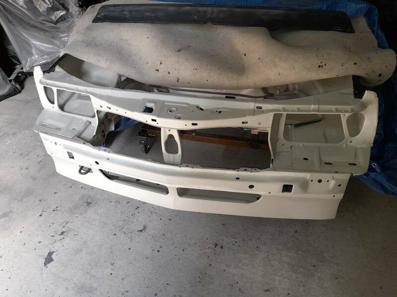

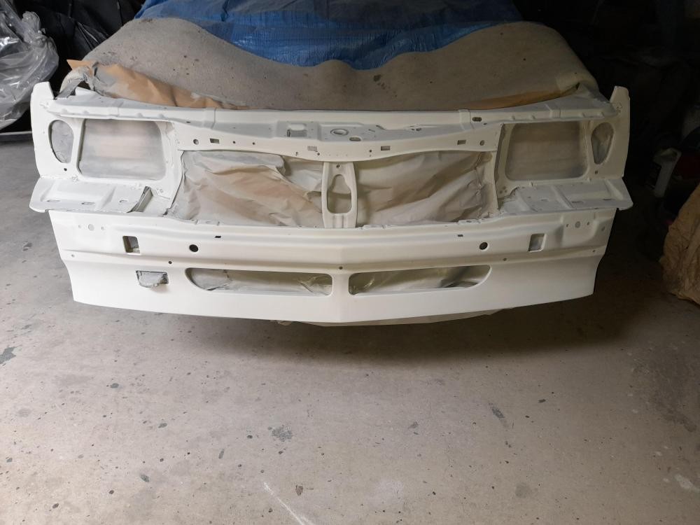

Front panels got a few skims of filler here and there to tidy up some of the welds, then it all got a good rub in preparation for another coat of epoxy primer.
I thought it was probably a good idea to finish masking off the inner wings before throwing any paint about -
20210620_135728.thumb.jpg.4e28d0088e2e871b80bc89c6ab23f1e2.jpg.6f266aebf12ae8d7f8ba07a19be4e073.jpg
20210620_144332.thumb.jpg.5233c6d0ee59c7966bd7fe15df7a0ca7.jpg.d54d8a0d10fd158ebb96b96d3585ebbf.jpg
This used up my available time, so I'll have to get stuck in on my way home from work in the coming week.

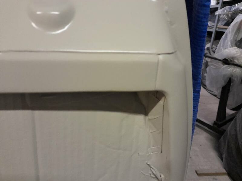

Before getting stuck in to the engine bay, I thought I'd better try fitting the doors to make sure the arches line up right. The nearside was spot on, but the offside  was a bit off.
20210704_121057.thumb.jpg.f5408e5d503cc33f5c1f9d9f9447cf21.jpg.ae5f149425b8094649d9606170a7eb1a.jpg

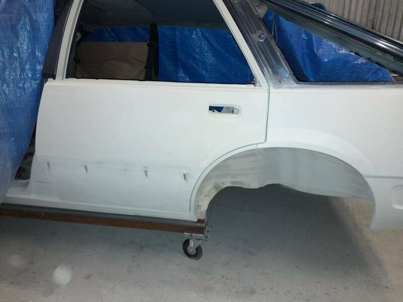

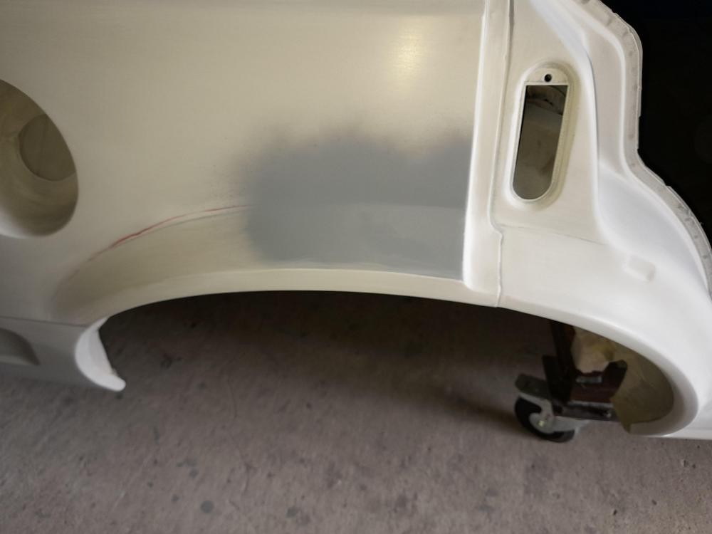

It looks like I put the arch profile a little low at the front of the quarter panel. It was only 2 or 3 mm out, but it would have bugged the hell out of me if I didn't correct it, so that's what I did next.
The front of the arch was re-shaped with a little filler, then blocked into the correct shape.
20210704_155853.thumb.jpg.d81a9b6d41c9a66d974cef7db1d407b8.jpg.54fccd7f7ecf6ecdcd95972bc2eeec60.jpg
When satisfied it all lined up, I splashed a bit of grey primer on it while I get round to re epoxying the quarter panel.
20210704_180421.thumb.jpg.c620f67e88a6177507fa905dfc97b9ed.jpg.44ad80a62c2c3695b003e28b1d02d0d9.jpg

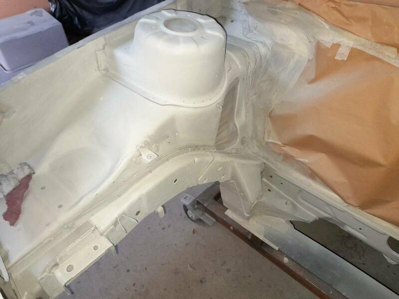

Back to the engine bay next.

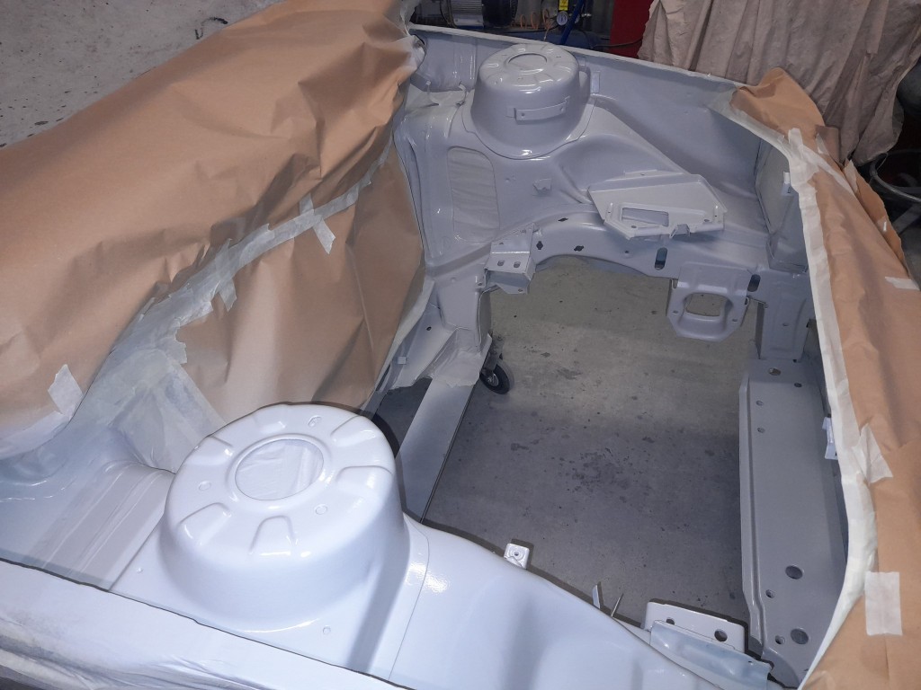

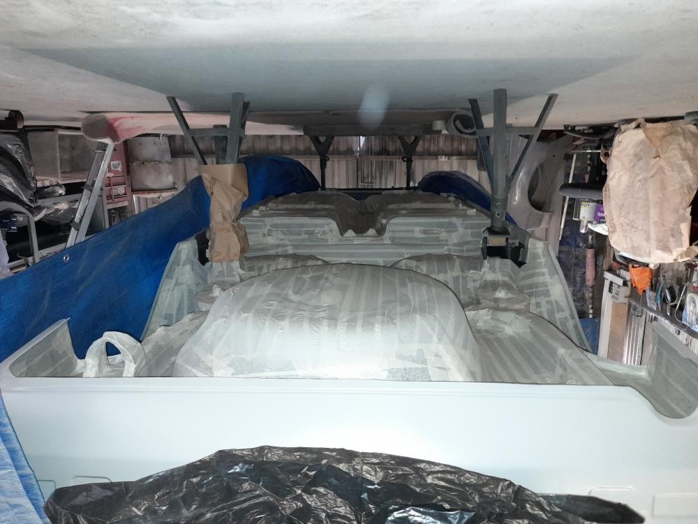

Been doing a bit of rubbing in here on the way home from work.
Extremely bored of paint preparation now - fortunately it should be ready to go over to the paint bloke by the end of the month. 🙂

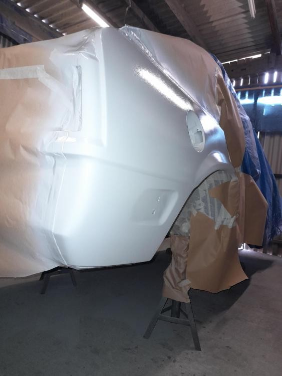

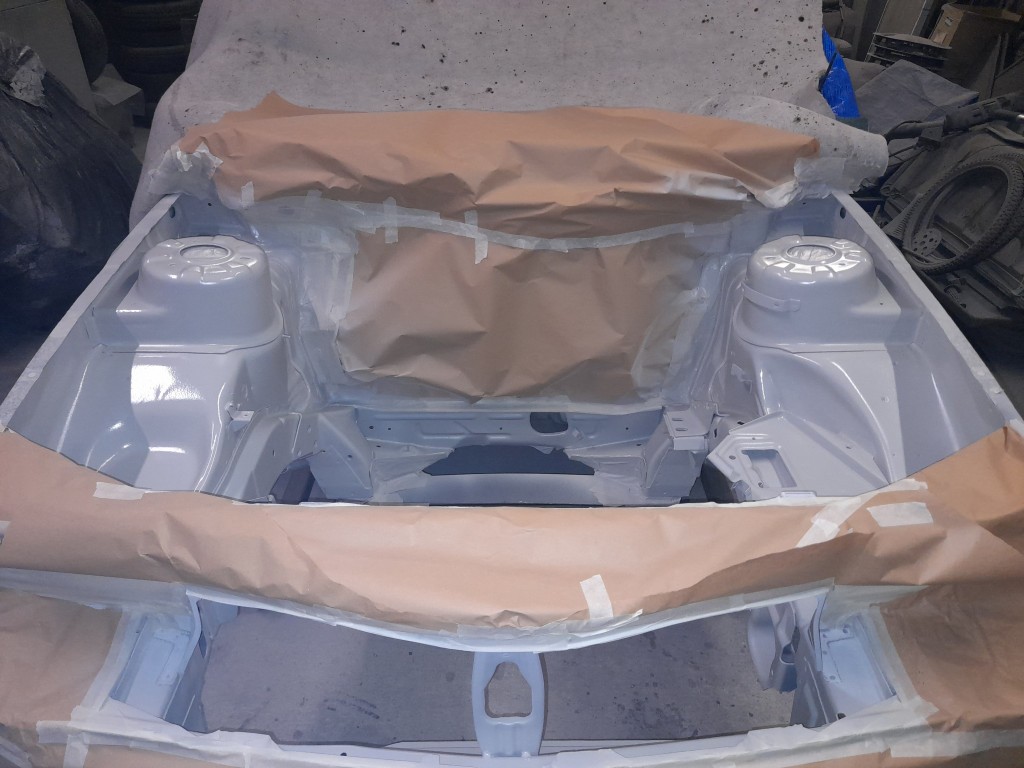

After more than enough rubbing, it was all thoroughly cleaned and masked up.
And after another coat of epoxy primer.

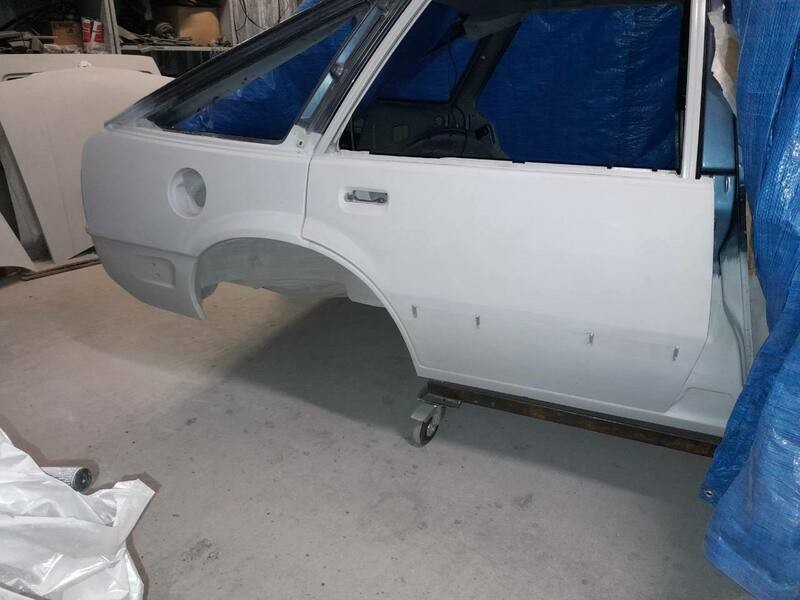

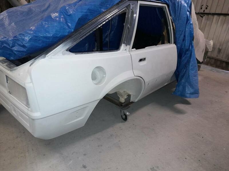

Rear quarter was rubbed out at the weekend, then plonked the door on today to have a weigh up.
20210712_173834.thumb.jpg.2bb0b46b3273047bfc3c2d7e0576f670.jpg.a11c15a449e4739a00c184ee3c84f114.jpg
20210712_173854.thumb.jpg.90d3f7ed5136c5cb6ed3ea8f31f38c20.jpg.a377d844870e75078b01cf3a9562585e.jpg
It's a lot better, but not quite 100%. I may have another little fettle at some point time permitting.
The nearside is pretty much spot on.

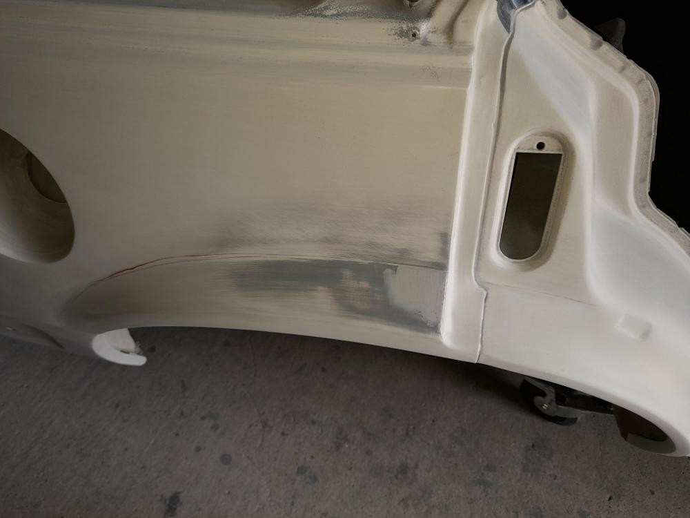

After playing with doors + umming and ahhing for a while, I got a bit of guide coat on in the engine bay, then made a start on rubbing it again.

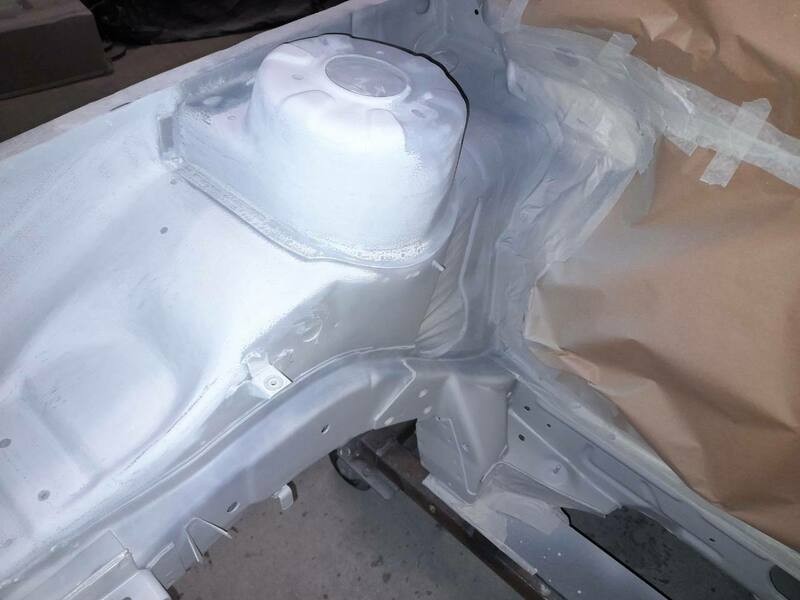

It's been a bit warmer than is comfortable in the shed of late, but I still managed to get a bit of rubbing done. The offside is mostly done.
20210714_190643.thumb.jpg.a5c847b76d2019181367368ba30627d4.jpg.17dea2ac989c05ff2793b86e592b1de0.jpg
Got started with the nearside turret, and ran out of time.
20210715_191842.thumb.jpg.a751798ad5126abb48eade01332d1897.jpg.76345a56b14caa2567f93f241831045a.jpg
Should get back on it over the next weekend.  :)

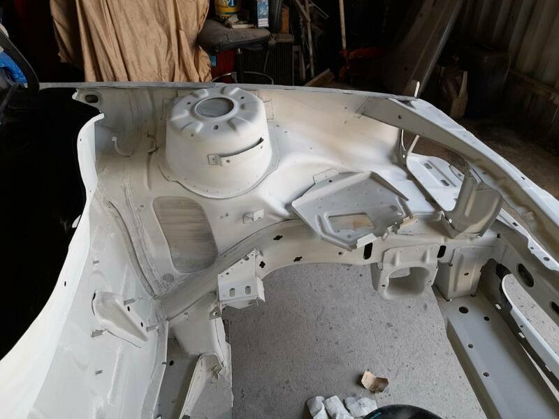

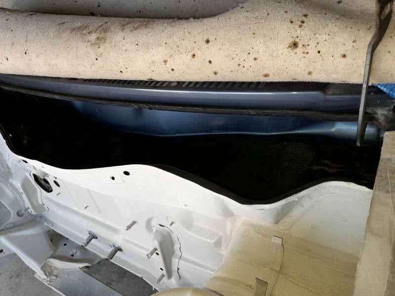

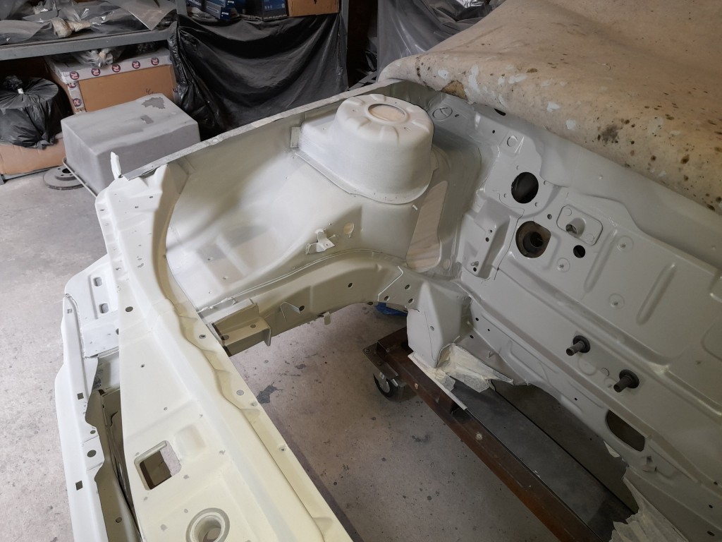

First job of the day, the heater blower/ scuttle area was cleaned up. After all the muck was removed, it looked fresh, so this area will be masked off and left as is.
20210718_124329.thumb.jpg.f65270e1da8f9cca7aec35dba88105a2.jpg.b7e9b57b041ee9b177354d155cde03e6.jpg
Nearside of engine bay now rubbed out.
20210718_124433.thumb.jpg.fa8200fa12aff42b921a8bb37881bf82.jpg.5970e51779ed8fe2db6feb930cea5ffa.jpg
Just the bottom half of the bulkhead left to rub now.
20210718_142415.thumb.jpg.e2933b85fc8259da6c7b49e70ffbe4c0.jpg.135a75b2239126cd337f0f1525b10d22.jpg
Should get that finished up one evening in the week.  :)

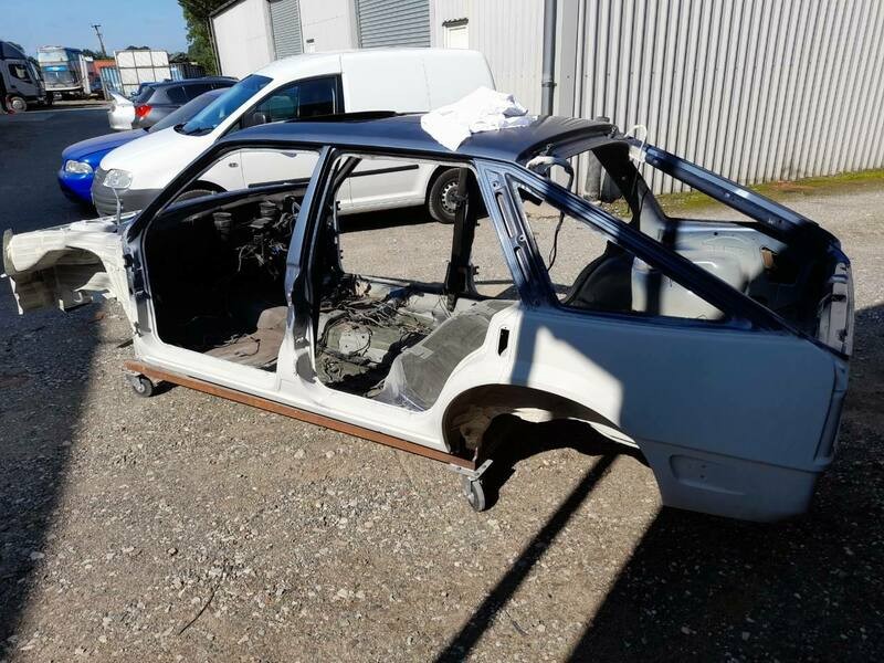

Last week I have mostly been taking the shine off the bits that are still blue. Still got a lot of rubbing to do, but the end is in sight. Today I also dug out the build plate and riveted it back on to the slam panel so it can be painted as it was originally.
20210723_172404.thumb.jpg.8b4ce23a27847727fab4cd064e1fb9f3.jpg.6e1400a743365037b4cce9f8d7065f77.jpg
Been grabbing the odd hour on this here and there this week, the c-pillars and offside are pretty much done, this picture was taken after making a start on the nearside.
20210728_173539.thumb.jpg.3c60eda6f7feddc5c32dcd0713880420.jpg.b6fda41d64c4a2643cc7d3fc26e9518a.jpg

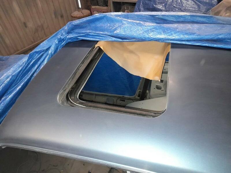

The roof was also finished up this week.

It's the first time this has been out of the shed for nearly 3 years.
20210803_101052.thumb.jpg.cc61615e6d2bfb340afdda0678ab7d45.jpg.f50b5e15c7b4d6b707aeac1b969c8ec4.jpg

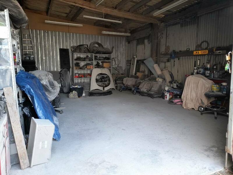

Time for a good sort out now theres plenty of space.
