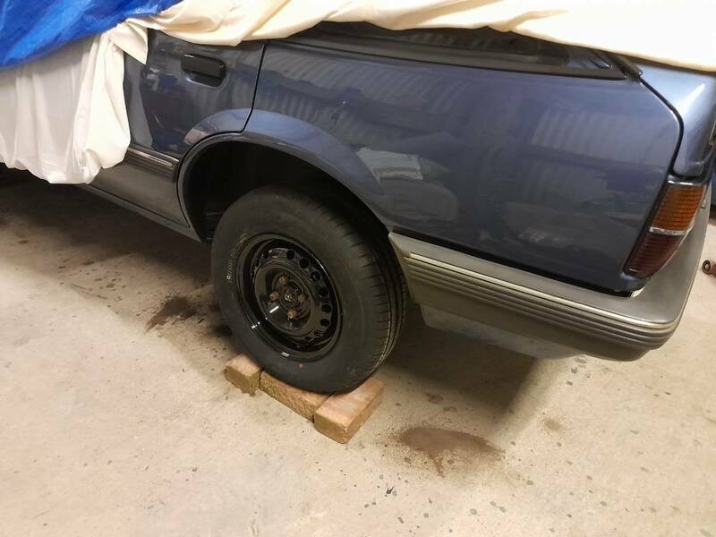

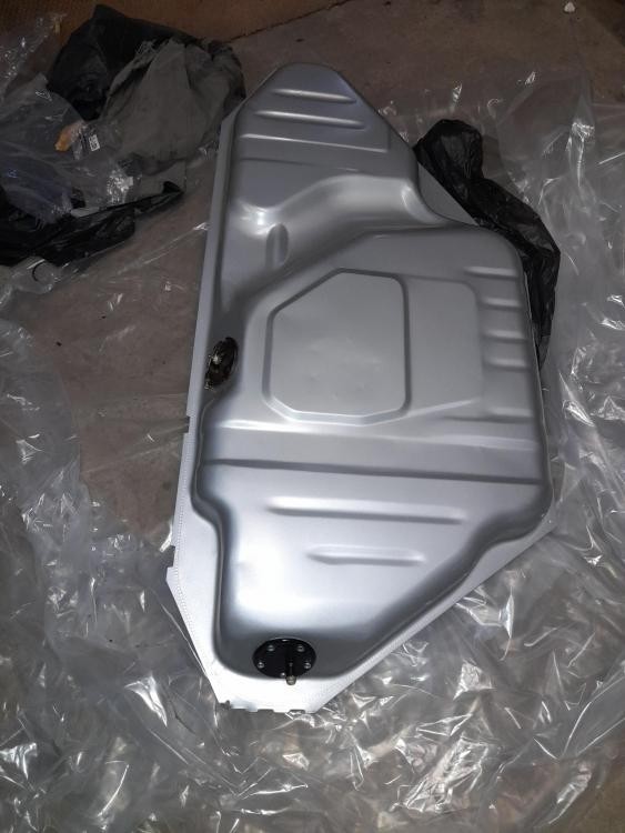

I spent too much time finding some new screws for the fuel pick up in the tank today. Eventually the screws and seals were found, and the pick up and gauge sender were fitted to the new tank.
20210918_162727.thumb.jpg.ffe40e42e50b72562de633d38c5afb17.jpg.896d285df32bfaa76606d8f11035fd9a.jpg

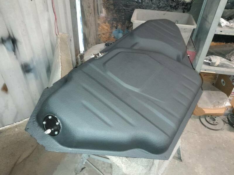

The top half of the tank was then keyed up with some 180 grit sand paper to prepare it for a good coat of stone chip paint,
20210918_173951.thumb.jpg.203b10d887ea05816410eb27270b5480.jpg.87471edd8fcdb929cd32e633bd2ea5b0.jpg
I'll do the bottom half tomorrow,  then once it's been coated with the underbody wax, it can be fitted.  :)

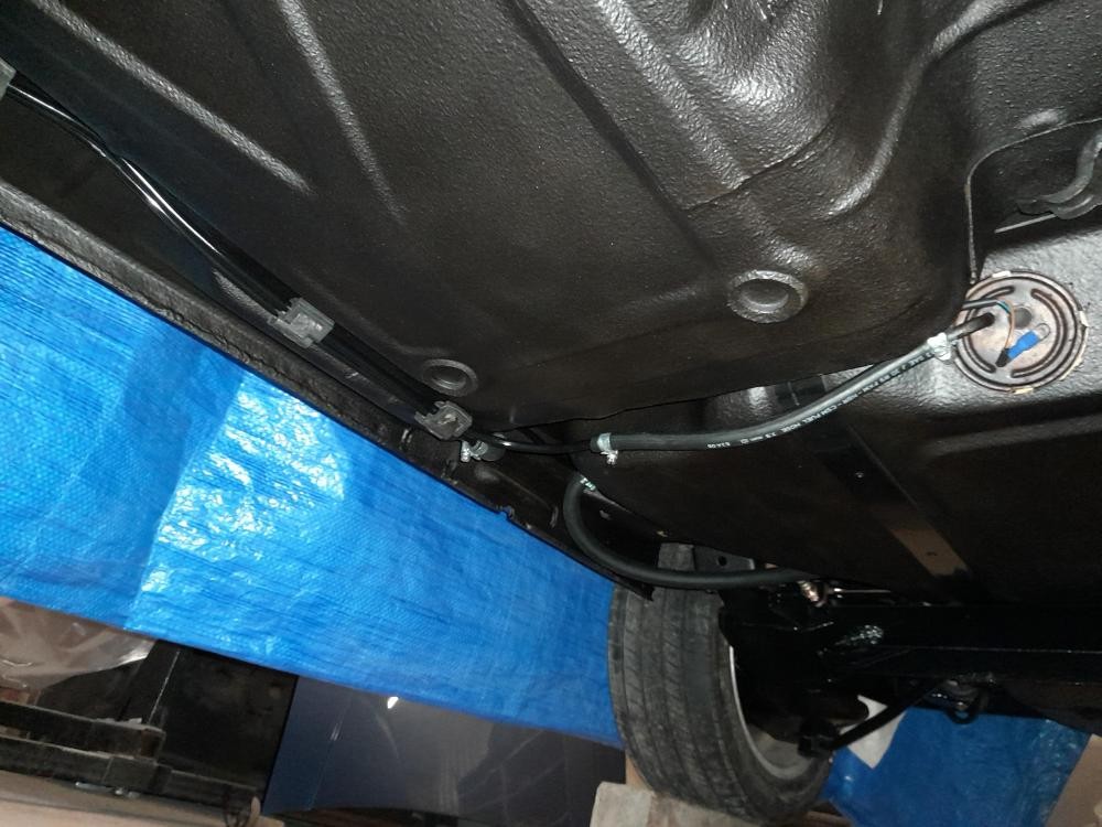

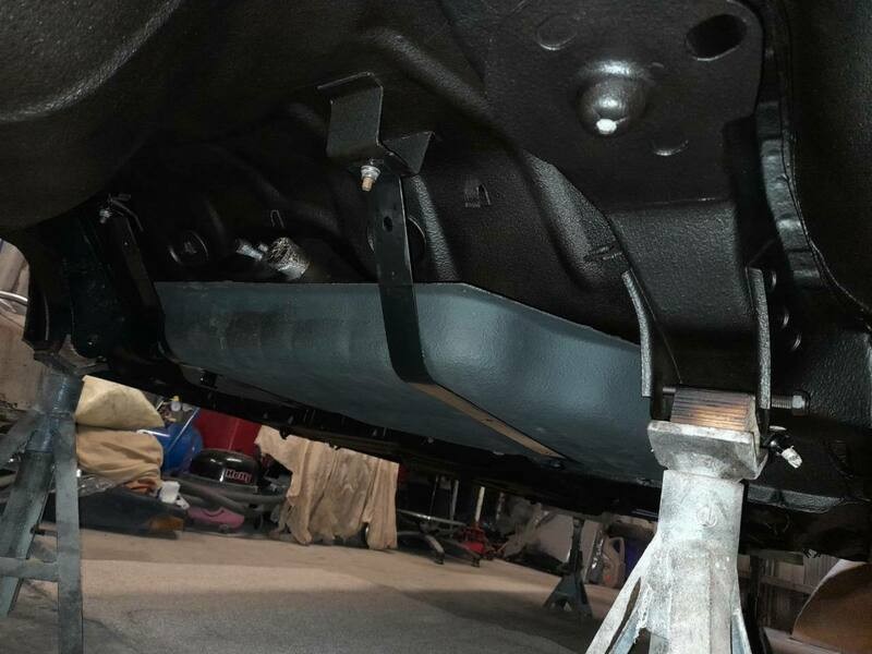

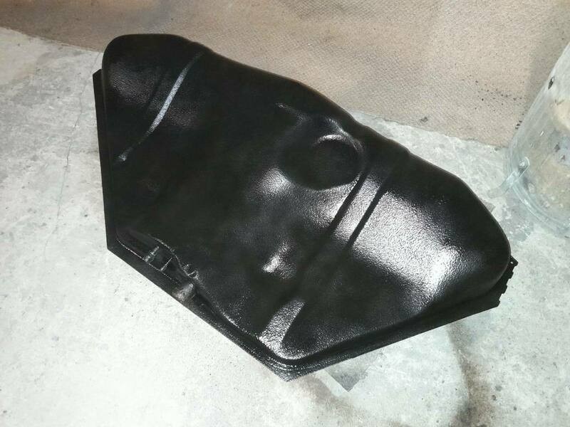

Got the day off today, so got on with this in between other jobs.  :)

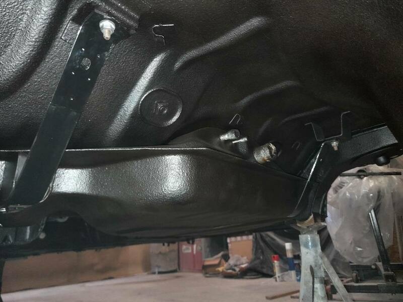

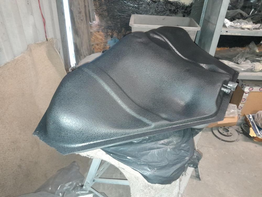

The underside of the tank was stone chipped.
20210920_182221.thumb.jpg.0615eb5162eea497f8a99a13798513a3.jpg.d9c725348ac2b4c43a396b7708bda140.jpg
Then the top side was waxed.
20210921_064014.thumb.jpg.88015cd8fcce3d3fd9ed2c95411b3a3c.jpg.f9bab4bcaae3a0da5d7bb82f518592e6.jpg

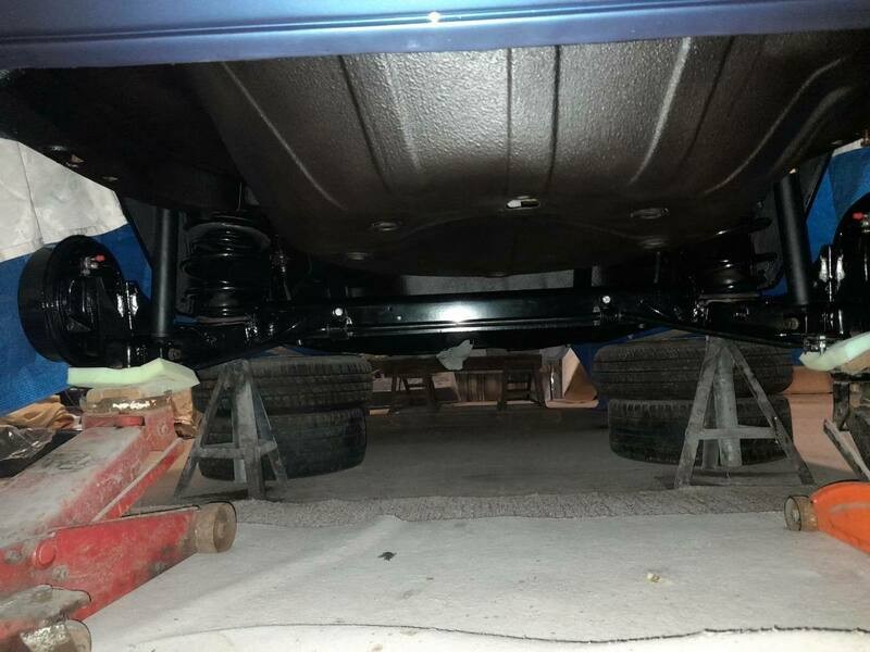

It then went into position (easier said than done!) leaving the underside unwaxed so that I didnt leave hand prints in it and generally end up covered in it.
20210921_093747.thumb.jpg.083a37e8ab39dcd32f58d372b03f6b80.jpg.16a1d8c6d1b6b4f563d2ba93d2e2bda9.jpg
It was then propped in position so I could wax it before putting the straps back on.
20210921_134549.thumb.jpg.ad2ca8997273171a7549faad6006ac17.jpg.db5c9a59eaaf7235ed2b0b48b7de889c.jpg
More underside related goodness to come at the weekend.  :)

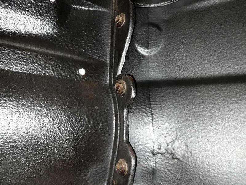

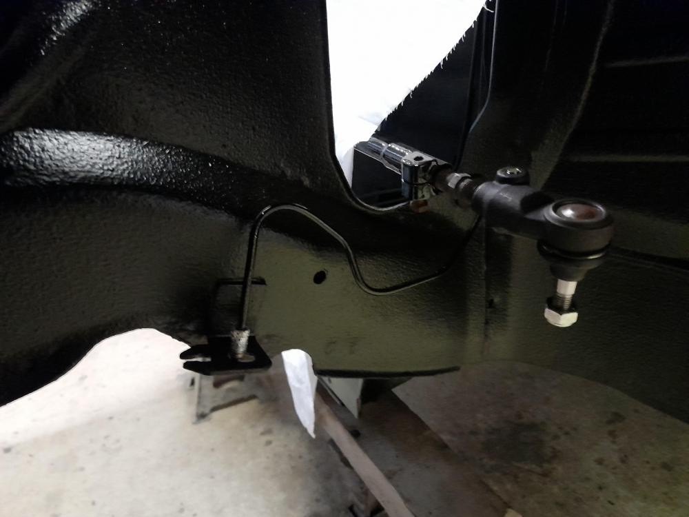

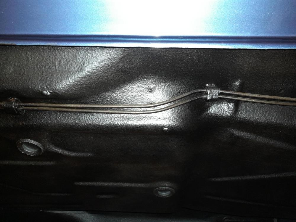

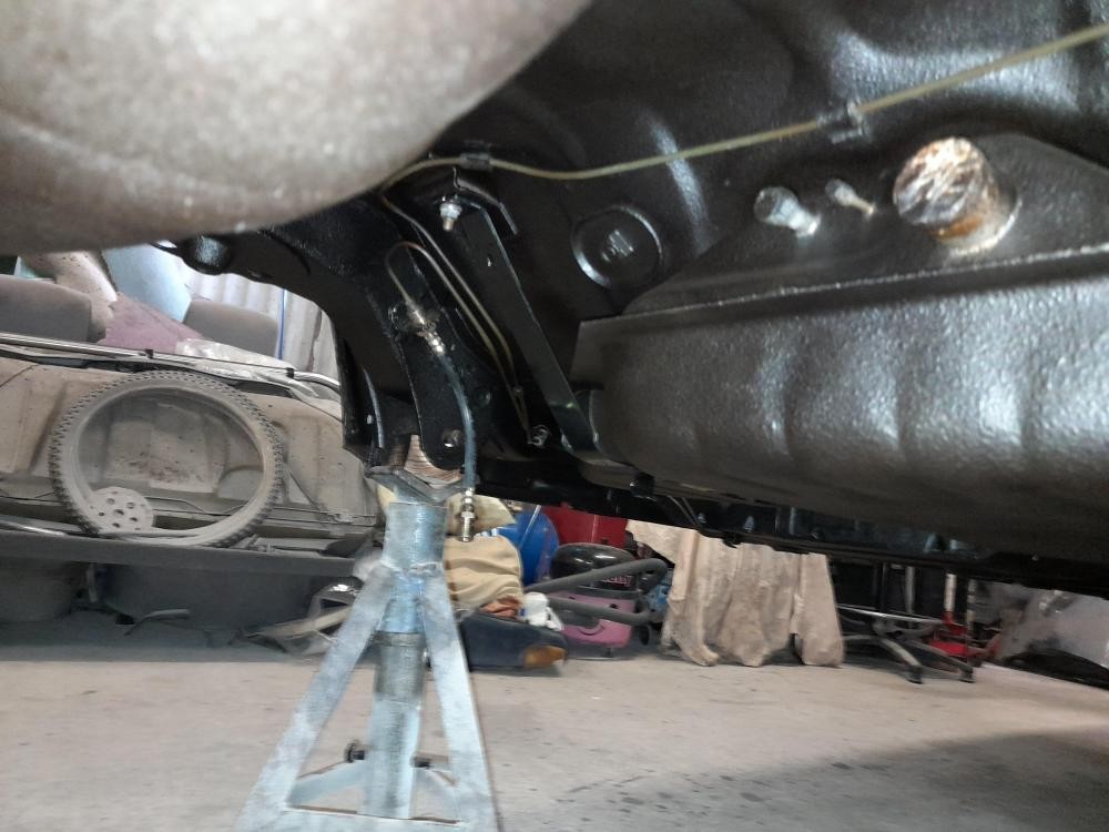

Brake lines went in this afternoon, I had to paint the front lines as the green coating had been damaged.
20210924_162613.thumb.jpg.3a483aa6cfae23cd9832a6533fcbef4c.jpg.7547846ed2649fa2119dc2dd1801cc31.jpg
All clipped in on the bulkhead.
20210923_193411.thumb.jpg.031edccb1c32822370e31de5ced6ba9d.jpg.e6161a096290666ccd502e7b598e2d0f.jpg
The same out back.
20210924_163046.thumb.jpg.1929f2e37059519e7d8e12364b6d3d93.jpg.cd2ab33d5f1196b8bced2a79083a9f99.jpg
Then given a good spaffing of wax to protect them.
20210924_163222.thumb.jpg.0ac6cfdda1b76ae62f4a4378aa91ee89.jpg.5d0a3eef12ff991c419c7e83a8fe4af9.jpg

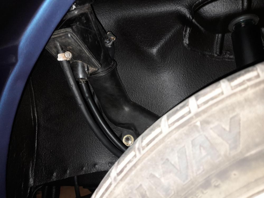

Plenty of wax dripped out of the drain points! I'll check to make sure coverage is  good with my endoscope once all the excess has dropped out.

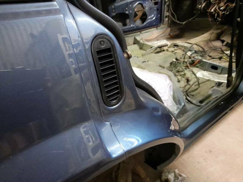

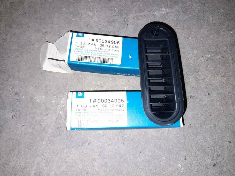

I dug out the new door aperture vents now that the waxing of the inner arches is done.
20210925_134204.thumb.jpg.40ae2a77d523958d35c8b2bc170cae8a.jpg.35d5e5a408e14932949ebab8bcca89d7.jpg
And chucked them on.
20210925_151310.thumb.jpg.974a5d320b5aaf65cb87f022abc16ba2.jpg.966711d7e7d3b560afab782f96d53855.jpg

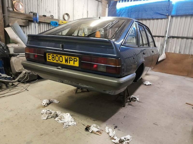

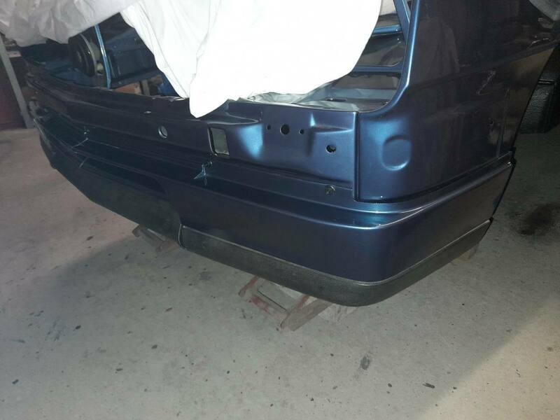

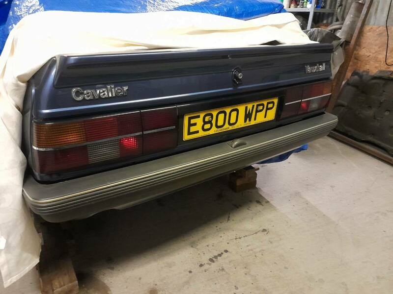

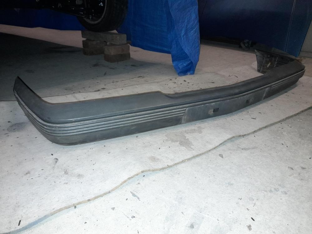

Before I finished the session, I put the rear bumper on for a look.
20210925_172140.thumb.jpg.2f2f120229dca7b09d02c3298f1f601a.jpg.7c323cc0c3ccae9680066c51d3bbebd2.jpg
It does let the side down a little as expected - I may try a textured paint to spruce them up a bit.   :)

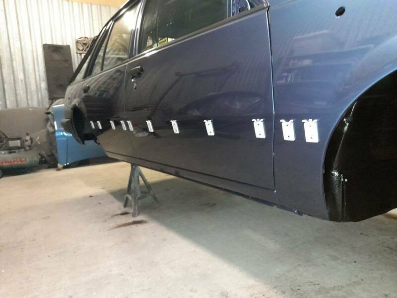

I was worried that the clips wouldn't fit properly as there is a fair amount of paint on there, but they went on a treat.
20210926_105218.thumb.jpg.aa9343b4e7f8d608081e1435d52193f9.jpg.82bbb046326d0b1d58efb029d9cd1044.jpg
Rubbing strips went back on with similar ease.
20210926_114953.thumb.jpg.59173496ebf20a393f41d8817f075463.jpg.d6614215cdc05e32e8661c30a7198695.jpg

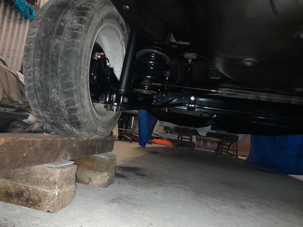

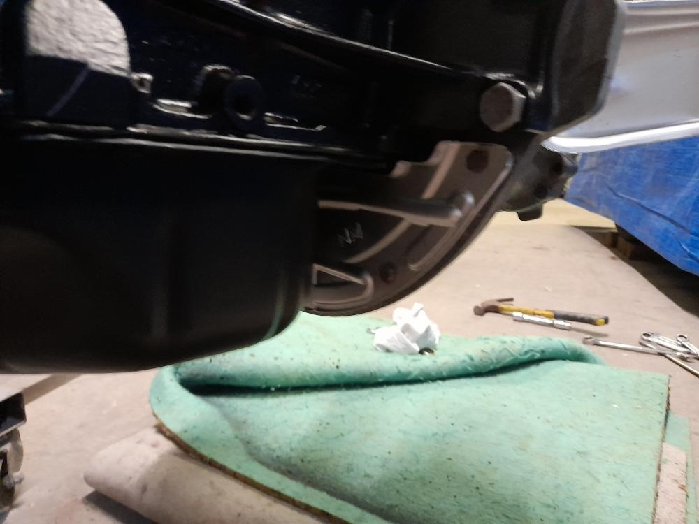

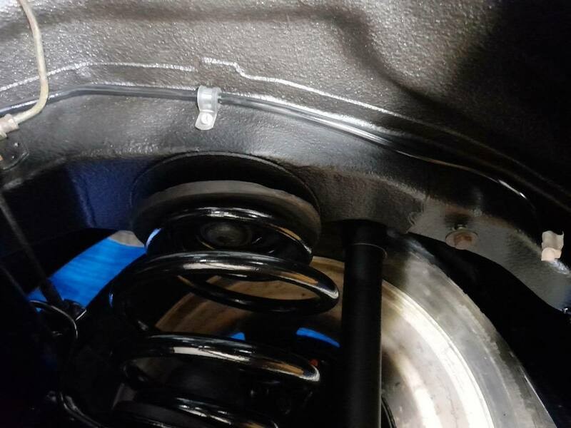

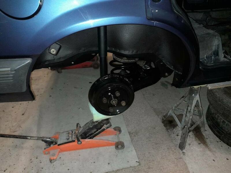

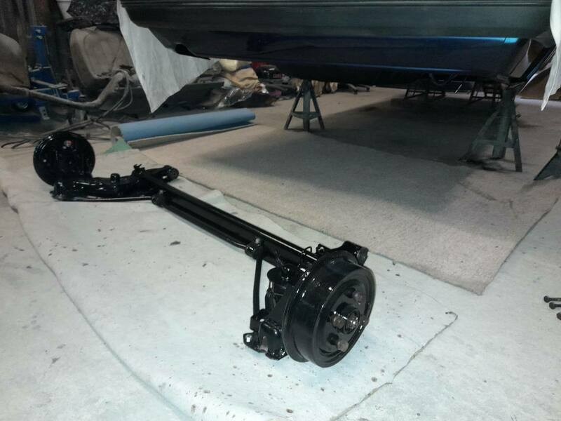

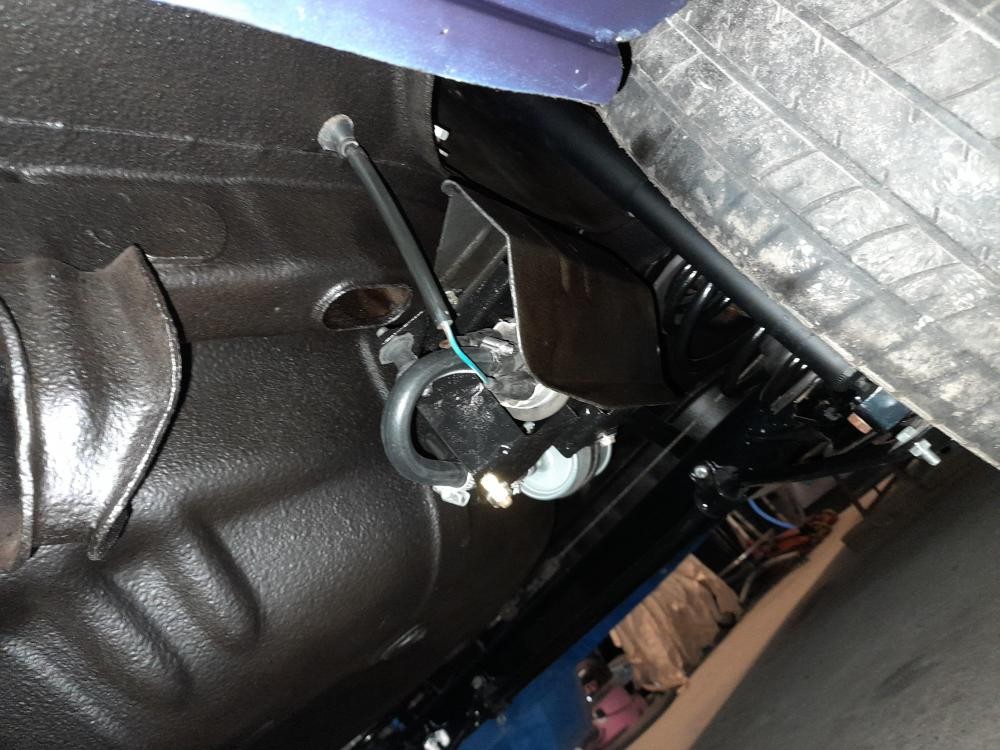

Still no fuel pipes, so got on with putting the rear running gear back in. The built up beam was slid under the car on a piece of carpet.
20210928_113821.thumb.jpg.de21e23694dbb165261e75cad85b80d0.jpg.9f31067276fb49f1a3b2e6531d22a9ff.jpg
The body of the car was at a height that allowed the mounting points to be shuffled into position without lifting the heavy assembly off the deck.
20210928_121721.thumb.jpg.49b660ec6efb0bd286eb99876d7303ea.jpg.08bad74f85d615048cd9ae8495288c02.jpg
A bit of jiggery pokery with a couple of trolley jacks saw the springs and shocks in position. I'll leave tightening the beam bolts until it's been sat on its wheels for a while.
20210928_134236.thumb.jpg.e418d4df961fdb01001fbb080924f11b.jpg.90f057d262f4fcbb38394f35f0caeafb.jpg
I'll fit the handbrake cables and adjust them up next, then I can button up the drums and get it sat on some wheels.   :)
20210928_135400.thumb.jpg.9a8c158e3c05e814d4d0998a68728a16.jpg.78e4829dc27d4a9357cae13c3c4ff044.jpg

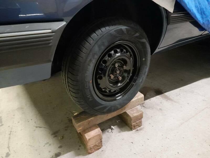

A short session today, the hand brake cables were fitted and adjusted up. A pair of 6N Polo wheels were then fitted to enable the removal of the axle stands.
20211001_155811.thumb.jpg.e976f56710ae1dee4d253a8da6d7debe.jpg.461067ad058d8a2447ebf653693bcdb5.jpg

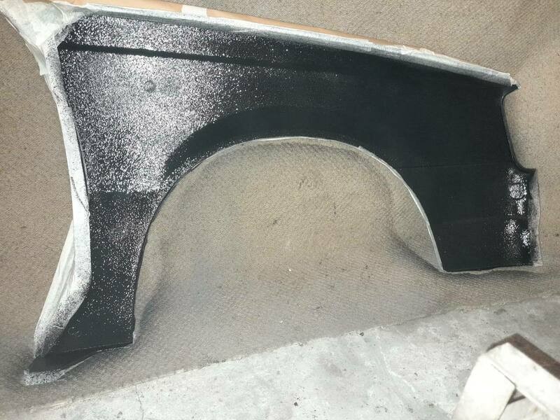

The wings got a good layer of stone chip, still waiting for more wax to arrive to finish them off though.
20211008_164523.thumb.jpg.904e05fac41e6de9046993786520594f.jpg.60ad89f5bed579e3aef6cc49fcd4c8f1.jpg

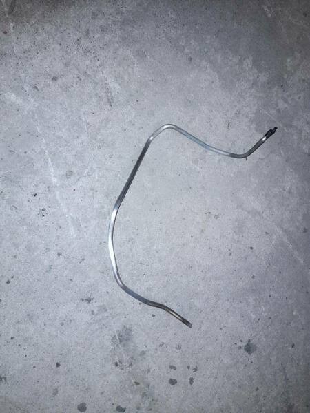

Got the metal fuel pipes mocked up, the one that runs down the offside rear chassis leg is also done. (All three are now painted too).
20211009_161601.thumb.jpg.bf79e62d491172d998163972fc72b024.jpg.71d667f5b2dcaa85ef6dce3c8e092074.jpg

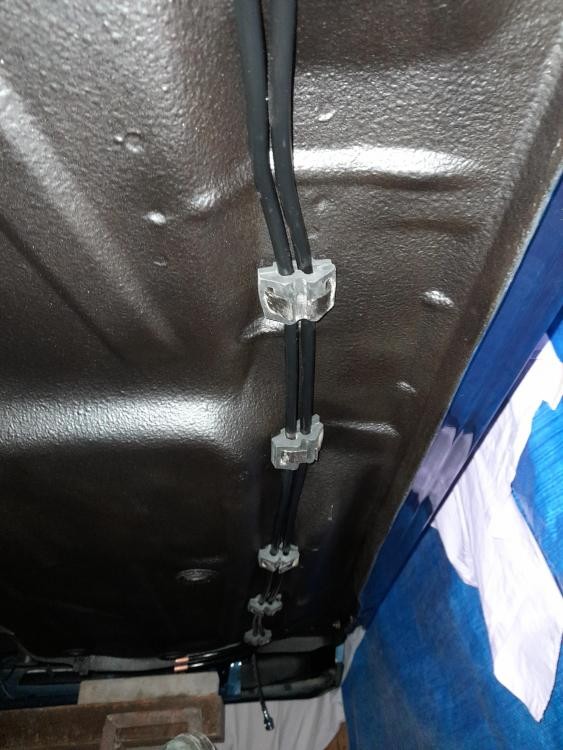

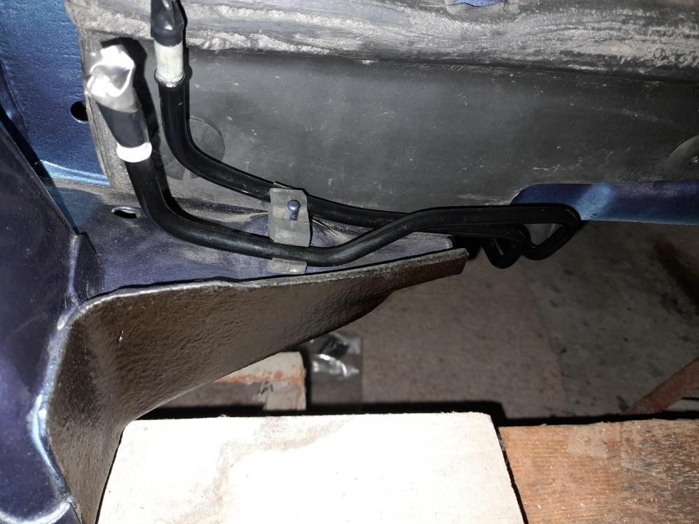

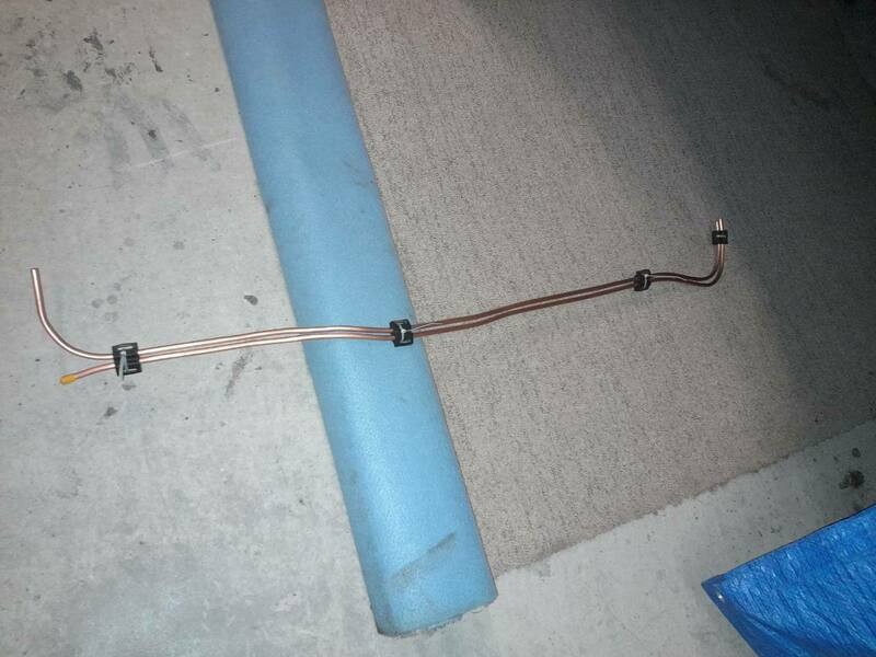

Chassis leg fuel line now p-clipped into position.
20211015_115327.thumb.jpg.d7b83f243663eb21167b1509f1669b77.jpg.d6e8a7082b5cdf62a266e8be17db8348.jpg

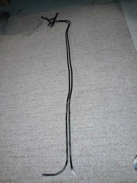

Front to back fuel lines now ready to fit.
20211015_120011.thumb.jpg.576603fa32abb2418c8c4deb592e5d16.jpg.061890469fad028d297cc51e6abeb3e3.jpg

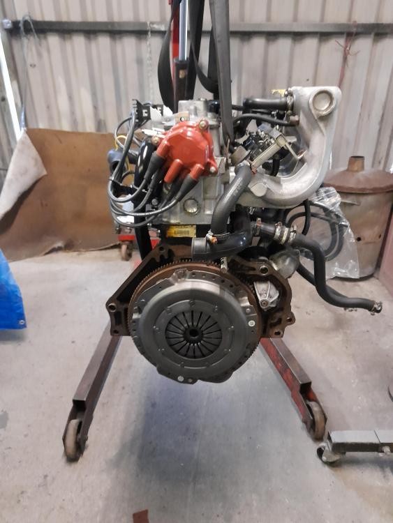

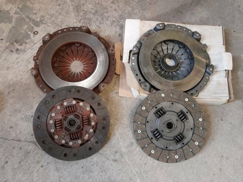

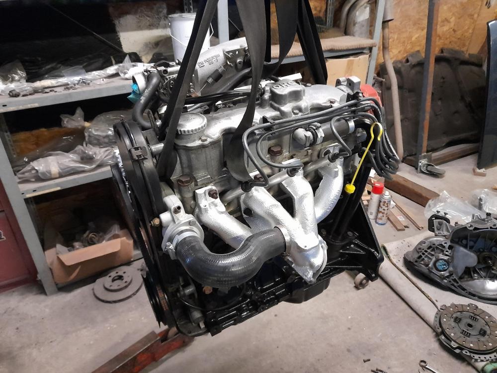

I now finally have a new clutch, after being sent a several that were wrong.
20211015_142555.thumb.jpg.4011380cdfab09042cf726039391198e.jpg.e7eba9d8a9ff479db87248e1f6dc005b.jpg
LUK branded - should be reet! :)

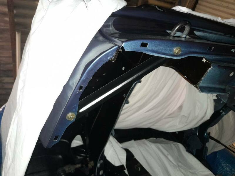

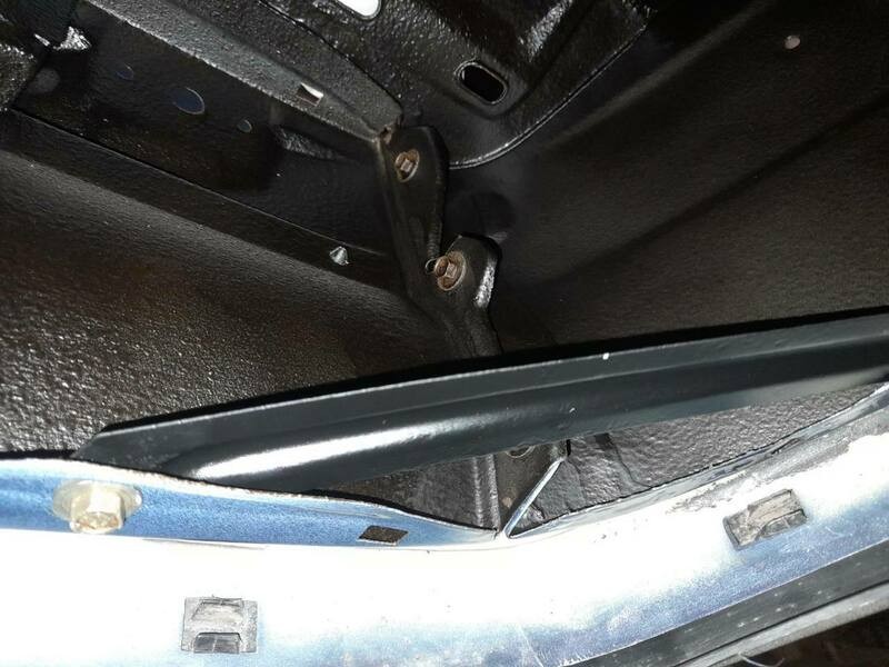

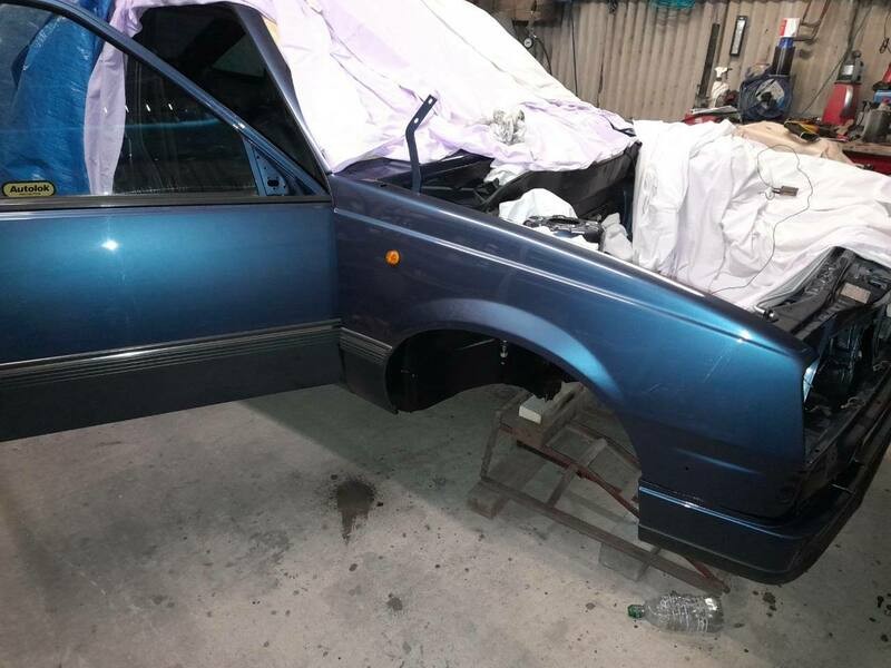

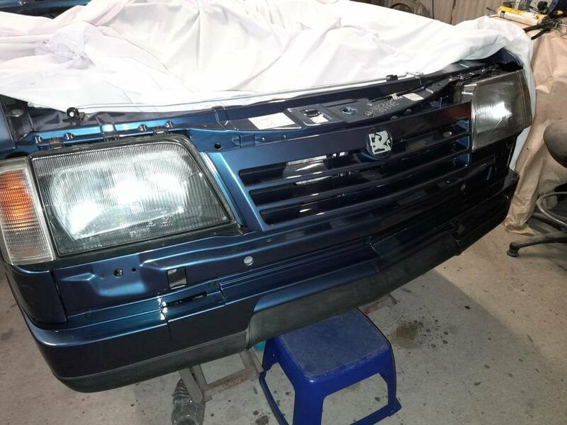

I've decided (after a couple of close calls) that the wings are less likely to get damaged if they're on the car. After fitting and gapping, the fasteners were hit with the underbody wax.
20211017_174315.thumb.jpg.de11b4d9518deb36d66d45c0a5b860aa.jpg.59817082d846c8f3afe0adb2a1efae07.jpg
20211017_174259.thumb.jpg.77599e3f0740126e103c80be9c5057e1.jpg.77197e745b8a3118def96ebc4704d5e0.jpg
I then fitted the little brace bars between the wings and valance.
20211017_174129.thumb.jpg.02332016e027d7078f69623c4b2973db.jpg.2dc19264c54582fa04d1fe83a0fcc37a.jpg
Before realising that the chin spoiler type thing needs to be in position before the brace bar goes in.
20211017_182151.thumb.jpg.1cc935b211f3a12c773ae4ff642d9793.jpg.43e2fe60451218883b43ec90071fb384.jpg
All in position now.
20211017_182631.thumb.jpg.4b15910e04fdf59bb405cbca29713a6b.jpg.4539c9cc25eb6e128c4c15ea0eee3791.jpg

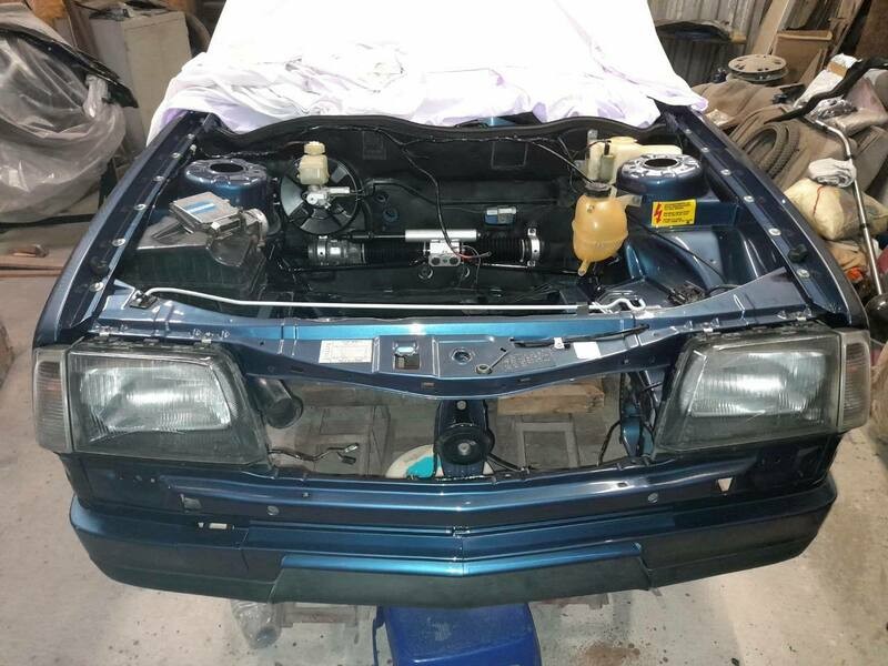

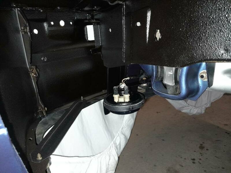

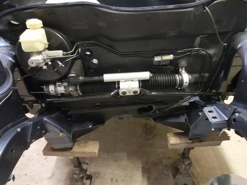

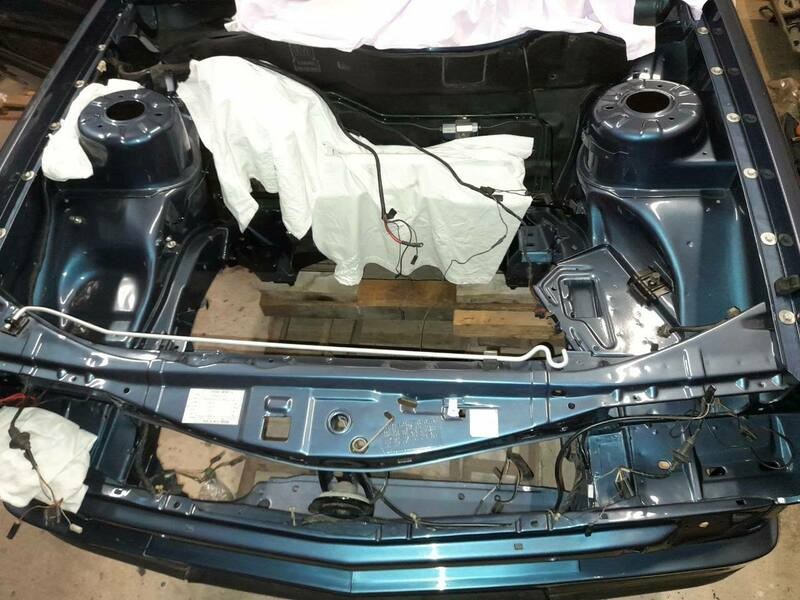

Still waiting for 8mm fuel pipe, so cracked on with stuff up front. The wiring loom was pulled through the bulkhead.
20211022_163043.thumb.jpg.91481bacef3bc1d03ccb863f21fef550.jpg.02c58c9e83637698f774be6f5682f6df.jpg
I got it all roughly in position to remind me what goes where. The plan is to clean it all and re wrap where necessary before securing it in position.
20211022_171025.thumb.jpg.6e80e67b35c7251c6111dad7f2721400.jpg.56b0f0601cd55698e2b253dbb9723aee.jpg

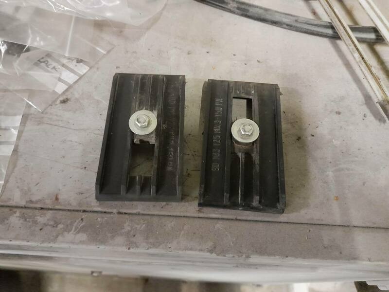

Fitted the rubber isolation blocks that the air box sits on - I found these on Ebay, size wise they're spot on.
20211022_171228.thumb.jpg.9a3d63eeabb7842a154f714a03077f60.jpg.a63b02787a292882576048f5be8207a1.jpg

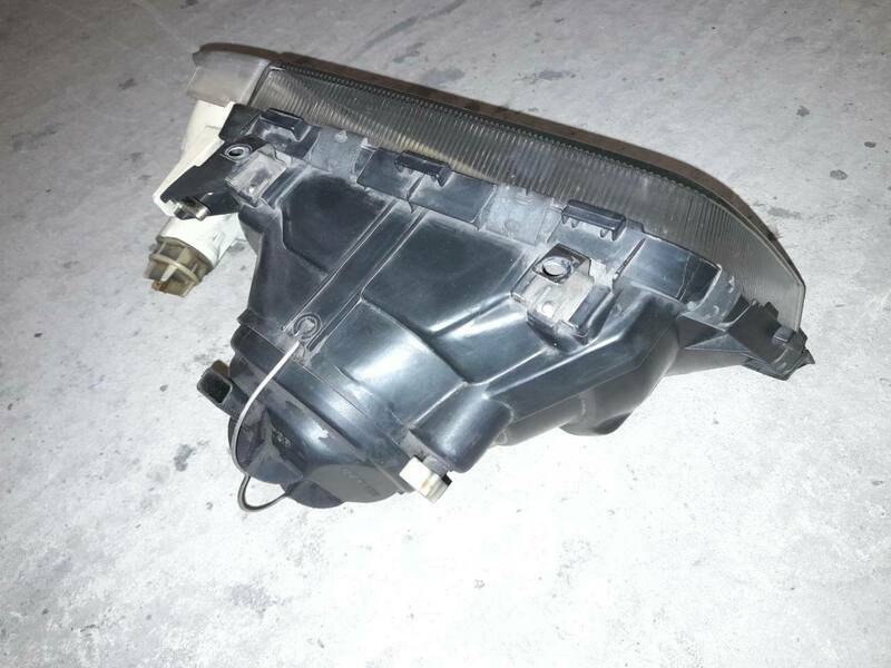

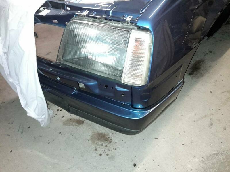

Before fettling the wiring loom, I decided to clean the headlights so they're ready to go back on. Seen below after the majority of the crud was removed with a cloth and panel wipe.
20211022_180108.thumb.jpg.154fd566ad262f945a4712eec15983ae.jpg.8cd1cb48f6fe961068263c4fd7e569e1.jpg
Popped one in to marvel at the annoying gap between the top of the indicator and the wing that all mk2 cavs have.
20211022_180648.thumb.jpg.f6f2df62e274f7fe36afb238a45badf8.jpg.b4a9c943740cc79d469b484ab2d4c870.jpg

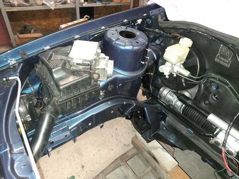

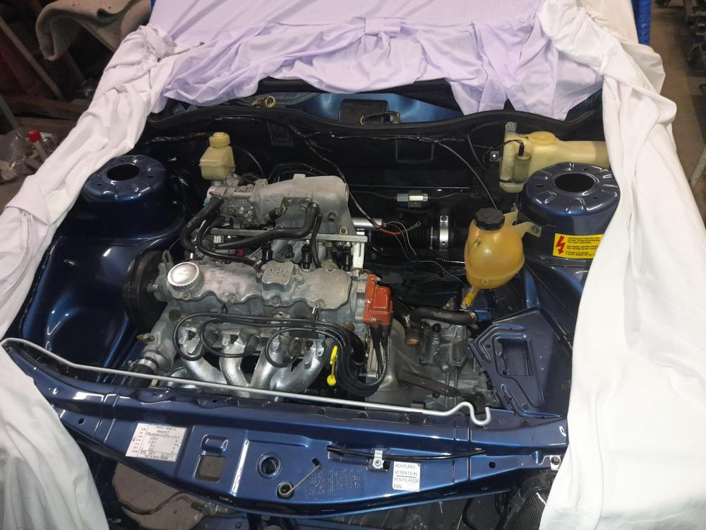

Loom now fitted and clipped into position. Assorted furniture put in to remind me how the loom goes.
20211024_141534.thumb.jpg.43d3b4cf26c8282668142c9bd5dfe9e2.jpg.0d63aced280238cb69a0883785b1e191.jpg
Air box needs a good clean before it gets fitted permanently.
20211024_141553.thumb.jpg.35b24127dd51b2c4b3690f116cab382c.jpg.c6067577bd58c944e6ce116e193cdcb1.jpg

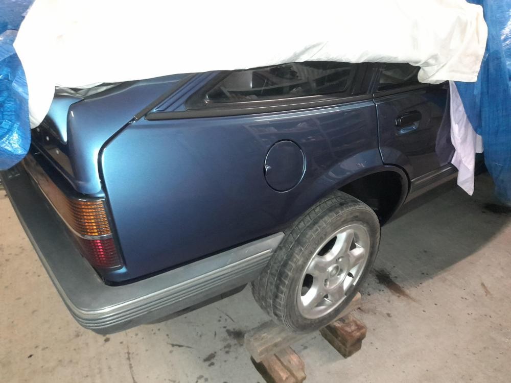

Had a look round the back end to make sure it's still there - not had the cover off for a while!
20211024_143359.thumb.jpg.35f9099e773b3df5d510cb29f4dc3c6f.jpg.c51bfe74947c7018c72e767314192787.jpg

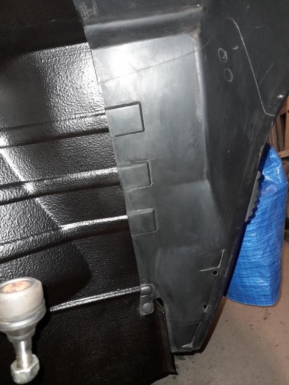

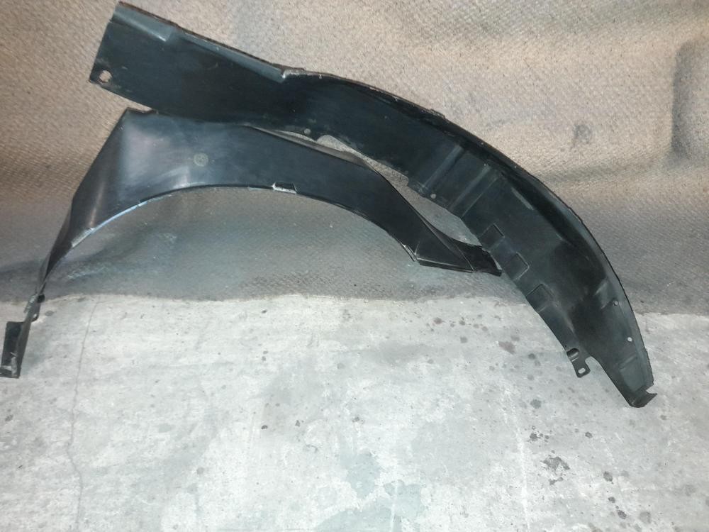

I could fit the arch liners. After a good scrub up,
20211028_175633.thumb.jpg.5bd0acf83a6c107ddcaf5834046ef96a.jpg.f76377c6576fce5abc37caeb5a88e59d.jpg
they went back on. I'd forgotten to drill a new hole in the offside inner wing when I repaired it a long time ago, but it was easy to do with the liner in place to show me where the hole needed to go.
20211028_182431.thumb.jpg.b3d261083a090f9b126e657954ed9451.jpg.648d393d8e3010e006fef368df0da604.jpg

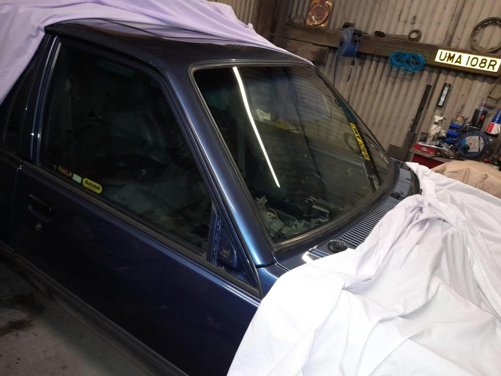

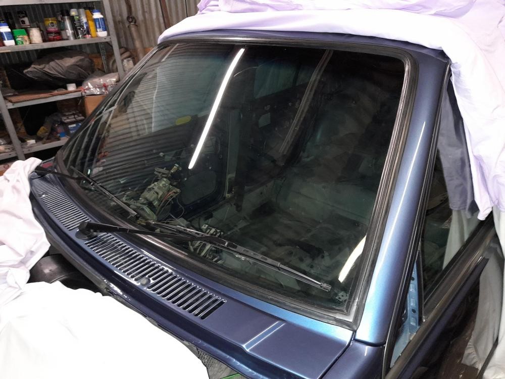

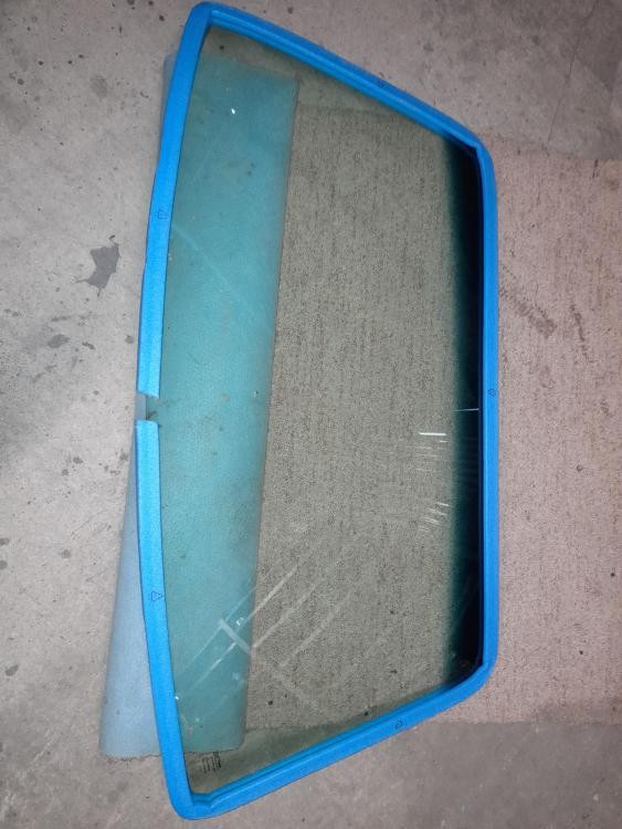

Pilkington delivered my new screen today,
20211029_165630.thumb.jpg.f3b64ca4ea1ccea913f714f5a8b71090.jpg.31ad9bafe39bcc62c9a92e2198d7bf05.jpg
It was flung in and fitted in a few minutes - I'm getting pretty good at doing this on my own now!
20211029_175109.thumb.jpg.adce6c057ae822bf2f0d9614b2b02f53.jpg.e5d1a6a28b16bcc7080e27f56802d5c0.jpg

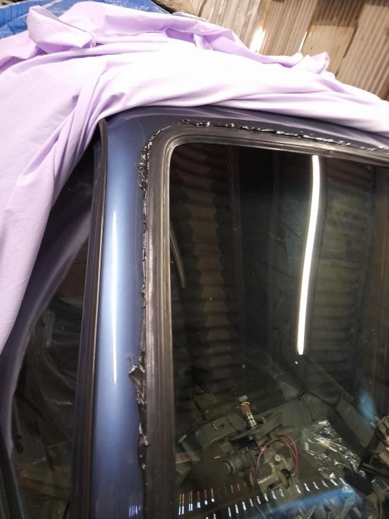

I'll apply some arbormast sealant and fit the trims over the weekend hopefully.   :)
Arbormast sealant was pumped into the gap between the frame and rubber.
20211030_151446.thumb.jpg.06c078955827b0da06948500a5cd854e.jpg.96deb3646683839c15d42b23c73feb60.jpg
Once the trim went in, a load of it splurged out as expected.
20211030_170307.thumb.jpg.29d31f9d74e2c208d9be1437c20b2956.jpg.c81ae3a9ab4c77c12409bdba54ea87bd.jpg
After the mess was cleaned up, the wipers went back on to complete the job.
20211031_145207.thumb.jpg.8fd1df2baf218da2bf05acf34dbaeb20.jpg.7794a210f3e85fa91f34029ea4a30592.jpg

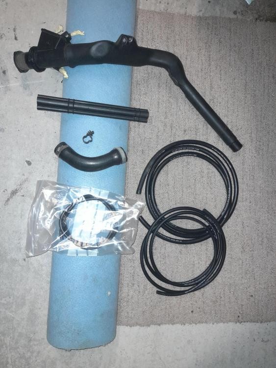

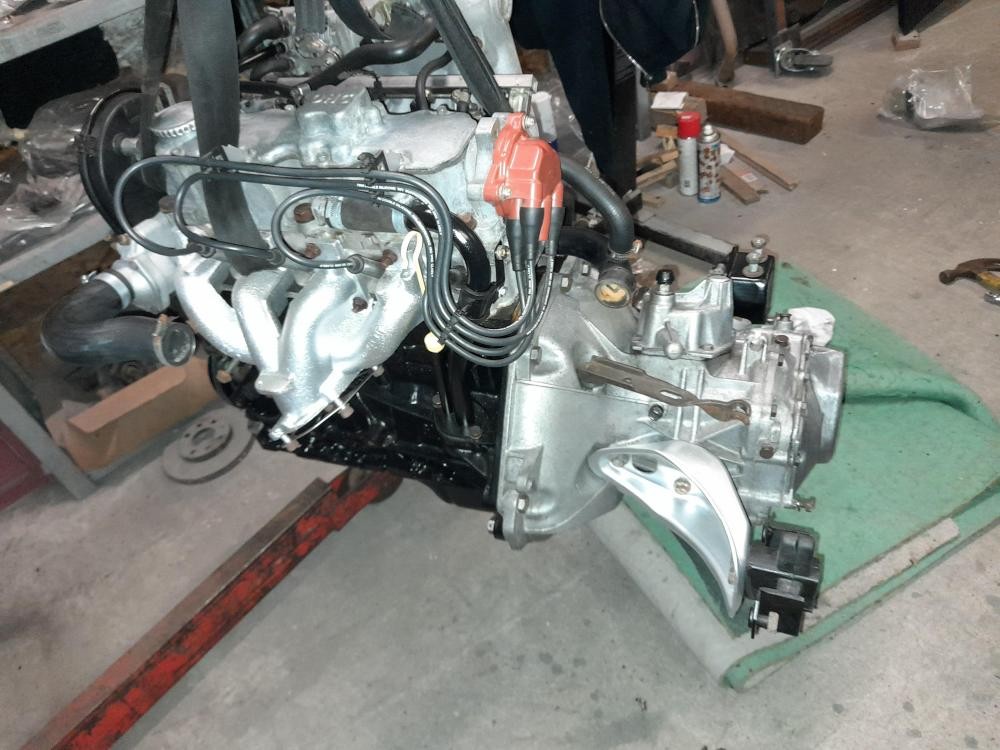

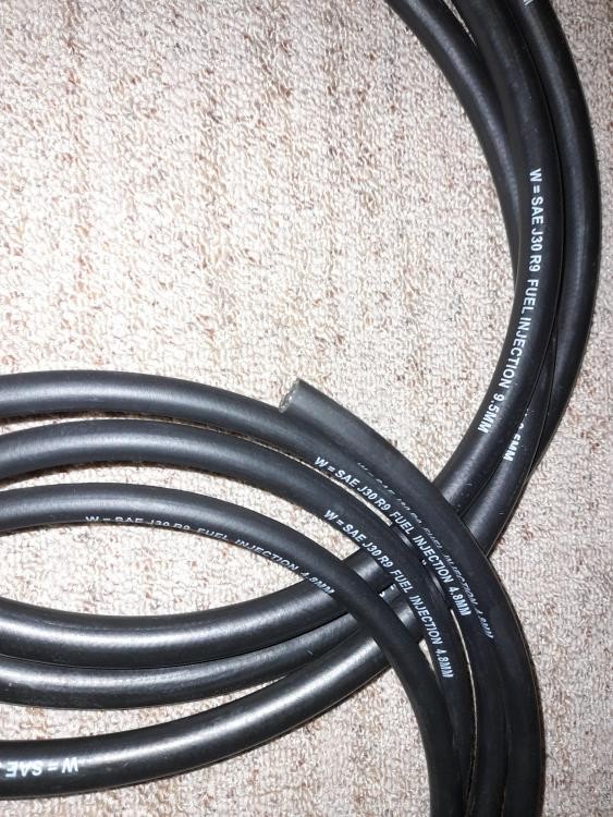

Fuel pipe is due on Monday, so hopefully I'll be able to stick the engine and gearbox back in once the fuel system is completed.  :)
I've not been able to get a go at this until this evening, but carried on chipping away at it. The first job was to remove the majority of the thick layer of dust and dirt off the front bumper. The trim strip had gone yellow and cloudy - probably UV damage, so as I had found a new one, the old one was removed.
20211103_183903.thumb.jpg.9fa61274d923112ca30108ebeb342644.jpg.d290abc73763f5613c179f53a7d3442f.jpg

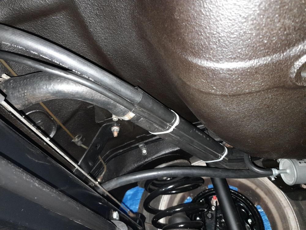

The 8mm fuel pipe arrived on Wednesday,
20211103_192816.thumb.jpg.729a96cce1089eafaf3d8a2311736b8e.jpg.8b9777346be956f92712861cc3771c5f.jpg
so made a start on finishing off the fuel system. I only got as far as fitting the fuel pump along with associated gubbins, then connecting the fuel filter to the metal fuel pipe on the chassis leg before my time was up.
20211104_184422.thumb.jpg.a5a31d48482a9430de8bfe22049d1237.jpg.dfa94692ec047f3163e76155021b6dd8.jpg
I should hopefully get back on it on Sunday and finish all the fuel pipes off. Then I can drop the back wheels on the deck and get the motor ready to go back in.  :)

Fuel filler apparatus now reinstated.  Threading the pipes through the plastic conduit arrangement was a bit of a faff.
20211106_195409.thumb.jpg.f8f3087dce11c06af0203f7411d5549b.jpg.9f7f34e92ade7f7b39fa7c18a9da87fe.jpg
It's all gotten a bit busier under there.
20211107_125342.thumb.jpg.6d14ceb035f1b9fe4f458b3f305cab45.jpg.b0efa74fecb45ac947068223301bf465.jpg
Fuel lines all buttoned up now,
20211107_142408.thumb.jpg.2f6d8a1a1b0946693baac1f86791fc37.jpg.3f15fdf24c250f722994096507ebd97f.jpg
To the rear, (still need to clip the tank to pump line to the chassis leg)
20211107_151839.thumb.jpg.de419030cdaab184d608b1ab7db172f3.jpg.36840418836a9ec1fb5a70441b84b5c2.jpg
Up front.
20211107_152559.thumb.jpg.e94a6ae07f1c63906cc5b6ec11264bd0.jpg.5942ef8d66b4cb35e26bca3126a463d2.jpg
Once I've checked everything over under here, I can get the motor back in.     :)
Whilst getting the front bumper cleaned up ready to go back on, I thought I'd try the grill on.
20211111_194309.thumb.jpg.669506f74f2ae8318a353e58b8a9fed3.jpg.6913d7555824a302d320a93f8741ef1d.jpg
It fits OK, but the little rubber grommets that support it on the body have disintegrated. May have to get creative here as I've not been able to find any on Ebay.
The bumper to wing brackets cleaned up pretty well, just need to fit the new chrome trim to the bumper and it can go back on.
20211111_200249.thumb.jpg.9325e98f54b58b44156cdadeb20e75eb.jpg.17bc9ec58c9fb2d0a15252e5f744e988.jpg

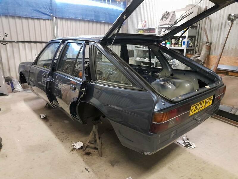

Borrowed an engine crane from next door in preparation for the lump going back in,
20211112_160244.thumb.jpg.dd45af23b21028a2a14644ee69ecb3b0.jpg.03376e2b5a00d6ea32a7641e19efa0a5.jpg
then went over the motor making sure everything was tightened or torqued before it goes back where it came from.
20211112_160454.thumb.jpg.d9cd284853f8cd9c8228a3dc8cf17103.jpg.055d13a311332560cc07bfc300621666.jpg

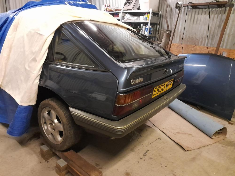

Put it's own wheels on out back, then proceeded to drop the back end down from this height,
20211112_162739.thumb.jpg.451f34fcedfd47dc2f3d11810c926c06.jpg.2ee7e4c0eeb76aa5cec49d7552d1f6c5.jpg
to something a little less precarious.
20211112_174411.thumb.jpg.cfb4bf5e1508783c5cb57f4b1ea27d93.jpg.e29cde78f90ff7e934bcc43c6a1e80ac.jpg
Should hopefully get the front end raised up, and the engine and gearbox back in over the weekend.    :)
Got the whole afternoon on this today, kicking off proceedings by getting the engine off the stand.
20211113_120135.thumb.jpg.b9ee31972b69701da21b6725cc02bea0.jpg.60b6b5c192d9b5f0a58cff405d543a12.jpg
The clutch was fitted next, I cleaned up the face of the flywheel with wire wool first as it had a bit of flash rust on it.
20211113_122039.thumb.jpg.f3d73192c157d5b5b22826fd1845b79d.jpg.ae24d48404f3168b61a4d0b7676899fa.jpg
Fitted a new release bearing, then the gearbox went back on.
20211113_132450.thumb.jpg.aefcd414499c34cbd4b4538d5cddf9a9.jpg.053fb152b01ac1404eb66c3b32c9eca0.jpg

The front of the car was raised up a little to enable the engine and box to slide underneath. I put a sheet of perspex down first, then some polythene bags, then sat the lump on top. I was surprised just how easy it was to manoeuvre the heavy lump on this plastic combination (in the past I've used carpet and struggled) and it was also spot on for protecting the paint on the sump from damage.
20211113_175951.thumb.jpg.1ba584636865ece121c52219e33eaf7d.jpg.04ba903542727168098c1ebf01f0d31b.jpg
Once it was central under the engine bay, the crane was used to lift the assembly up into position so that the engine and gearbox mounts could be fitted. This took a fair amount of time to lift and manoeuvre a little at a time, constantly checking so that nothing was allowed to damage any paint anywhere. After an hour or so of faffing and fussing, it's all in position on its mountings.
20211113_194335.thumb.jpg.9fb830a6c32e7e287ff4d2ba24ec0605.jpg.a18bc9c9049912f98abe461ce8e58a30.jpg
Should get all the mountings tightened up, and everything plumbed in and wired up tomorrow.   :)

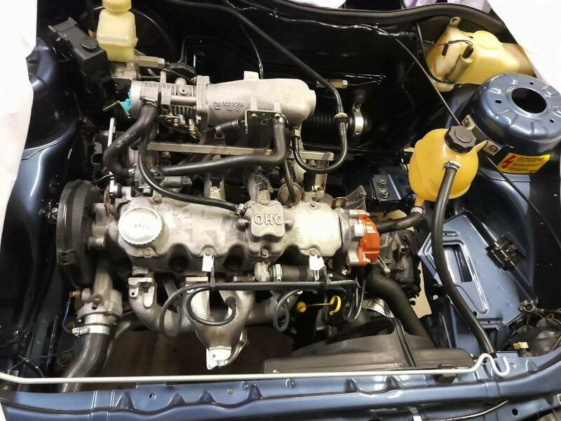

Arthritis got the better of me the other day, but I managed a couple of hours on it this evening after work.
The engine mounts were all tightened up first, then a few smal under bonnet items went on before the radiator, fan and coolant hoses all went back where they belong.
20211115_180627.thumb.jpg.12cf069d8b3b87d7235400ddf1a38cf4.jpg.9faa8eb2de1c07abbd4a5a35a74cc568.jpg
I was a bit too crippled to get underneath and continue connecting up pipes and wires, so I chose the far easier job of fitting the secondary horn to the nearside front gearbox mount next.
20211115_185807.thumb.jpg.f5c1e9c97560886dfd1fbeaf7aa41399.jpg.174b9347b459acb65504dbc88068832b.jpg
