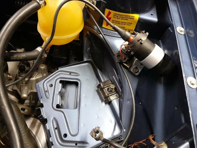

The coil has been spruced up and put back on.
20211118_185122.thumb.jpg.2f9d1e385f0066aa9e21a4a0abd92bc4.jpg.7c01b1e09c9fbb023ad4a3fd890990c0.jpg

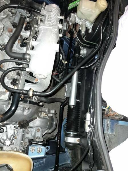

The plumbing in and wiring is coming along, once I've fitted the engine loom and connected up the fuel lines, I can get  on with fitting the sub frame and suspension.

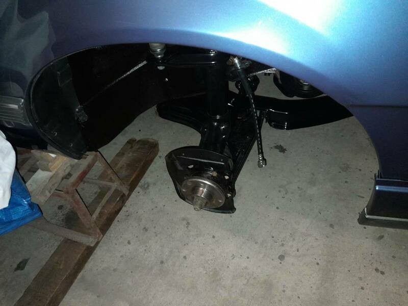

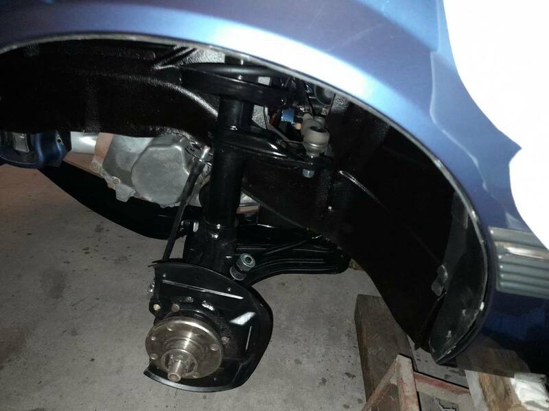

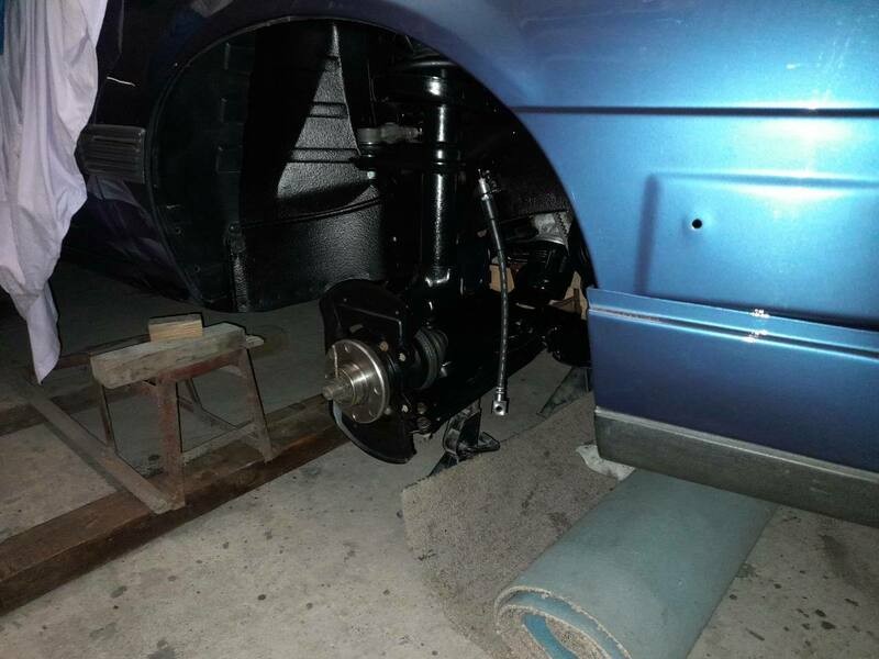

I've left the re-fitting of the engine loom for now, and got on with getting the front suspension back together. It's been sat on the four bolts which hold the centre of the sub frame arms to the chassis, so first I had to move the axle stands from there to the jacking points at the front of the sills. Once that was done, the anti roll bar was bolted on.
20211126_164431.thumb.jpg.2b87f7acdb8616feddff5a1b5f25388a.jpg.7b4223183a7a7f4fffa1f96b91890ddc.jpg
With that in position, the sub frame arms could go back on, closely followed by the wishbone.
20211126_162257.thumb.jpg.265ea6c6aa387dec6c33999c9a411263.jpg.f50ef73b358edf04e47a67bd60077bf3.jpg

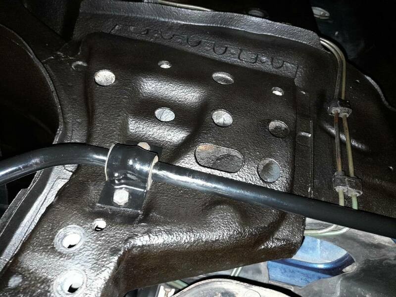

Once I'd fitted the anti roll bar links, time had run out.
20211126_172453.thumb.jpg.c3cd8b10f2f09138a4869bd8f6a323a2.jpg.c89edf62a9a4429327d1b05c15249d94.jpg

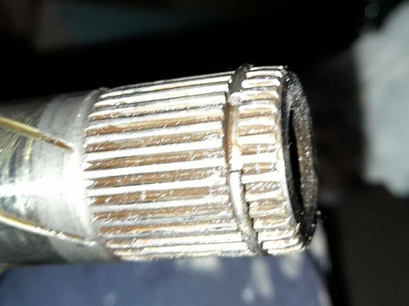

Bit more done today, the offside driveshaft didn't want to go back in to the gearbox, so suspecting that the circlip thing in the splined end was at fault....
20211127_143157.thumb.jpg.a66b00a42725819348b5e3ac56ff840c.jpg.060dd06061d34145e4b63008084470d7.jpg
another one was sourced from a random pile of driveshafts next door. The offending item didn't look too distorted....
20211127_143121.thumb.jpg.c04fd8d91275c7ec294a1b77367cb39f.jpg.a748c17e0379fb6a5906f93013f663d7.jpg
But the "new" one allowed the driveshaft to flop back in with a couple of gentle taps.

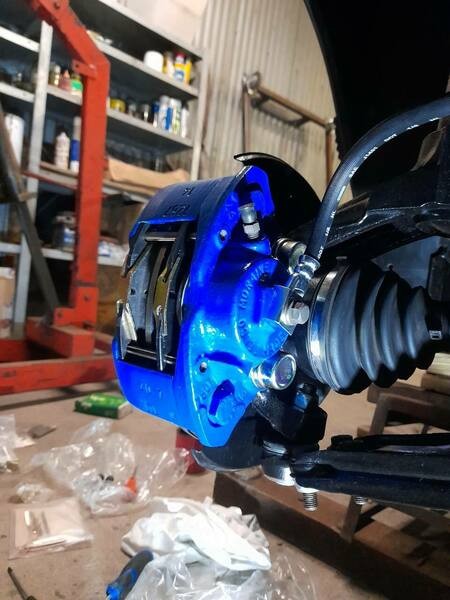

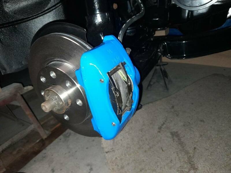

I checked that the caliper sliders still slid, and that the pistons were still mobile (it's been a while since my DIY refurb). All in order, so they went on with the new discs...
20211205_172210.thumb.jpg.79b996b9bccb3cae323d587c78aa9079.jpg.46e5e985e4d0c9b7a6ca740f8ff75c2c.jpg

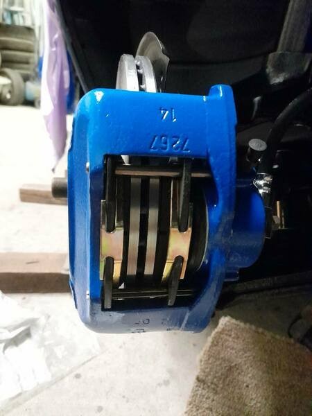

new pads and fitting kit...
20211205_172745.thumb.jpg.680bf9e04648916bb59c76c135684e4c.jpg.8bb44b2732e31853181caae1c291702f.jpg
and new caliper bolt covers.
20211205_173057.thumb.jpg.4f95b1a33fac43adf1b66696d2433d16.jpg.d6b7c62155a8f45c0e6874cab9afbe9a.jpg

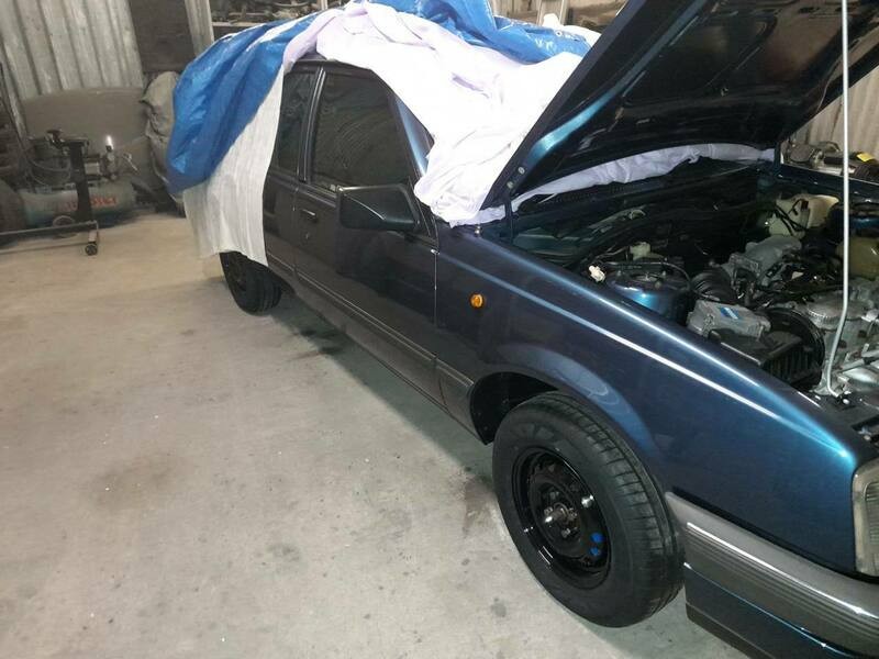

Front wheels now on, should hopefully be sourcing oil, coolant and a battery over the weekend.  :)
20211209_183227.thumb.jpg.b7b0889cde0602697f14b2f3d1a18f38.jpg.7138721126315be40590844e59957740.jpg

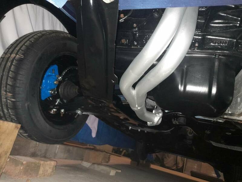

Tidying up the front and rear sections of the exhaust was next on the list. They were cleaned up with a wire wheel and drill attachments (missed those guys!) Then given a good clean with thinners.
20211213_180806.thumb.jpg.dceb28c3b765daa2dad049d17ee80543.jpg.72c93a75b85e2ab10ac9ae84891218f5.jpg
20211214_182349.thumb.jpg.3968c5bffb70621b25731c9cf71afec1.jpg.d4d0d5a898886b17f0e9d455fe77e73a.jpg

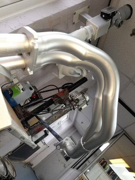

So far, the front part has received a coating of exhaust paint at work (where its warmer than my shed!).
20211214_104522.thumb.jpg.8a601047241350f7c73027155aec9506.jpg.27faec0099d5eadda57a36d49c15057e.jpg
I'll paint the back box next. Hopefully the new mid section I've ordered doesn't take too long to arrive.  :)

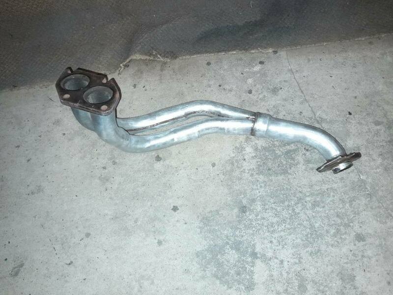

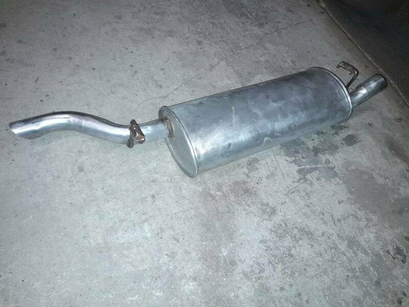

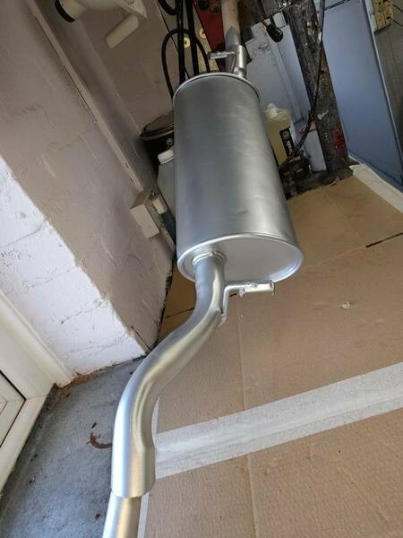

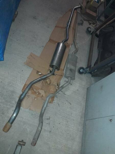

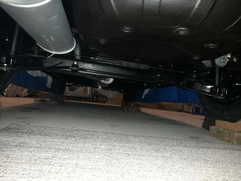

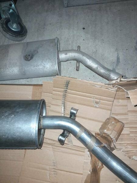

Exhaust arrived yesterday  - pretty good going taking just over a week from Poland.  A side by side comparison shows the new item is a better quality product.
20211222_174943.thumb.jpg.df94a65474b914ab880ed4df8a317dfa.jpg.dca6b01019486b87e38ee7af30e1e981.jpg
The bends are nicer, and the hangers are actually positioned correctly.
20211222_174953.thumb.jpg.4edb6228ddfa2458345aa6ba902c27c8.jpg.cf9013eb336be5df0cbb2c2aad29e8fb.jpg
The only down side was they had to cut it to get the package size down, but they did supply a joining piece to make up for it!

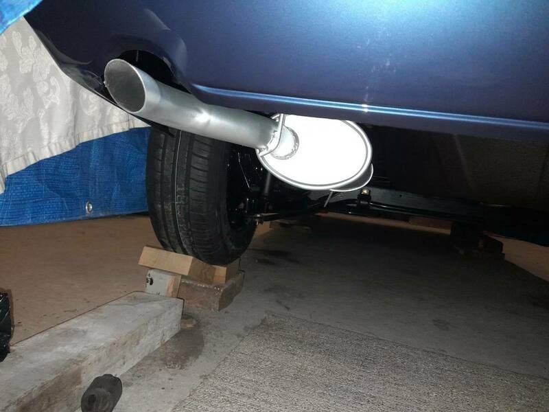

It's now in position, but suspended by cable ties until the correct rubbers arrive.
20211222_194525.thumb.jpg.0a7e8f41422d4480289e18c04a381dfd.jpg.9d0c32b8905917e0cfd05d2454b903b9.jpg
The fit isn't bad at all considering it's all pattern parts.  :)
20211222_194728.thumb.jpg.d09464f123bd02869dca7a7f0bb956fe.jpg.149f87c24725f2e36d6a615fcfc3ebd8.jpg

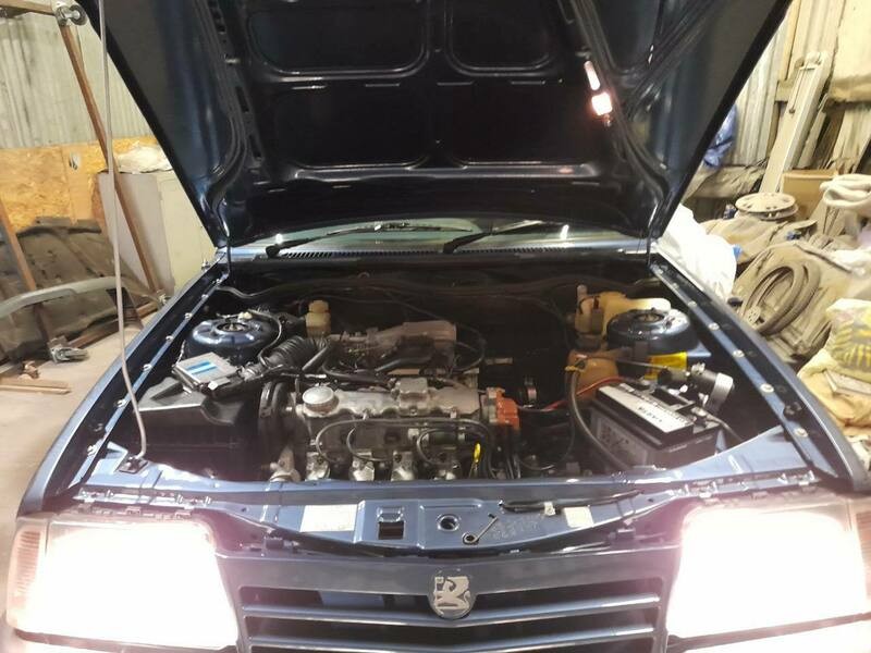

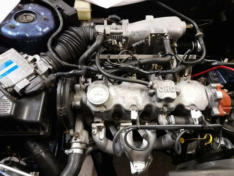

Its alive!
Sounds just as terrible on my phone as it did before! So far just a small leak from one of the pipes to the fuel filter, an easy fix. Was running for about an hour and a half, then ran out of fuel.

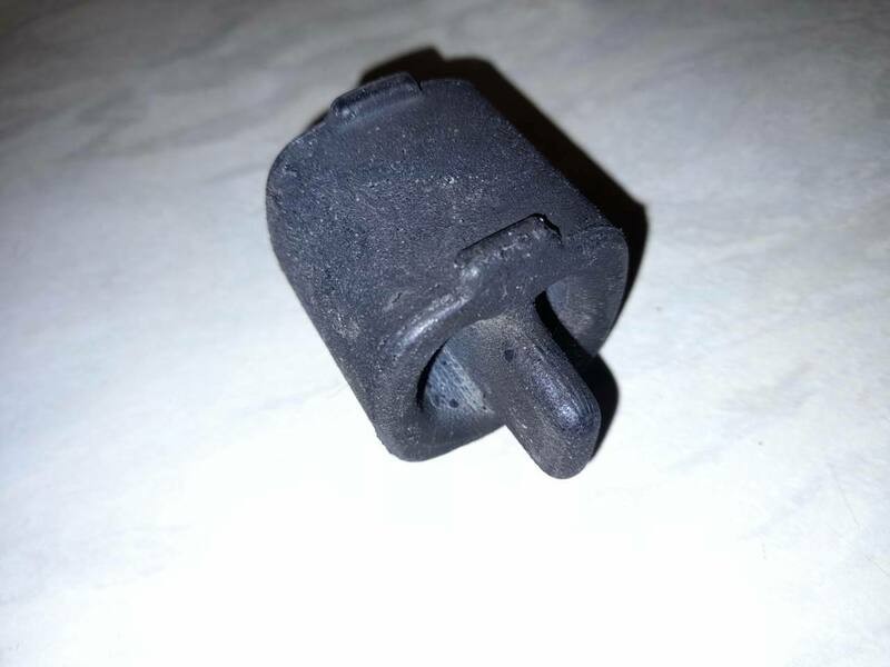

They arrived on Christmas Eve, along with a couple of these exhaust rubbers.
20211224_101855.thumb.jpg.bf885a1a174530374d6d5abdc9a86cb3.jpg.3cd09ce4a597995156b5911dc4c83cd0.jpg

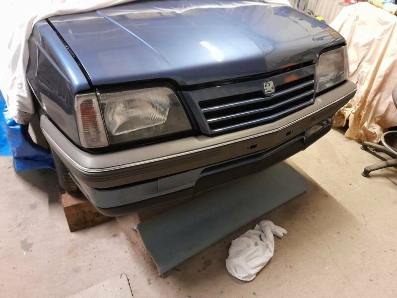

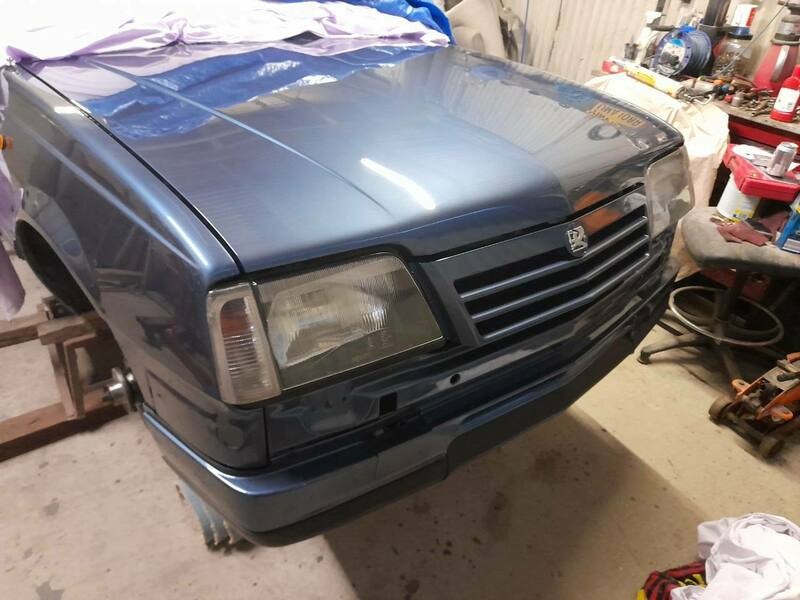

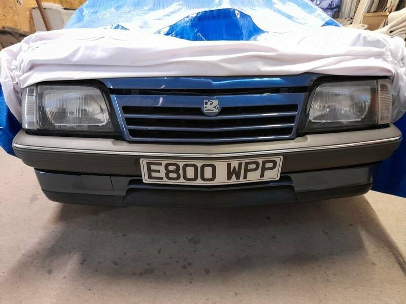

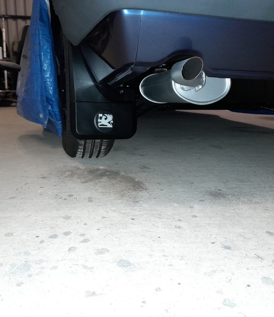

Finally got round to fitting the front bumper today.
20211227_182222.thumb.jpg.3109969cd26e229edb52c20b6028bfb0.jpg.0804677f7909efe1b0fc4bf877d6a5f4.jpg
Then dug these out for fettling.
20211227_115805.thumb.jpg.45e5f9a600e1a0915681592f51fe3c6c.jpg.f7babbfd2412c10e31c3406b4209793f.jpg
I'm hoping to get a bit more done soon!    :)

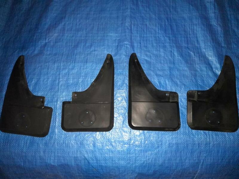

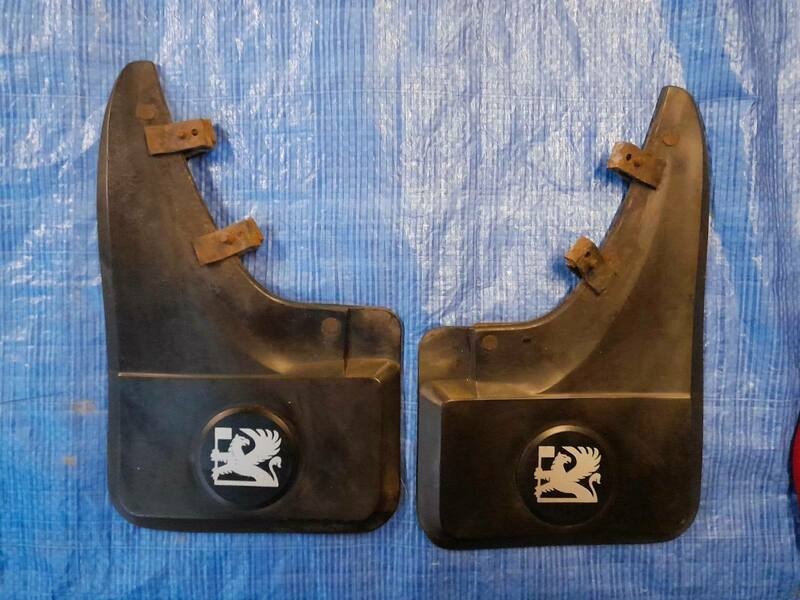

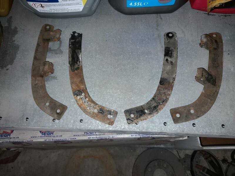

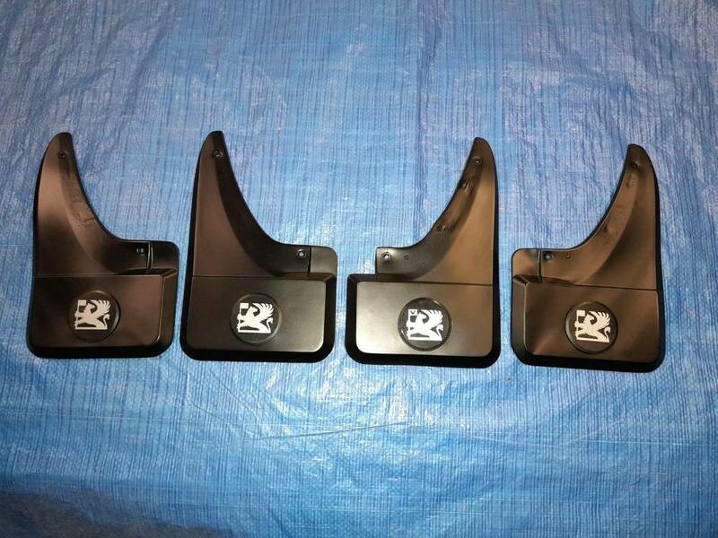

I decided to have a search for the other two mudflaps in my assorted storage facilities - I found them, but one of the Griffins has escaped!
20211230_172438.thumb.jpg.9750858ef870601fe762b3595b7d7e02.jpg.2fae5e459483373b000a7851c14a999c.jpg
On the hunt for a replacement now.  :(

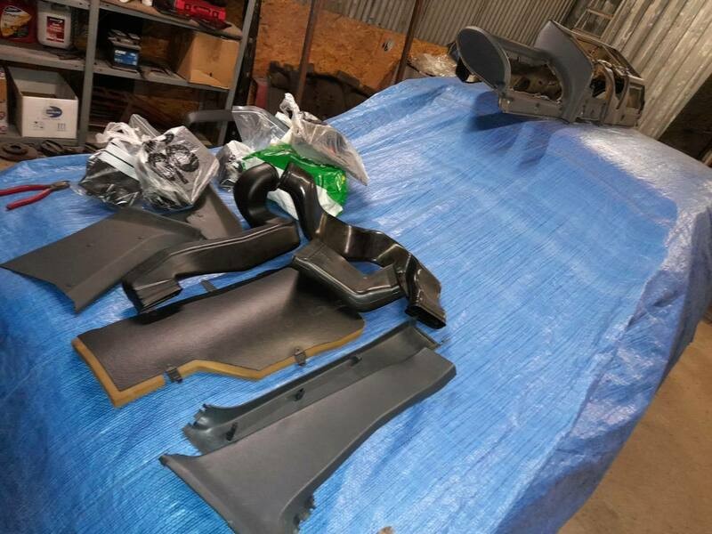

In the afternoon I gathered up a load of interior stuff from home, and carted it all over to the shed.

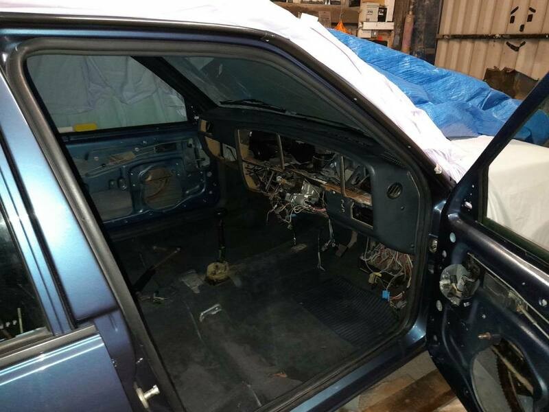

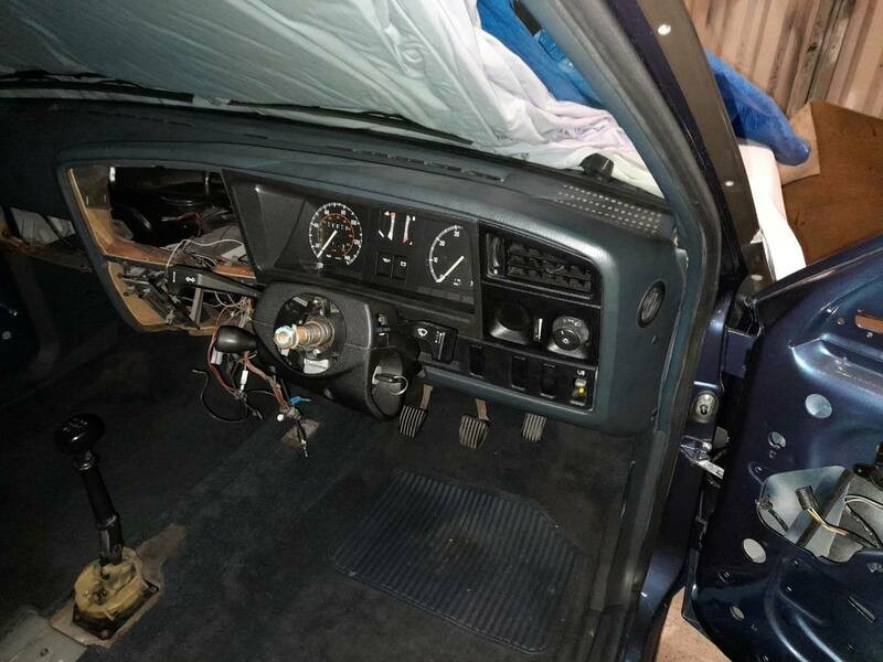

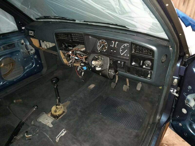

I wasn't planning to put the dash back in today, but thought that I may as well get it started.
Plonked in loosely to work out where the spaghetti needs to go.
20211230_190726.thumb.jpg.41a862a21fb1a137d4a2357dd253bc81.jpg.2cd6c4ced840c65b2f2396ce144a404a.jpg

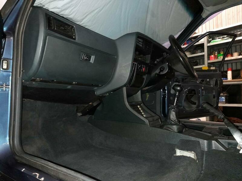

Hardest part done now, even managed to tuck the dash under the screen rubber.
20211230_213206.thumb.jpg.014690b9638d253fc00a546cbd14e258.jpg.c89910a46d1e11a25da0a00d5e221e5d.jpg

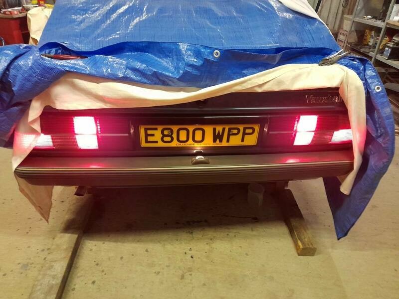

A quick check of all electrical features revealed that everything functions as intended (for which I was most grateful!).
20211231_162918.thumb.jpg.247bc92b5dc9e68ffb3843a691b153d7.jpg.6e75d2a5d68d726ee6594daf2216f8d3.jpg
20211231_164706.thumb.jpg.f6531efdac14f42e843a22b15ebbcdb5.jpg.cd38510592c3837fa463e1ffca5126c3.jpg

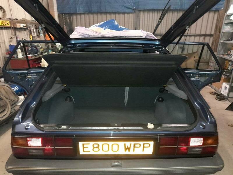

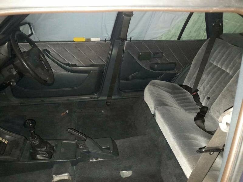

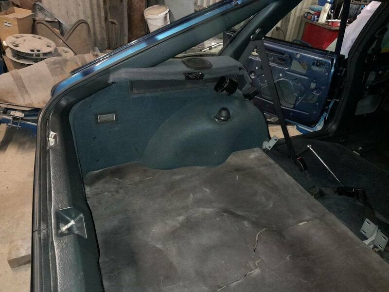

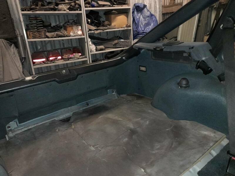

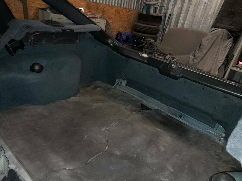

Found a little more time for this today, all the load compartment and rear seat belts went back in.
20220103_141158.thumb.jpg.0a74bdb5b2c5202844f7bc9aaa6c0157.jpg.3c5ceac38218ffe91c13755aee5afe07.jpg
20220103_141209.thumb.jpg.c7d6e41d074211cd0d7ecf583f22bb85.jpg.3072d0f00930b3c1e0abef03e0199e78.jpg
20220103_141146.thumb.jpg.738abe81f6ed55a4a1ef75303fb82315.jpg.2580ef6ccb5ad5fd1c29c7228f5b1315.jpg

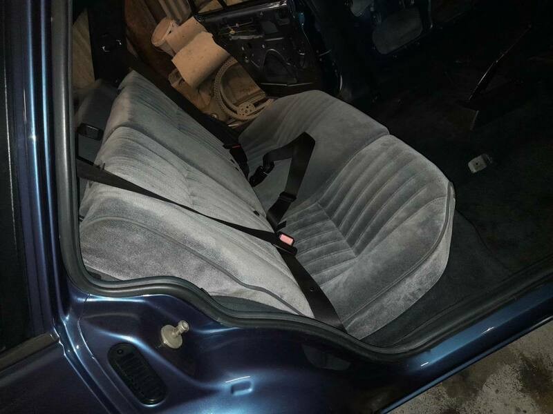

Just seats and door cards left to go back in here now, but I want to give them a decent clean before that happens.  :)

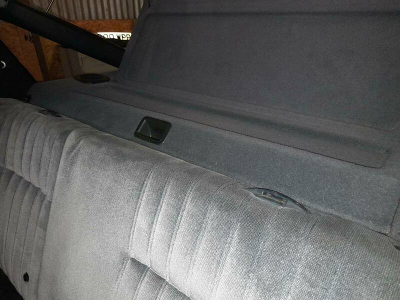

A little more was cleaned and put back where it belongs. First up the rear seat backs were fitted, closely followed by the boot floor carpet and load cover/parcel shelf.
20220108_155004.thumb.jpg.d0117631a433763496f5c07543262be0.jpg.25ea74cb6b1eba27b8cb91ae878c04aa.jpg
20220108_155045.thumb.jpg.c1e2f3a22847aa7fb6d46421b1110ef4.jpg.9fc48936c8927fe7a8c28546140e476d.jpg
I've got so used to seeing the spare wheel through the hatch window that it looks odd to me with all this stuff back in position.
20220108_155520.thumb.jpg.e958807b693d0091e376166d46096f21.jpg.55a7051a5be86001c341b84c14dc8f14.jpg
Time was short on it today, so once the bits you sit on were fitted, I had to vacate.
20220108_163502.thumb.jpg.cbef83ad322afd523b8aaa60c2c82d62.jpg.15001838b30b54d3b4f6944c86073872.jpg
Hopefully I'll get some more bits cleaned and refitted soon.   :)

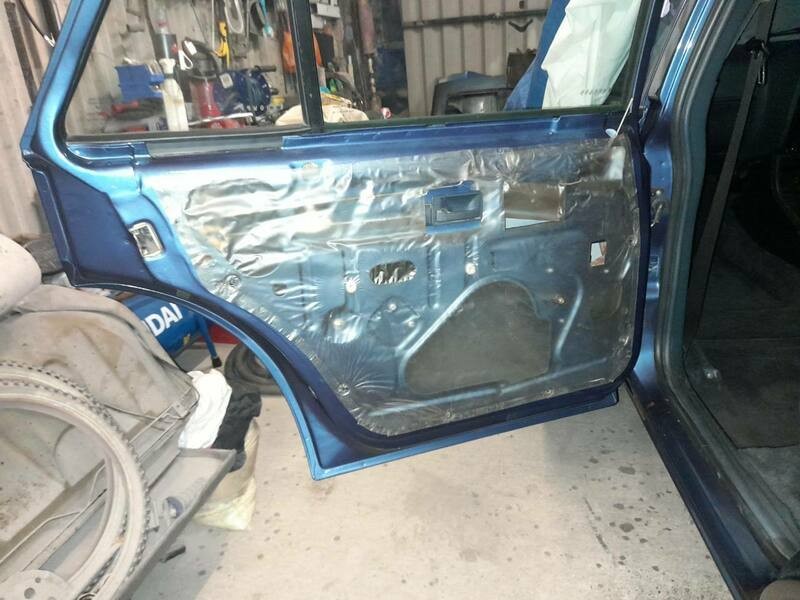

Door cards were given a good clean yesterday evening,  and went back on this afternoon.
Membranes fitted first with double sided tape.
20220109_140553.thumb.jpg.8fdda0b4970f645185d0821acf5dec9f.jpg.b9875f1af34d3db9250817321bf0db45.jpg

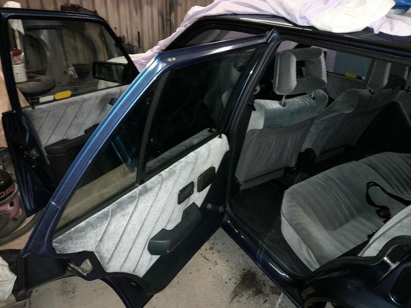

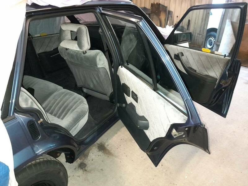

Door cards and mirrors back where they came from.
20220109_162010.thumb.jpg.aafd30ff9b2b3ffd4a7922a228b91829.jpg.ad6b498770c52a450f286c089faa6c03.jpg

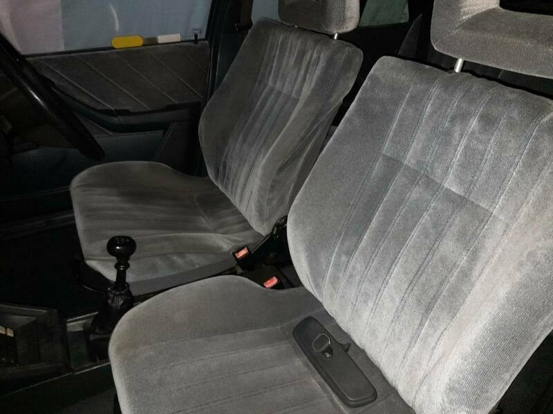

Front seats still need cleaning before they can be reinstated.

I'll hopefully be cleaning the front seats this week.   :)
Drivers' seat went back in first this afternoon.
20220114_160434.thumb.jpg.d583baf9c6475bfd16a493920cd1507d.jpg.3aefd866e50db9f9ee0809bf68e8099b.jpg
Obviously the passenger side was next!
20220114_164759.thumb.jpg.2077d4457ab2040ff3e2a41ad0acc0ce.jpg.544738bf7a4561eafcddb9418f4154ee.jpg
I got them reasonably clean using bathroom wipes (to avoid getting them too wet), but when the ambient temperature is considerably higher I'll be wet vacuuming the seats and door cards to finish the cleaning off. The worst of the muck has gone though.
20220114_164810.thumb.jpg.8f5cbfd0debf41ef246d3492f3456ecb.jpg.eae0258c80979b2fa60403faa9625374.jpg

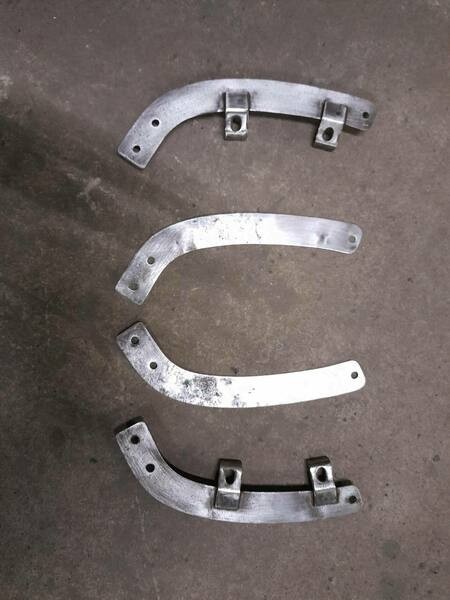

A little mudflap fettling was akso done this afternoon.  Emblems and metal bits were removed first.
20220115_143646.thumb.jpg.044fcb6959748229d8ea0962a30b5f69.jpg.69fa3d818a954fa4cd4e653858a7e8da.jpg
The rubbery bits were then relieved of many years worth of muck (and bodge overspray!)
20220115_163233.thumb.jpg.70aaeebf6fb5ea79295cecc983a748ff.jpg.4c7e2335e6a15ff2f85a270315825c36.jpg
These will be receiving a bit of treatment from the paint bloke to restore the shine lost by the deep clean.
The metal bits then got straightened and cleaned back to the point where Hydrate 80 can be applied prior to black paint.
20220116_155854.thumb.jpg.7a15a8a33c24af81dd4ad8db07068f38.jpg.4ec2a2f76e8a2efce365bca8ed5356d3.jpg
Still looking for the missing emblem. :)

Not had the chance to do anything on this until yesterday,  so got a few small jobs sorted.

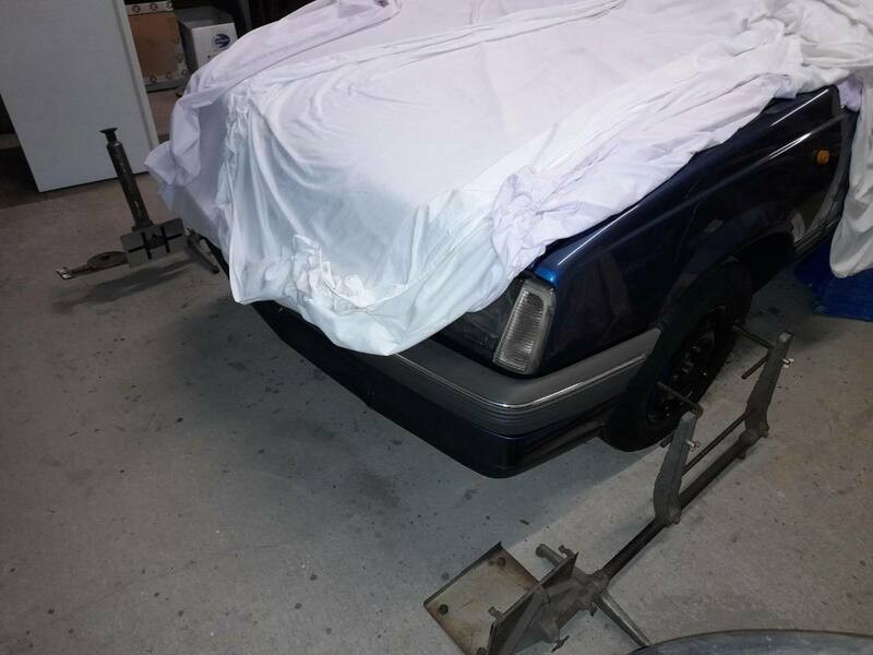

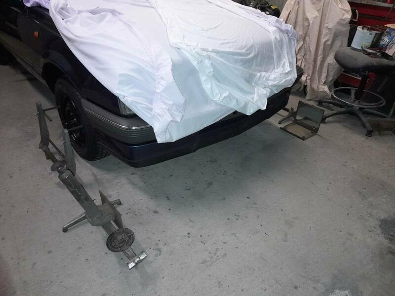

A pair of old fashioned tracking gauges were borrowed from a neighbor to enable me to get the wheels pointing in roughly the same direction.
20220128_142036.thumb.jpg.a766e199232d578529d3533cb87d16d1.jpg.d7d4c2bbbdcd91a3fbaec31021e26252.jpg
20220128_142014.thumb.jpg.1cd07d95114f627ba17de285a0f4362f.jpg.851e5414ed9c72626ce3ce394536f3d8.jpg

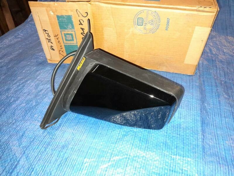

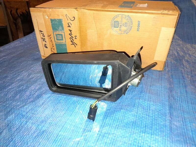

Some genuine GM NOS goodness arrived this week. I'd forgotten all about breaking the nearside mirror (nearly six years ago) whilst backing the car into a garage. It's still useable, but the aluminium structure had cracked, and it wobbled slightly as a result. A replacement was sourced, and it was unboxed today.
20220203_185129.thumb.jpg.4fc0c3e9b214b508efb386289f59b0cf.jpg.b45037a79cfee4cc5cb7fc54d5da2131.jpg
20220203_185117.thumb.jpg.1a0e6513cdba307926106d242b192c53.jpg.6e761cc43ffa3a5048fb4937ea990834.jpg

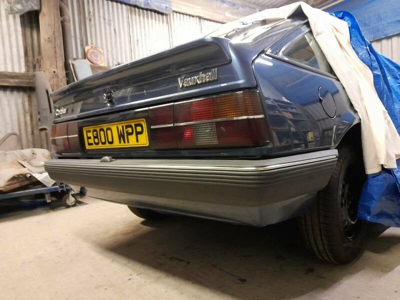

The rear bumper, although in reasonable condition, did let the car down a little. I treated it to a new genuine GM replacement, and this was swapped over this afternoon.
20220203_183047.thumb.jpg.540e7d3cbc7d37b3a4c3f52a9a1b9946.jpg.0046c5d315e763578b793b02ab133baf.jpg
No unsightly marks on this one, just need to fit the GL and I badges to finish off the rear end now. :)
Started putting the mudflaps back together today...
20220204_171931.thumb.jpg.10b0494a72e42ff2cf8cbb6f1d774b76.jpg.fc33cd9f94e79589f1d1f99a36718f1f.jpg
No idea when I'll get back on it - hopefully it'll be the coming weekend.

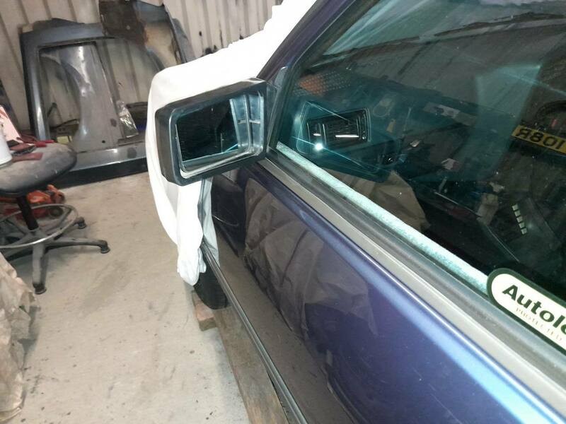

Got cracking with a few jobs this afternoon - the new nearside mirror was fitted first. The rear mudflaps were then fitted.
The stormy weather then took out the electricity supply to the farm, ending play for today.
