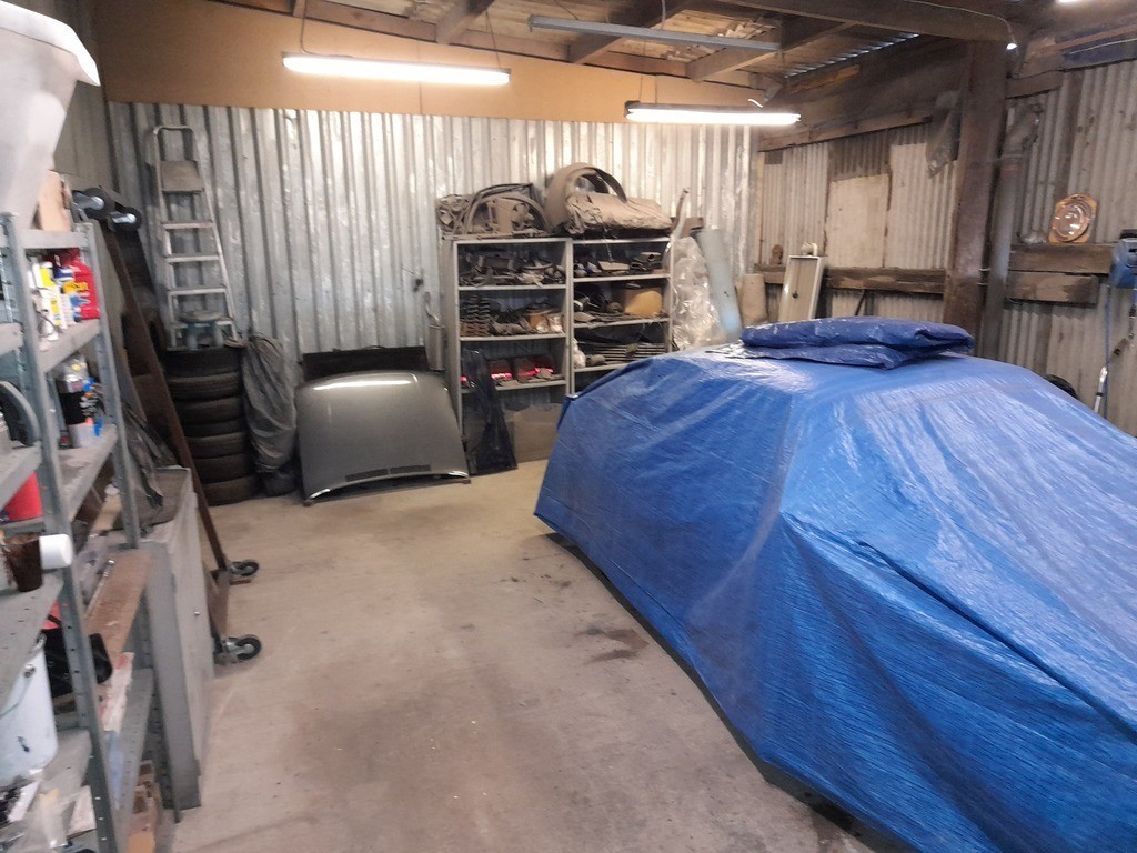

Most of my spare time has been eaten up by tidying up the shed. Got rid of a load of junk, rearranged some stuff, and installed a fridge for the summer months.

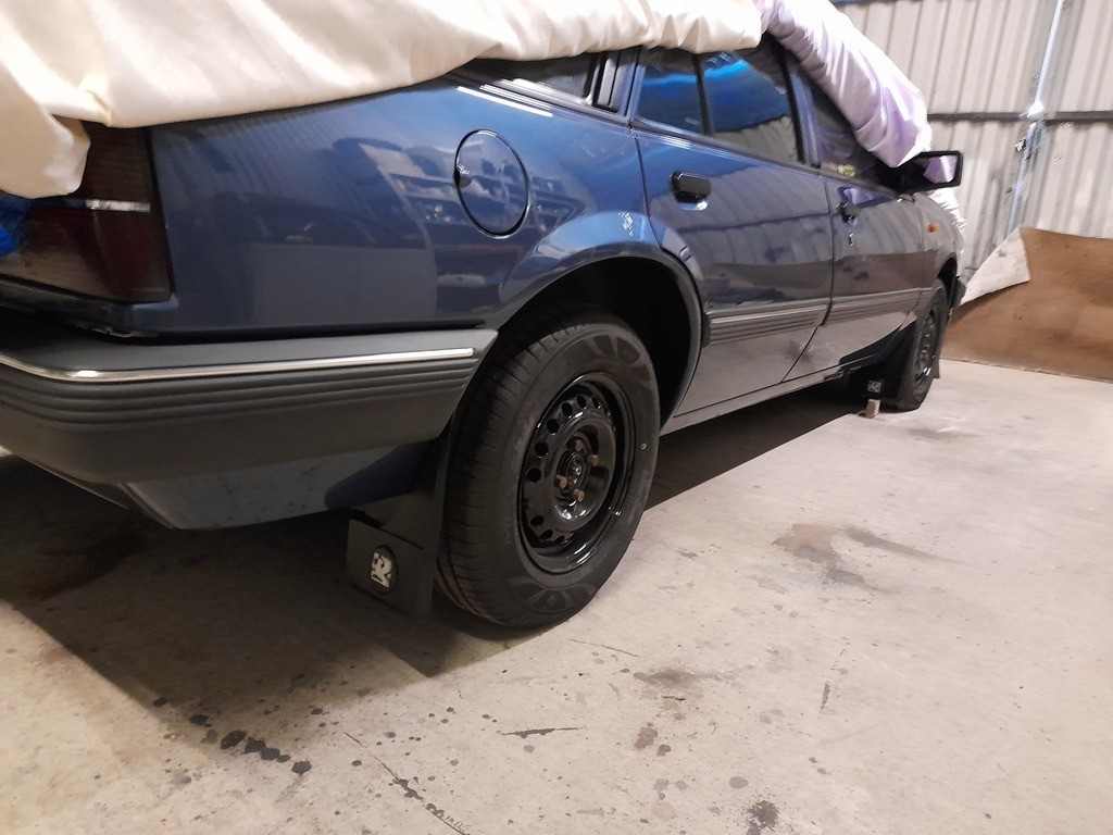

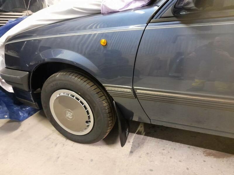

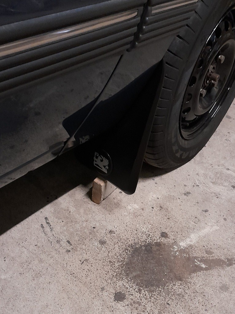

The front mudflaps went on next.
The block of wood was used to set them at the same height each side.

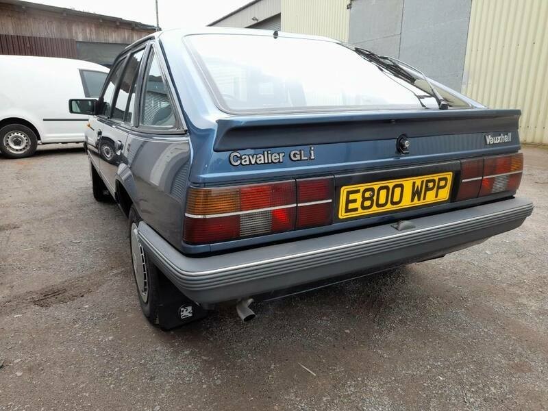

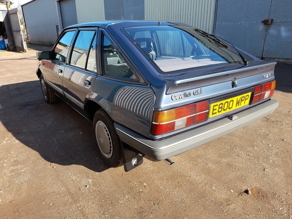

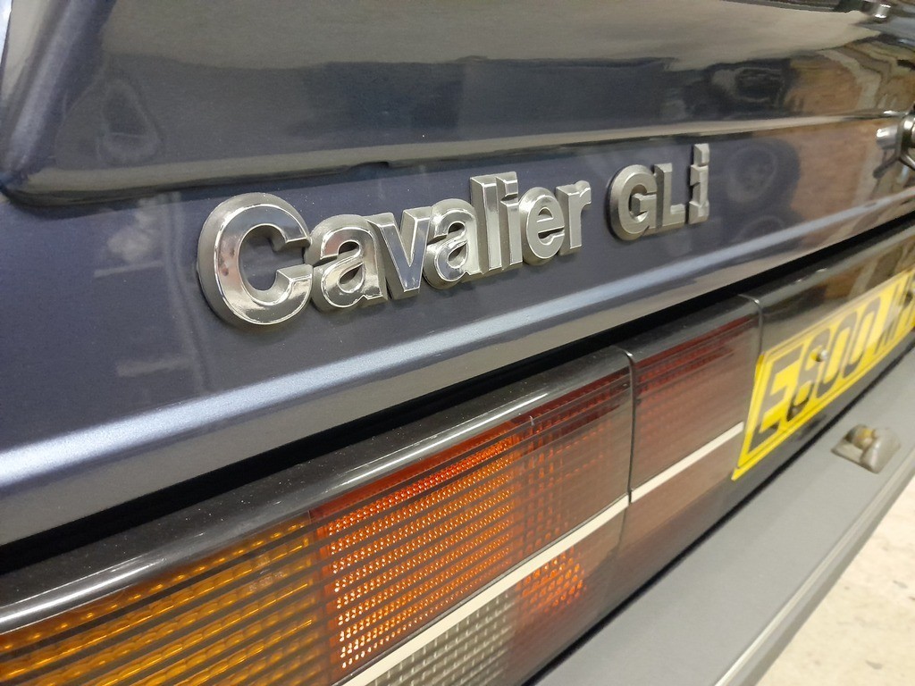

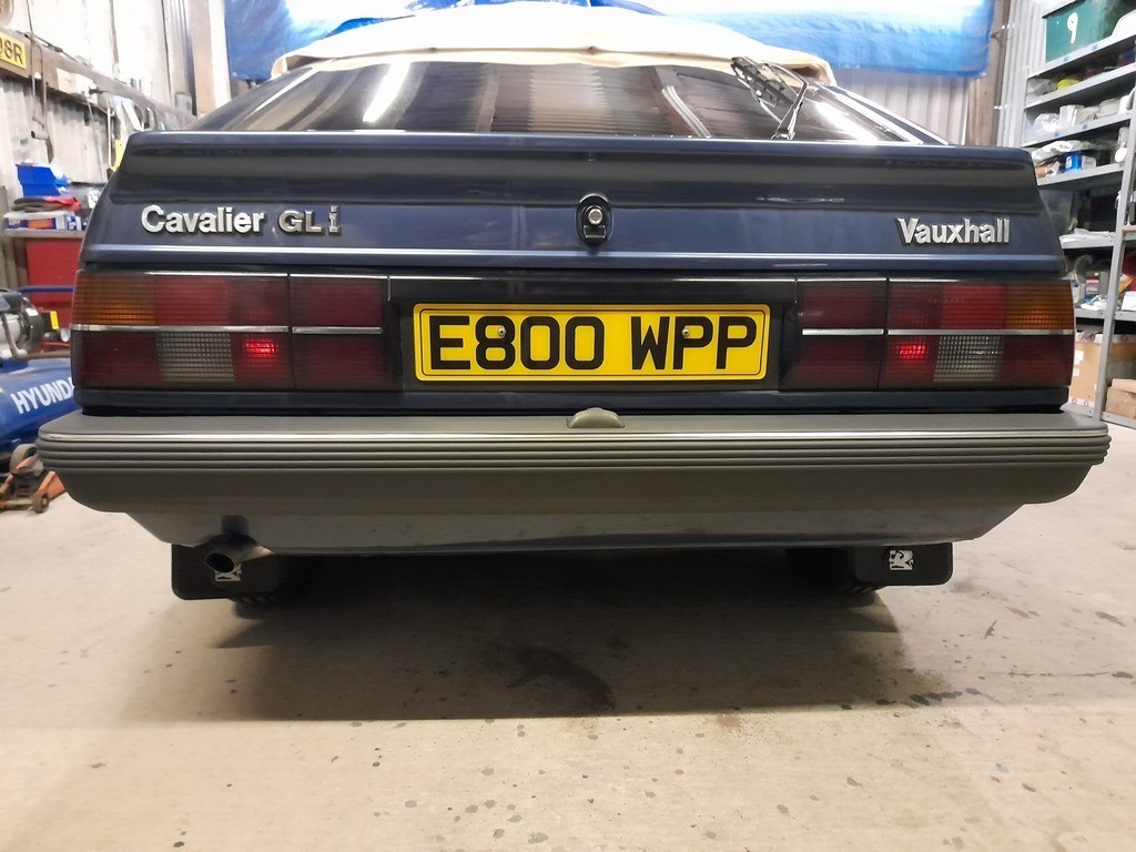

The rest of the tailgate badges went on.
Now the back end is finally completed!

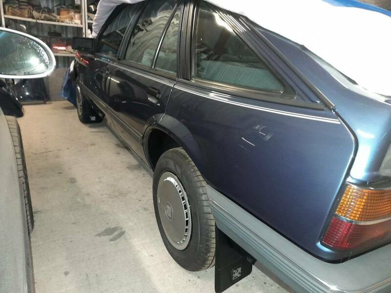

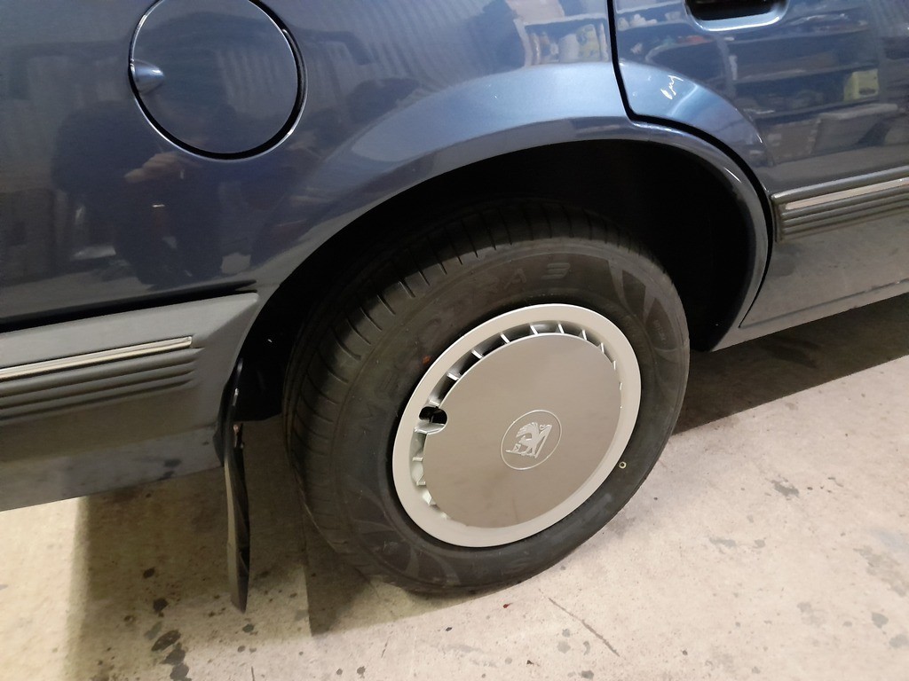

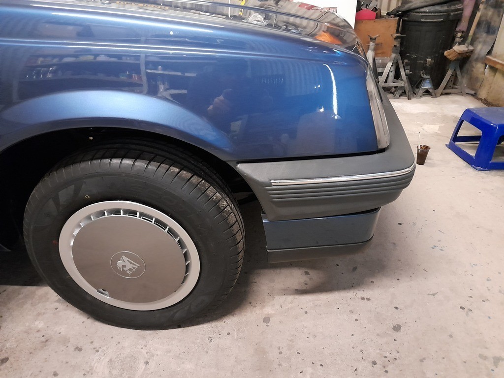

The shiny new wheel trims were dug out of storage and the front ones were fitted.
I need to fit the castle nuts and split pins before the rears can go on, then all that's left to do is fettle the exhaust and apply some pinstripes. I've not been able to find any in a flat grey - everything available is in metallic grey/silver which just doesn't look right.

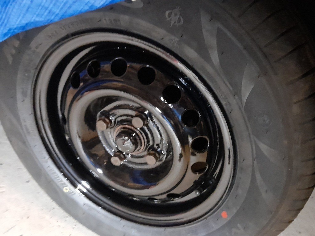

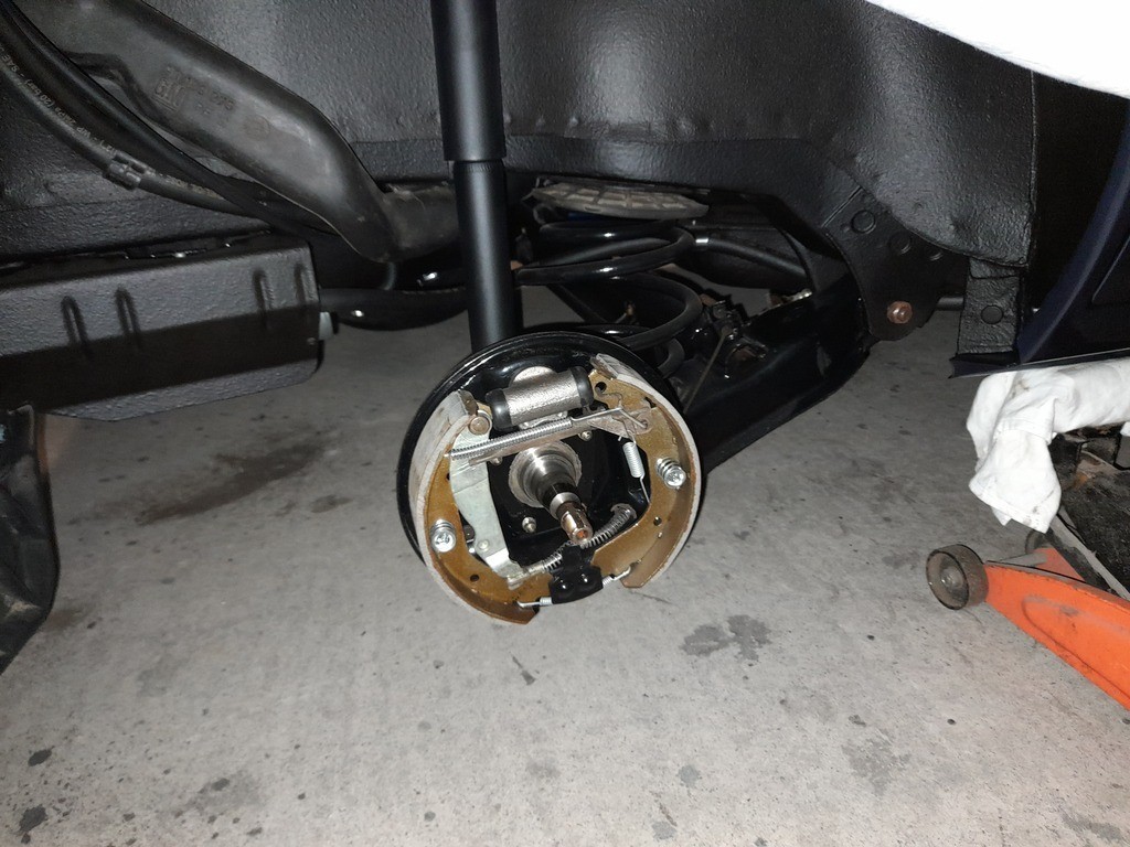

The rear wheels/brakes were sorted on Friday. The wheels were stuck on the drums as both had been painted, and this made it a tight fit! It was sorted by removing the paint from the drum spigot and applying copper grease.
One last look at clean rear brakes.
Drums and wheels back on, then bearings adjusted, split pins + dust cover fitted.
Trims on.

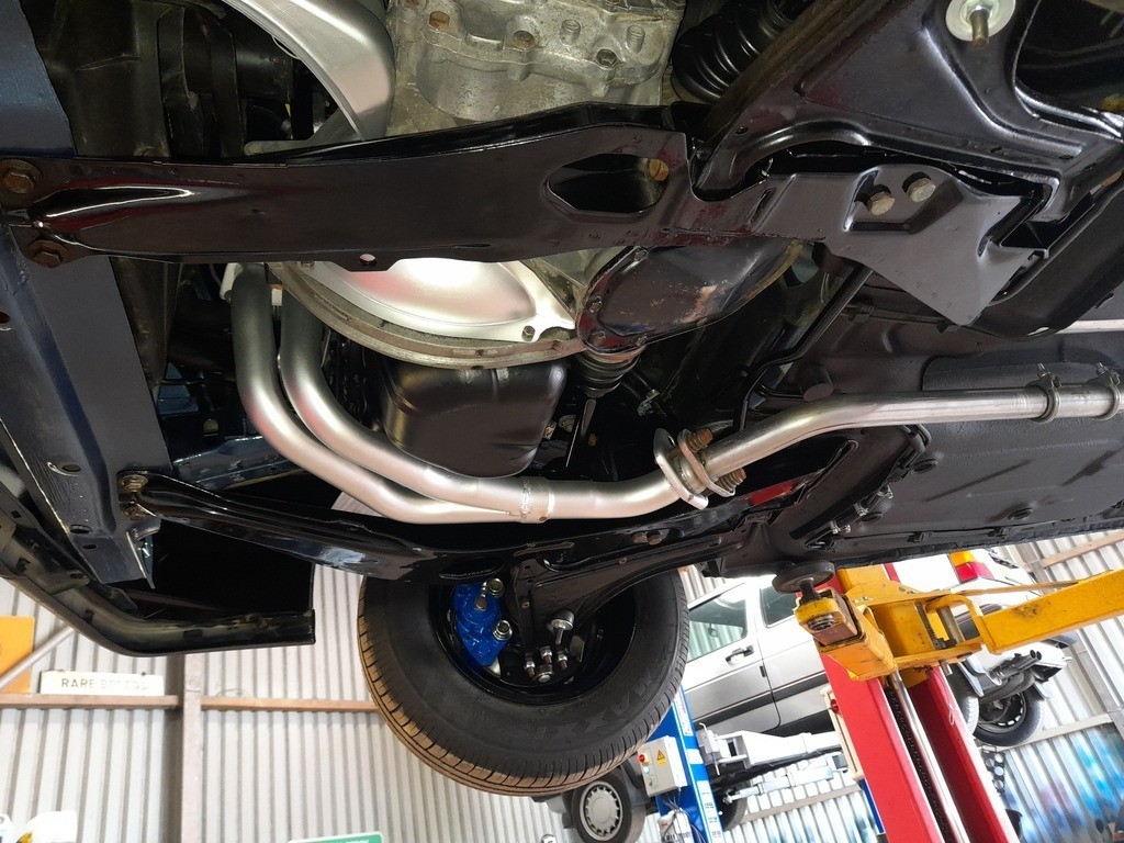

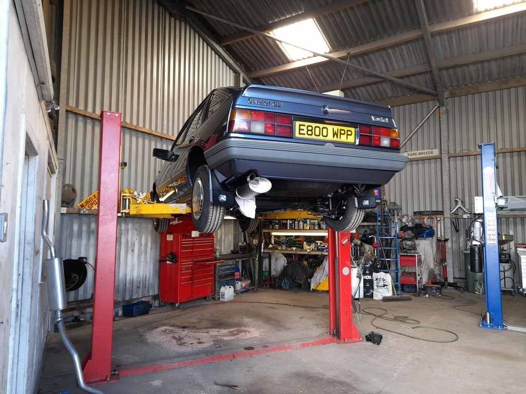

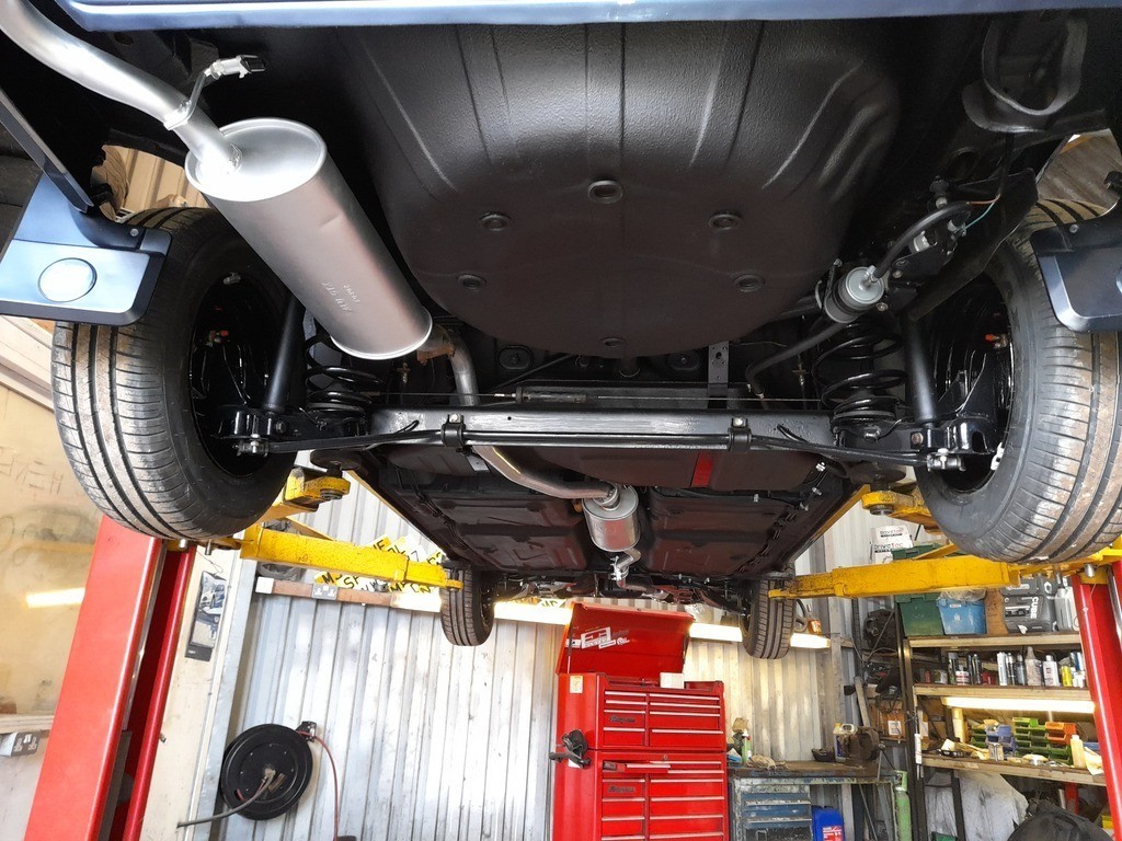

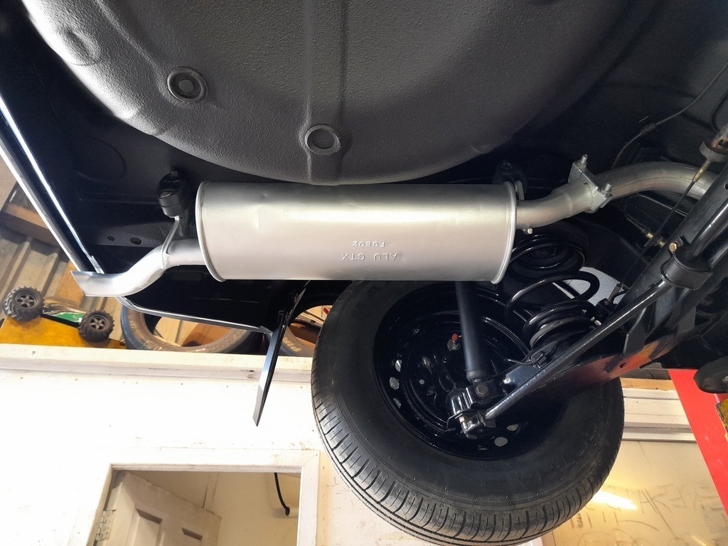

Had the offer of a bit of time on a two poster today, so got stuck in to fettling the exhaust.
Cable ties have been holding the exhaust up since before Christmas.
Quick look about to make sure nothing has been leaking.
I had to shorten the rearward part of the mid section to allow the back box to fit.
Then the mid section was welded back together as it had been cut to enable shipping. It was now gas tight, so it got a bit of a drive around the yard.
Just the pinstripes left to do now. (Plus putting the front mudflaps back on, as I've found some better fixings for them!)

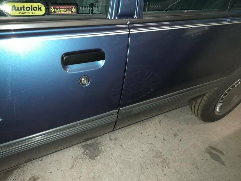

Still waiting for a suitable time slot to get an MOT on this - but in the mean time, a small package arrived from the U.S. of A.
20220504_184436.thumb.jpg.ef177bc042b44bf14fe11e4ce87d0735.jpg.3c9a62f77f4cedfe2e2cb6918797f5b5.jpg
They're the right colour, and almost the correct size, so got some stuck in position.
20220504_185521.thumb.jpg.87d4671bff347f2c9be953179af9d2c7.jpg.8488889e4e7a6bd25a38b4037d084b75.jpg
20220504_184322.thumb.jpg.db54e7a72cb02405a380ecbb6dc10e94.jpg.cd3f3fd75b7bd946df26b81a60319de7.jpg
20220504_184658.thumb.jpg.8814a1ecdae4383d1fcccee4c2198a56.jpg.409c8c54853abd7f8508a9a536e800d4.jpg
Should hopefully be back on the road in a week or so.  :)

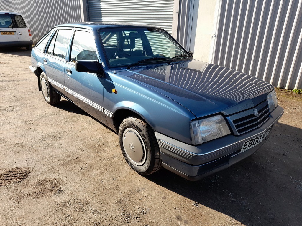

Pre MOT checks done this morning - only problem found was one of the washer jets was blocked. Did a couple of miles up and down the farm driveway to scrub the new brakes in a little, they work better already, so hopefully they'll be up to par by the time I've driven it to the test centre. The underside is now sporting some dirt, the minty freshness is already a thing of the past.  :(  It was alas inevitable.

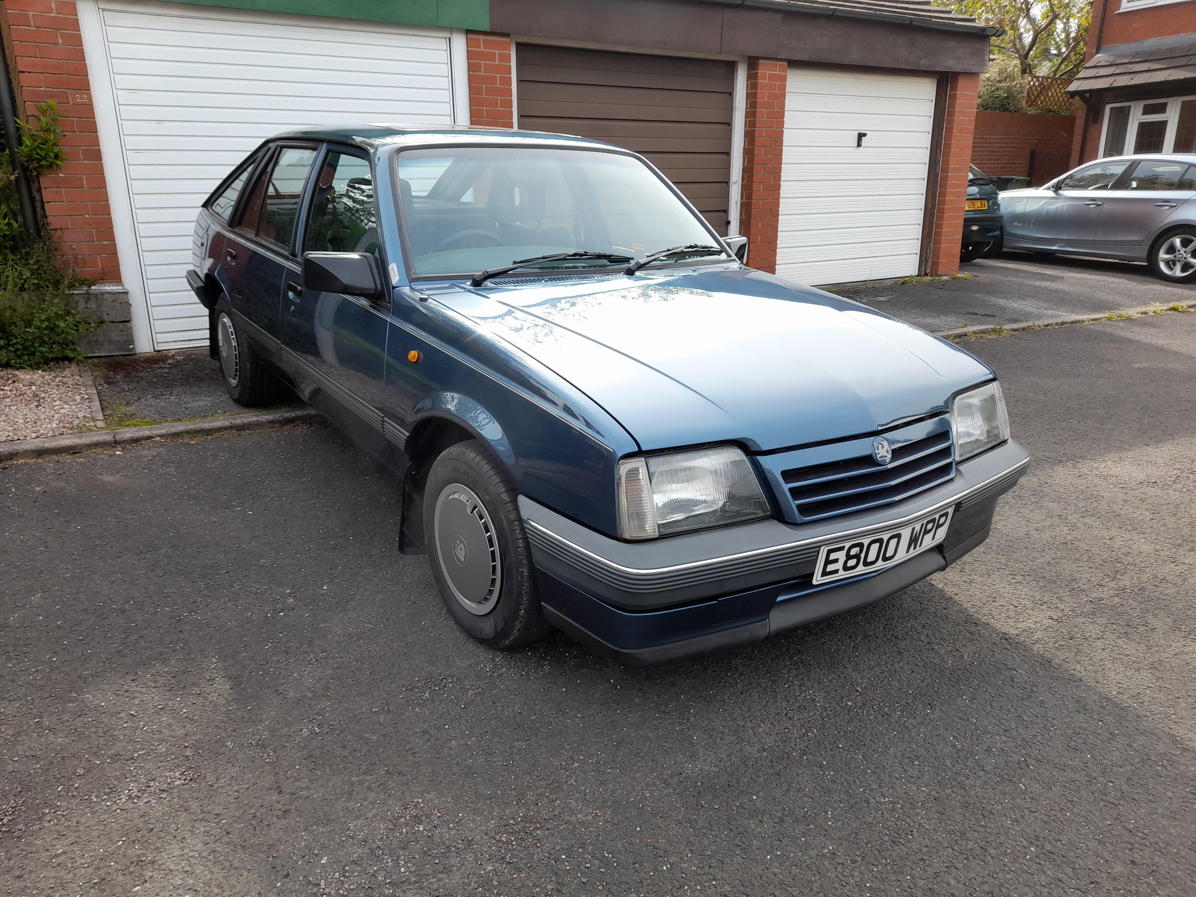

MOT and tax sorted.

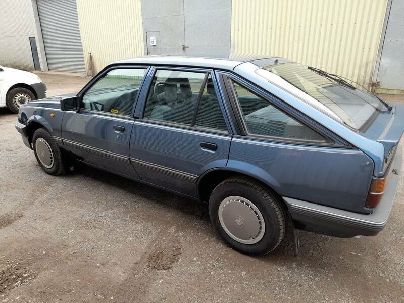

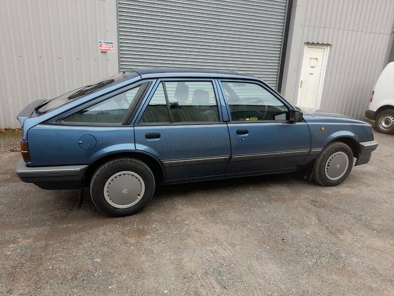

Finally home after 4 years away.   :)

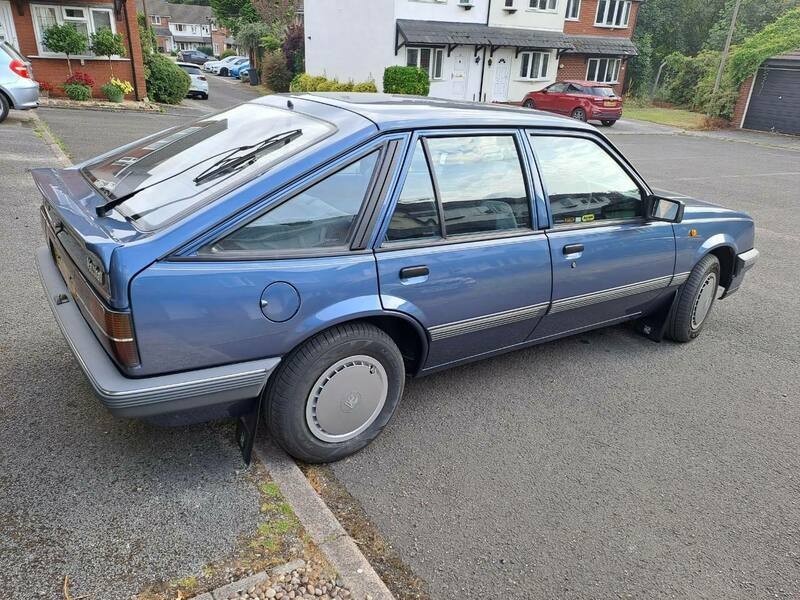

A few pics now it's back on the road.20220508_110213.thumb.jpg.4e460b86efbfed9708d0cbba9105bd16.jpg.1e25922d2a1fbf77a179c57a7f937350.jpg
20220508_110201.thumb.jpg.e17a6eaa8bddb34161ea725fb74c0bd0.jpg.a5166aed37dbec380c65129ac9bef95d.jpg
20220508_110144.thumb.jpg.a110eb3827a185a520e5b80c552ada22.jpg.a1321efc02b2a68c1b6de3d05853d25b.jpg
Next project will probably be Polo related.   😃
