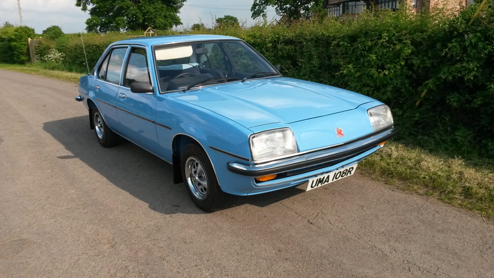

Nice work! I've driven the Mk1 Cavalier in Vauxhall's heritage collection - it's a decent drive, I was surprised at how good it felt. Vauxhall's Mk2 is an auto, though. I remember friends' parents having them when I was a kid. Felt like stepping back into something familiar, which the Mk1 didn't.
Cheers Alex! The mk2 drives like a modern car - surprising given the 36 years since it's launch. The Mk1 is definitely from a different era though, I still prefer the way the Mk1 drives over the Mk2 - even though the Mk2 would be a lot nicer to live with day to day.

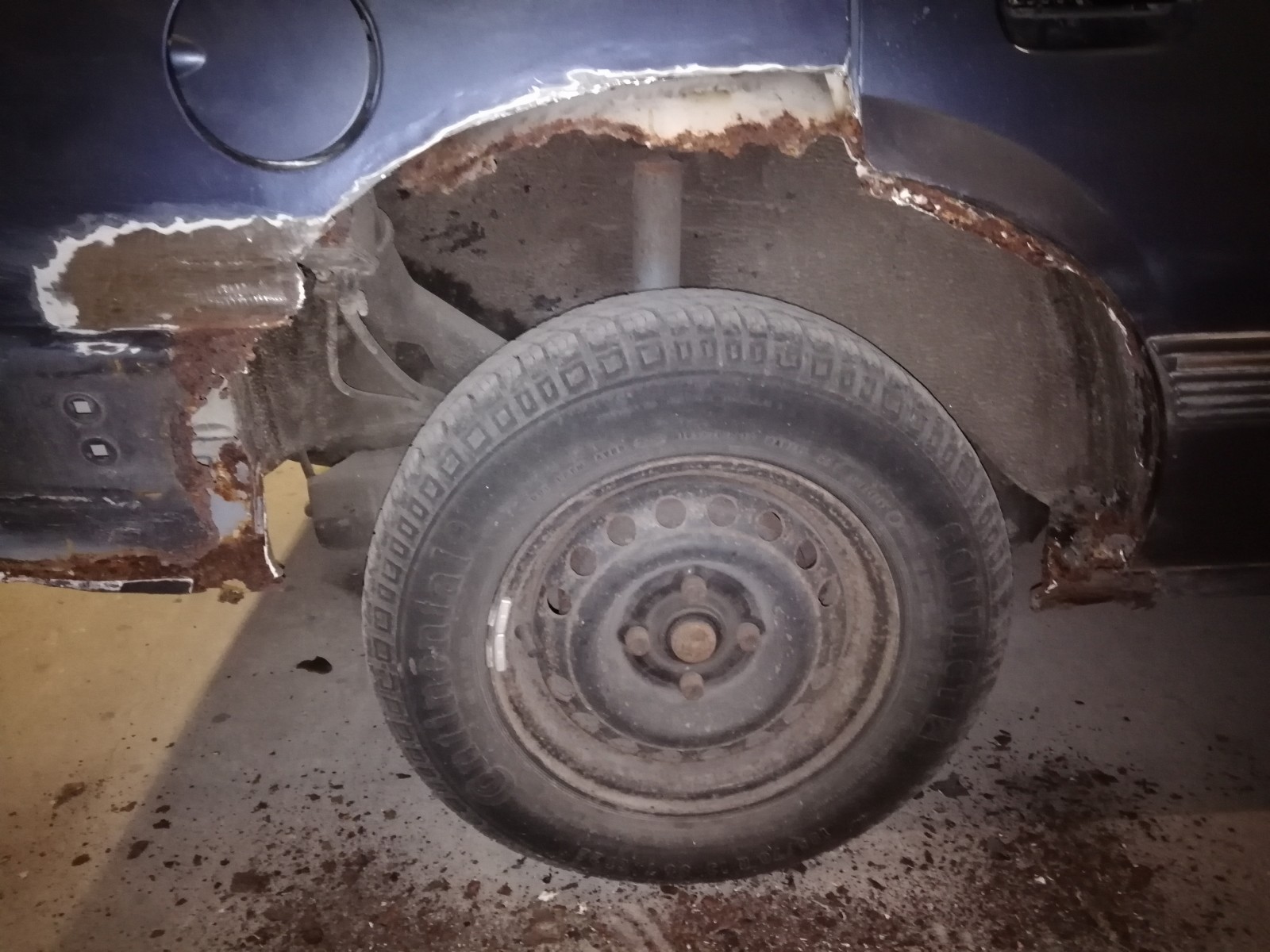

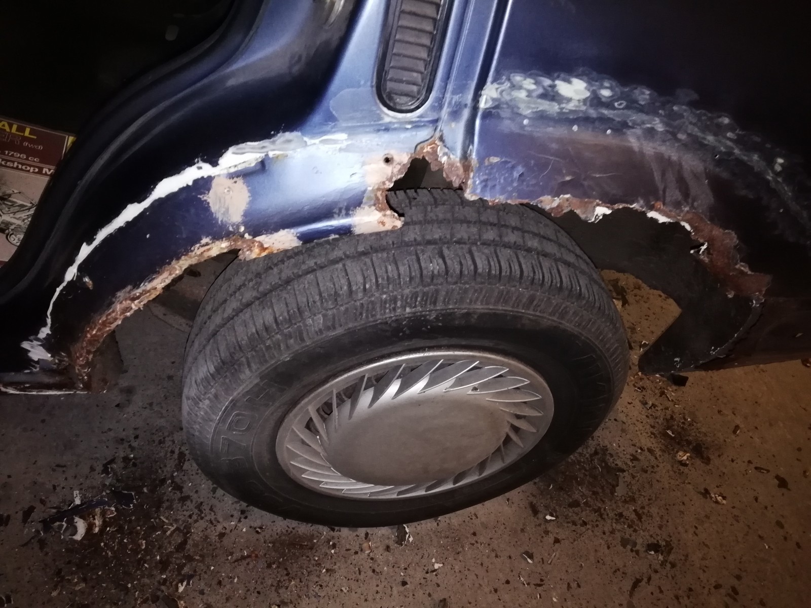

Had a bit of a pick at the O/S rear arch  - as expected, its far from pretty! Its just as it looked - repair panels tacked on followed by lashings of filler. Where the inner arch met the outer lip, a good inch of filler was used to stick the two together.
Just this one small scale excavation has instantly made me appreciate the fantastic condition my MK1 came to me in!

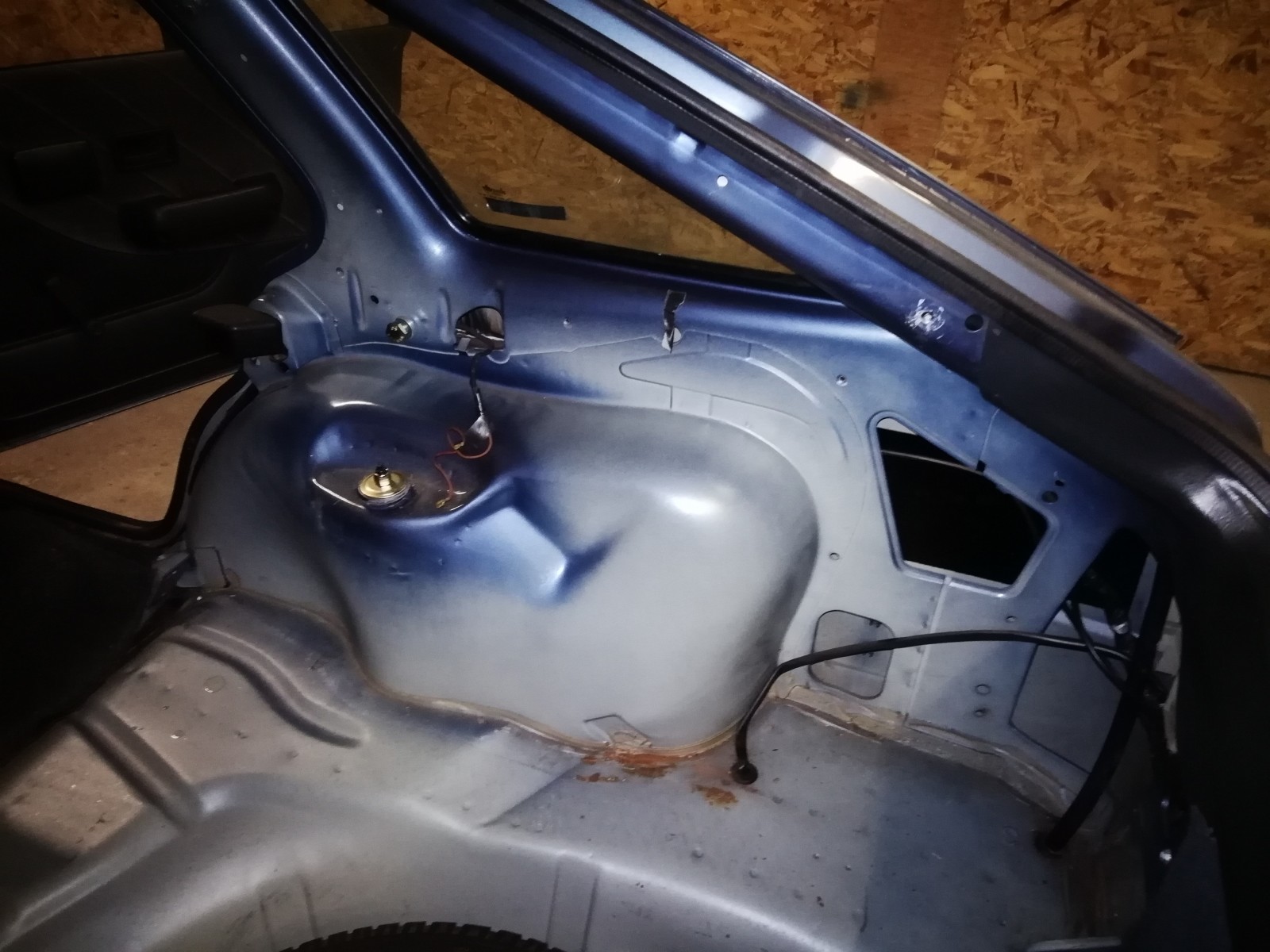

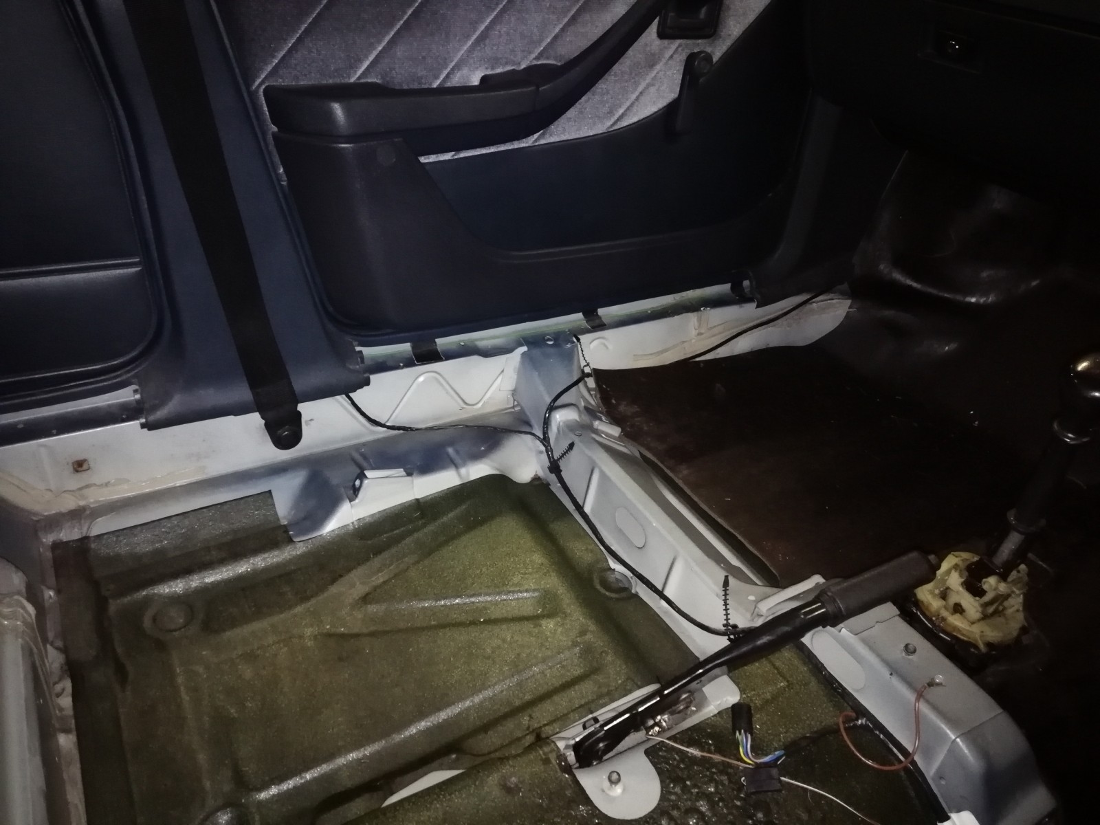

Spare wheel well is pretty good - a couple of rusty bung holes, but good and solid, and will clean up nicely.
Near side wheel house looks pretty good now the rear interior trim is out.
Theres a little bit of rust peeking out between the boot floor and the off side wheel house, it doesn't appear to be soft, and withstood a good stabbing with a sharp screwdriver. This will be properly investigated at some point.
So far, so reasonable! 🙂

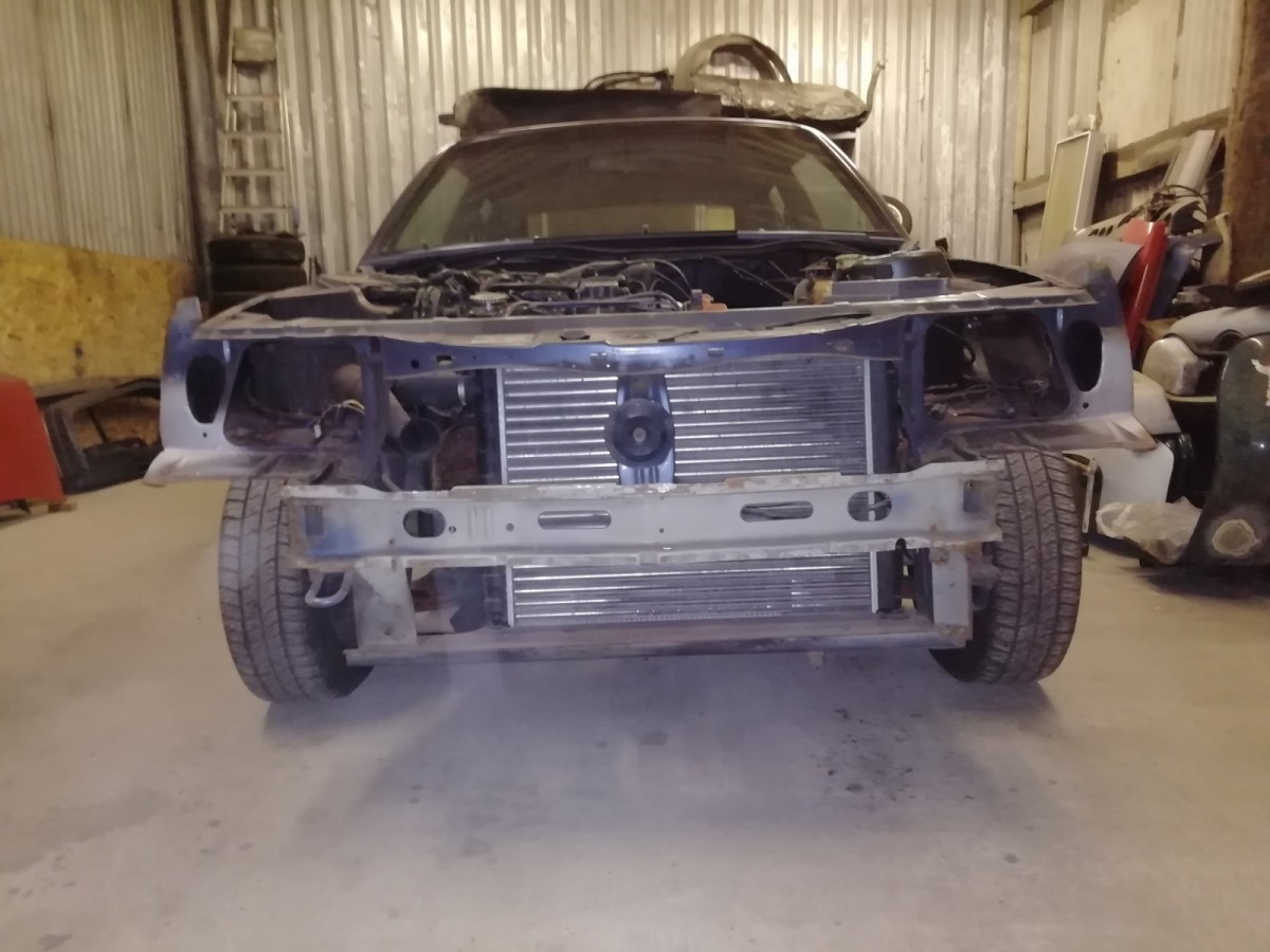

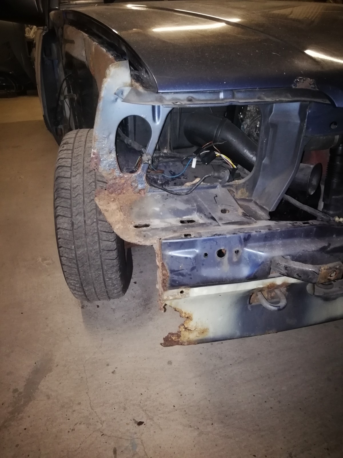

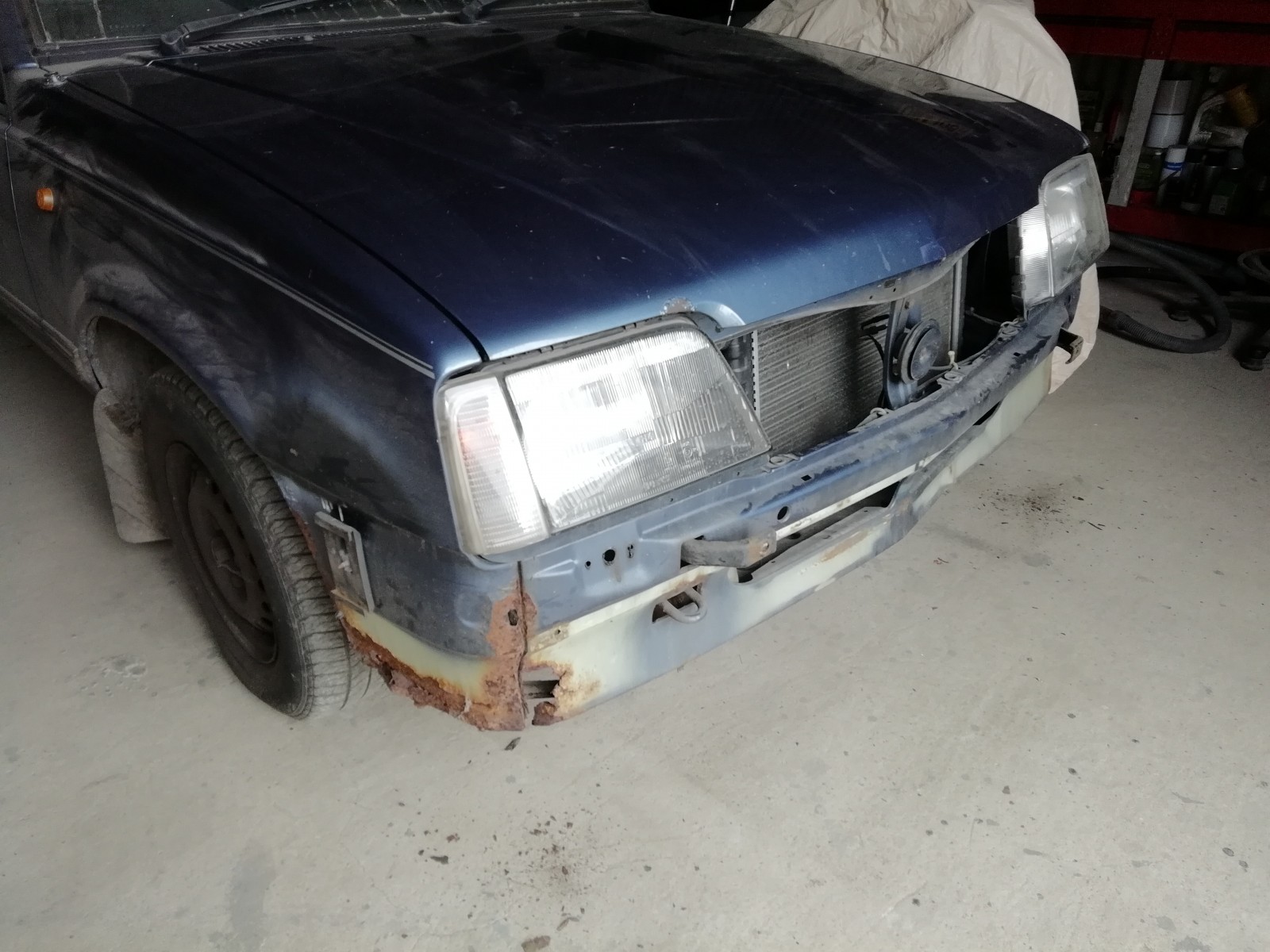

The front bumper and lower spoiler type thing were removed next to reveal very crispy wings and edges of the front valance where the wings attach.
I could probably repair the valance, but it looks like I could do with a pair of wings. 😞

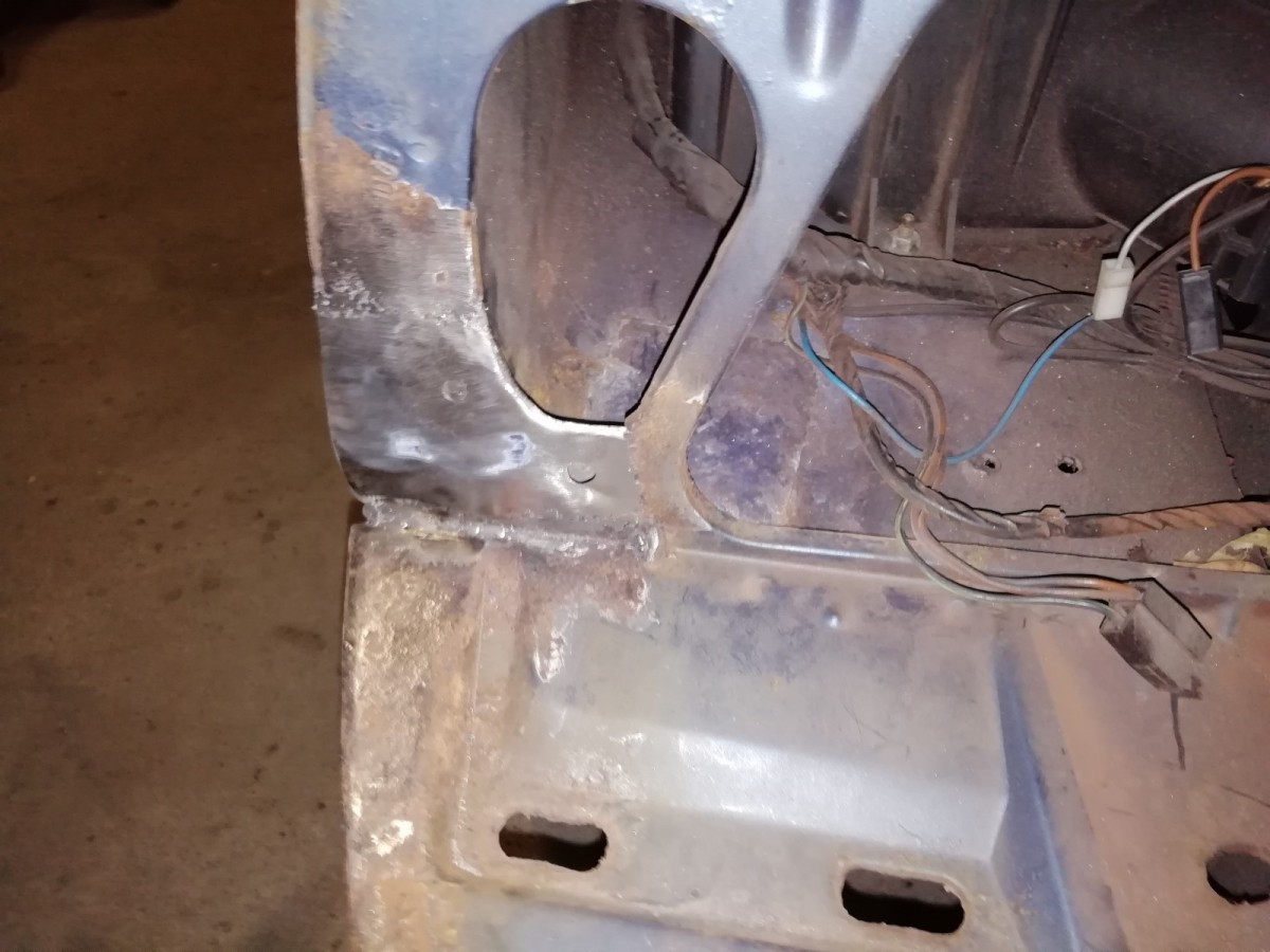

Next up, wings, arch liners, rear side glass and roof gutter trims all came off. The driver's side front wing may well be past saving, but the inner wings seem to be pretty reasonable so far (may be some small repairs needed after its seen the wire wheel!)

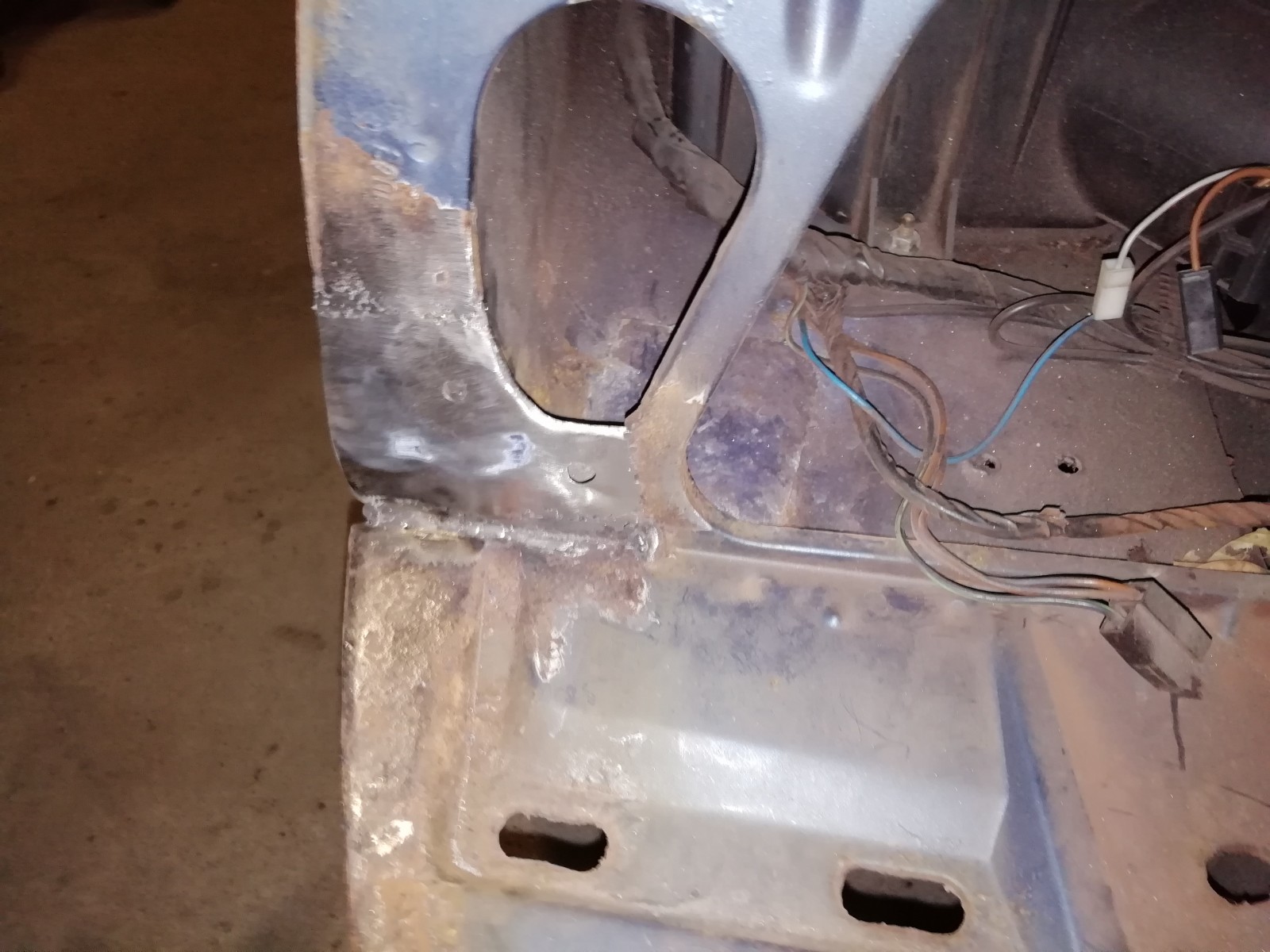

The passenger side wing is much better - I'll possibly be repairing the lower front section on this. The inner wing on this side looks pretty much spot on (wire wheel notwithstanding)
The sides of the panels behind the headlights have rotted, and will need repairing - hopefully it won't be too difficult to make a nice job of it. 🙂

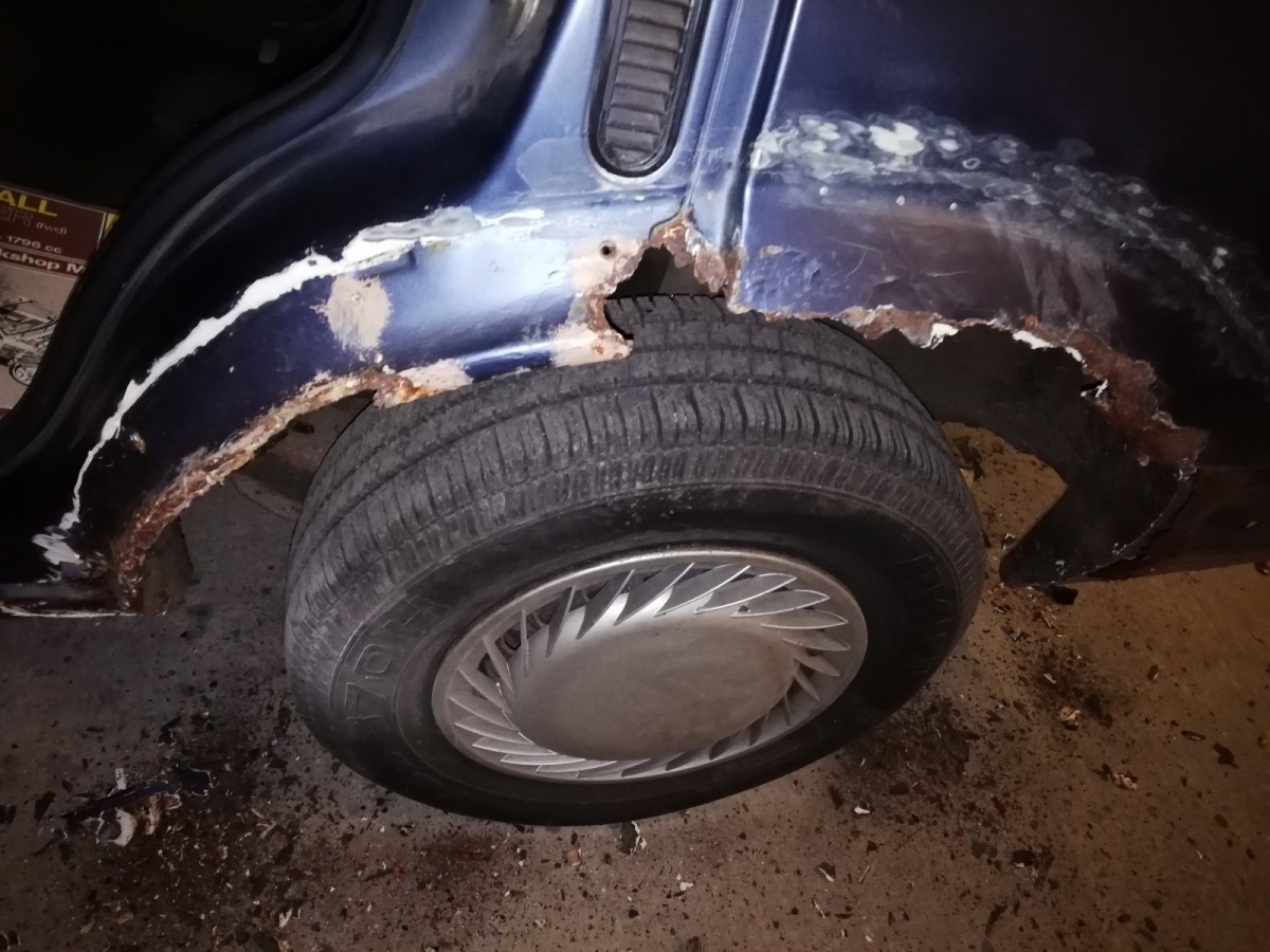

After that, I couldn't resist it any more - the grinder came out, and armed with a wire wheel, flap disc and slitting disc, the O/S/R outer arch "repair' came off
There's not much left of the outboard side of the inner arch once all the structural filler and mesh came off!
I was hoping that there was more inner arch left than that - its gonna be a bit of a mission to remake that so it looks right! Hopefully I can modify a wheel tub for a different application to make a decent job of this as a replacement doesn't appear to be available!

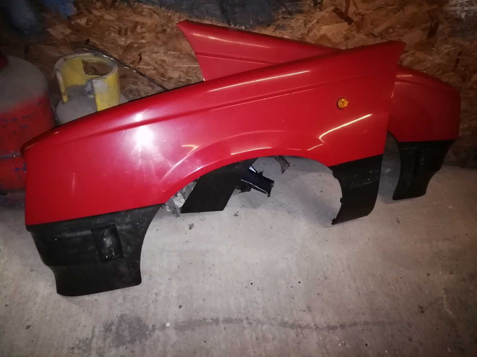

Collected a decent pair of genuine wings to avoid repairing my proxy ones.
They were a long way away, but the pair were less than half the price of one new GM wing. 🙂
No more actual work done that day, but less bran flakes to contend with can only be a good thing!

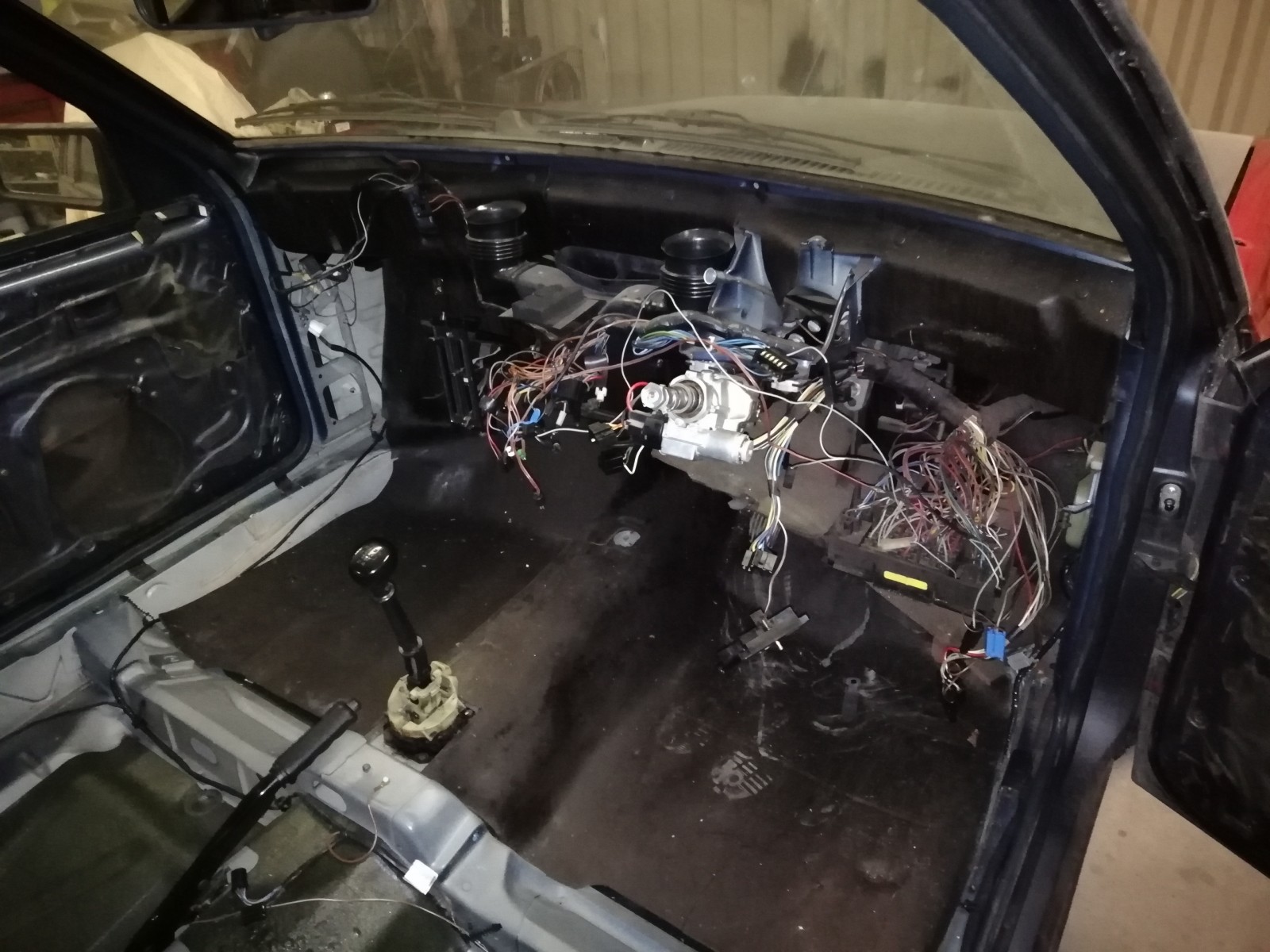

Armed with a couple of hours spare last week, I prepared myself for the deep joy of dashboard removal. I don't have a steering wheel puller, so hit it with the violent wiggling trick. After a few minutes of that, coupled with a bit of professional grade language, it popped off.
As is normal, the Haynes book gave me a few clues, but I had to work out how to remove some of the parts which ate up a fair bit of the time available.
Once I'd discovered how to remove the passenger side air vent, radio and central vents, the operation sped up somewhat.
And its out! 🙂
Took out the comedy air vent ducting (similar to the MK1)
I'd run out of time now, so had to leave the heater box and wiring spaghetti for another day. My target for the day was to get the dashboard out though, so jobs a good 'un!

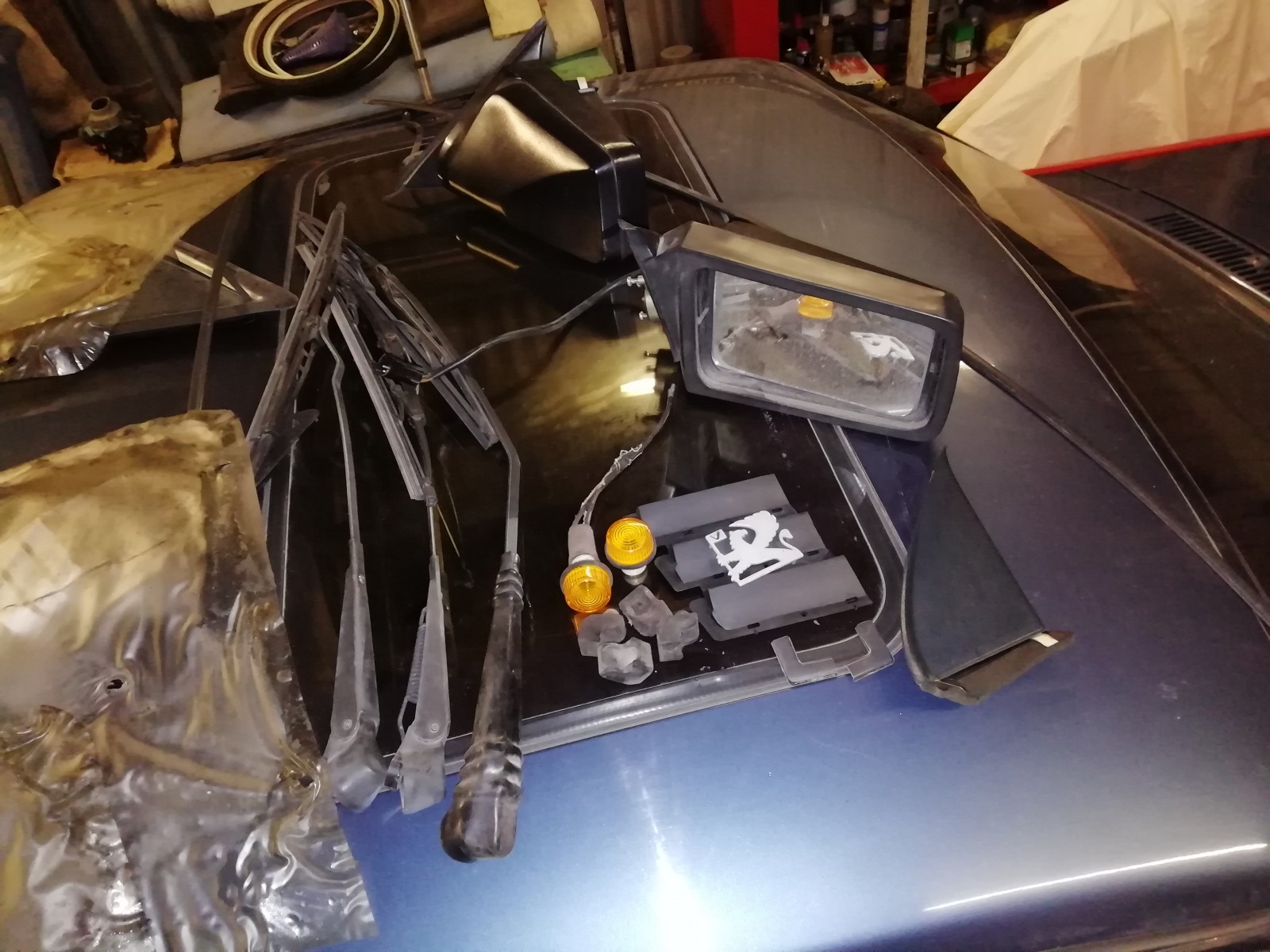

Grabbed an unexpected bit of stripping time on this earlier - the bumper brackets, side repeaters, mirrors, wiper arms, windscreen trim, door membranes + removable parts of the grill all came off.
Window bottom trims were next - great care was taken to avoid distorting these as they're made from a soft alloy - I seem to have gotten away with keeping them nice and straight. 🙂

Next I decided to remove the outer part of the front valance. I was going to replace it in its entirety, but it would be difficult to weld it on without unsightly beads on the end of the chassis rails. This way I had the joy of unpicking all the spot welds holding the front part to the beam behind it. (And look forward to separating the two parts of the GM replacement!)
