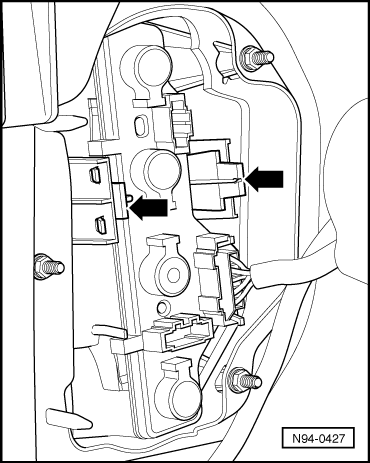

I noticed when I got home last night that my rear passenger side light was out. I had a quick search online and Halfords say that their 207S bulbs will fit, so I'm going to nip in at dinner and pick some up. Am I correct in thinking that it's a pretty easy job to swap out a bulb; that it's a matter of uncovering the light cluster from within the boot, unclipping the cables and cover, swapping out the bulb and then putting things back. I don't really want to pay Halfords a fiver for something I could do in a couple of minutes.

  • That is the correct bulb   Disconnect the connector Release the retaining tabs Arrowed and take out the bulb carrier   Bulb twists out of holder   Refit in reve
Refit in reverse order
That's great, worked first time :D
