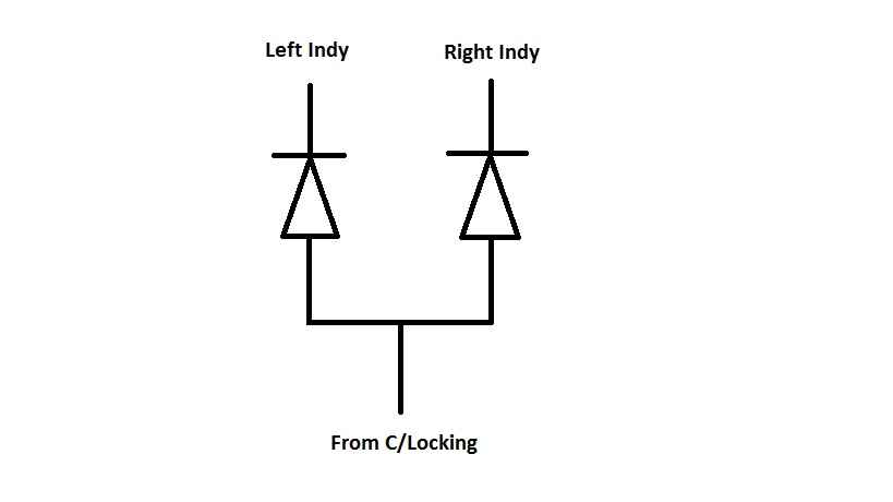

I would connect a multimeter to either the Brown or White wires and see if you get a 12v pulse when you lock/unlock, if you get that, you'll need two IN4001 diodes (maplins or ebay) connect the wire that gave you the 12v pulse, to both of the negative end of the diodes, then from the positive ends run wires to your left/right indicators
6 hours ago, nige8021 said:
is would connect a multimeter to either the Brown or White wires and see if you get a 12v pulse when you lock/unlock, if you get that, you'll need two IN4001 diodes (maplins or ebay) connect the wire that gave you the 12v pulse, to both of the negative end of the diodes, then from the positive ends run wires to your left/right indicators
Thanks nige . I dont Have a multimeter to test. The Instructions Says the Brown wire Is unlock and the white wire IS Lock For the aftermarket alarm. I think Im gona order the Diodes and Split the Brown Wire Into Two.
You don't have a multimeter !!!  go out and buy one prices from £5 it'll pay for itself, but until you do, just use a 12v 5W  rear sidelight bulb connect it between the chassis (ground) and your Brown or White wire, if the bulb lights there is a 12v pulse out, but it might not be capable of powering the 6 indy bulbs that's 8amps, the output might only be capable of very low current to signal the aftermarket alarm system !!  If there is a pulsed 12v on one of the wires, it would be better to use that to control a relay to switch a 12v live supply via the two diodes to the left & right indies :)

@nige8021 thanks for the diagram.  Been looking to buy that boot locking mechanism but cheapest I found was £30 on ebay, which I would'nt buy because I feel like im being ripped off. Found one on the 6n/6n2 facebook parts page for £16. Hopefully that should be here by Saturday-Monday.
