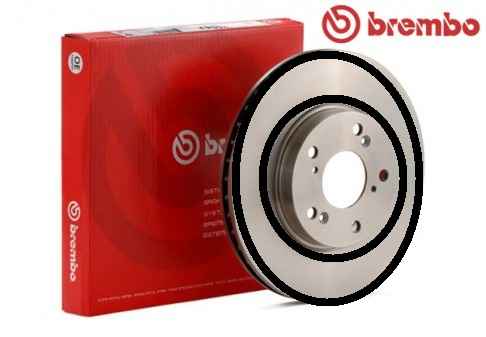

As for the brakes had wheels off quickly today when was raising and I noticed that seems as if only part of the brakes are braking if that makes sense? Any idea what would cause this, everything seems fine, only thing I noticed was there was no grub screws on discs could this be partly to blame.

So you mean the pads are wearing unevenly? This is likely down to sticky or seized slider pins. Ideally you should have taken those out and given them a clean and greased them up when you were doing the brakes. The grub screw not being there won't make a difference, it is just to make life easy when fitting the discs and locating the wheels. Once the wheels are on the disc will sit flat against the hub.

We had to fit new caliper bolts as they were rounded so almost positive we greased everything before putting back on, it is as if the top and bottom of the pads are braking but the middle of them are not, will attach a photo of a disc and highlight in black where the pads appear to braking.
