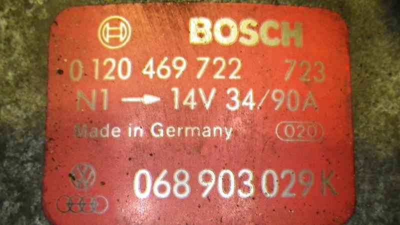

if anyone is intrested this is the alternator that is almost a direct fit on polos
its from a passat /golf diesel late 80s /early 90s
get the alternator and swap all the pulley/washers over from the original  , then you will find the upper bolt hole is 10mm vs 8mm on the old one , you can either purchase some sleeve bearings for a few pence to push in and convert to 8mm or drill your mount and use the 10mm bolt
lower bracket will need a m8 bolt and washer on the early polos without the toothed wheel adjsuter
belt ...well they seem to vary , seems i need a 690 x 10 mm , but my mates gt fits with the original so be prepared to mess with that (same pulleys but bigger alt doesnt allow so much movement to slip belt on)
i also upgrded the wire to 4 guage

okay more info
standard belt should fit standard engine - mine needs a differant belt as the abd has some extra bosses cast on the engine block that prevents the alternator swinging as far as it needs to
