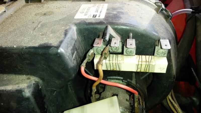

Hi
My blower fan on my Mk2F Coupe is only operating on speed 3 so I think the blower resistor is shot.
I am struggling to find a replacement resistor, can anyone help ?
Thanks
Peter

  • If it's only working on 3 then it will most likely be the resistor, This is the wrong section to ask for parts though, So please make a Wanted advert in the Classified section.  https://www.clubpolo.c
  • Look at this on eBay http://www.ebay.co.uk/itm/371719900116   should be the right one
If it's only working on 3 then it will most likely be the resistor, This is the wrong section to ask for parts though, So please make a Wanted advert in the Classified section.  https://www.clubpolo.co.uk/classifieds/category/8-wanted/
Thats great thanks for your help !
