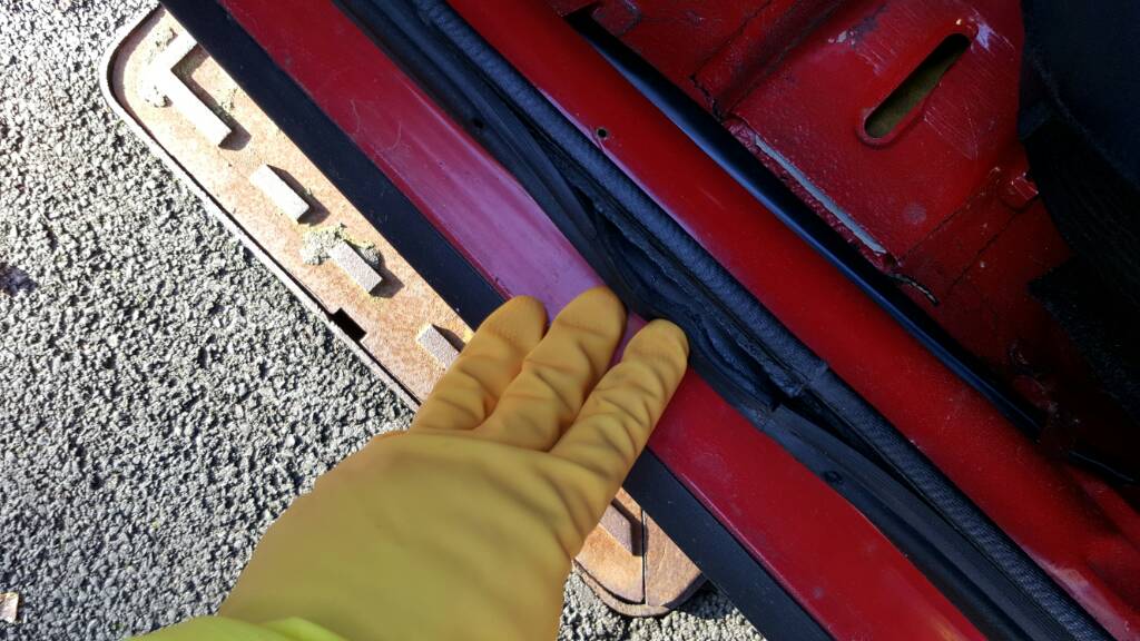

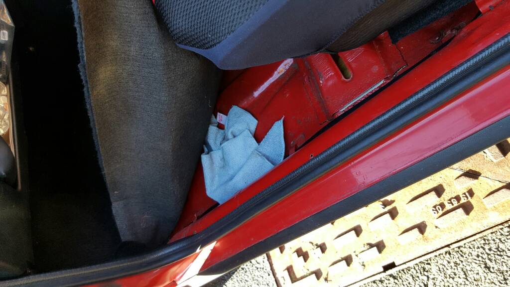

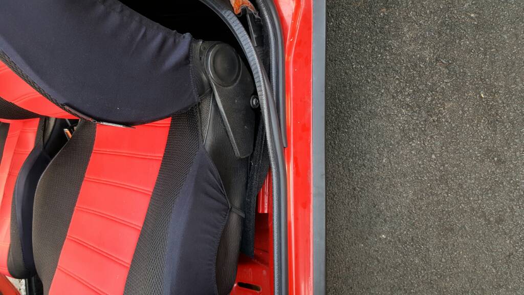

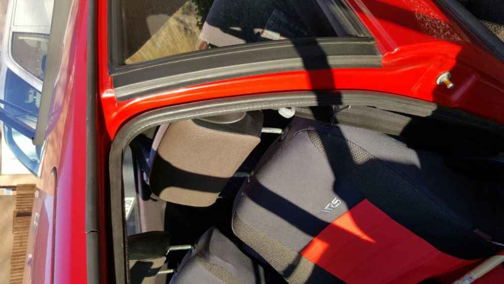

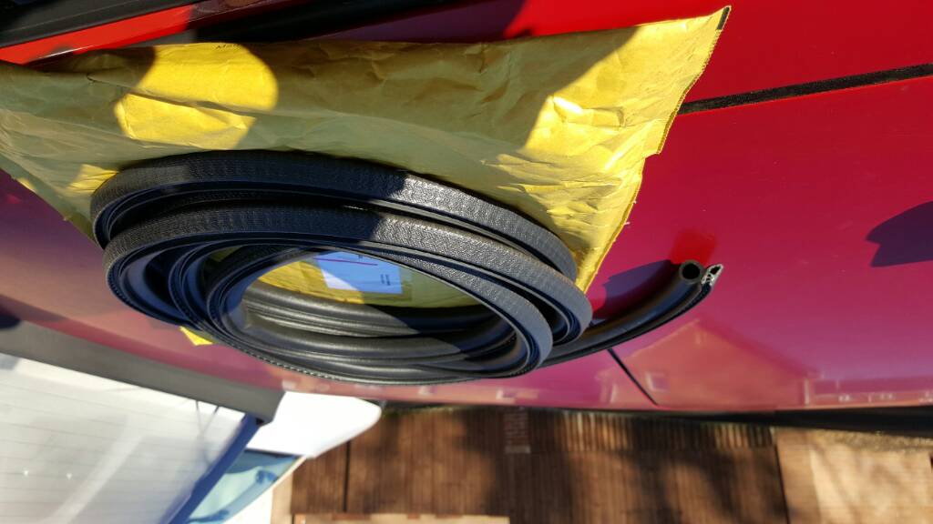

First photo is of the old split seal on the car. Second is the new seal from Woolies and the other two are with the seal on the car. Looks the part and does the job at a fraction of the cost of a dealership from Germany through VW Heritage coming in at over £100.

Looks the part. Where is the join ? as on original one its at the bottom . Have you got a link for the new rubber supplier ?
Just did an online search for Woolies. Going to let it sit for a while to settle in then cut and join. Not sure how to join yet have used tape in the past but will look for something more permanent.
Sent from my SM-G920F using Tapatalk
Edited by c.w.pritchard
not joined at all from new....just a little tube inside the hollow part
found a 1mm disc in a angle grinder cuts it neat if you haveone
