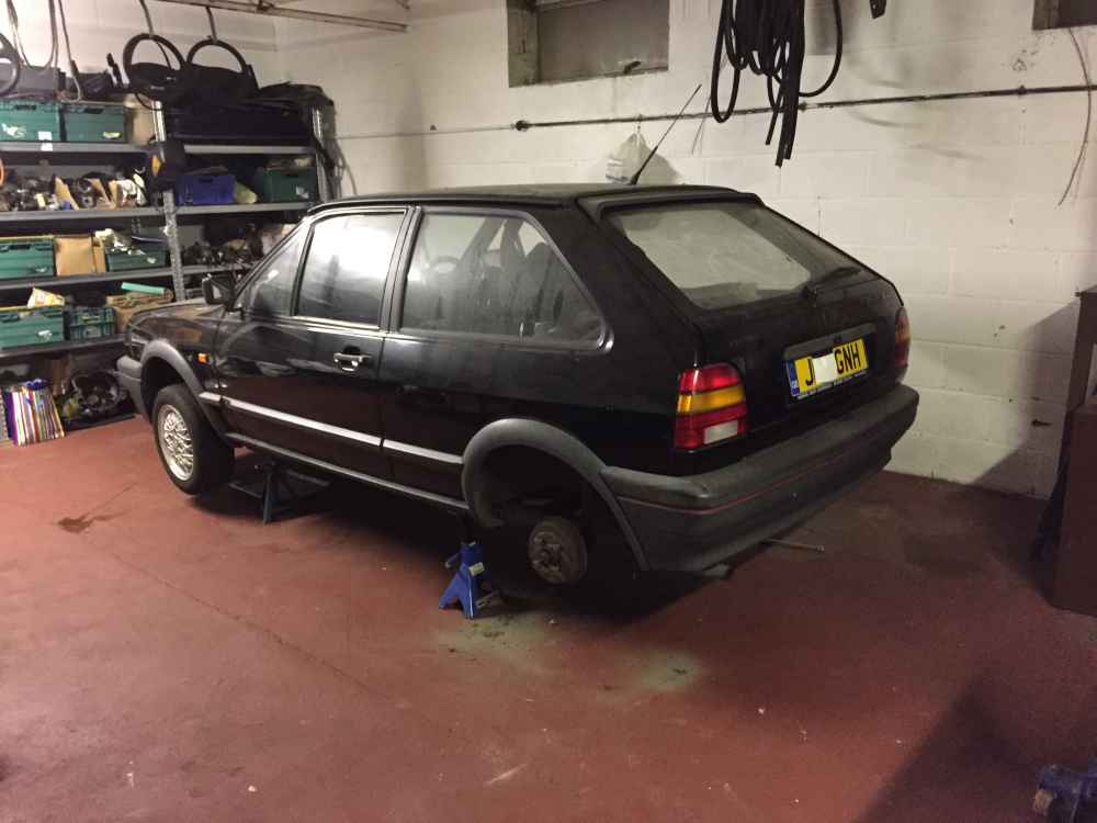

Anyway having not done anything with it in some time I got it up on stands tonight, removed the rear wheels then ran out of tools as they're all at home.

Poor thing needs a wash!

Loads planned. Rear beam is coming off to be overhauled. I have a decent one on the wife's mk2 which I might rob back to save some work.
Have both fuel pumps, which will be changed. Sort any underlying rust; there's a bit around the windscreen and the battery tray needs sorting. Doors need replacing - I have a spare pair in black along with wings (although I made a mess of one of my spare wings). Then once it's in reasonable shape may get it resprayed.
Gearbox has dumped its oil slowly all over the nice painted floor. Will pull that out and swap it for a spare and give the engine a once over.

nice... G40 rear beam has an antiroll strengthening rod. So unless yours is really rotten, your wife's mk2 beam won't be as good.
Gearbox is probably just the selector shaft seal... and can be replaced with box attached (ideally drained).
Thanks. I've previously changed the rear beam on my wife's car for a G40 beam which I'd had Powdercoated.
Having driven it for a year or so; it seems to drive pretty straight.
1B171AD7-D925-4230-88A4-F1B93CE84FF2_zps
As for the gearbox; it feels pretty crunchy anyway. Going to swap it for a spare ATV and get the original rebuilt eventually.
