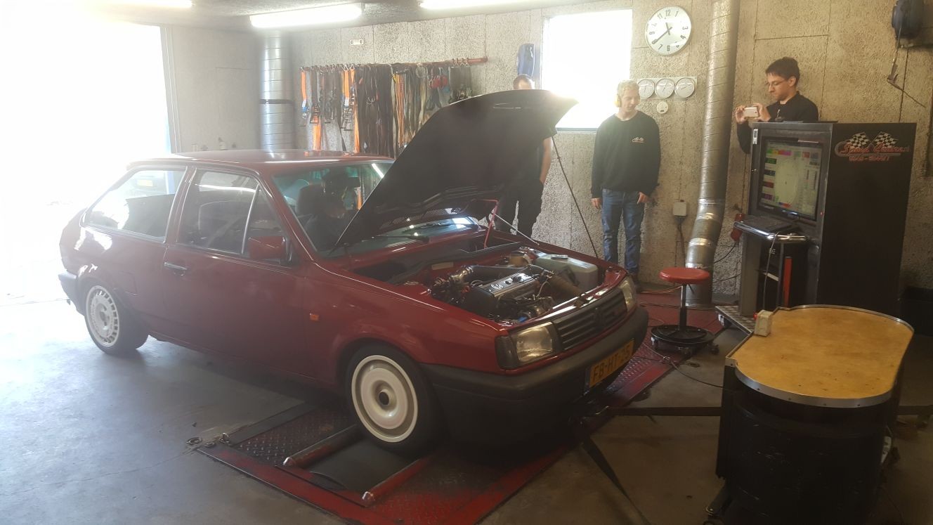

    some news   old engine is out, new fresh engine in. with a ported head and a thinner head gasket, so faster turbo spool and better no boost drivability   i had some serious carter
  • Audioholic
    Audioholic
    another set of wheels. with continental sportcontact tires. 195 40
Love!  Really nice mk3 there matey
some news
i had some serious carter pressure problems with the old engine that was unsolvable, turbo smoking at idle ect. pulled the head ofthe engine and looked inside and came to the conclusion that the guy i got the engine from do not know how to rebuilt a engine, the cylinder walls are like it was honed with a brick, :-(

regardless what i have said about megasquirt. there is an EFIgnition ecu on its way! can't wait!

What AFR was your max torque at?
13.1 ish, just leaned it a bit out and won a lot of torque :D 14 afr while spooling
leaned it above 6300 rmp to a afr of 11,5( was afr 10.5 ish), rest afr is overall 12.
running at 1.2 bar btw..
Edited by Audioholic
Thanks I found 13:1 better on normally aspirated GK than 12.8:1 (with 99 RON fuel).
Are you using knock sensor to retard ignition to avoid detonation as you lean the top end of RPM?
