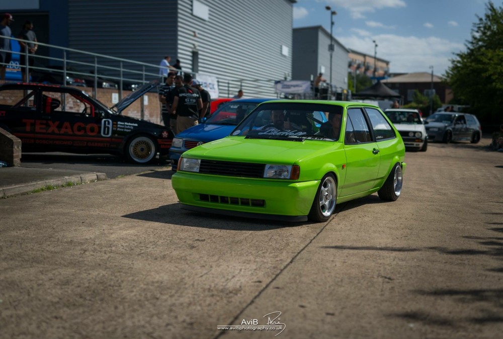

alright boys, just trying to work out in my head what's going with my polo (mk2f)
its pritty low, and I was cruising to a meet a while back and hit a hole or dip in the m25, something when bang and the drive shaft weight started hitting the bell housing because the drive shaft Had actually came out about 15-20mm (yes the weight is that close) because of the angle of the shafts being so low but, when I stopped I noticed the drive shaft actually moves side to side as in, in and out the gear box, no up and down movement at all, this is drivers side with this problem,
