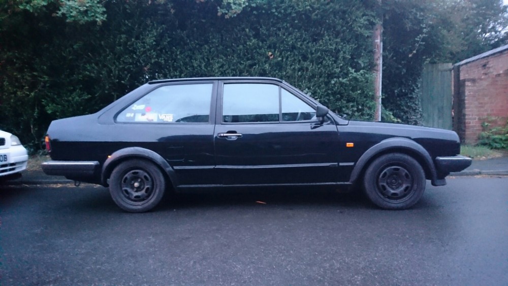

As of August 2016 I became the new keeper of this old girl.  I'd been looking for one for around 4 months before this 1.05L popped up for sale. A friend and I made a 3 hour trip across the country to go and see it with the intention of buying it no matter what. So I did... even though first impressions were that it needs a lot of work!  I'd wanted a new project to get stuck into anyway so it didn't put me off. The odd patch of rust here and there, grille smashed from someone reversing into it, dents here and there. Just generally needs a lot of love thrown its way.
First mod, lose the window stickers.

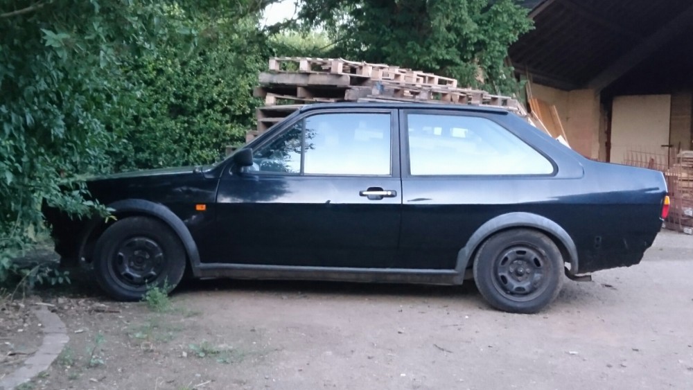

Being a fan of the smooth flowing JDM 70's and 80's cars, I pulled all the door bumper strips off, which make the car look untidy. Also removed the bumpers to see what it looked like. Also to gauge if there was any more rust I hadn't seen. DSC_0091.JPG.337e065d7f071d5ae31c8cd42ea42faf.JPG
I then went a step further and pulled all the rivets out of the arch trims and removed all of that too, again to see if there was any rust hiding on the arch lips. I definitely got away lucky as all the arches came up really nice. Its just a shame about the two front wings as the passenger side has a very bad repair from a previous dented which looks like it was kind of pulled straight and painted over with a rattle can and theres clear coat overspray all over the place. The drivers side has a crease right on the swage line where it meets the arch, drivers looks repairable, but a replacement passenger was ordered.

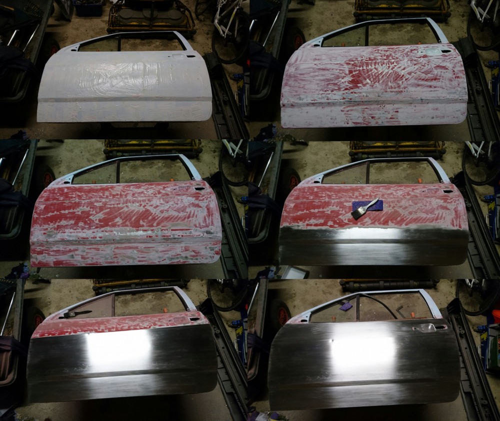

  • Next up to order a couple of doors, passenger door has a big crease vertically down the door which I knew wouldn't press out well. The drivers door has a massive rust bubble across the whole of the lo

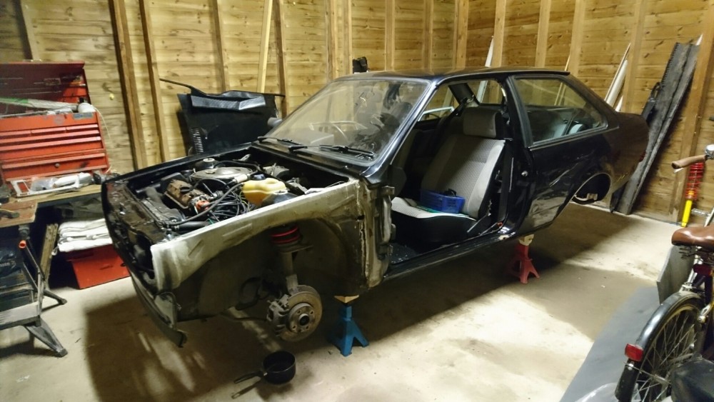

  • Time to start stripping it down!     Engine service done, replaced a leaking sump gasket... cambelt, air filter, fuel filter, plugs, leads, distributor, camshaft seal, coolant all

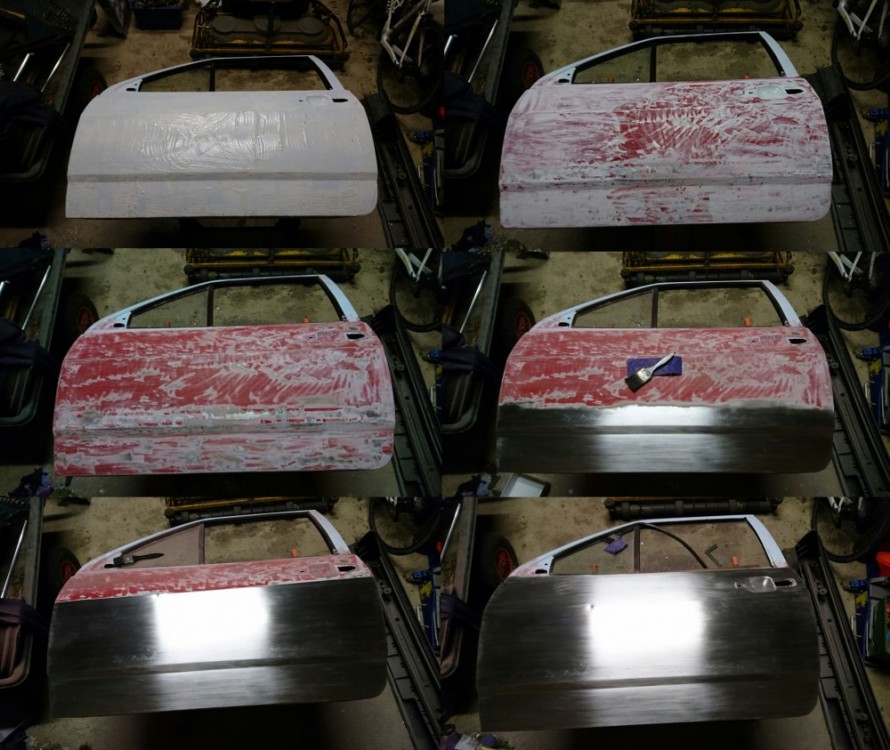

Next up to order a couple of doors, passenger door has a big crease vertically down the door which I knew wouldn't press out well. The drivers door has a massive rust bubble across the whole of the lower section of the outer skin, I know you can re-skin them but thought by the time i've cut and welded it all, it would've been easier to get new doors and paint over them.  So searched for a while and picked up a couple of white ones from ebay. Sold in the description as 'professionally painted' I didn't collect them myself otherwise I would've refused them.. paint was literally just emulsion wall paint that had been rollered on. The pictures on the ebay listing hid this very well. Nevermind eh...  Below you will see my painfully long attempt to strip the paint back (to find that they had been stripped back before with what must have been an angle grinder and have left ripples in the metal, so back to bare metal it goes...
Not too bad underneath, just one or two small dents that were hidden by the paint, these can easily be fillered in and then they will be ready for the primer, paint and fitting.

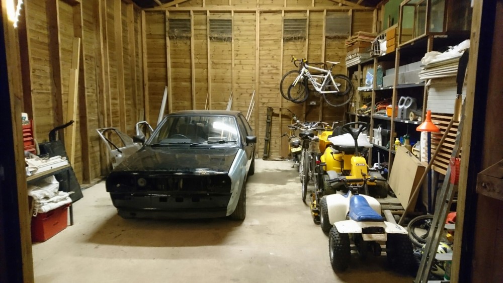

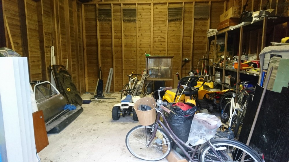

Next up comes winter, and theres nothing I can do on the car outside so time to make some space in the shed and get the car stripped down.
Theres a nice polo sized space over on the left there, a couple of weekends later and its in.
Engine service done, replaced a leaking sump gasket... cambelt, air filter, fuel filter, plugs, leads, distributor, camshaft seal, coolant all new. Good to go!
Also have a new fuel tank ready to go in. (original fuel tank would leak with anything over 15 litres in it, some shoddy quickmetal repair around the filler neck meant it would leak fuel wherever it sat) The rear axle came off in order to dislodge the fuel tank that was well and truly tucked up in the chassis.

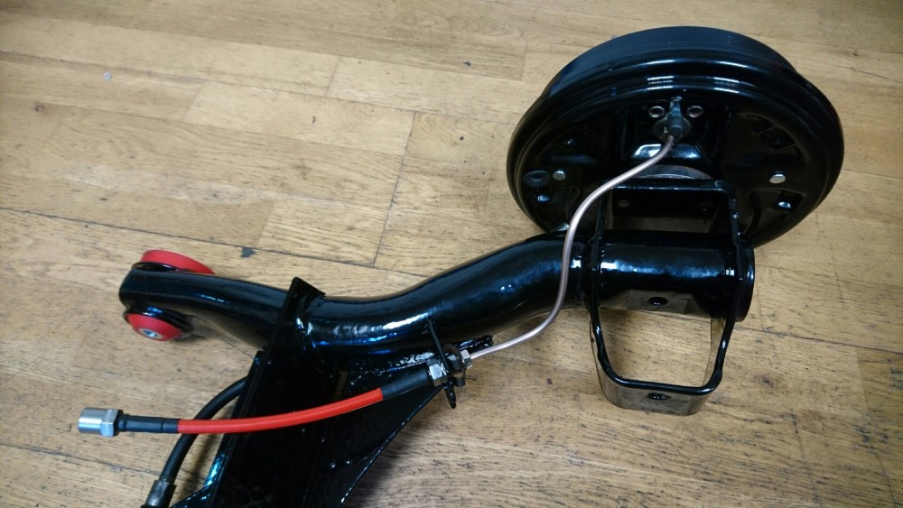

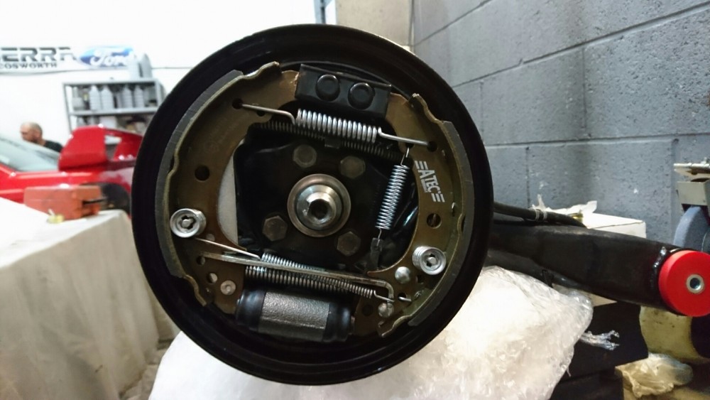

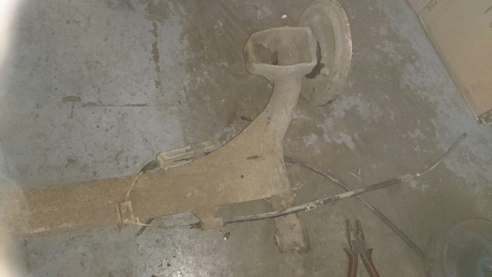

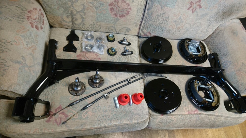

Rear axle back from powder-coating with all the new goodies arrived.
Polybushes for the rear beam to chassis mounts, complete new drum overhaul kit, braided hoses and new brake hardlines.
Hopefully all ready to re-fit this weekend.. After giving the boot floor and rear arches a nice couple of coats of underseal!
axle looks great...do you recall what spec/size bolts you ordered please
Cheers. Had a fair bit of money thrown it's way but the results are worth it. Which bolts did you need spec for?
im planning to refurb my axle , so the pivot bolts and the mounts to the body and stub axle to beam if you can
thread pitch and grade mostly if you can thanks
Can't help on that I'm afraid, the bolts that came out were actually pretty new. Presumably from when the previous owner changed the shocks and springs so I'll be reusing them. Sorry!

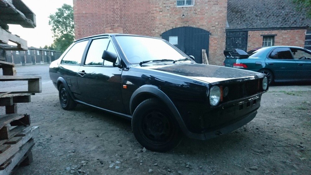

The sill side strips were a bit of a pain in the a** tbh! Mine were riveted in, just like the arch trims. There must have been around 8 along the top and another 8 along the bottom on each side. Just drilled the heads off so that the sill covers could be taken off, then took an angle grinder to them to buzz them flat. Will need painting over but i've got a pair of replacement sills to chop in now instead.
The door strips however do just pull off, and they take some hammer! I pulled on mine so hard they went banana shaped, not sure they would be re-useable.  I eventually used a hot air gun / hair dryer on them to loosen up the bond they make with the door and it made them a lot easier to remove.

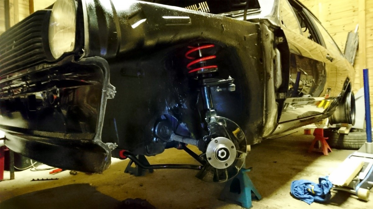

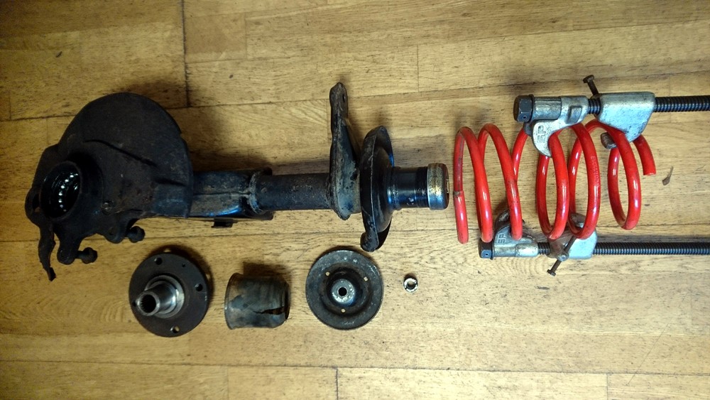

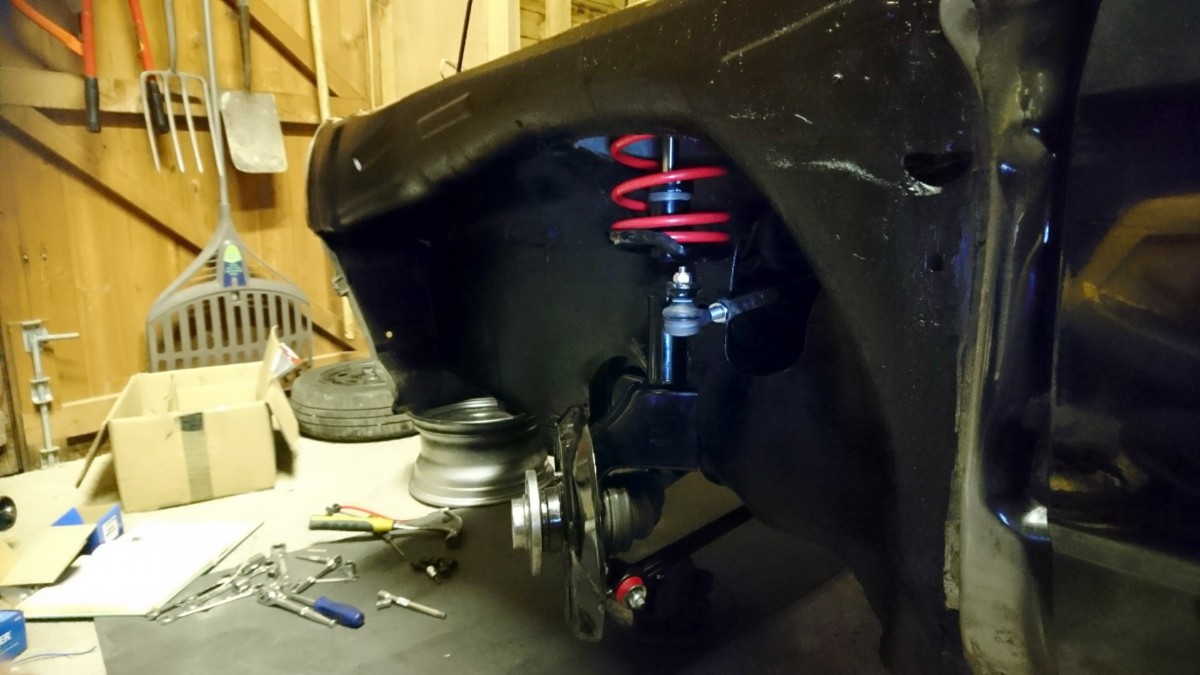

So turns out the front shocks were ruined, I had some new 'low friendly' shock inserts delivered from germany and a whole lot of new bushes and bearings all put on order, and a load more stuff was sent away for powdercoating.

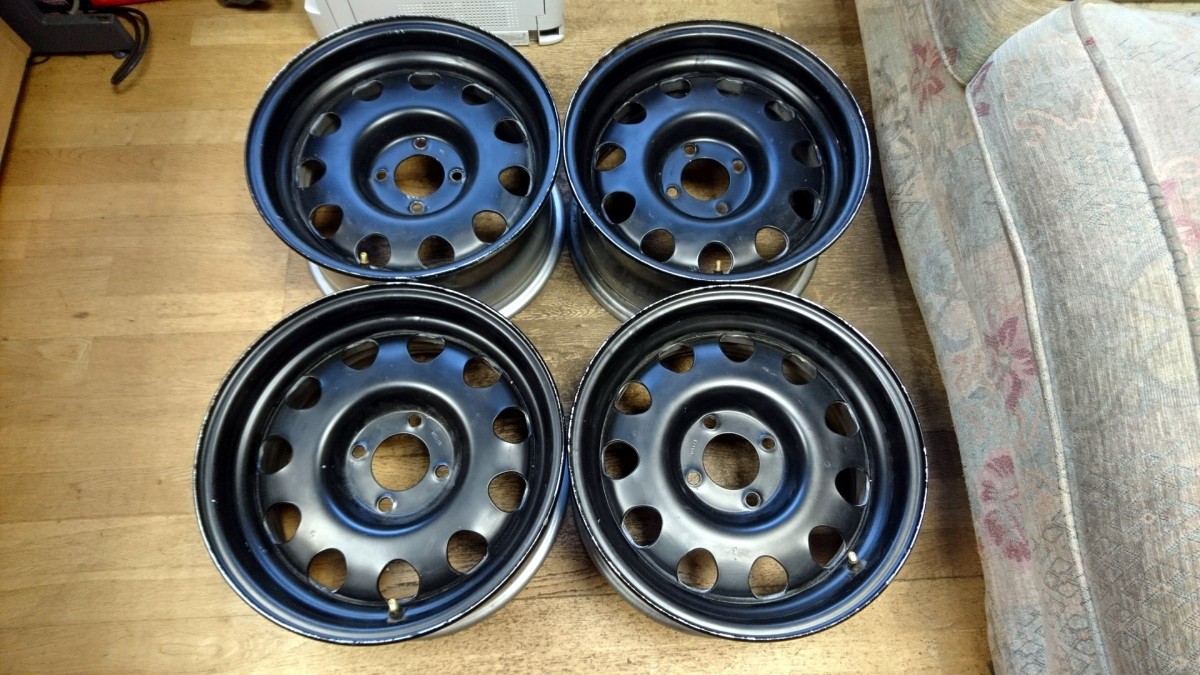

Soon to follow was the set of Weller wheels i'd picked up from eBay, which look like they've barely been used as the the insides are spotless, just look tatty from a bad rattle can respray.
Now time to underseal up the front arches and get the polybushes and shiny new suspension bits installed so I can test fit the wheels.
