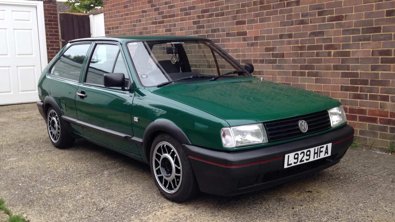

Hello Club Polo!
This is my Mk2f 1.3 Genesis when I first bought her in September. "Geny" is my first car and is in a very clean state for 107k! Underside is clean, rear arches are good however she has had a new fuel tank (Presumed filler neck rot).
Since owning her I have only made some slight changes.
Clear indicators and repeaters,
Klaxon horn hehe
Sony head unit
6x9 shelf speakers (holes where already there) sub and amp,
carpeted boot with floor removable to access spare wheel.
I have purchased a set of 14x6 snowflakes which are being 'refurbished' by myself currently.
New driveshafts, radiator, wheel bearings all corners, water pump and timing belt, clutch and auxiliary belt are due to be fitted. (Have parts-being fitted gradually)
Will post updates with more recent images if anyone is interested!

  • rare colour, only used it in 1993. looks clean too, oem+ dont do any permenant changes

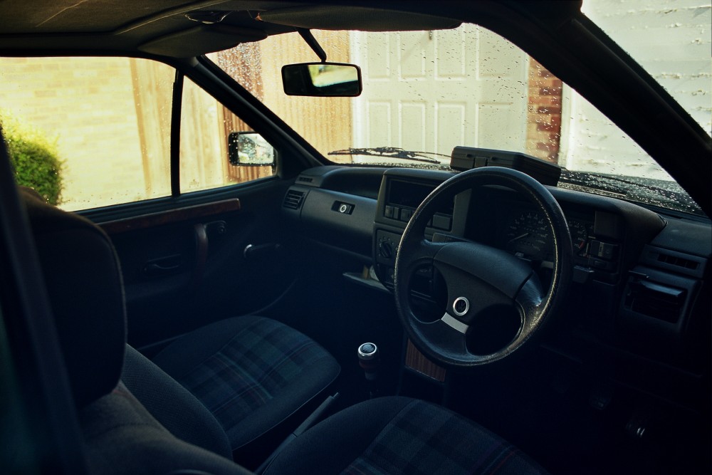

  • This is "Geny"'s interior, good condition genesis interior. The is an an old photo before the stereo went in.  The heater only blew on full power.. so the heater resistor was replaced and th
The heater only blew on full power.. so the heater resistor was replaced and the fan bearings greased, bought some thermal fuses as well just in case! (there was literally none of the resistor there, someone had discarded it all).
Yea tell me about it! Mixed paint is hard to find!
Did genesis models come with red piping on the bumpers? There are remnants of either the factory tape or someone else has had a go.
The rear bumper also looks saggy compared to a few examples I have seen on hear at the sides underneath the rear lights. Is this fixable?
Looks like such a clean example in a brilliant colour!
The arch trims and red bumper piping would have been added by someone as they only came as standard on the GT & G40 models.
The sagging rear bumper is usually caused by the clips on the side of the bumper breaking. The best fix I've seen for this is a bit of metal bent to the correct shape and fixed in place where the clip used to be. If it is the clip on the body that has broken these can probably still be found new on eBay or if not there will be plenty second hand ones going about.

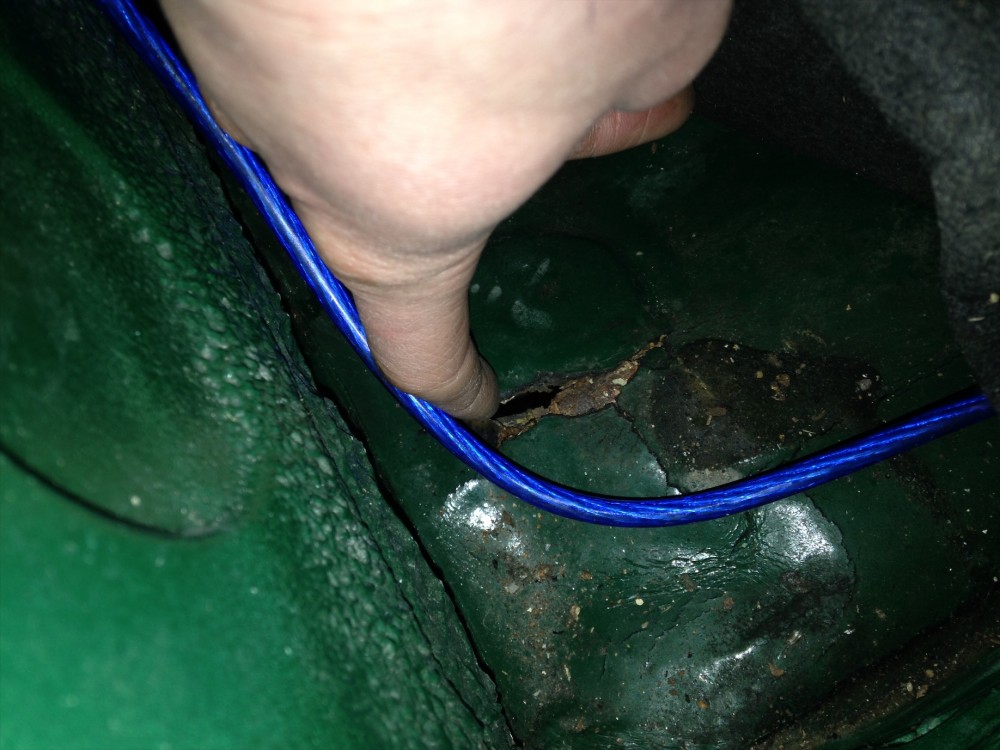

Discovered this today however.. routing stereo cables. Drivers side passenger footwell has a hole in, looks like a failed attempt to jack up the car!
This will have to be cut out and welded properly.

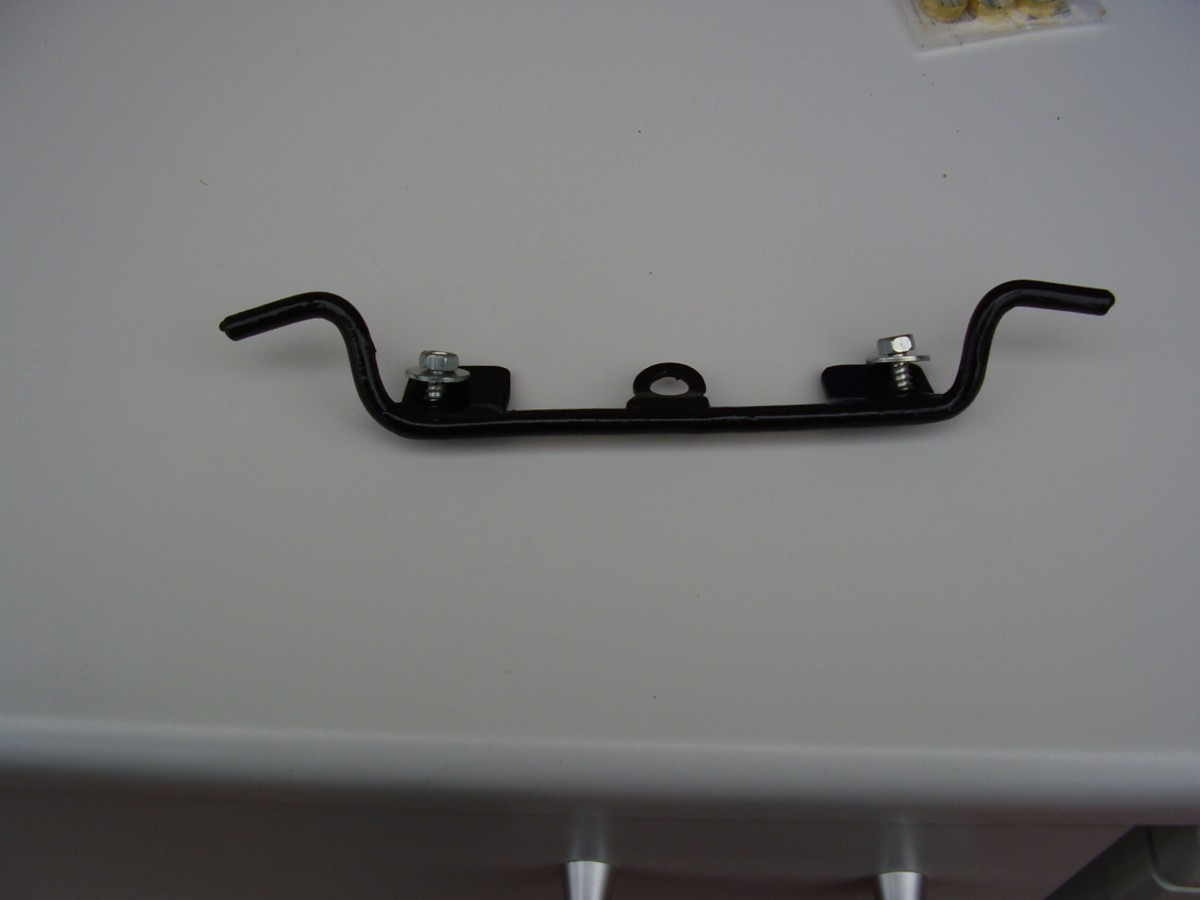

Okay guys, nothing much has changed aside from me blowing the bulb in the Heater control panel.

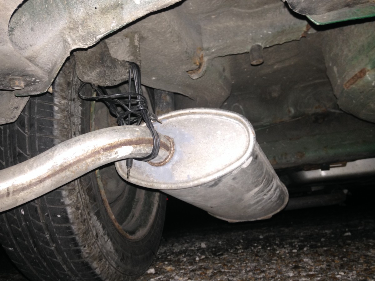

One of the muffler exhaust mounts failed on me driving home at around 1am, it is currently tied by the exhaust tip by an aux cable.
The image shows the current situation, the mount on the left is fine, the other side has snapped, the middle section is also not hung however the cnetre muffler is being replaced as its blowing really badly.
What are my options here, do I drill some holes in the brace by the centre buffer and use an l piece of alu to hang the exhaust on?
(Muffler mounts are fine)
Any help would be good!
Lyle
My right mount also slipped off constantly, metal fatige problem.
I got some hose clamps and secured it that way, haven't driven that much but it also hasnt come lose.
Use your left rubber as guidance and try too releave stress with the hose clamps.
i lashed this up and bolted it in place , been rock solid since
Cheers for the tips guys,
@steveo3002 I went with a similar solution to yours, works a treat!
