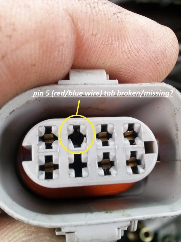

alright guys i have a new question about one of the wires in the tps plug. i have kept getting a fault code of 00670 "tps implausable signal". so i asked on here for a pinout so i may test the wires for a short back to the ecu. today i started testing the wires and when i got to pin #5 (red with blue wire) i noticed inside the socket there was nothing enableing it to connect with the pin on the tps, like it was broken or something. all the other wires had continuity. my question is
1) what does this wire do (pin 5 Red/Blue wire      """""""""""""""""""""""""""""""""""""""""""""" pin 1 Rd/Blu wire to        """"""  pin 41 G69 Wiper of resistor (position).
2) could this be causing the code of implausable signal to pop up?

If that pin isn't held in the connector it would throw up that code, as that wire is the signal wire to the ECU for the throttle butterfly position, the other one on pin 8 is for the position of the Idle control.
It looks like someone has tried to remove the pin at some time and damaged the connector ?

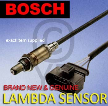

What engine code do you have ? as the ones listed for 1998 only have 1 lambda sensor ?

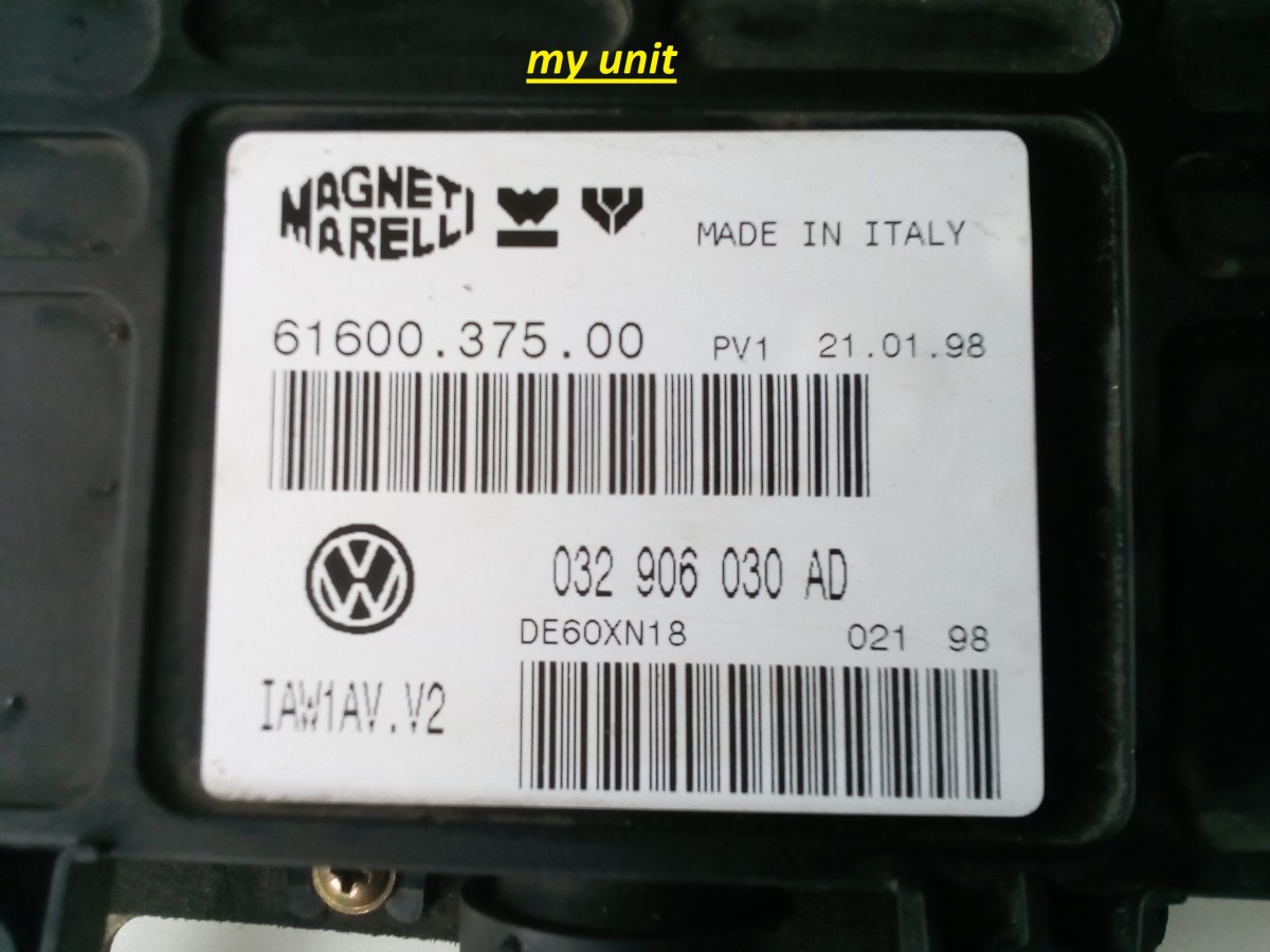

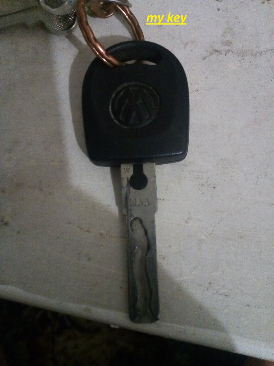

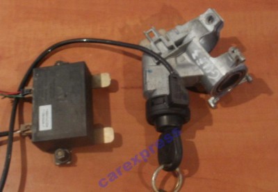

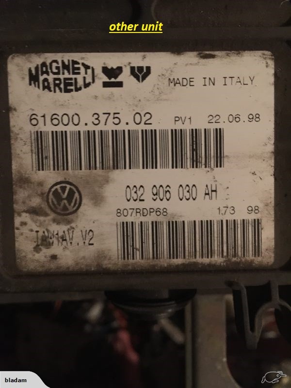

yes i have been clearing the codes after i changed sensor or connecting/disconnecting any of them ect. yep the car is automatic.. 1998 vw polo 1.6L engine code AEE. Vin# wvwxzz6NZWW117063, ecu part # 032 906 030 AD . if i could ask, my car doesnt have the key symbol in the instrument cluster, does this mean i have the older version of the immobilizer system (system II?) i have available to me parts from another vw polo, same year same engine/tranny ect ect. the ECU number varies in the last 2 letters, mine says 032 906 030 AD, the other one says 032 906 030 AH. in theory, if i get the ecu, the immobilizer with the key and ignition switch (mine is pretty buggered anyhow). this should work? with the exception of maybe adapting the throttle body? sorry i have so many questions but vw is all new to me. here are some pictures of what i have.......

The AEE definitely only has 1 Lambda probe
To get around the re-coding you would need to get the ECU, Immob unit & the matching key transponder/key fob

mine is definately a 1998.....two lambda probes brother, i'll take a picture for you tonight when i get home. this is one of the problems i feel with these cars, is the lack of consistency in equipment and information!
Well I'm going by the main dealer wiring diagrams for a 98 6N1 with the AEE engine and they only show the 1 lambda sensor, unless yours was a special edition for a non European market ??
sorry i took so long, got busy at work. here is the picture of the lambda probe on the rear end or the catalytic and what it looks like out of the car (too lazy to take it out). BTW, i live in new zealand so european market?
That is the position for the normal sensor, so where is the other one ?
NZ/Aus are not considered "European" market, my dealer manual doesn't cover the NZ/Aus market cars

the other one is located in the exhaust pipe right behind and underneath the intake manifold (back of engine)
