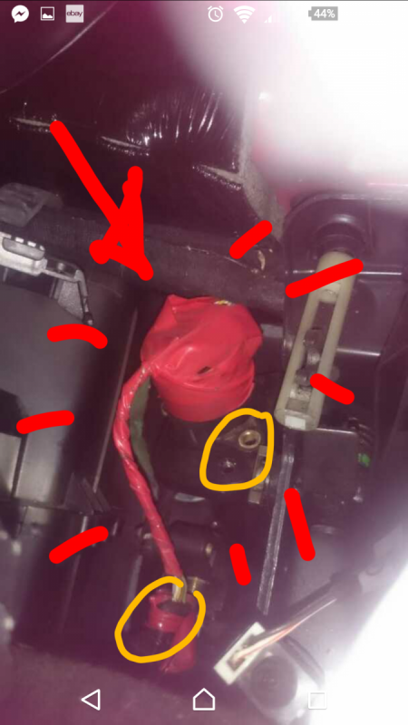

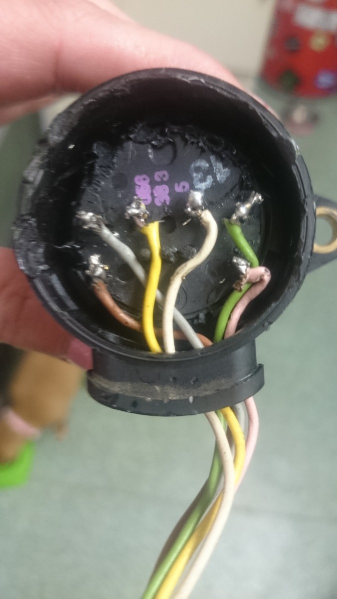

Obviously in my case it was a bodged job, but its still a common and easy fix problem, if only I'd known, I could have saved me a lot of money, which i instead put in the 1.0 Polo to keep it going :-(

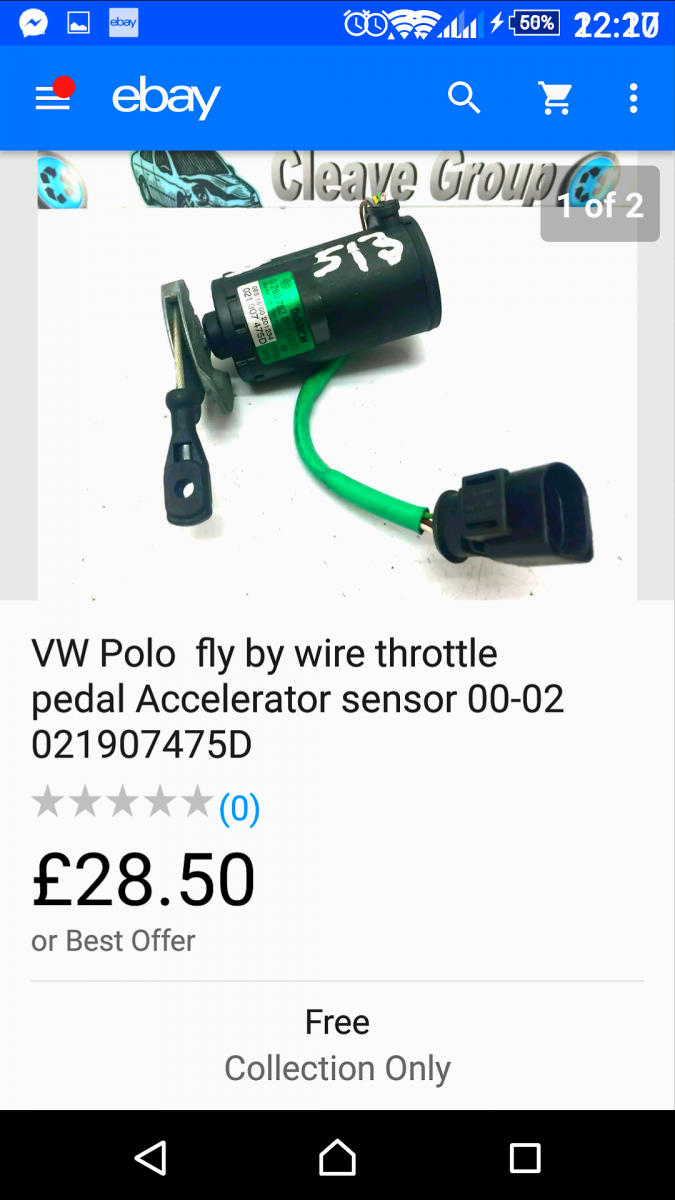

The replacement with part number
And this was under the red tape lol :D

I almost dropped the phone when they told me, £633!! I asked if he was sure he had the right part and if that maybe included the whole pedal and all lol, but nope, that was just for the very same part as the one above

021907475D
(so users engines can find the accelerator pedal fly-by-wire part number)
Despite the 747 not a Boeing jumbo jet part so no excuse for VAG price.
