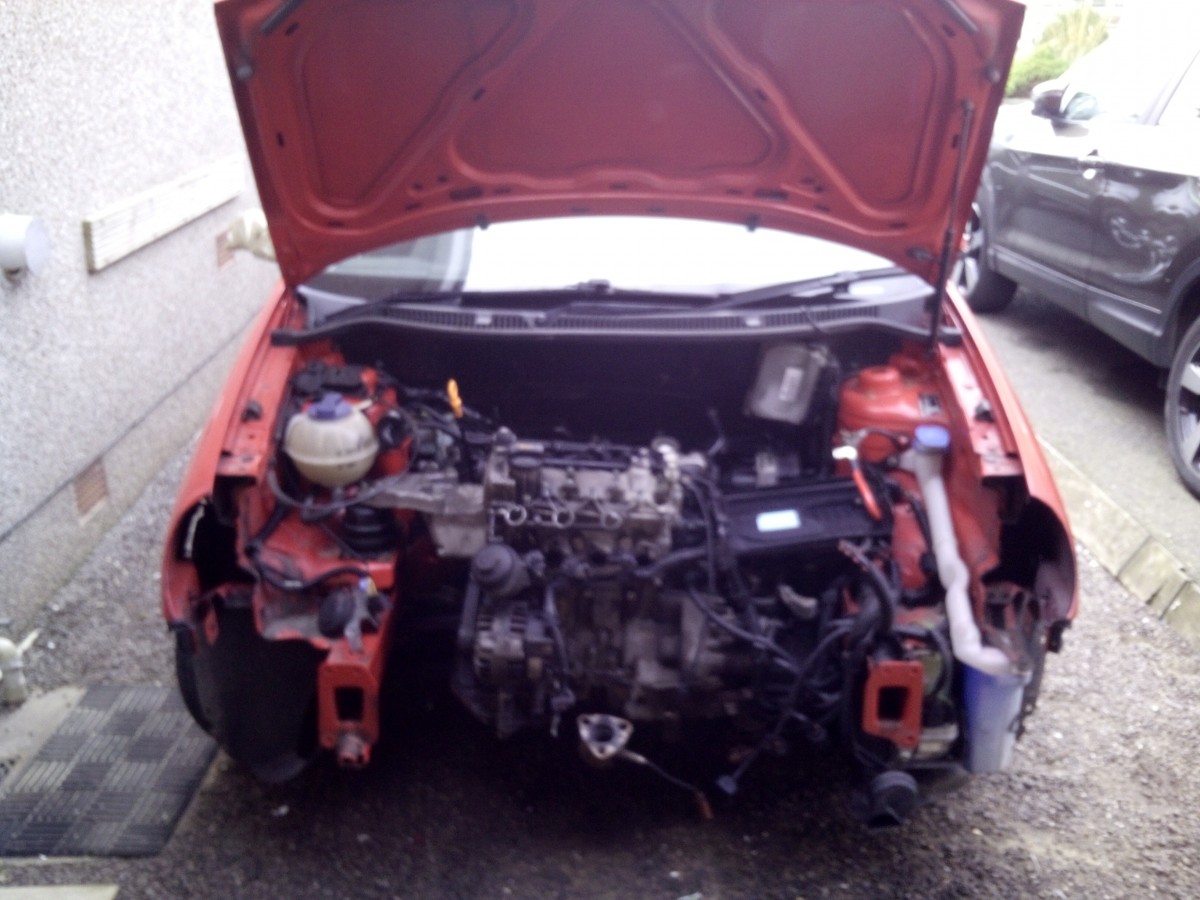

58e021a887afc_IMG_20170401_111239_6CS1.thumb.jpg.d088160b460239df166b36a7e229826d.jpg
I taken the front end off night before so it gave me a head start on the polo's AWY engine.
Out you come you little 3 banger you :D

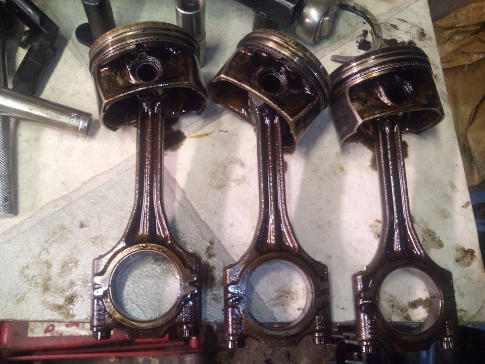

Ohh a hole looks like a new engine then, I wonder how bad this is inside
Ohh it seems one piston has done a Paul Daniels on me
And 2 valves are missing as well
What was left of the internal contents of 2 valves, Piston crown's, and bits of cylinder head.
All 3 rods are bent
So looks like there will be a new engine for this polo now.
