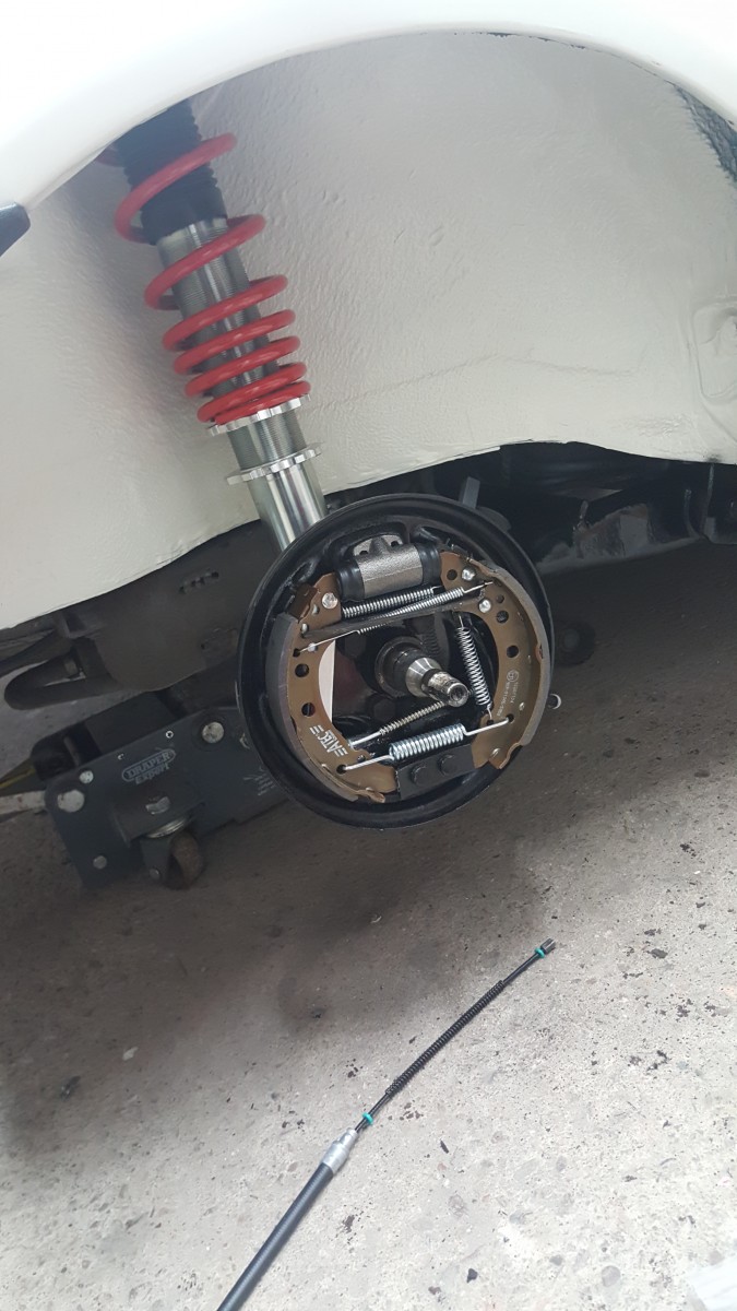

I then started with the back, removed the rear axle rubbed it all down and painted it, fitted new bushes and also painted the hangers on the car side, bought new drums, shoes, wheel cylinders, brake pipe flexis and handbrake cables, but before I fitted the axle again I removed the rear suspension and painted the inner arches. I then fitted shiny new TA technics coilovers bolted on the axle, stub pins fitted all the brakes to the rear. doesn't seam like a lot but doing everything yourself it take a lot of time and effort, I then set about the front...

    rear inner arches painted and new coilovers fitted, along with freshly painted axle new wheel cylinders and brake shoes and drums
