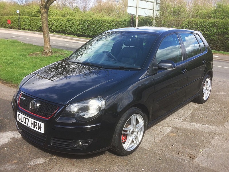

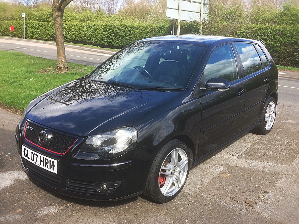

Hi folks!
Quite new here, and recently picked up quite a tidy GTI.
She's going in for a stage remap on Thursday to push up the torque to something useful and the BHP up around 200.
The thing is (and I had this with previous Polos) the brake pedal is quite soft compared to modern, more urgent servos. Has anyone done any minor brake enhancements that have given more of a response? It's ok to drive when you know the car but I'd still prefer a bit more of a bite than the VW gradual brakes I've experienced on all cars of this age and older.
