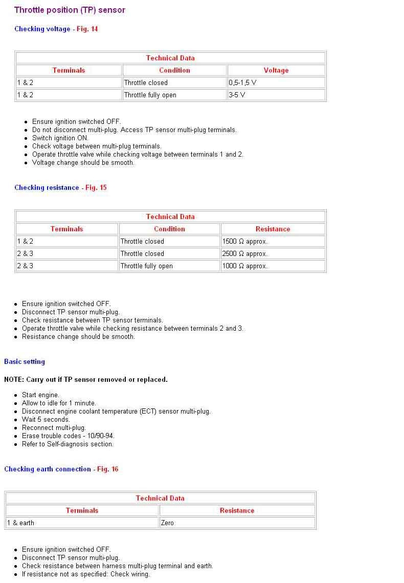

Thanks for your response (again!), any idea what readings i'm looking to get.
I know I saw them at some point in a thread but can't for the life of me find it again.
Thanks
Andy
Thanks that's great
So, I've been out with my multimeter today and found the following:
As I played around with the cables going into the multiplug the brown, earth, pulled free.
I thought brilliant, it must've been a tempermental earth all along!
I pulled the plug to pieces and soldered the earth back onto the terminal.
After this I got these readings on my multimeter
Voltage across 1 & 2 throttle closed .383. Should be 0.5-1.5
Voltage across 1 & 2 throttle open 4.13. Should be 3-5 so ok
Resistance across 1 & 2 throttle closed 1.075. Should be approx 1.5
Resistance across 2 & 3 throttle closed 2.908. Should be approx 2.5
Resistance across 2 & 3 throttle open 1.175. Should be approx 1 so ok.
Earth connection 01.1. Should be 0. Not sure why it read 01.1 rather than 1.1?
I then cleared any codes from the ECU and went for a drive only to find the fault code 00518 to have reappeared.
Do the readings in bold seem to suggest the sensor is knackered or is the earth connection likely to be the fault?

Do you know where the throttle position sensor earths to, it dissapears into the loom and can't seem to locate it in the haynes manual either.
Also do you think that because the throttle closed voltage is very low, thats what is causing the hesitation on low throttle?

So back to it today,
I have replaced terminal 1with a cable straight to the battery negative to ensure a good earth with no resistance.
I then retested all the measurements, first column is the previous reading, second are the new reading. The third column is a reading from my (what I presume is) genuine GT but faulty sensor that I replaced
Voltage across 1 & 2 throttle closed                     .383        0.37         0
Voltage across 1 & 2 throttle open                        4.13.       4.17        4.5
Resistance across 1 & 2 throttle closed               1.075.      1.074     0.85
Resistance across 2 & 3 throttle closed               2.908.      2.90        5.7
Resistance across 2 & 3 throttle open                  1.175.      1.17       1.18
Earth connection                                                    01.1         0             0
So to me it looks like the old sensor was definitely faulty and the new sensor is partially down on voltage when closed and resistance across 1 and 2.
There is still a constant fault code on the ECU of 00518 so I'm guessing this slight variation in reading is enough to upset the running.
Anybody have any other thoughts?
Is it worth me swapping the ECU or shall I just return the sensor and get a replacement?
Thanks
Andy
