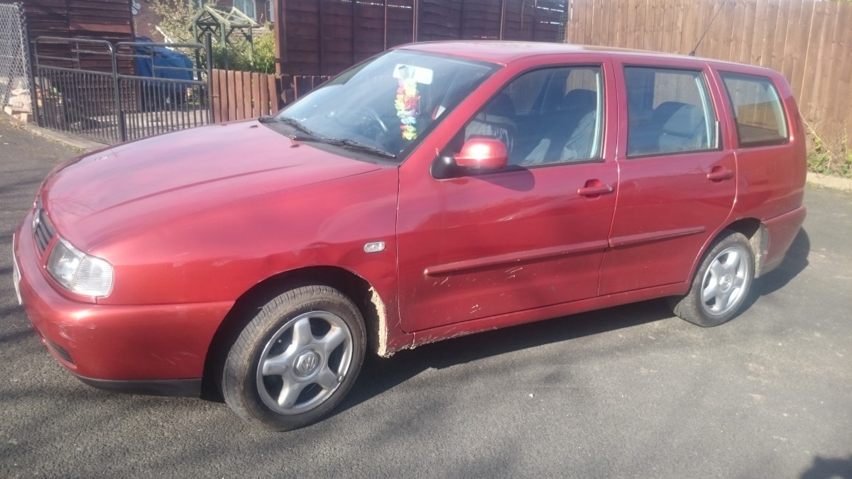

She's back! 6n2 1.4 16v estate
She's back on the road! And i did it all myself! After buying her last year March, I only got to drive her for a couple of months, then she didn't respond to the gas pedal any more, I was told to scrap her as it would be too costly to repair, I was gutted as there's only a handful of this model left, I didn't want to sell or even scrap her so she was left on my drive for a year, then I had a hunch and managed to fix her, it cost me a whole £25!!! I since have done lots to her and she passed Mot last week with flying colours! Im so very proud of myself, and so very happy she's back on the road

  • She still needs a few things doing, besides a good t-cut lol, but so far this is what I've done,    New temp sensor Replaced accelerator pedal sensor Replaced springs and struds on
  • Still to do, lambda sensor 1 bank 1  Clutch eventually  Replace backdoor handle cover Try to find an affordable frame and motor for passenger window, which I found just resting on
  • Audioholic
    Audioholic
    het is een x what anders. tof that je hem weer enigsinds op de weg hebt     (lol forum heeft spellingscontrole)
New temp sensor
Replaced springs and struds on the front
Replaced caliper bolts on front
Replaced battery
New pads n disks on front
New sparks
New air filter
New oil and filter
Replaced offside elec window motor
Replaced alloys and tires
New wheel bearings on back
And yes, I'm a 46yr single mum, with my own tools and on my drive, I did it myself! :D

Still to do,
Clutch eventually
Try to find an affordable frame and motor for passenger window, which I found just resting on a piece of wood when I bought her...

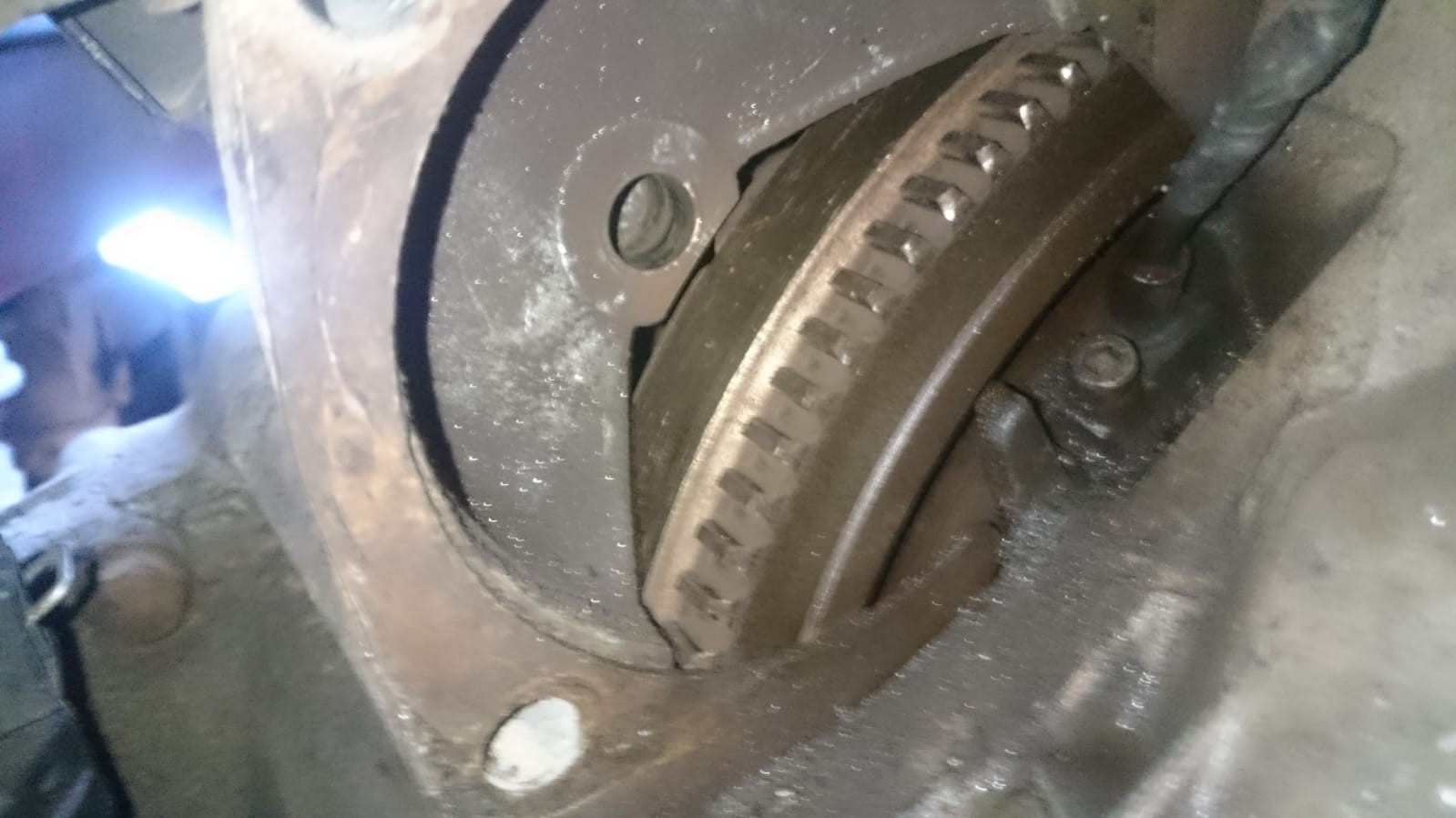

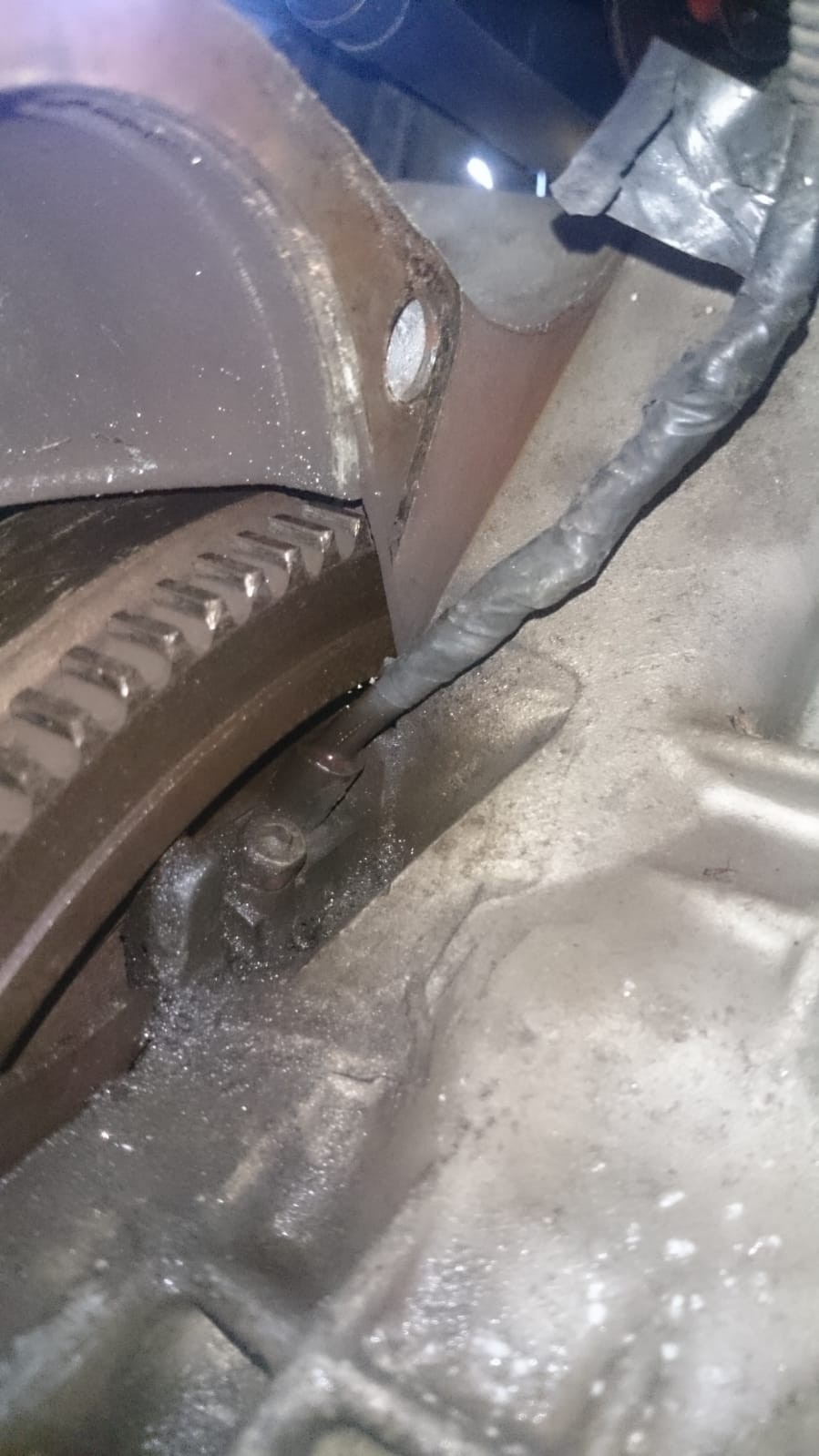

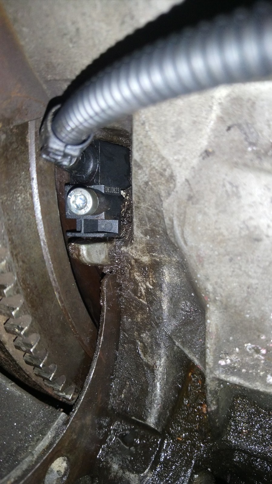

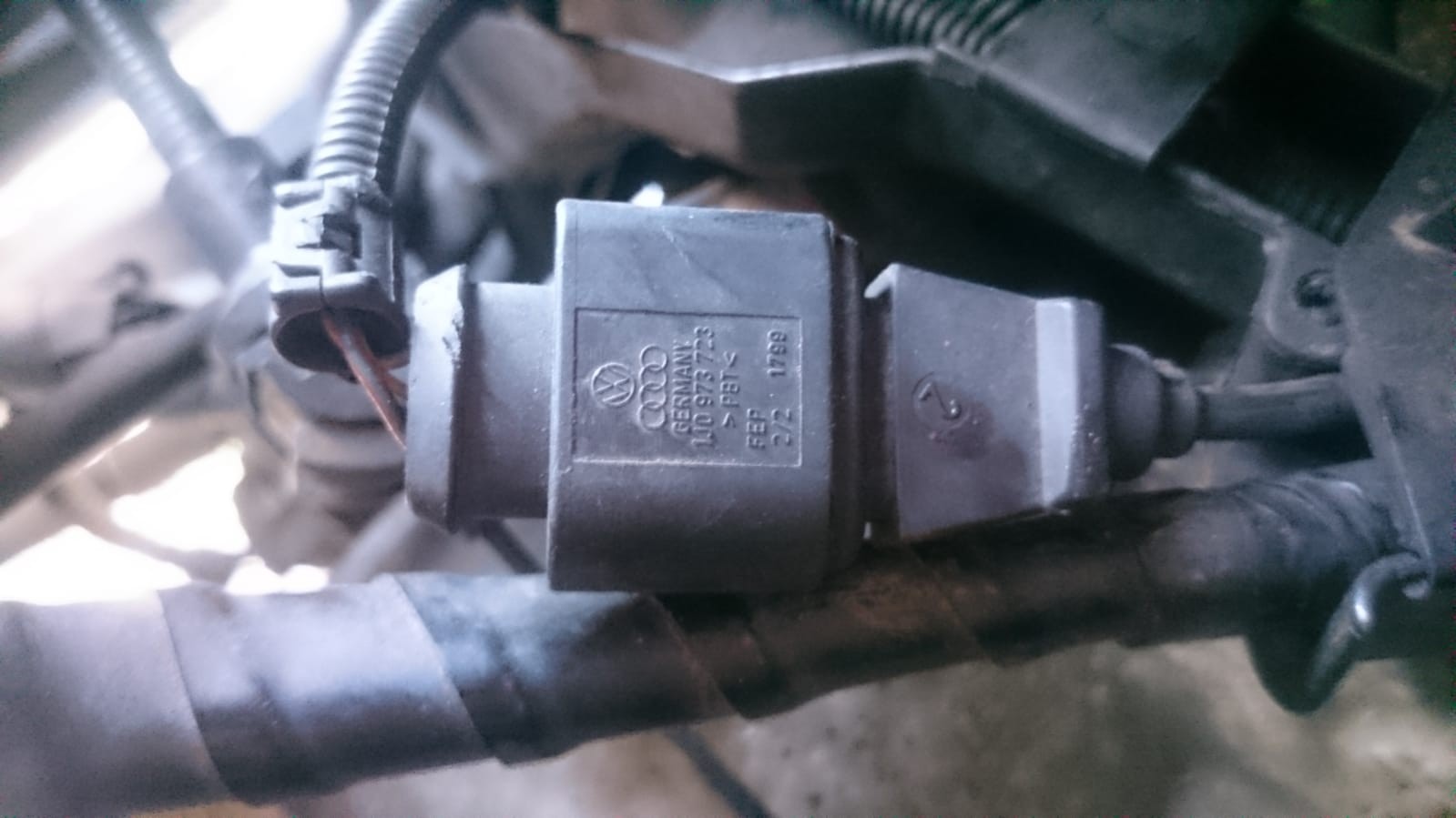

Just a little update, replaced the crankshaft sensor, I'll add some pictures, hope they'll be of help to someone in the future to locate it, its in between the engine and the starter motor, on the gearbox, I found it easiest to removed the starter motor, from the top, and then with help of my phone camera just do it by feel, I was warned the bolt might get rounded, but I found that using one of them longer allen keys, the ones with a plastic handle, nr 4, and plenty of presoaking with wd40, it came out with no trouble 😊
This is the old one, incl the connector plug on the other end
And the new one
