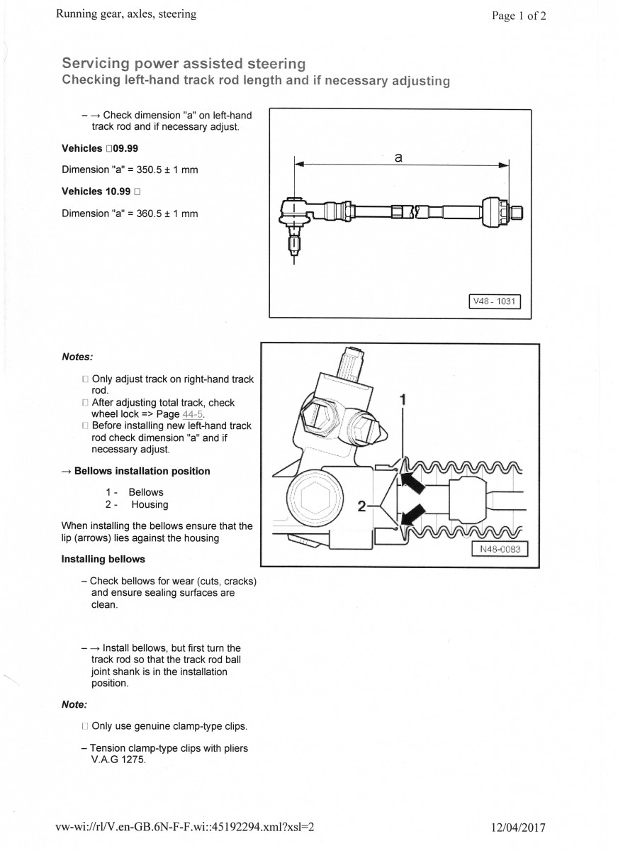

6N2 Tracking. Adjust right-hand (driver's side) track rod only? Why?
Hello all.  Question is as the subject line: Adjust right-hand (driver's side) track rod only?  Why?. That's what Haynes tells me by the way.  That's my main question but also got other thoughts.   So then if steering spokes are not level - take the steering wheel off to correct the situation.

Cheers steveo.  The place I'm taking it to has the Hunter equipment so we will see.  The Haynes manual suggests it is adjustable on the left but just don't touch it!!!
The Dealer manual states to set the left track rod to 360.5 +/_ 1mm from the end of the inner joint to the centre line of the outer ball joint, then adjust the right track rod to obtain the correct toe in
Thanks nige - excellent info as always!  Think we'd have to take the track rod out and bellows off to get a decent measurement.  I think we're just gonna have to assume it's correct as nothing on that side of the car has been touched.  Any work was done on the right hand side so that's where we should be able to make the corrections.
When I say 'We', I mean the garage I'm taking it to!!
TBH I would make sure the wheel is straight and adjust both sides to get the correct toe-in
I'm pretty sure that's what any garage will want to do anyway and as said it seems I've got even less chance for them to address anything to do with camber that a new lower ball-joint may have changed.  Oh well - such is life.  Thanks all the same guys!
