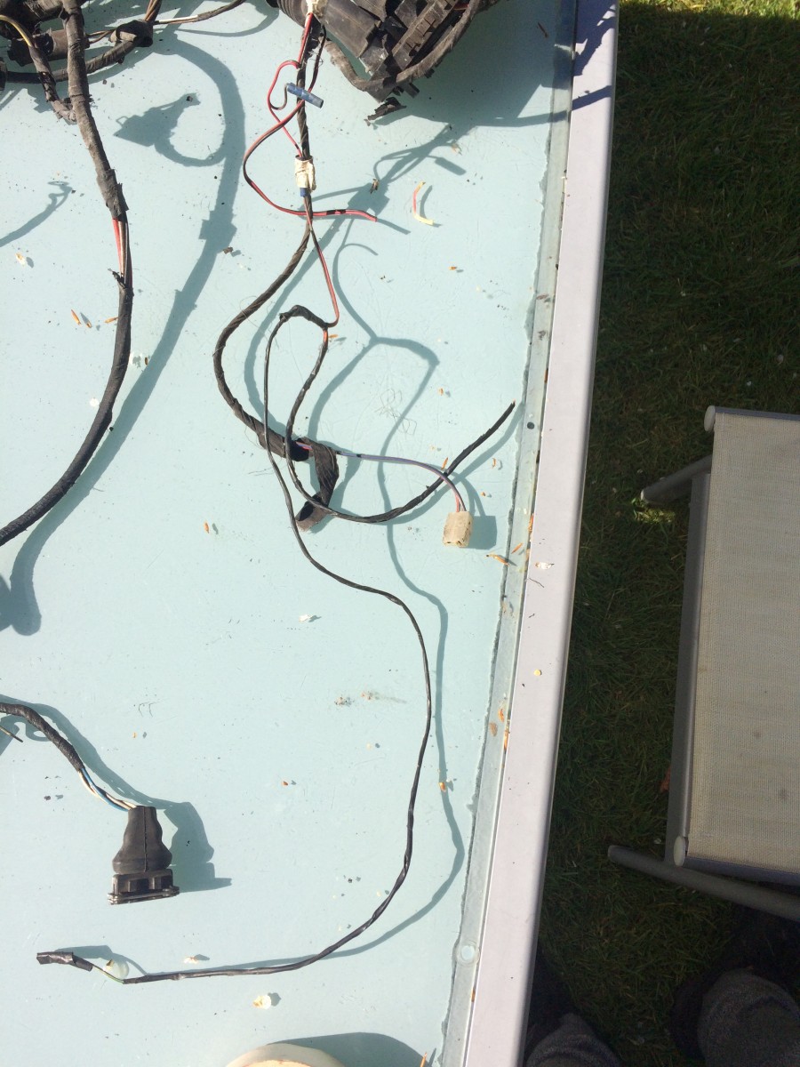

Need help unfortunately I bet people have been through this a million times, but i think this loom has been savaged,
Butchered GT looms annoy me, for a simple plug and play conversion people love to make life hard for themselves.
The best thing to do is connect what you have then try and figure out what you are missing.
Thought I'd bring it home in the sun an have a look at some wiring diagrams, got a couple of things labled, but yes, why people have to chop things is beond me
These looks might have to be scrapped, interior loom gets worse, I travelled, 3 and a half hours so I couldn't leave empty handed
According to the person I bought it off the interior loom was chopped for immobiliser and alarm perpouses??, asked about engine loom, because ideally the description of what I'm buying should state any faults
Well you don't need the interior loom which is a bonus. But that has been cut due to laziness not for alarm reasons I'd say.
I thought I needed the interior loom haha! Well that's huge bonus haha
The only part of the interior loom that comes in handy is the fuel pump wiring.
Witch isn't on there haha
