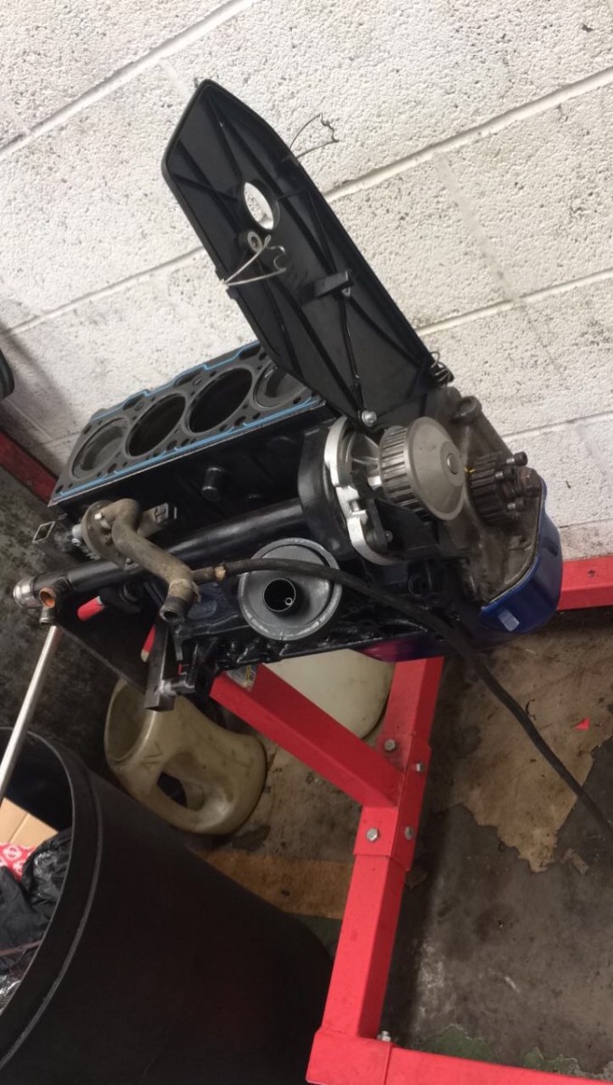

Well atleast what the person told me about this engine, head gasket looked new, but I'd rather know for definite, engine had been stripped to the block, engine stand has been borrowed an block is now on it, sump off an ready for new sump gasket, heads getting checked next week, shall see what the verdict is it's all fun and games

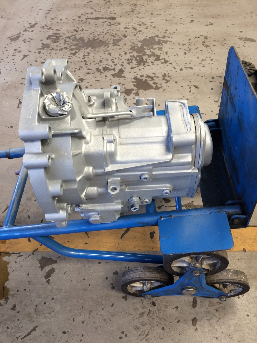

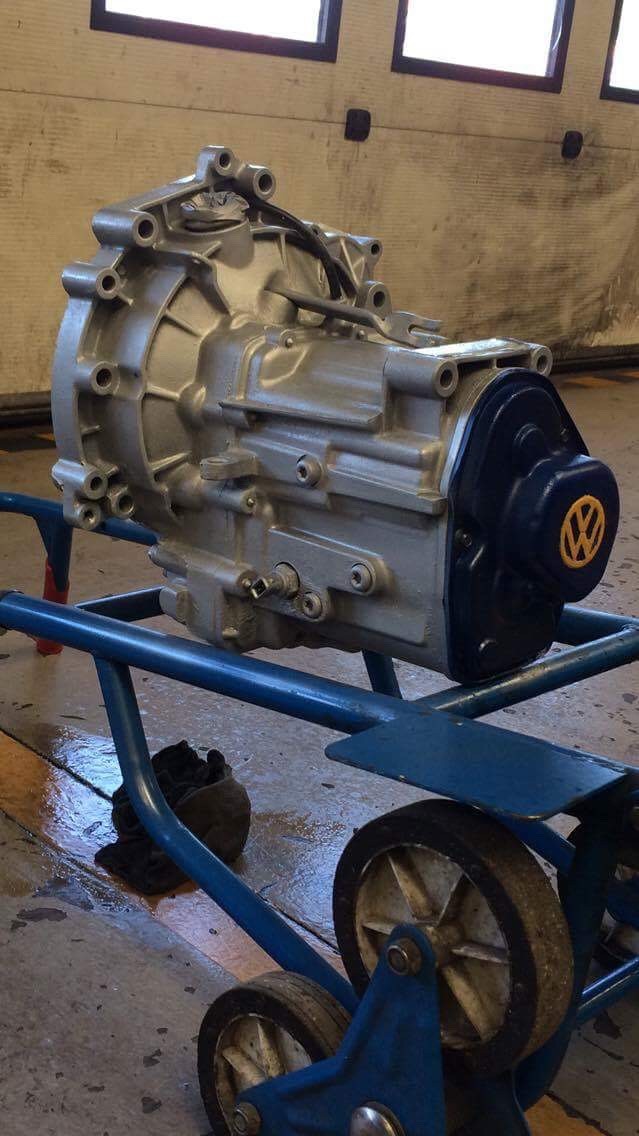

Had fun today, been painting, engine and gear box are done, here's some pictures of the final gearbox result
Final result

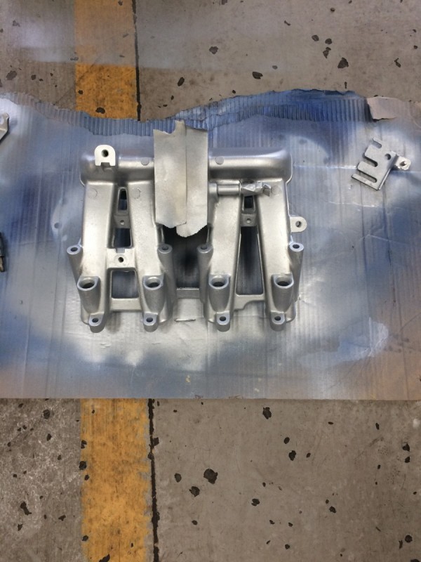

It coming together, just got to wait on head that is coming back Monday hopefully, waterpump fitted, got new belts, sump is back on, sprayed inlet manifold and sorted fuel rail, can't wait to get it built up an ready for in, ps I haven't sprayed where the crank pully is because you don't really see it much with timing covers

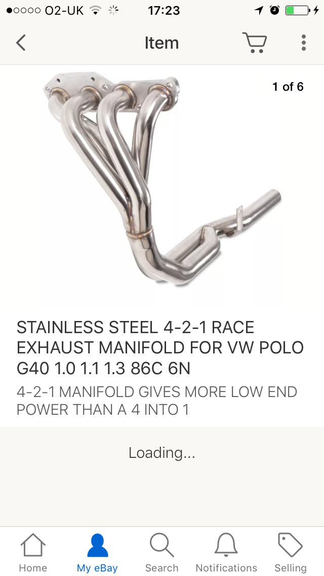

I take it this fits? Want to make sure though

I need a exhaust manifold anyway, the person who I bought it off cut it when removing it so it can't be used so thought why not just buy a decent one
But I'll keep what you said in mind but yeah need to get it running first

Yes 5 speed antiroll bar or it will bash the gearbox end plate.
And with that exhaust manifold you might need some g-laderseite arb blocks to pull the front wheels forward. Definitely if lowering car. Might be okay at normal ride height. These give better handling (and clearance).
