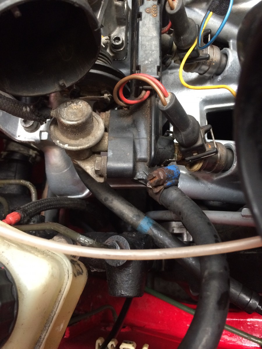

I have a noob question ??, which is the feed and which is the return on these? Is the return as on this picture or the other way round ??
think the rail one is return and the pressure reg is in
